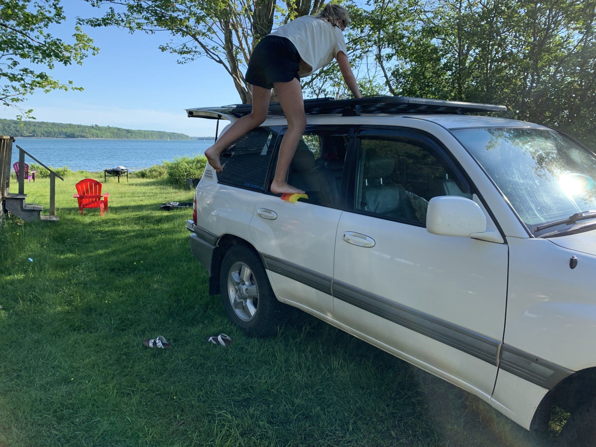

@BenCC really came through with this. It may not be needed by most people but we sure love it!! Even in Toyota racing colors! Thanks Ben! (My door trim thanks you too)

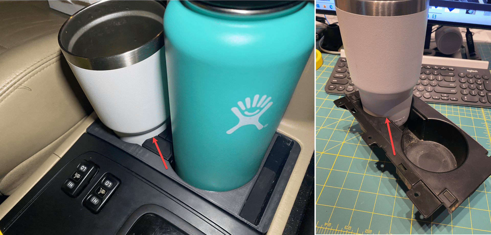

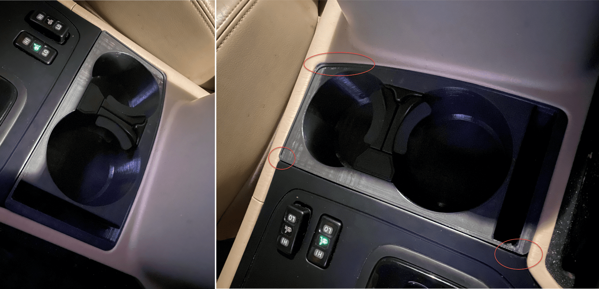

Updated prototype was on the truck. Need revision.
30 oz Yeti fits in both holes. 40 oz Hydro Flask fits the larger one.
Ordered two Toyota cupholder inserts 55616-35010 and 66991-35020. Will see if they can be used with this cupholder.
This is to compare the holding depth. 48 mm vs 71 mm (48% increase).
