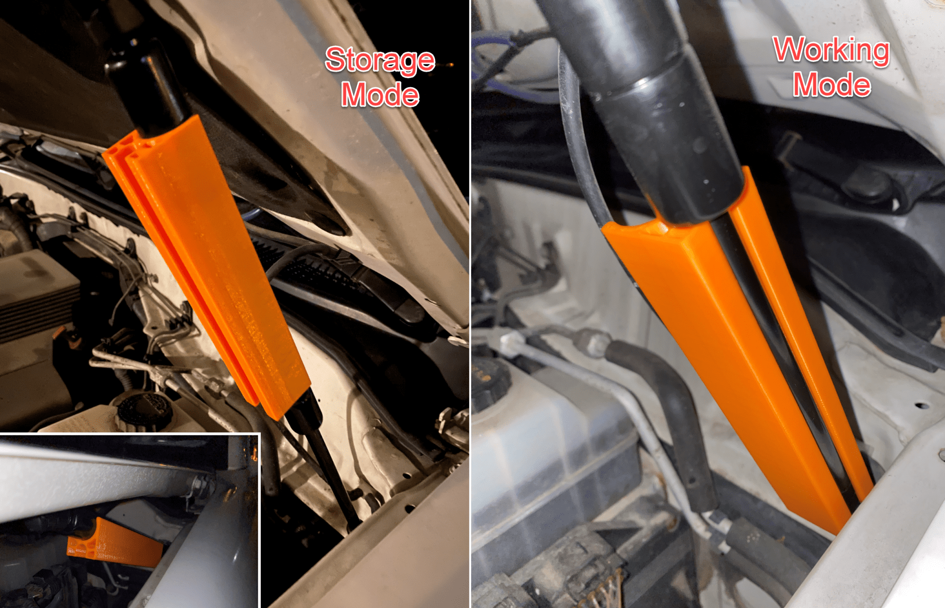

This prototype was in the engine bay for the last two days. Nothing was wrong. But it is still cold in Ohio. Anyone in Arizona or hot places want to test it? Let me know.
Volunteers:
@Zagalona Abu Dhabi
@Otter Arizona
@medtro Arizona
@AustinJoe Texas
i'm in florida. Its been in the upper 80s the last two weeks. My hood struts are shot. I could test for you. I have an LX

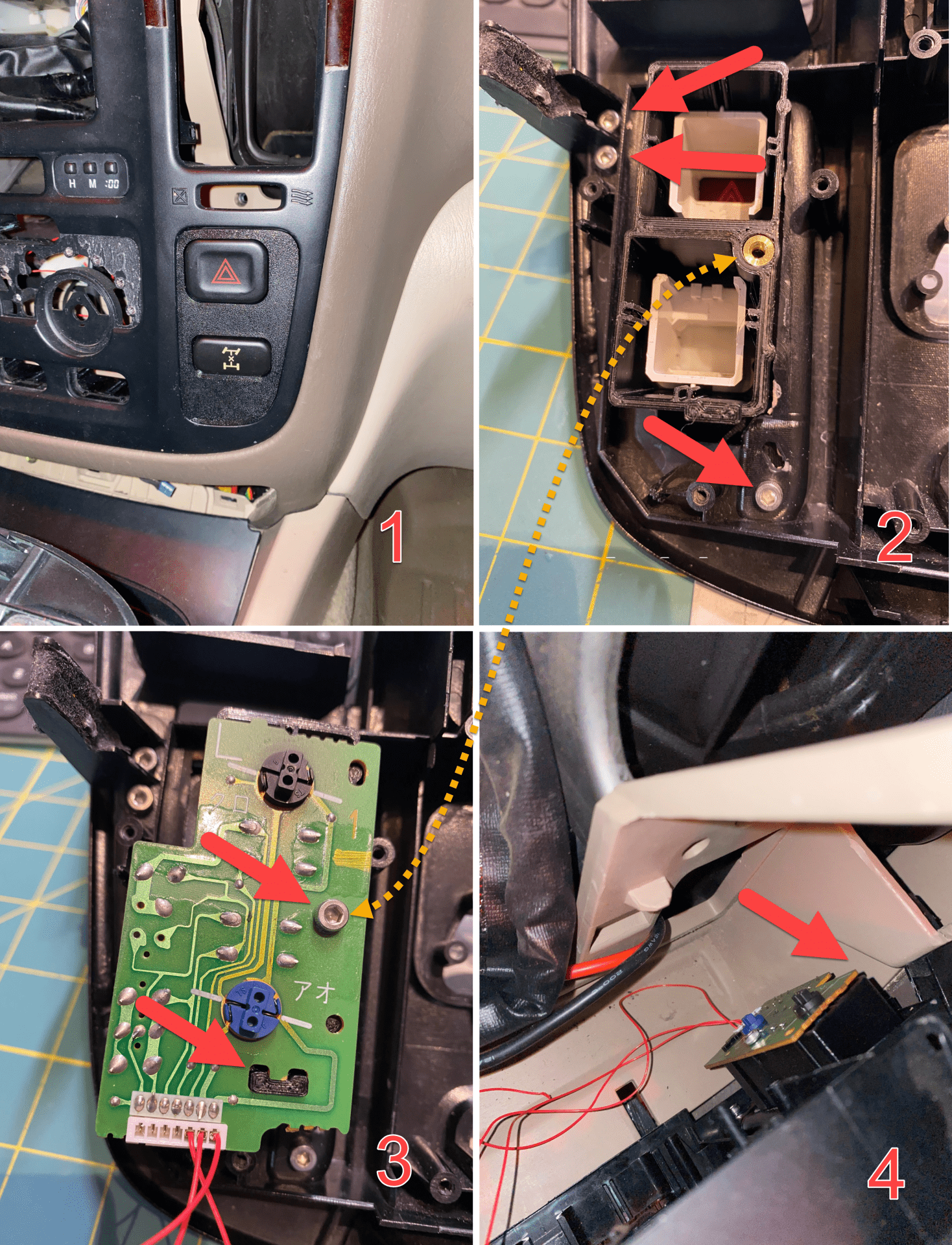

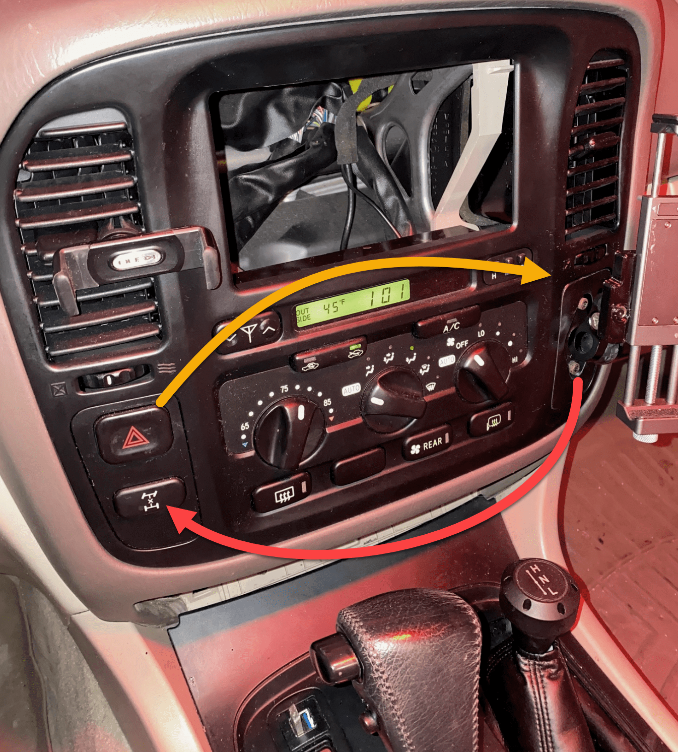

Updating on the Hazard/DiffLock swap panel:
This is the goal which is to mount my phone or tablet closer to the driver and reloate the Hazard/Difflock to the passenger side.
1: This is the front view. I wanted to recess the switches deeper. But the facotry panel does not allow it. Still they protrude less than the original configuration by about 1mm.
2: Three factory holes are used to fix the printed panel.
3: The circuit of the switches is pined down by the printed feature and fixed by the bolt. The micro switches are actually on the circuit board.
4: I had a concern that the circuit board would interfere with factory parts behind the console. Fortunately it went in with some clearance.
Need to complete the wiring.
The Japanese words on the circuit board say “blue” lol.

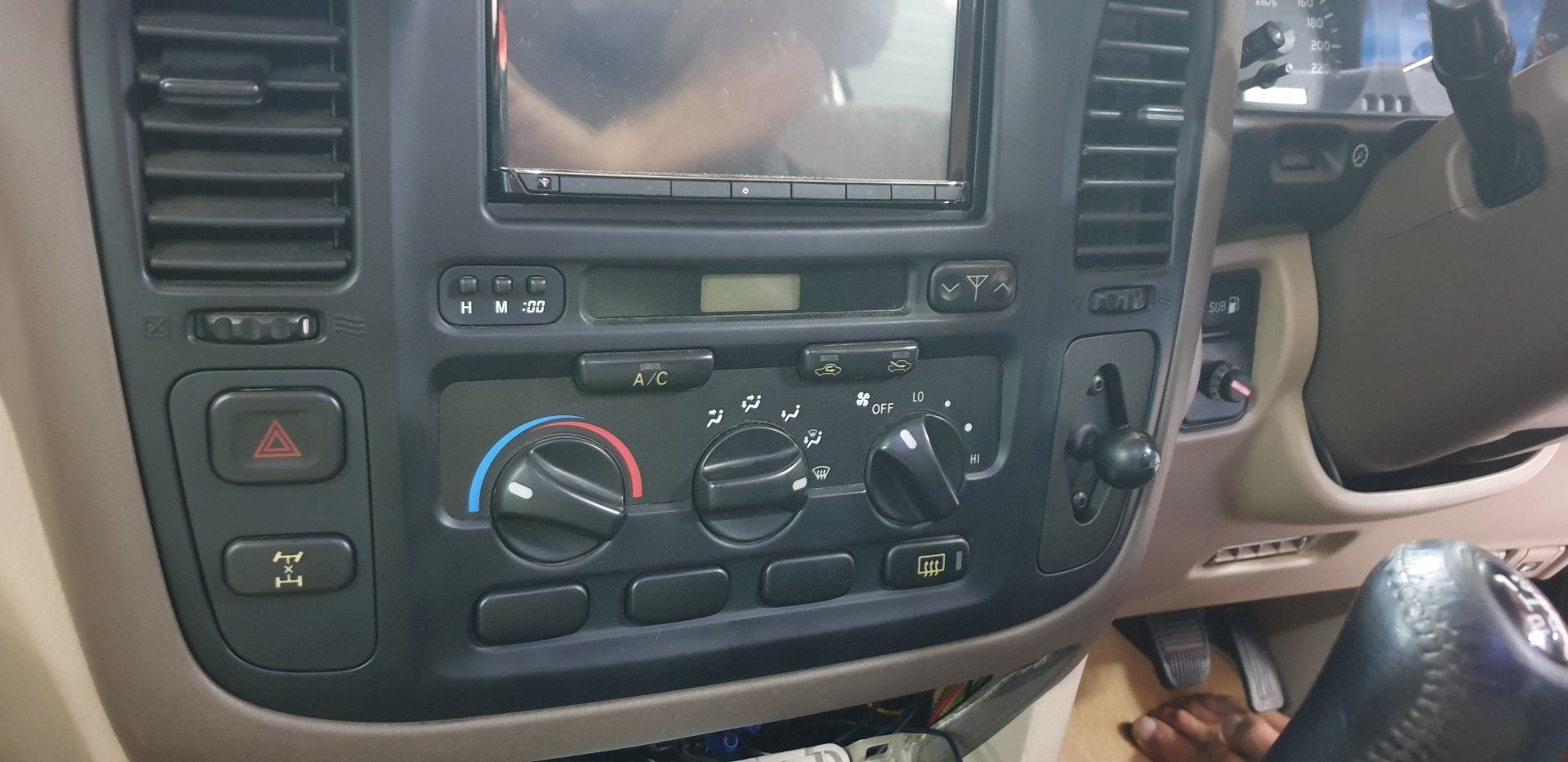

I did this swap on my Right Hand-drive 105LC and it worked out great. I was fortunate enough to be able swap my RH Aussie switch panel for a LH USA switch panel and just extend the wiring. The functionality of having the phone closer is great and it is not that often that you need to reach for the hazard or 4WD buttons. I haven't yet needed to have either of the switches recessed or covered, but I would guess that you do not want your passenger pressing the 4WD button at 100kph (65 mph).
M2V2 installed. While this may not seem too exciting for those in the USA, this is in a right hand drive vehicle. So had to swap my RHD Hazard /4WD switch to a LHD one (a big thanks to @Ayune for the swap) and perform some minor wiring mods and all works like a charm. Just need that ashtray replacement panel now to complete the package.
