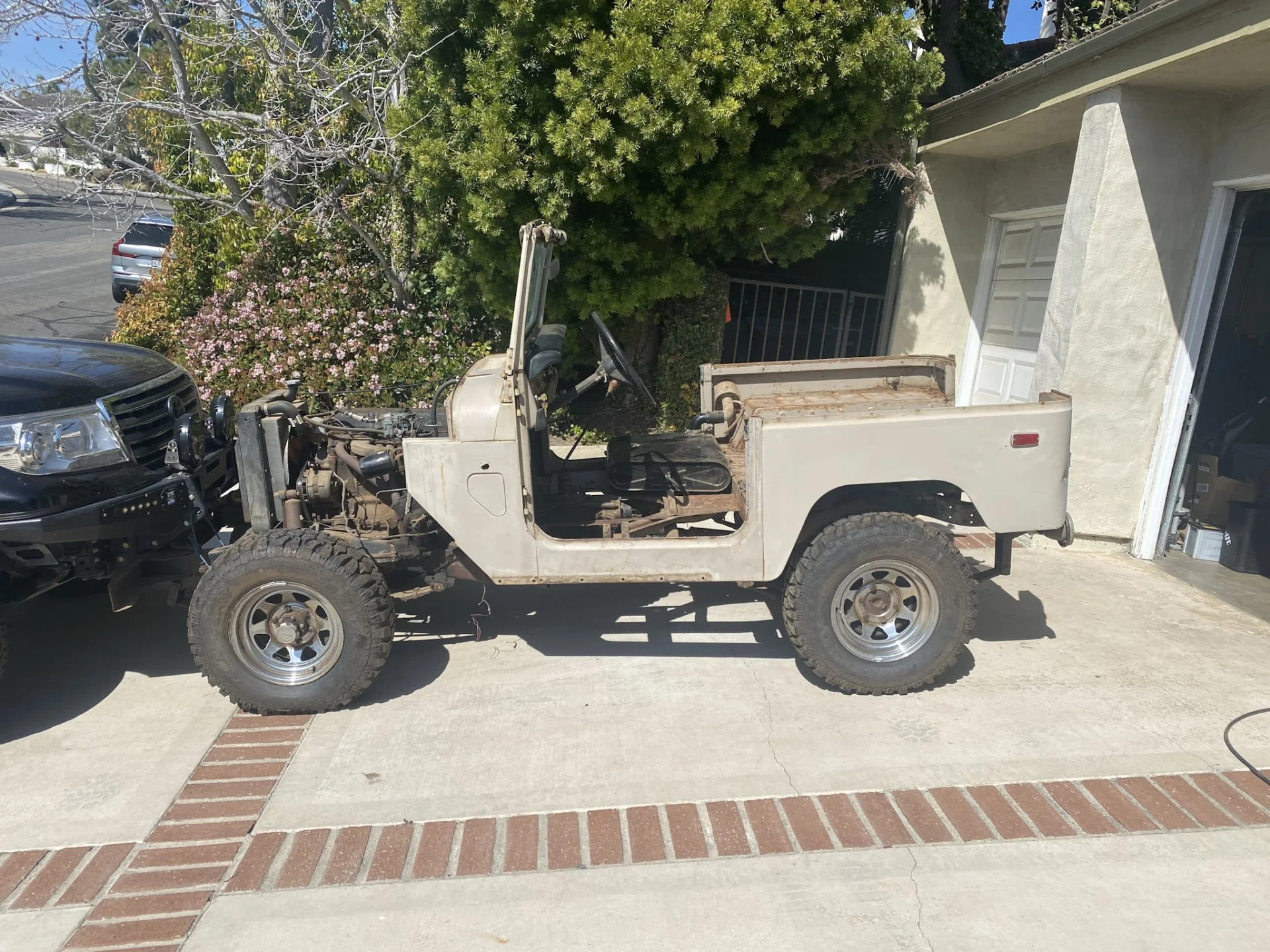

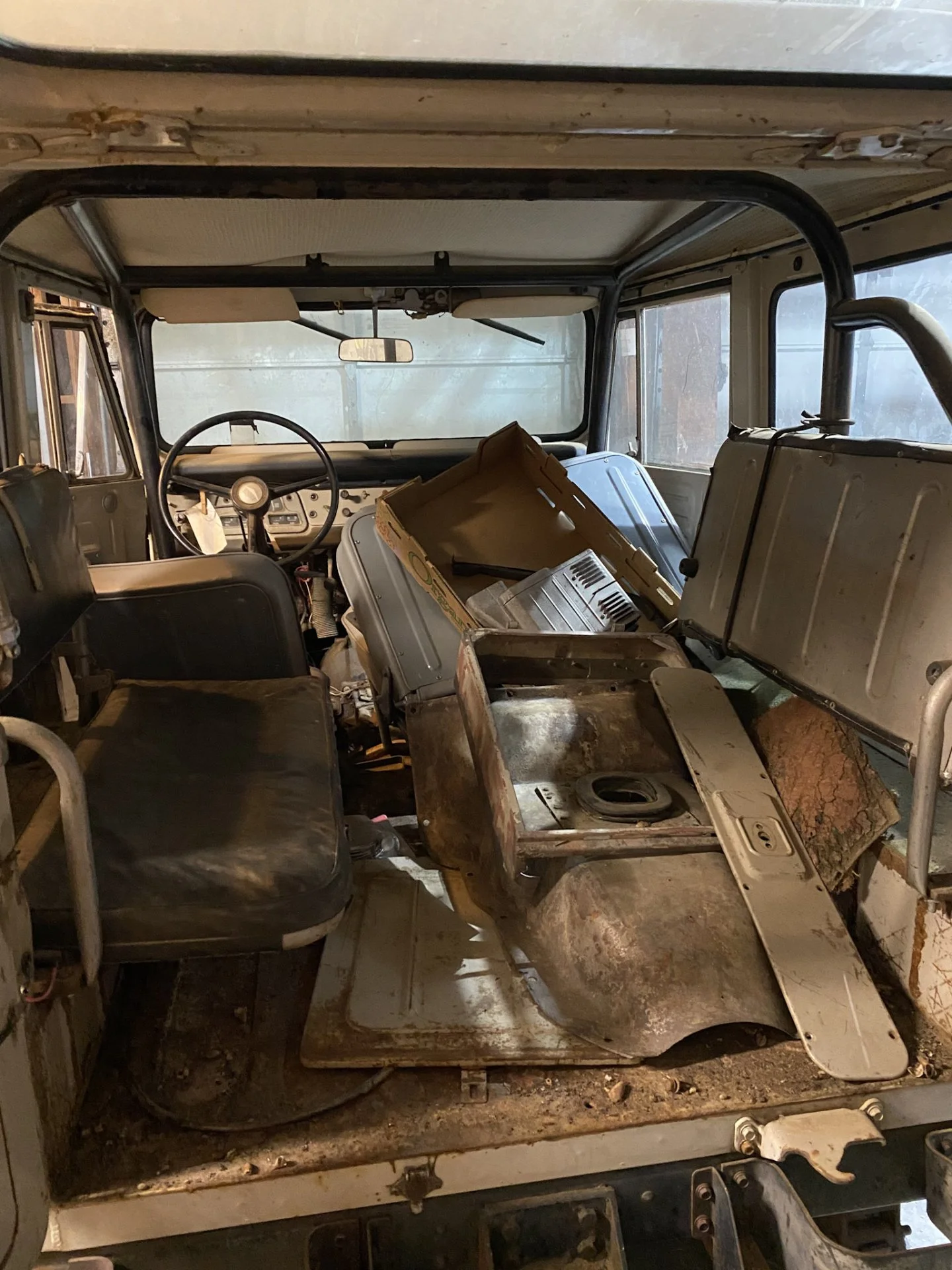

So now I had a January 1970 on my hands, something I thought would be so far in the future was now a reality. It took a while to sink in and stop being overwhelming.
Overall, the exterior is in great condition damage wise. a dent in a fender and rear quarter panel is most of it. As the story goes, it was parked downhill under a tree for 35 years until somone tried to start working on it. This had the floors get rusted from the inside out, most likely from a rear leak. But other than that, the rust is mostly surface.
It was near complete in major components and seemed like a great base to build off of. The seller claimed someone got it to turn over three years ago, but that is as far as they took it.

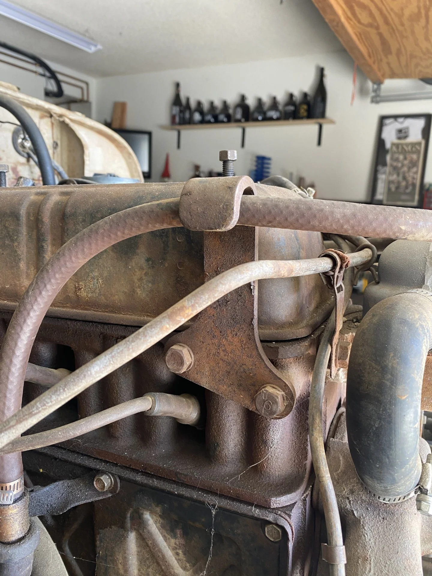

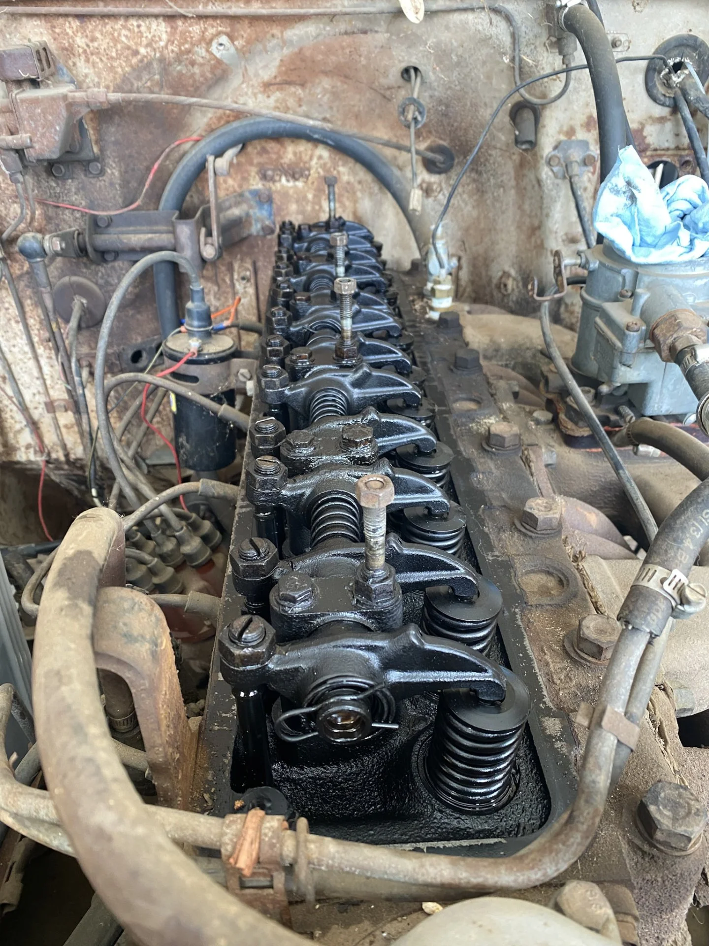

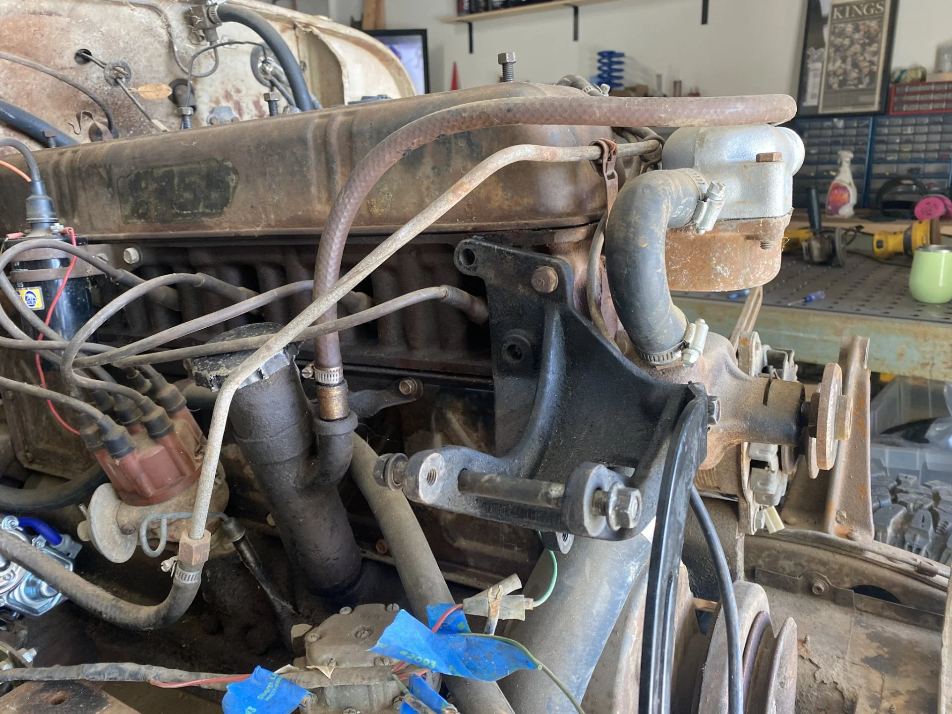

Up first was seeing if the motor would turn over. Connected to a battery and heard some clicking from the solenoid in the starter but nothing else. Removed it and cleaned it up and got it to work on the bench.
Put it back in and got it to slowly start cranking. Definitely not seized. Some coolant under the cover and it is quite black.
After more research, definitely seems as I should have poured some magic mystery oil into the cylinders prior to trying to turn it over. I first tried this about a week ago. Poured some oil into it last night. All the spark plugs had been replaced 3 years ago when they tried to get it running.
New gear reduced starter arrives today. My goal in all of this is trying to figure out if this engine is worth the squeeze of cleaning it up and rebuilding it. My plan is to try and get it to crank over and measure pressure in the cylinders. Is that a sound plan without it firing?
I like to try to turn these engines by hand first after they’ve been sitting. Either with the crank tool in the claw nut or just grabbing the balancer and brute force. I find them pretty easy to turn over by hand and if they don’t, there’s likely something wrong that I don’t want them to be turning over until addressed.

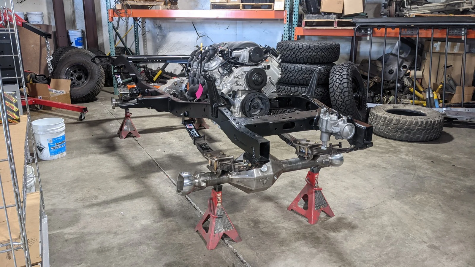

So at this point the plan is to pretty much start from the ground up. The end goal is something that can tackle the Rubicon but also retain that classic look while cruising around the beach town. So the immediate plans are as follows:
- SOA with FJ 60 axles
- Power steering
- Shackle and possibly spring reversal on the front
- Spring reversal on the rear
- New driveshafts due to increased wheel base
- 35" tire minimum

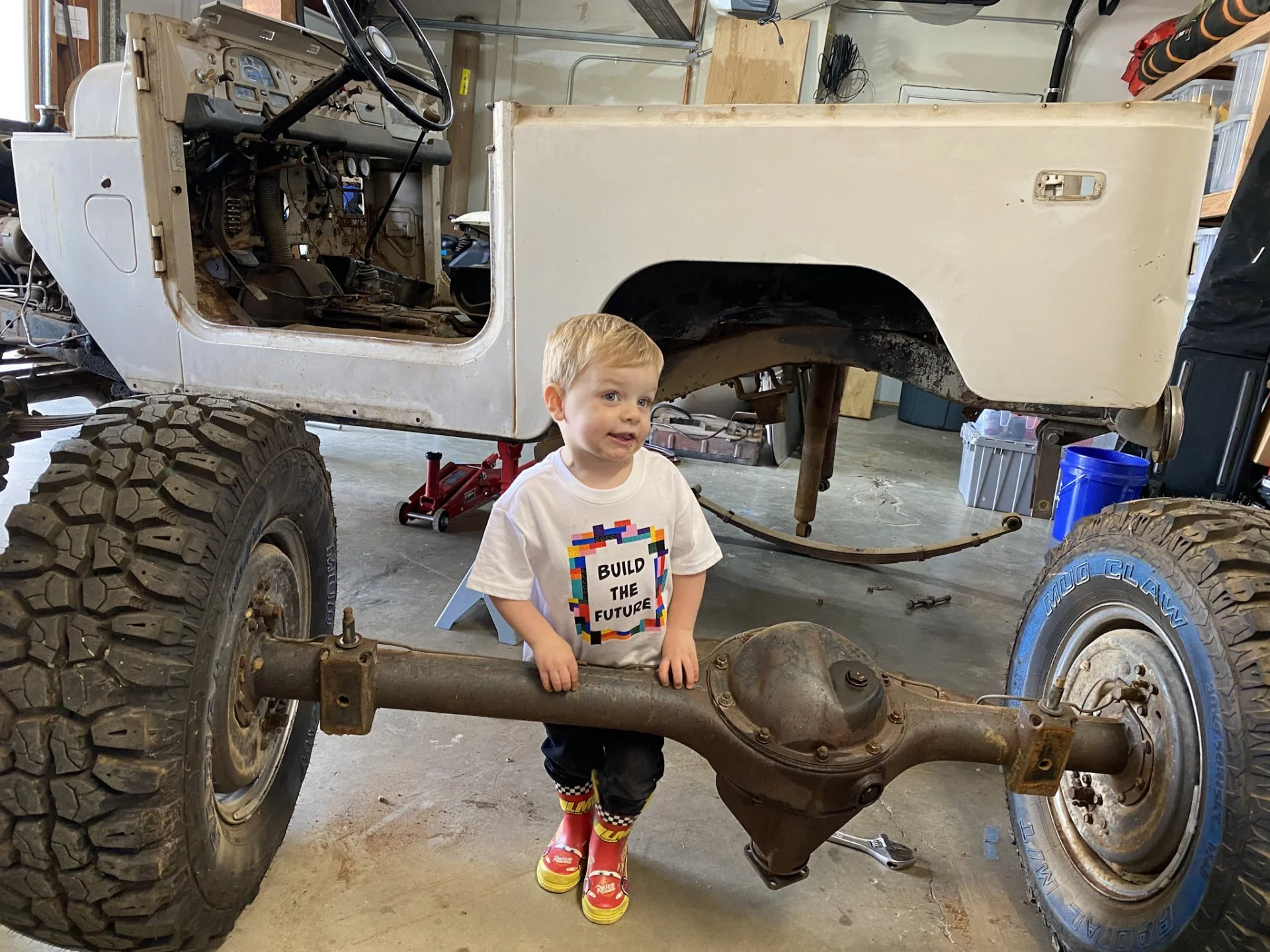

Pulled out the old axle with some help from the little guy.

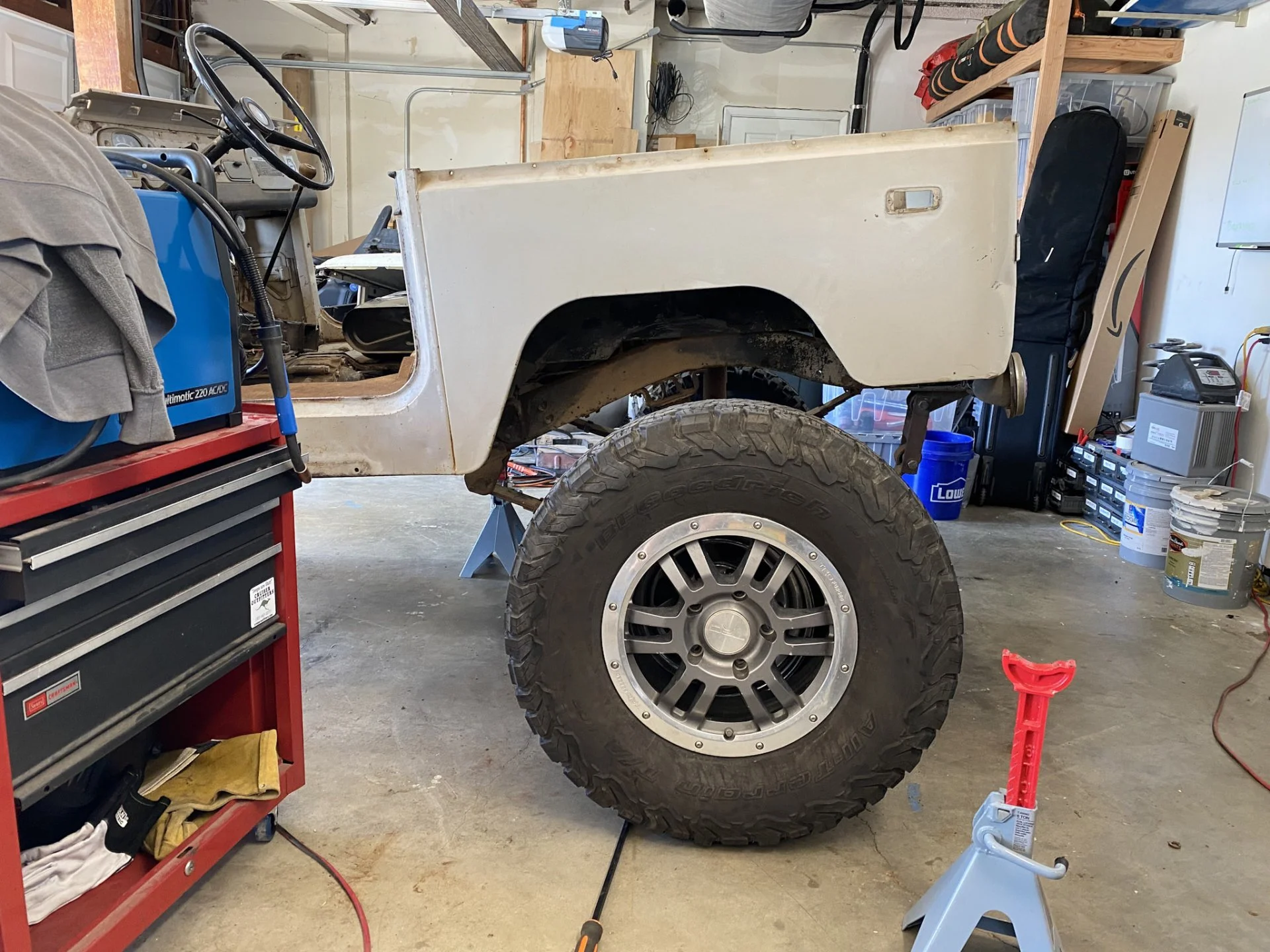

Flipped the springs and placed the new axle under it. Only bolted one side as I need to put narrower perches on the axle. Placed a 35" spare from the 200 in front of the 30" to get an idea of what we are working with.
Started refreshing the rear spring packs since I had to take them apart to flip the second spring.
Couple questions for the brains trust:
1. I assume 60 series power steering is the way to go. Any general tips as I start this research?
2. As you can see, my rear shackle is pretty vertical. I assume a closer to stock shackle length (currently a 5" on there) and some weight will get it into a better position. Any reason to move the shackle mount? Plan is to use stock springs.

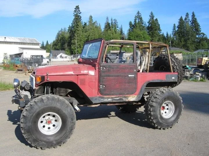

Wow, thought this was going to stay a cherry survivor, kinda sad. You dove right in thats for sure. My ‘80 is 60 axles front rear, shackle reversed and saginaw up front. Everything works really well. I used 60 rear leaf springs front and rear. If i was to do it over again, im not sure i would use them up front again as they are just a bit long for shackle reversal unless you really push the front spring hanger way forward.

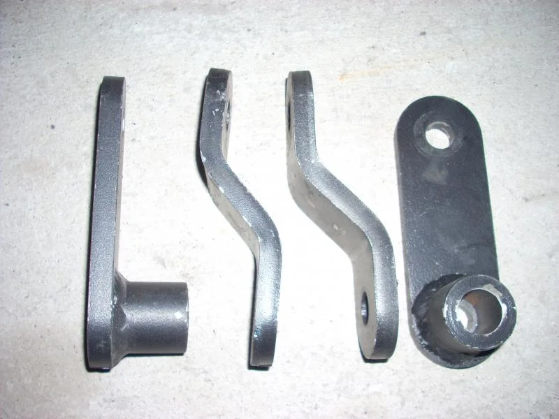

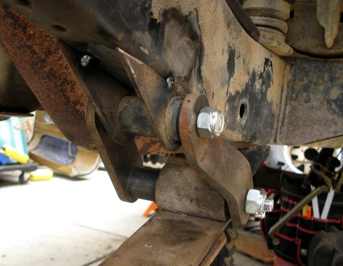

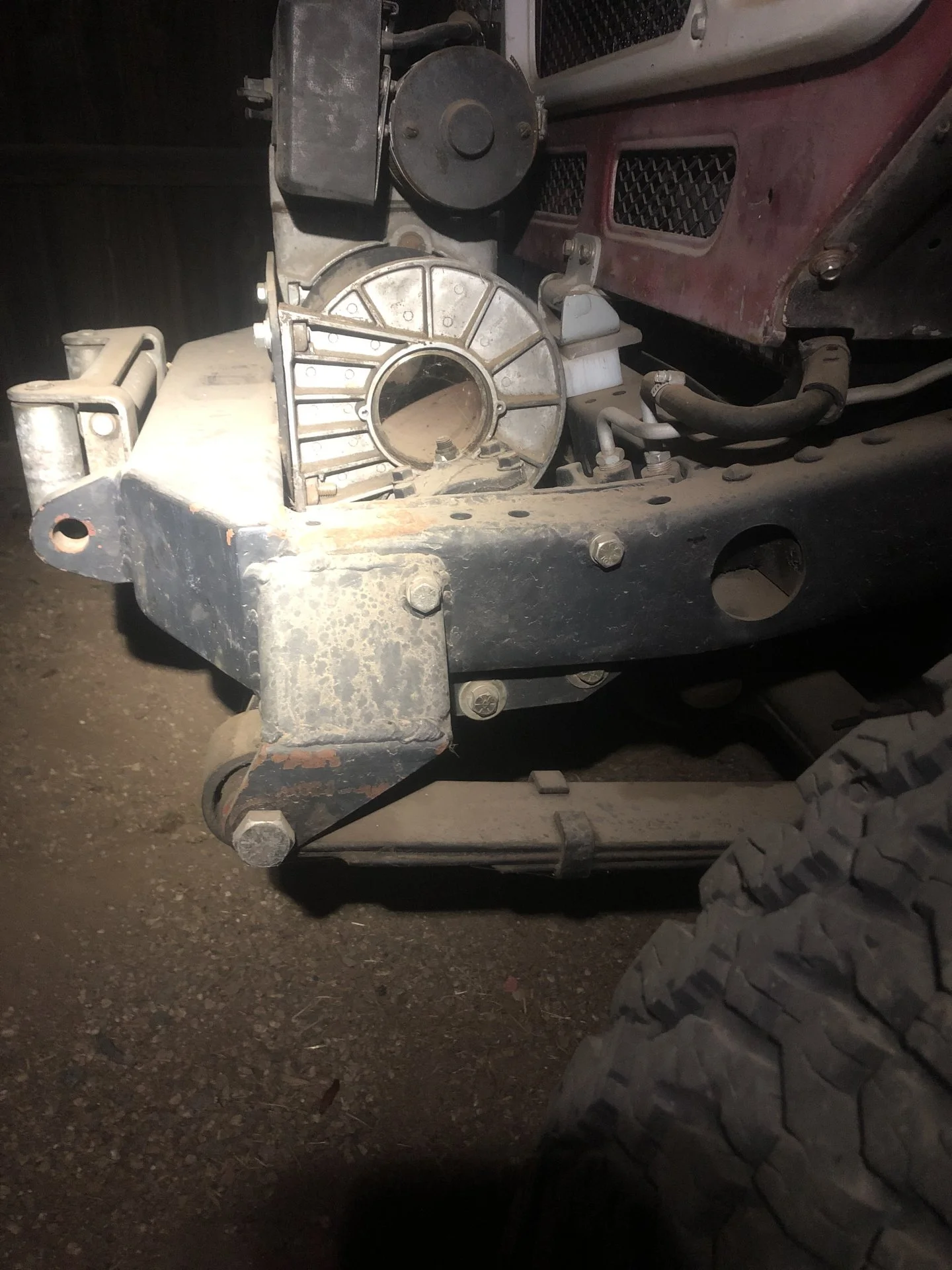

Another thing to consider is how you are going to approach the frame side shackle mount with the out boarded spring width. My first iteration was the shackle hanger below the frame. It made the front too tall compared to the back. I used it for a year and the visuals angered me, so i went to a through the frame setup with a spacer in the shackle. Excuse the dirty photos, this poor thing has been neglected :(
And i need to make shackles that are about 1/4-1/2” longer so my spring eyes dont contact the frame.
Here you can see the old mount below the frame. The viewpoint isnt best, but i think you can tell its go the Carolina squat going on and that wasnt what i was going for.

Thanks for all of the info. Luckily the axles I got have already been cut and turned. Was definitely thinking about a shackle reversal upfront since I have to widen them anyways. Found the following pics while I was researching. Any other tips for sleeving the shackle thru the frame? My plan was to try and keep the sleeve towards the bottom of the rail in order to not have the shackle hit it upon flexing and probably keep the same pin to pin distance as stock.
The offset shackle seems like it would work well. Haven't really found an off the shelf solution, so might have to find someone to bend some up for me.

Knowing now versus what I knew then back in '08, with flat leaf springs and spring over arrangement I would keep the shackle in the front, ESPECIALLY if I was outboarding. The difference in ride is negligible with the shackle in front versus shackle in rear with the flat factory leafs if your suspension is setup correctly (shackle angle @ ~45 degrees at ride height, proper caster, all steering components tight). It really simplifies the issues we're discussing with shackle through frame setups. I think most people have other issues with geometry and equipment, and when they go to shackle reversed, everything gets replaced and/or setup properly, and voila! problems solved, not knowing what the actual root cause of their issues are.
My '71 is spring over with high steer, manual gearbox with all factory steering linkage, shackle is in front with OEM leafs. It does not drive or ride significantly better or worse on the road than my '80 with stretched wheelbase, outboarded leaf springs and shackle reversed arrangement. Both cruise straight down the freeway at 70+ mph. Off road, obviously the wheelbase and width would make a difference, but purely based on road driving, the difference is not noticeable enough to justify all the work. My opinion based on real world experience. Offroad, shackle in front is mostly an advantage. There is the off chance you are not good at driving and run into a rock or tree at a rate of travel higher than what the leaf spring can handle and you can bend a leaf spring, but other than that possibility, off road performance with shackle in front trumps shackle reversed in my opinion.

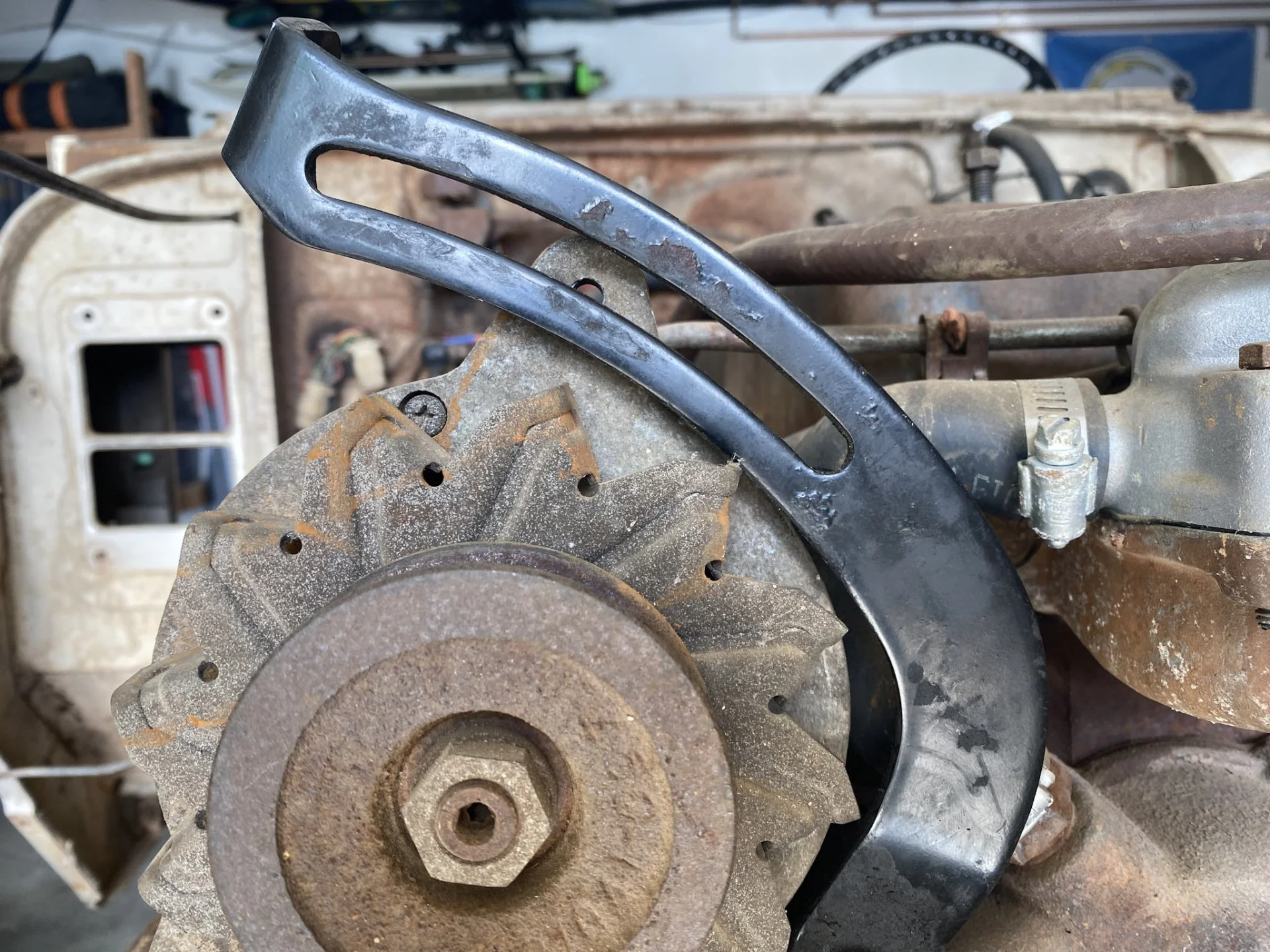

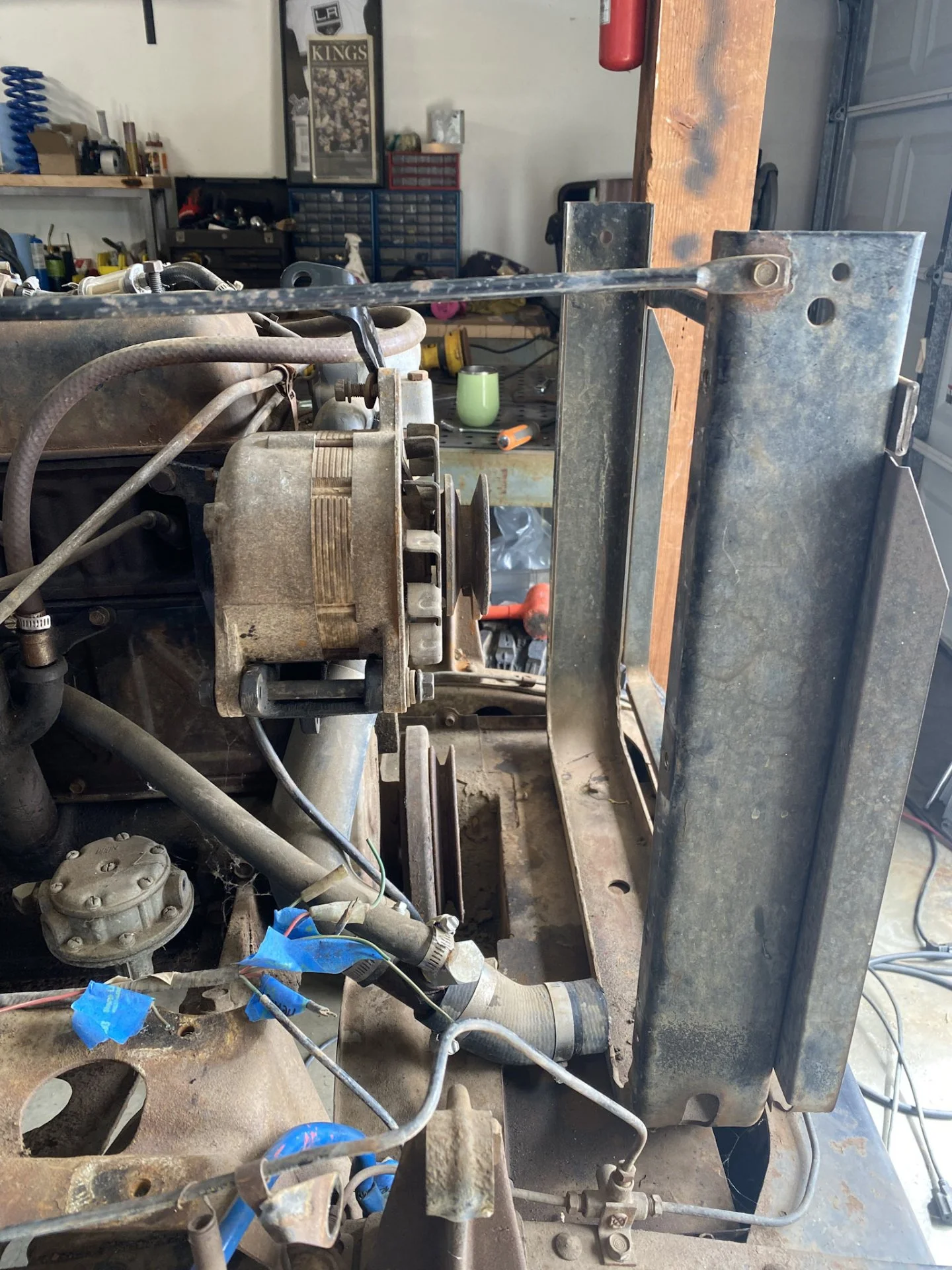

In preparation for adding a power steering pump, I am moving the alternator to the passenger side using a 2f Bracket. Definitely missing a mounting hole, but otherwise it looks like it belongs there. Only have one bolt inserted in the pic, but the two from the previous mount fit.
For some reason I just assumed the 1f Alt would bolt right up. Doesn't quite fir the mount and the pully is in the wrong orientation. Guess it is just an excuse to upgrade the alternator to a 55 amp version. I assume the 2f will be aligned correctly, anyone know if that is correct?
I think is the single row pulley on the crank. A double row might line up better.

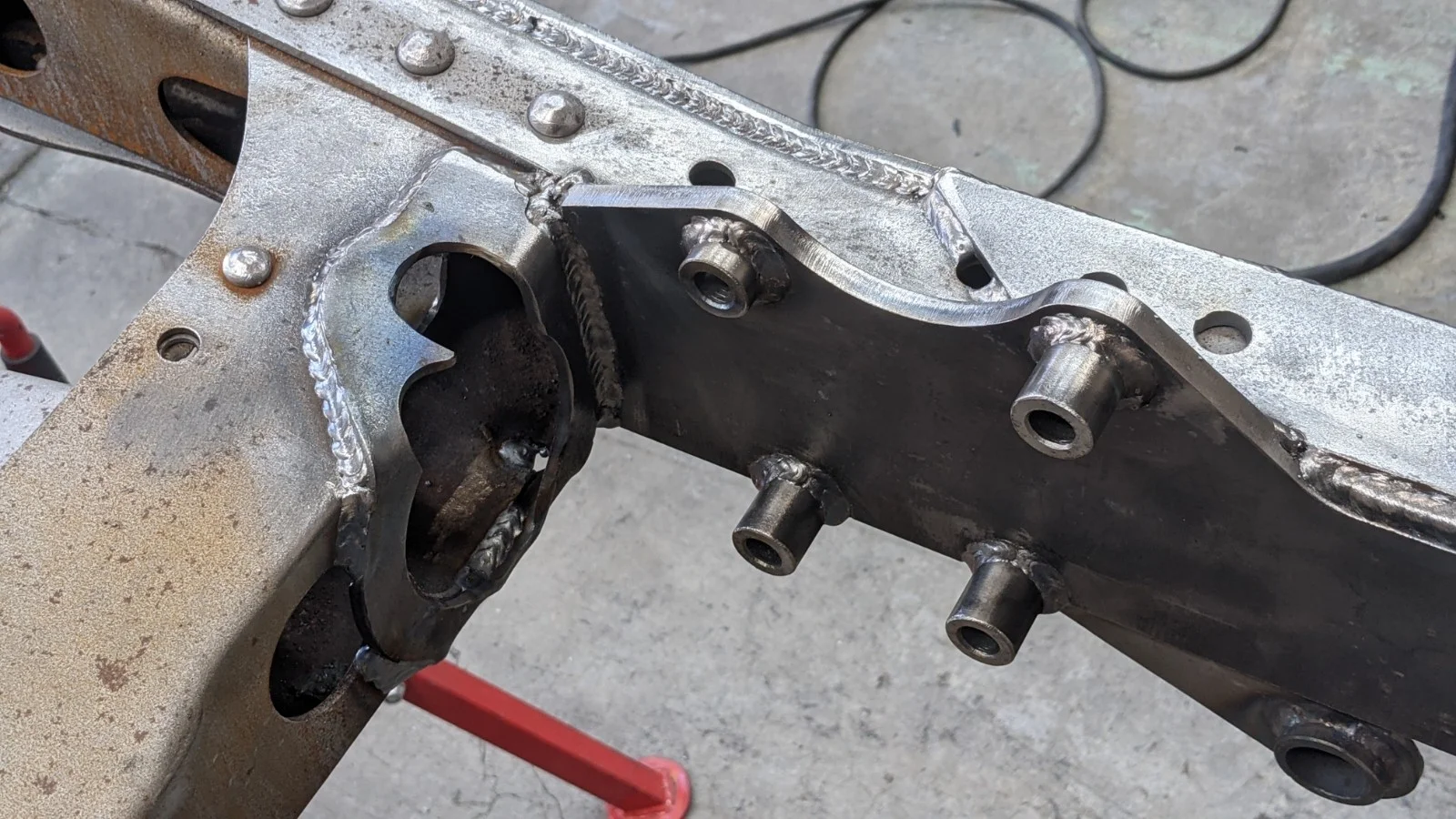

As far as turning back, too late for that. Front leaf mounts and hangers are out. Shackle/spring reversal is in progress. Starting to have it lined up, but want to get the power steering mocked up with a bumper to see how I want to tie it all in with the frond leaf mount once outboarded.
Will be reusing the mounts for the front leaf mounts. The tubes are from the OEM shackle hangers, these will be thru the frame
