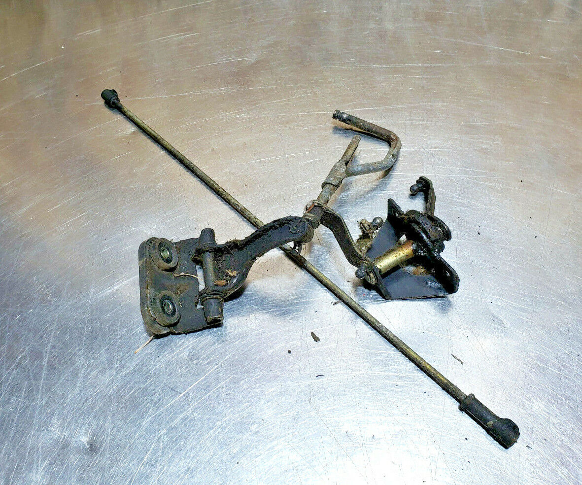

Below is the original carb, manifold, spacer, from my '75 FJ40 fitted with a cable-bellcrank setup. Technically speaking, I assume this Toyota part# 78106-90351, correct me if I am wrong, but, a MUD search comes up with one that has the return spring configured differently (toward the front of the truck).
The goal of this project is to duplicate the above bellcrank and ball-joint push rod. The original Toyota part has some wear, and I'm more interested in a no-slop, positive feel on the gas pedal, and a stack of my own fresh bellcrank clones.
Below, torque-rod-type linkage set-up from early '75 2F tech.

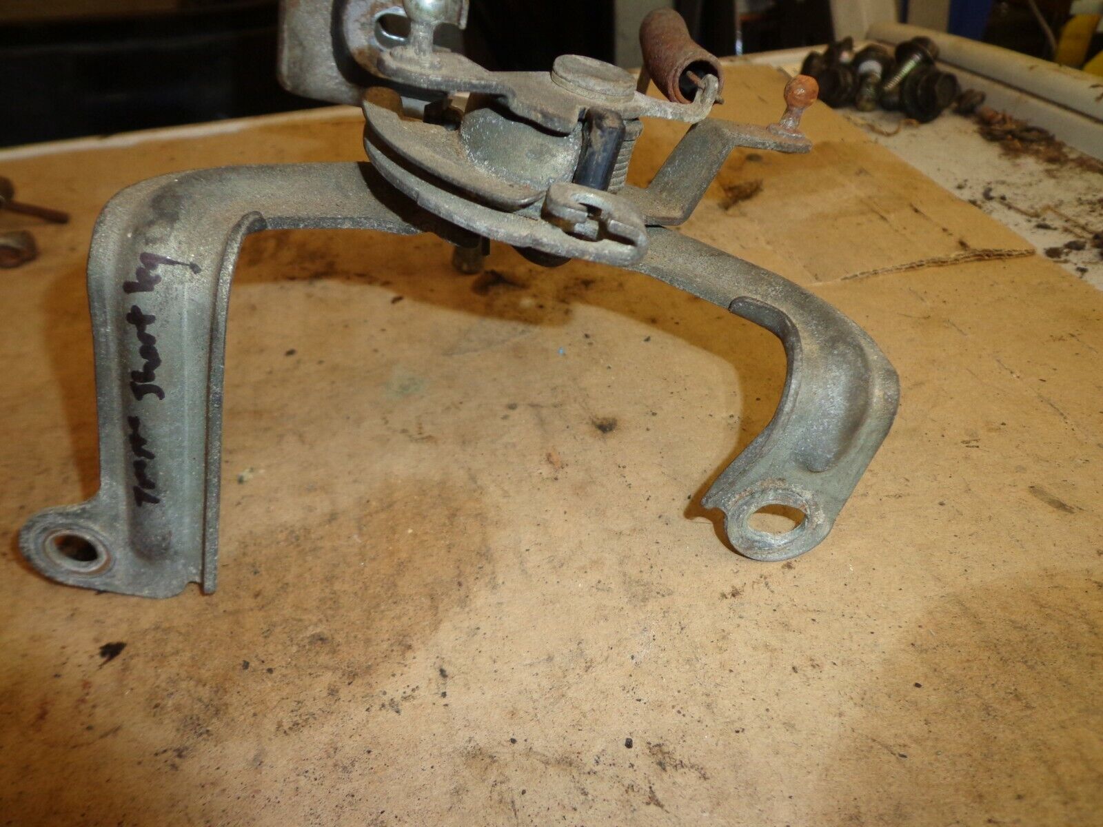

So, here is a '70 intake. The carb spacer from 2F won't clear the head; the F manifold is a tad bit closer where it mounts the carb to the intake than the 2F, so I used a stack of washers to mock up. If it had to do factory oiling with the oil filter on the driver side, I assume that the bellcrank would clear?

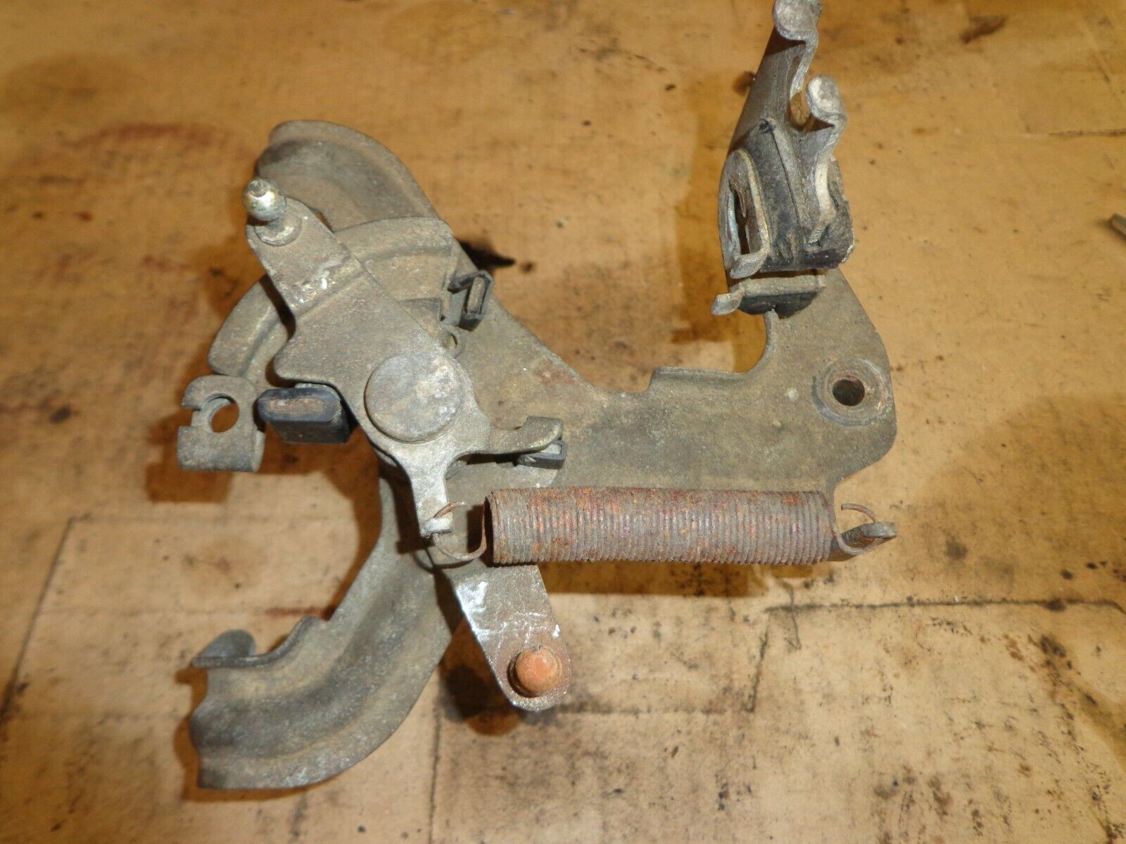

the brake booster and return spring are in conflict here. There is a photo of one with the spring on the fender side of the engine, maybe my bellcrank is closer to the design for the later manifolds?
A big victory about this set-up is you get a carb with a stud for mounting an air filter housing, as the original '70 carb requires a functional air-horn-clamp-type air cleaner assembly. My '73 had been pretty mangled with the clamp around the air horn, IIRC, and probably let in unfiltered air. We are hopefully opening up doors here so that people can run an Aisan-type carb, until you get a complete set of original carb parts, or whatever.

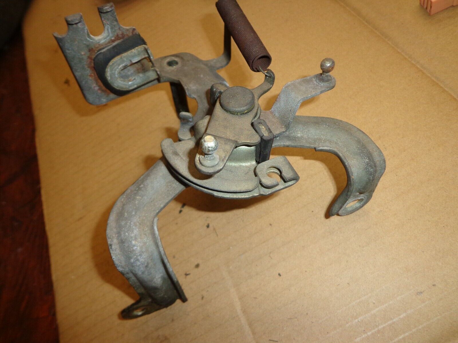

It looks like later '69 was a model-year when they had the PCV routed to the manifold, not the carb base. Maybe that is the year for my F intake manifold.

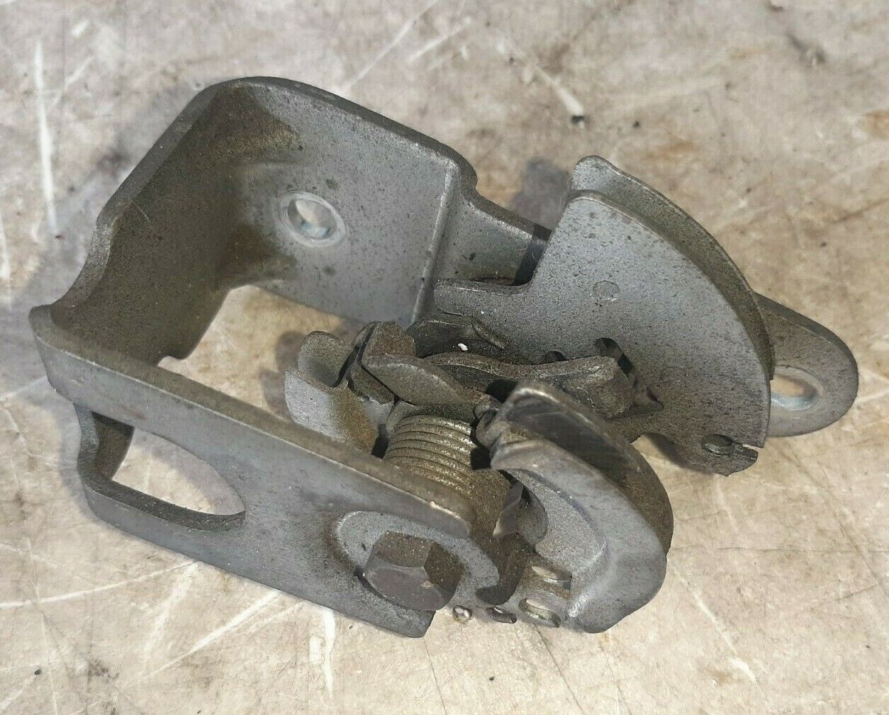

Right now, I'd like to make it so the spring is integral to the bellcrank itself, and reproduce the part of the carb that has the ball - so I don't have to hack up any original parts.
I'm seeing most of what is needed for the spring in this one - photo credit: @73FJ40
7lm6gtKqpPubdKuAtuLX9_VUuCDSQpnvP6RiGywu6PQn-kezR_Jzst59OiLXbHkByMDR96-qPJd1bP6D3YqMxmJryeFW6xdED2x64AOsfToQRFgVRCBjM2wUWksk8mvtw2_7zYmUNNi4Z4e8461zyBCJ40aonC6zAp8Pm4i5fjR3AYRgsf7i9dU5f70f2b2tAvNfNIRLqSTmsRWAHLO69RseBvY7xGTjQUm-kZn-PjGy0-sFxkK6byu5tODuCnCeHT9-hbGeXtkrTvibRMa4SakcpAYOYv_R-pqBrfpNjqfPc0JCskTzgubzWQ3nVVAIk6oI4PSr2ItTdYs1vpVcQccT-S3U8QAKdf1I5kxqvf1XUnR3acWgMPRF-UfM1GQDqYuKwPI2FiQNHvc4Ft9VK1ifxkaCsyGplPkfKMGWuveIn-evT4TveXed5H1exg3nX64tB87_aNvq5CfAFr3m5T8GZOtVLXkMT2qcyrQoU4bNcBPIJjzKT15FbDjKU4c3BwbYkcT8WKd_KAgWlovA86abB5kOVoRabObr-vAN6Y_IApymu5M72NIEWnZHjoIbepuG6vLddoaVl_-NtTyJAZrpf4hpyXqi5wPIjcA3=w872-h1162-no
Now, I wouldn't want to drill out the ball on the original throttle lever, OEM or clone carb. Well, I'm sure that I could find the parts, start sending me throttle levers, PM please. But certainly, I certainly don't want to modify the original '73 bellcrank for the new ball, that part justifies finding an original '73 to go into, or send it to the LC museum kind of thing.
There is a tiny pin on these that indexes the lever, and keeps it from wanting to turn on the throttle shaft spindle by connecting to the part behind it. I used the original pin to locate the other holes on a steel blank. After all that, I tapped an M4x.7 left over from a side marker lamp to index the new lever on the old carb. I left a bit of a boss so I could weld on the return spring (1/8" c.r.s.).
That suggests that the bellcrank was also native to '74-model year? I say that because all of the '73 and '74 model-year carbs listed in SOR would require a return spring not attached on the throttle lever, but integral to the bellcrank. Maybe SOR installed the wrong throttle lever on their carb identifier for '74?
