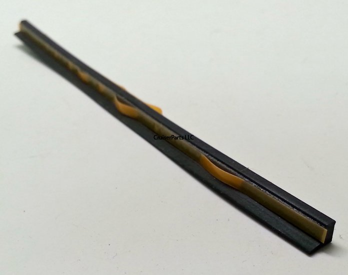

I'll let everyone know how the mask-and-paint-on-vehicle process goes for anyone pondering a cleanup of their mouldings. I think it will turn out really well. The only real issues are finding fender pads to replace the originals (as I believe they should be pulled and replaced to properly mask between the fender and body on the vehicle. You don't want to paint or clear over these - mine were falling apart anyway), and possibly replacing any mouldings that have broken or are loose. I had one rear flare that had to be replaced because the mounts had all broken and we couldnt get it reattached snugly. The shop was able to find 1 of 6 OE flares left in the country (according to them), and it was not cheap; but like @@mtkreitz, I really want to maintain much of the factory aesthetic so I'm trying my best to find the parts.
@ELSIE80 really looking forward to seeing photos.
I'm leaning towards black or something dark for the moldings - that way black pads will look ok. I figure why fight the current and just pick a color that matches available pads.

!HELP NEEDED! I am trying to determine if I need the small fender pads/spacers (3 & 4 in the image below) that goes on the vertical surface between the two-pieces of the rear wheel flare.
61788-60011 (Right)
61787-60011 (Left)
If someone can take a picture of their 80 series (or LX450) so I can see how this looks I would appreciate it. I am thinking I can just substitute the 3M VHB tape in this area but am concerned it may attract dirt.
