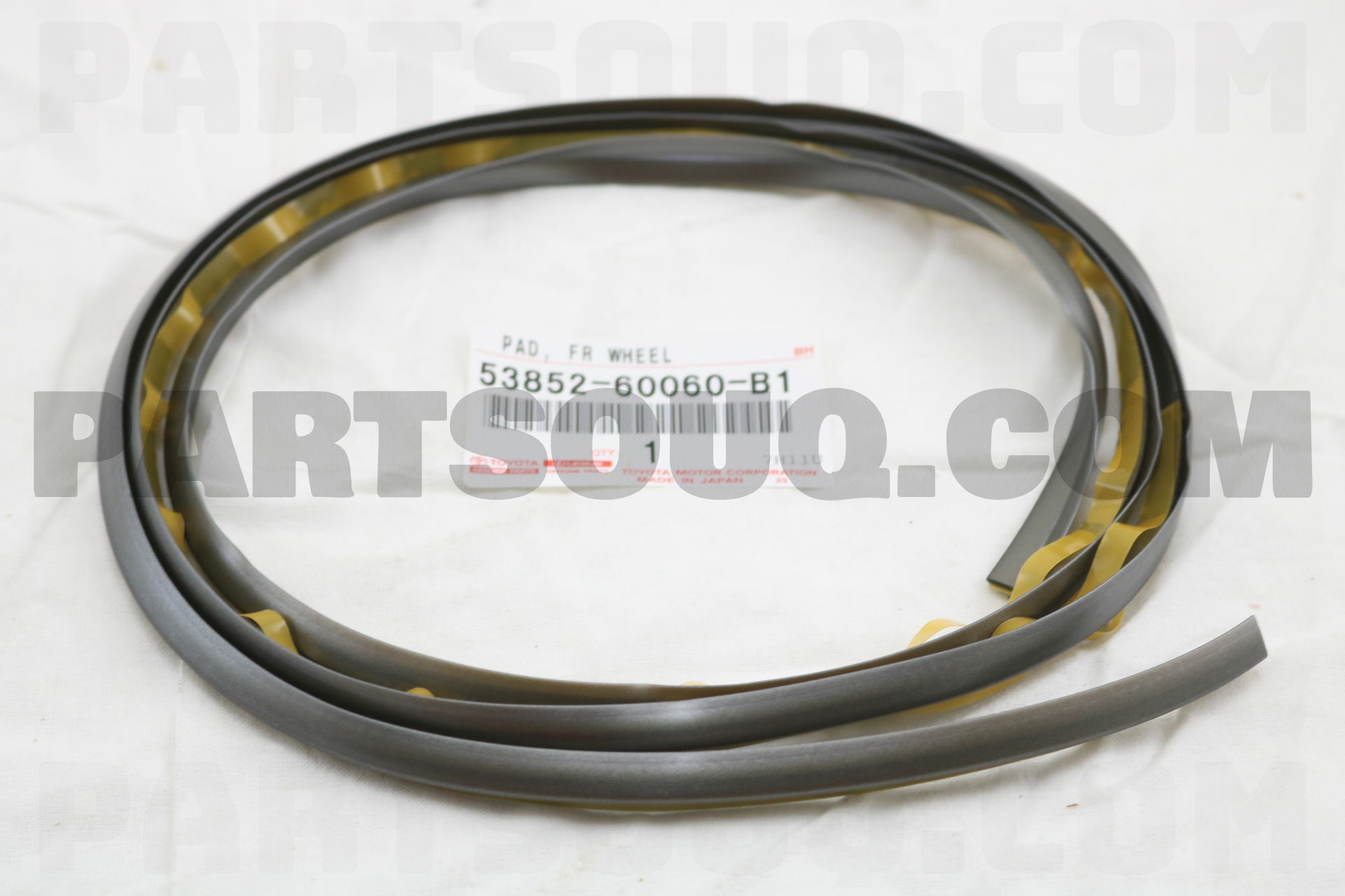

Toyota Parts Deal has beige CE pads. I have no idea how that compares to the beige LX450 pad. I have an LX450 in champagne pearl and needed flare gaskets....I didnt do my homework and ordered and just received an anniversary edition gray (hoping it would be close enough) and the color isnt too far off...its darker than the originals. The shape and length look fine. What IS different is that the adhesive on the fender side only covers part of the pad. The adhesive on the flare side is full length. I can make it work. mtkreitz: where did you find gray pads for your LX?

53852-60060-B1 the 40th Anniversary gray that I ordered.. drivers side front
53852-60040-E0 CE Beige.. drivers side front
You're right. That color does look close...
