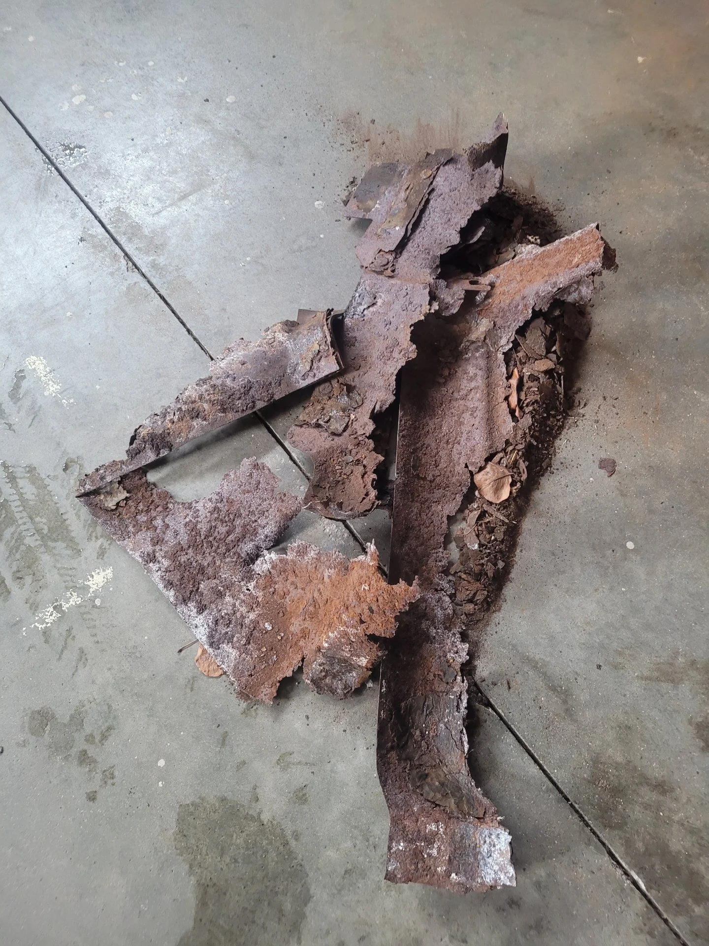

Driver footwell rusted through - All other body areas are good

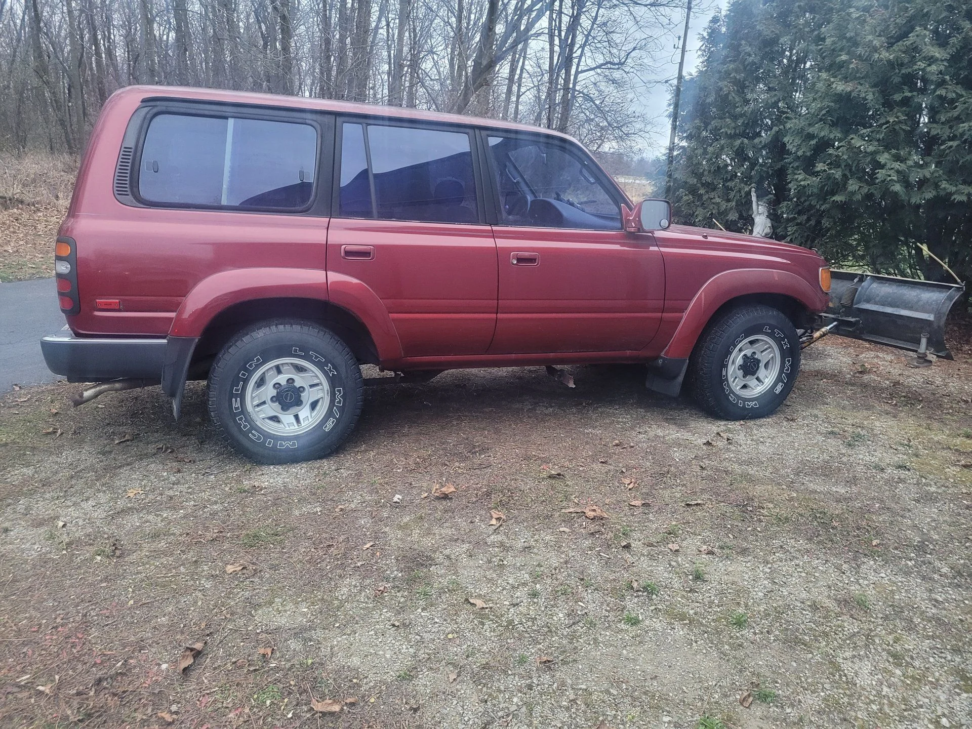

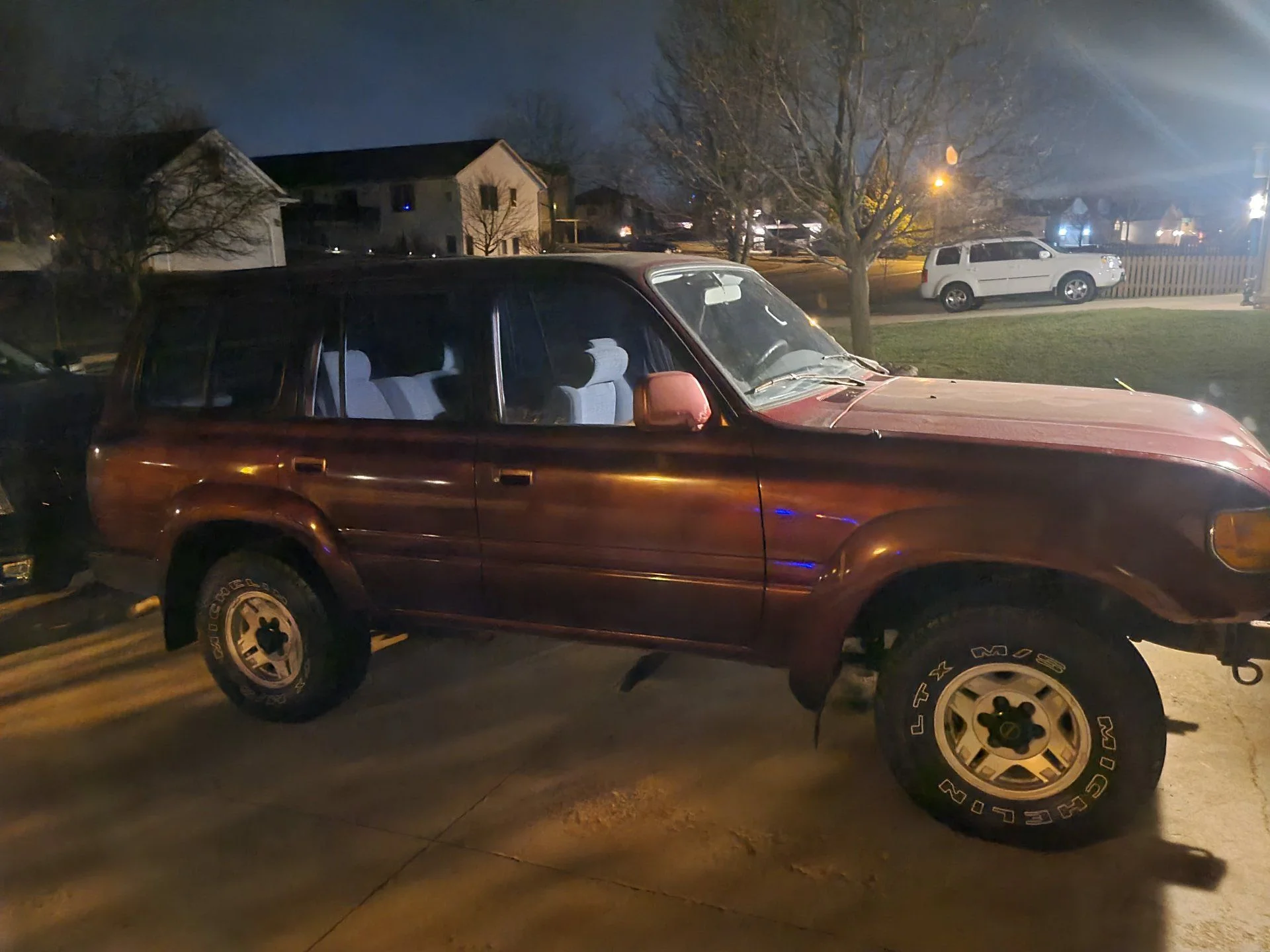

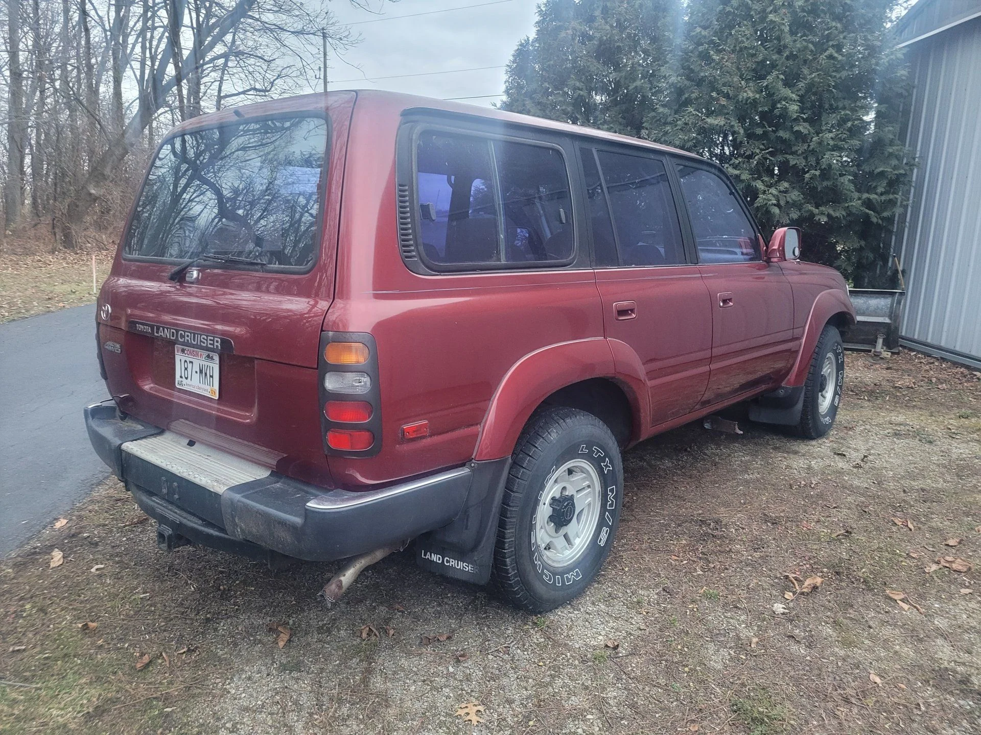

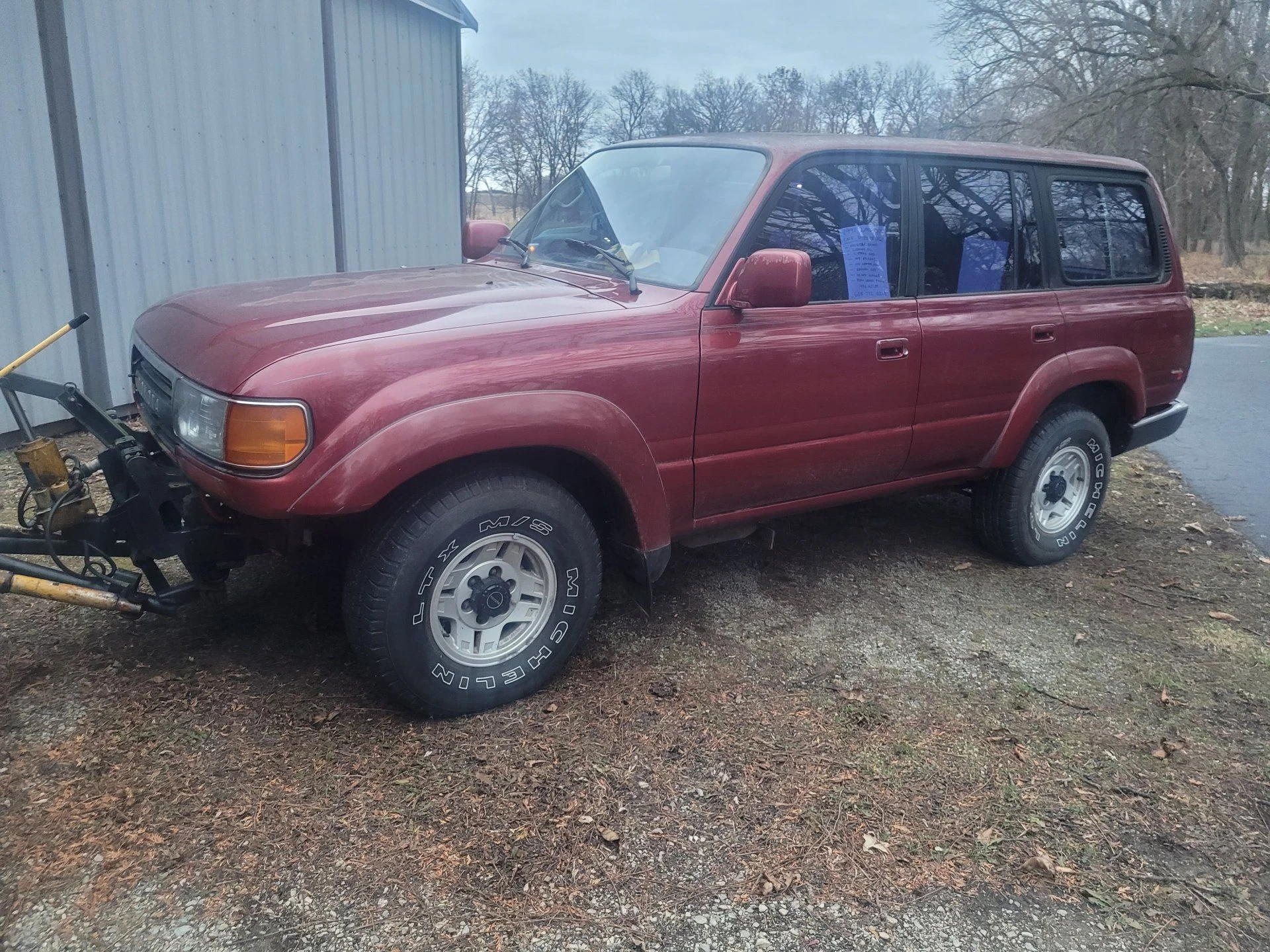

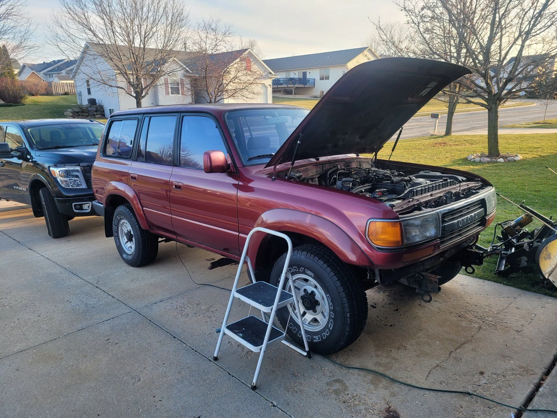

Pictures of when I first took it home.

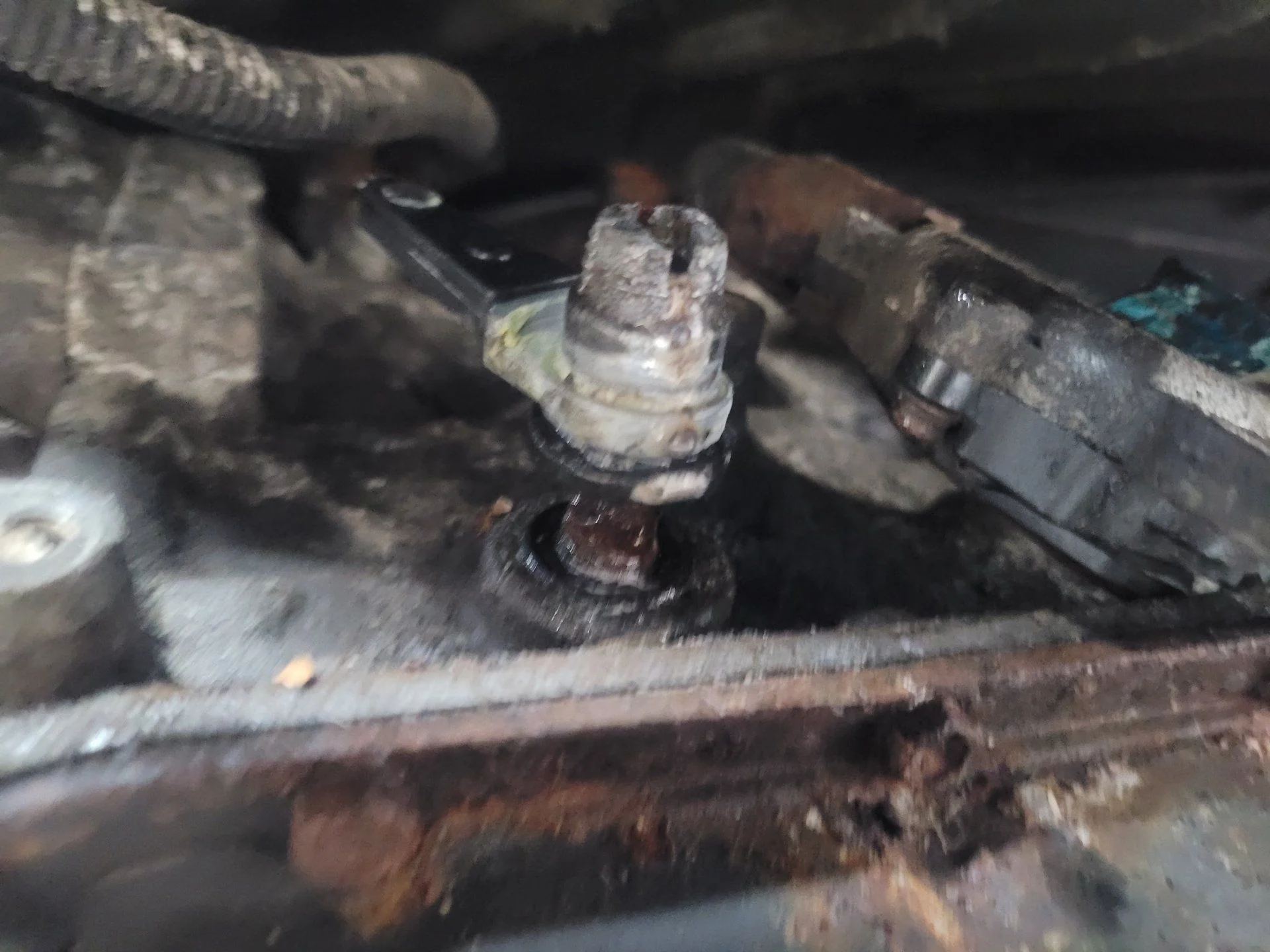

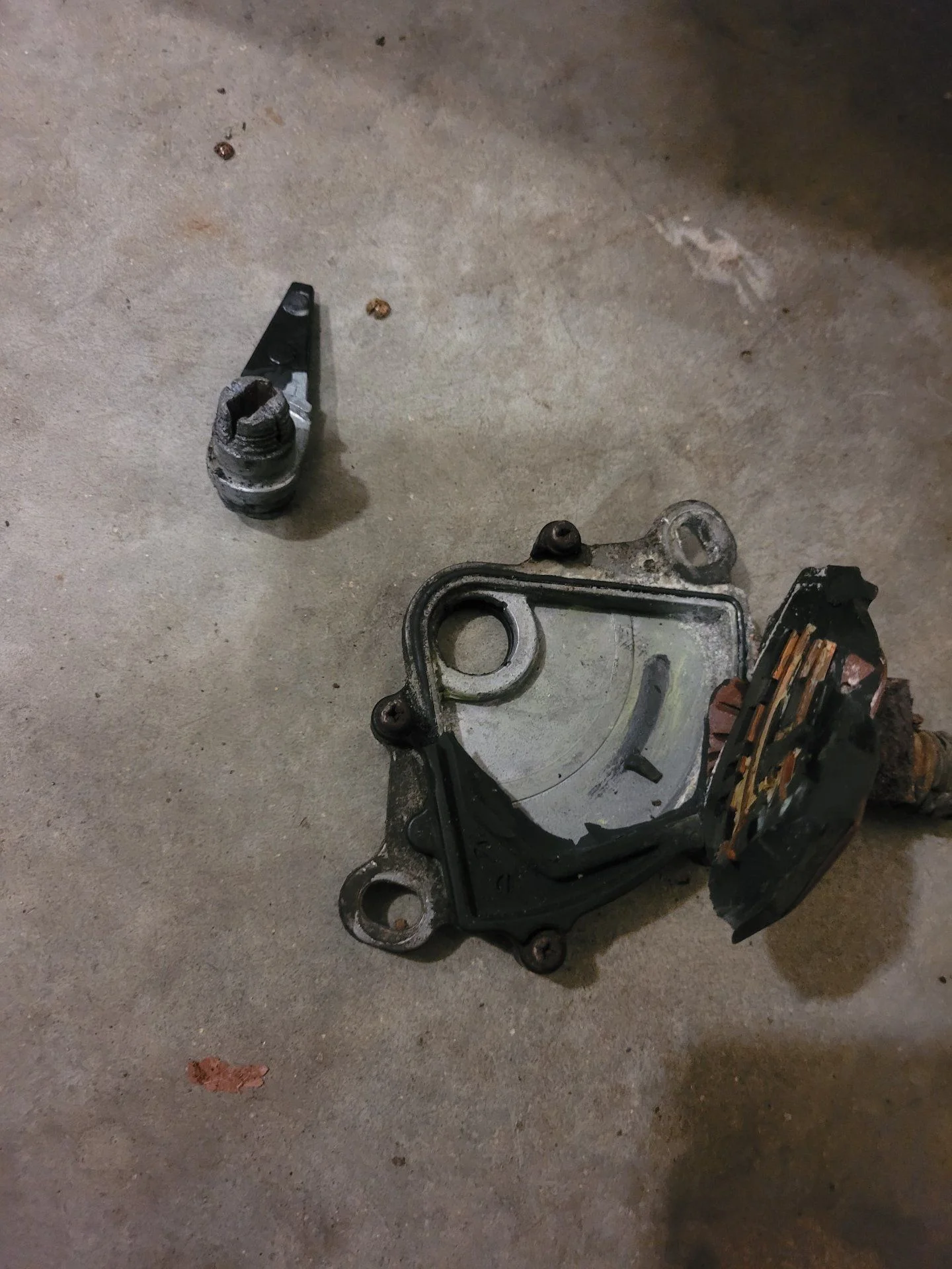

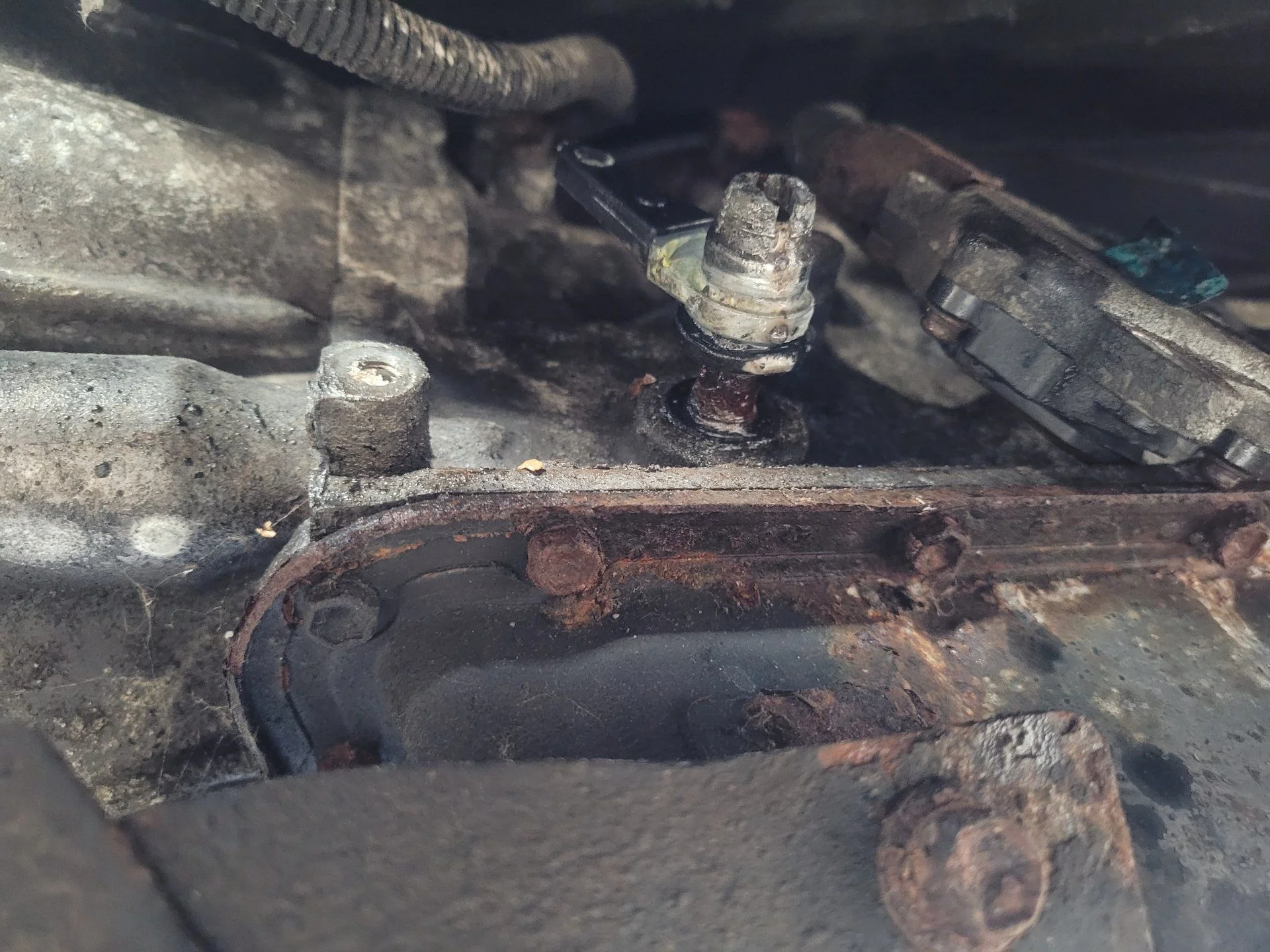

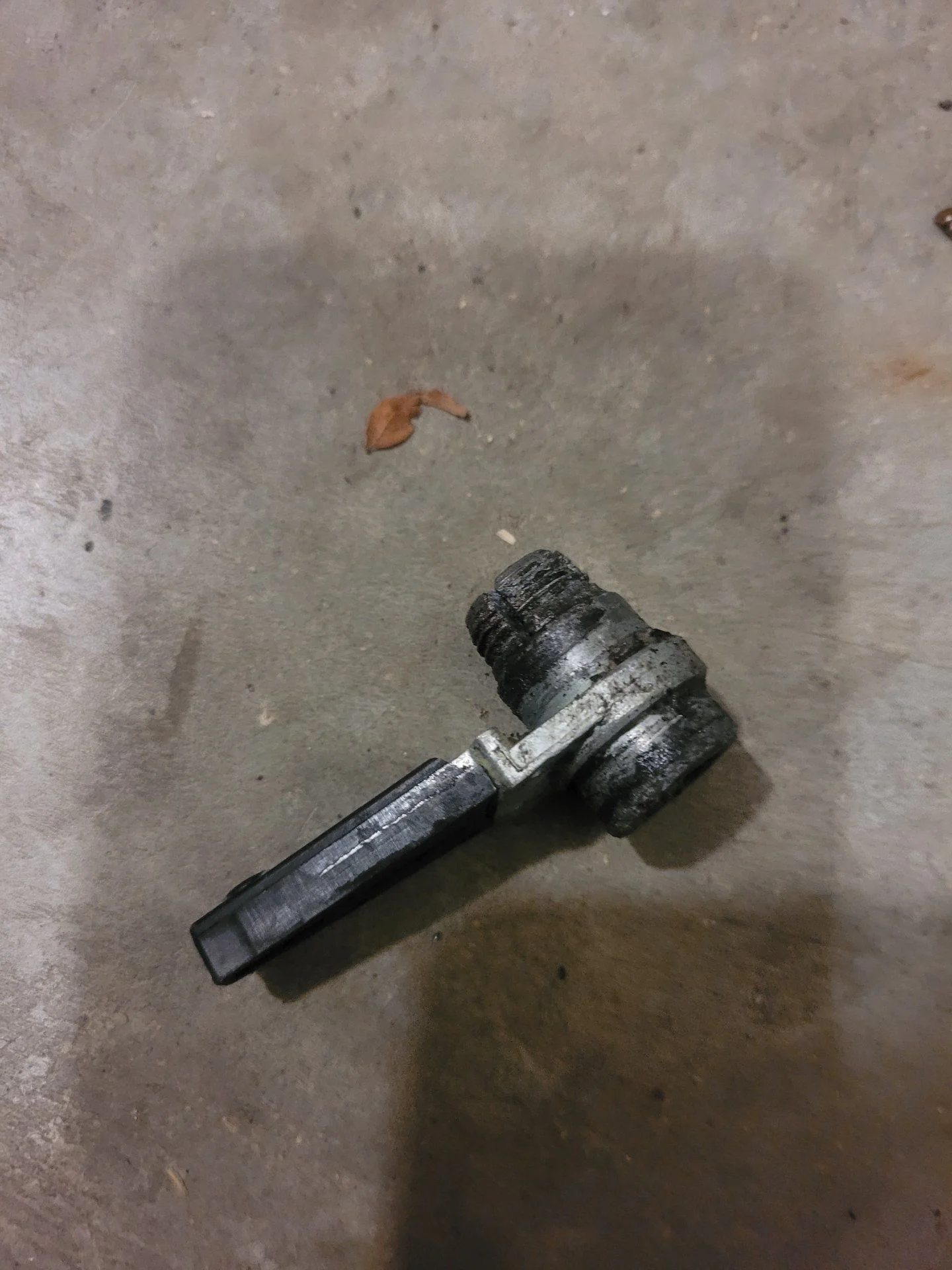

Started in on the P/N safety switch. Thanks MUD for preparing me for the likely event the aluminum barrel would be rust welded to the trans output shaft. I hoped to recondition the P/N switch but that is out of the question now. Ill go in there with a small cut wheel to get it off. I don't want to risk tranny damage. Here is the broken switch and seized barrel.

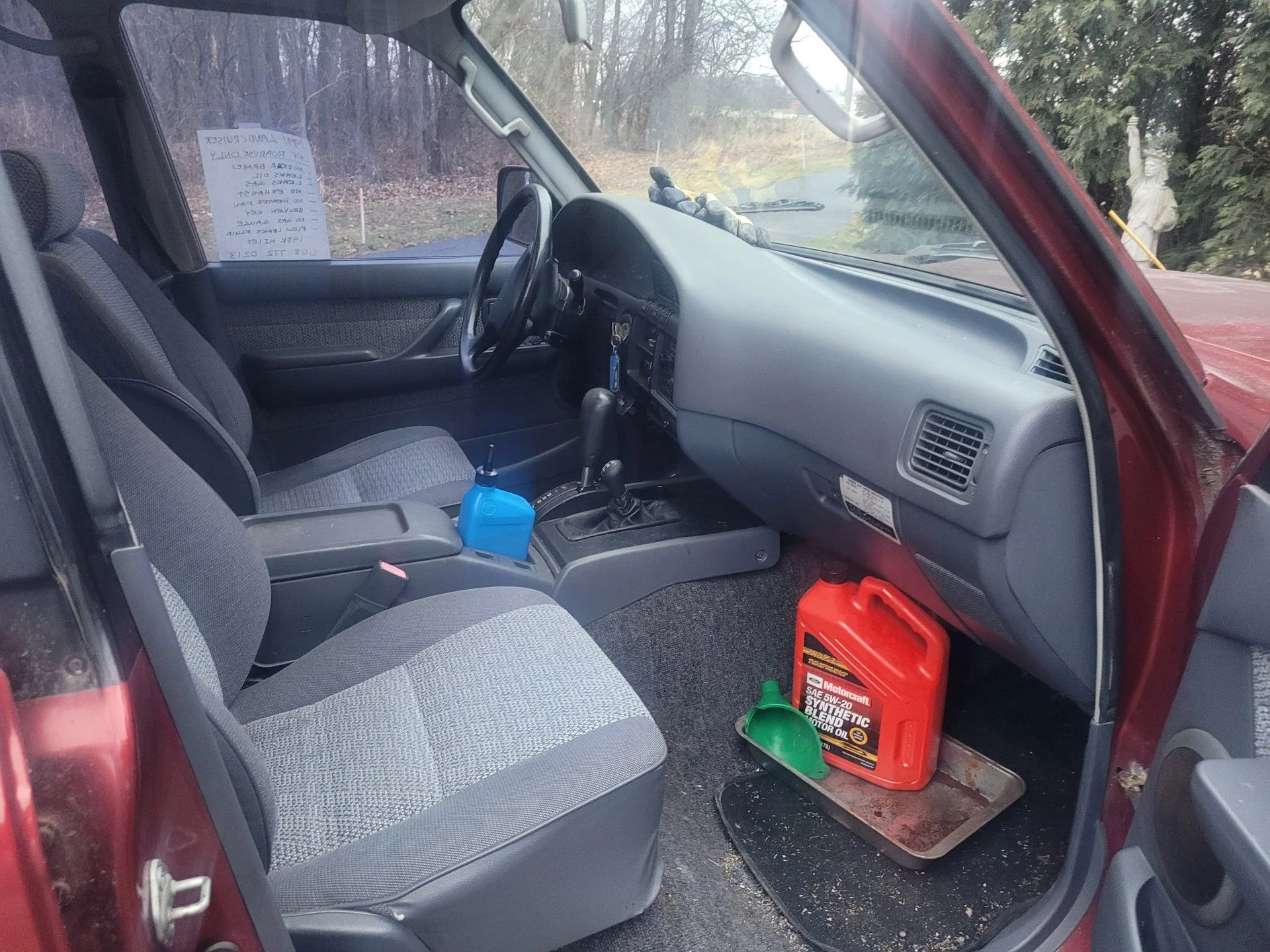

Your front seats look great! Do some stabilization to that hole on the drivers front, so it doesn't spread. Those cloth seats are impossible to find, and highly coveted.

I got the new P/N safety switch in and installed. Works perfectly. I was amazed to see that all it gear indicator lights in the dash still work. I am sure that won't last for long.
On a side note. I tried tapping the barrel that was stuck to the transmission output with a soft hammer to see if that would work before cutting it off. I did get it to break free. It would have been possible to save my old P/N safety switch if I would have taken a bit more time. The transmission shaft is a lot more robust then I thought as well.

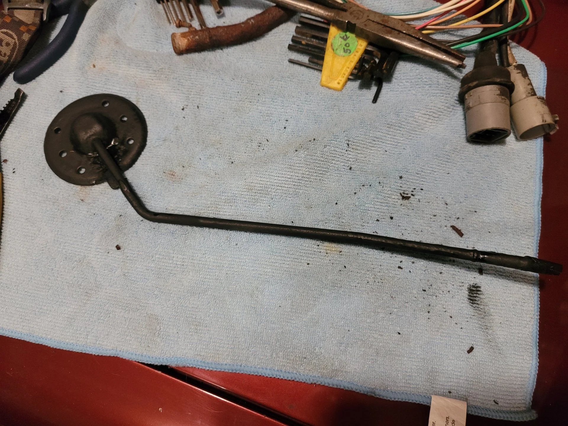

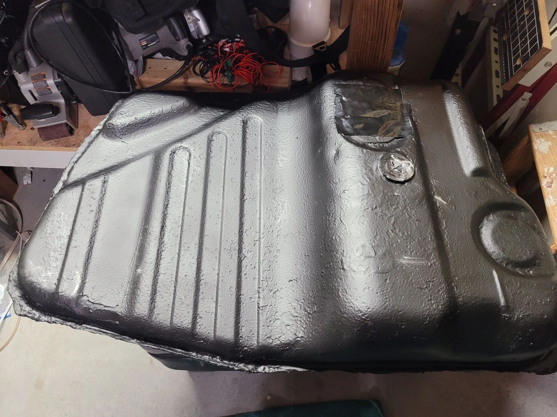

I finished completely stripping down the tank. Sealed up the outside with JB Weld gas tank epoxy. The rubberized the outside. Then did 3 coats of POR15 sealant inside. I'll let it dry for a few weeks while waiting for parts before installing. Should be in good shape.

I was reading your list and expected to see a pile in the photos. But honestly, it looks really nice. Good find, I love it when left to rot Land Cruisers find their way to a loving home where they are brought back to life and saved from the scrap yard. Have you worked out a name / nickname for the ol girl?
Thanks. I feel the same way. Of course we feel completely bias! I think all these land cruises should keep driving up in price so they all become financially worth saving. Until then the more that get saved by people like us MUD members the better.
