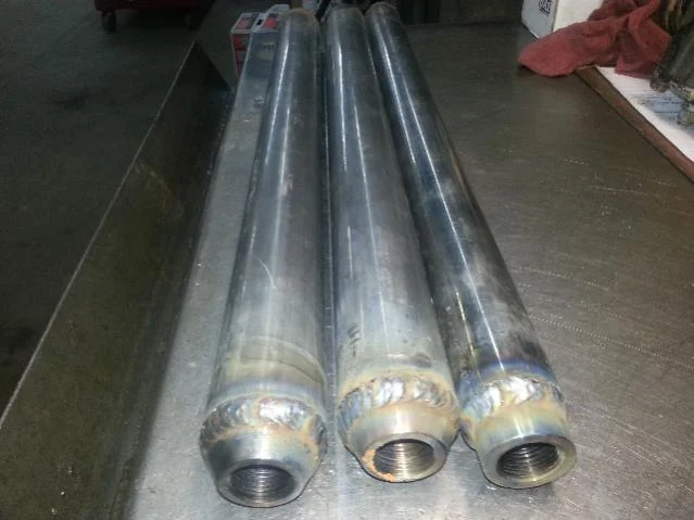

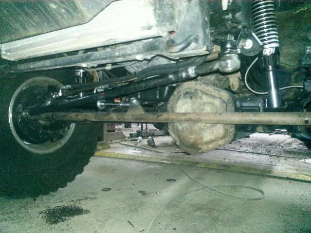

Had a few extra minutes today after work so I got the front lower links all welded together.

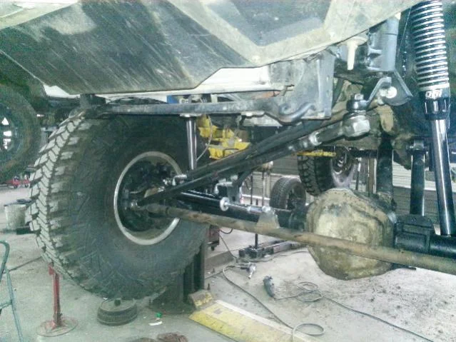

got everything welded on the axle this morning and got it mounted this after noon.
Drove really smooth. Definitely smoother than the rear which Is still stock.

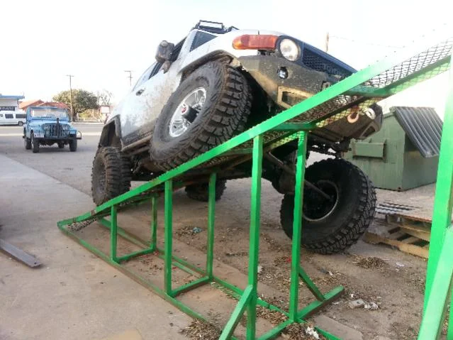

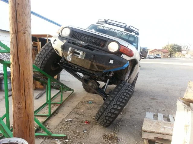

Not sure on what the exact travel will be when In done but the front travels 14 inches straight up and down.

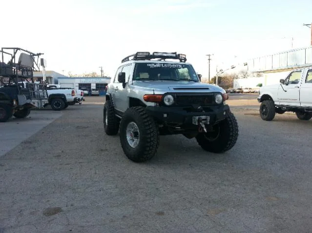

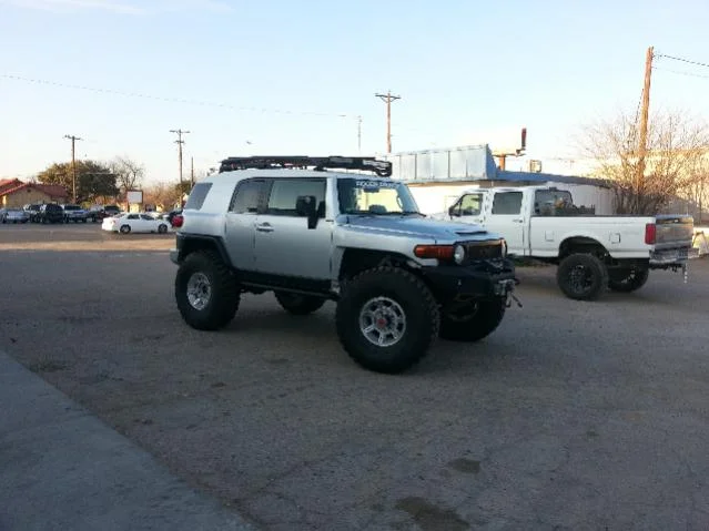

Looks good, nothing rubbing or extremely out of line, well done...
Thanks coach. I build steering systems for a living so I'm glad someone approves.
Tires are going to tuck into the fenders well. Looks like my RedNeck math is going to turn out well on that too.

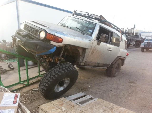

35 inches of travel right now. Should be a lot more after I get the rear axle swapped out.
