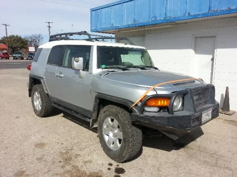

I just picked up an abandoned FJC off of a ranch in west Texas. It's had an extremely hard life and the previous owner let me have it for next to nothing with a promise to give it a good life.
I've built several Toyota's for other people but this will be the first for myself. So feel free to give me some pointers. Criticism with be gladly accepted but please don't be an ass. That's why I'm here and not on pirate.

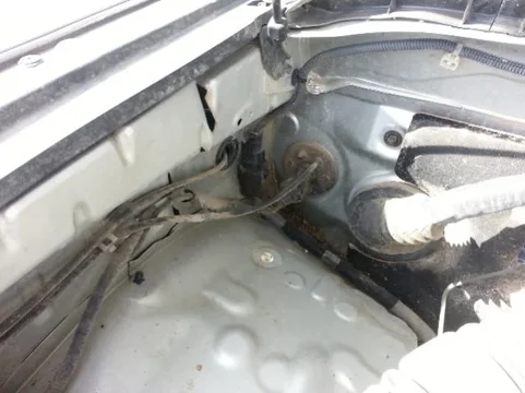

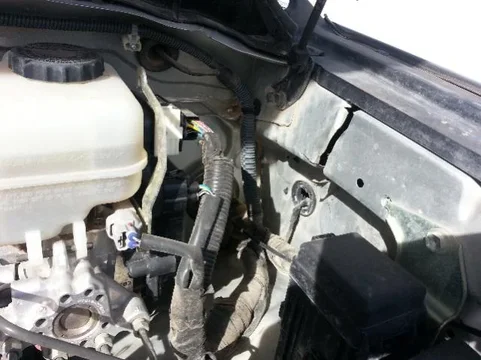

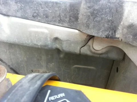

Like the title says this poor thing is beat down. He used it like a one ton truck on a ranch and bashed a lot of brush with it. It has very severe inner fender cracks that run all the way back to the firewall. This resulted in radiator, condenser and grill problems.
Long term goal with it is a high pinion king pin D60 with coil overs but still just a family rig to go to Katemcy or Moab.
Short term I'm going to have the front end fixed and put a 6 inch rough country lift on it so I can make the land cruiser round up.
Pictures to follow soon.

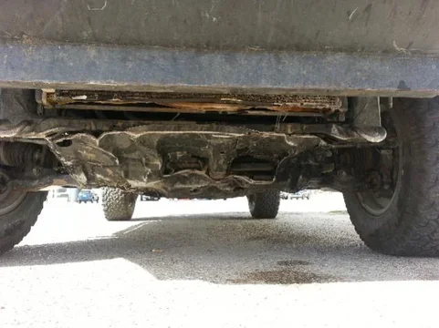

Here she is. Hood latch is ripped completely out so I have to have a ratchet strap to keep the hood off the windshield.
Sounds like a good project truck. I would reconsider the RC 6" lift and consider a 3" instead. Do some research on the 6" lift over on the blue room about them. Several guys ended up removing them and going with a 3" instead.
Looking forward to see what you do with it.
If its short term lift why even bother with a RC? Why not a cheapie used OME or even get used Coilovers- either will end up being much easier to re sell down the road than a 6" kit to get that money back. Or just wheel it as is...it's not like that thing can't take some more abuse before ur rebuild. Looking forward to the end result. I love sas fjc's
Bobby normally I would agree with you but I'm into the 6 for almost nothing. Plus it's a motivator for me to fit 37 inch tires that I have. I know it's alot of wasted labor but again it will get me motivated too.
I did wheel it at the opening weekend of Katemcy and had a blast with it. I am used to doing the hard trails but still got a lot of places that no one thought I could get. I just have to have more clearance before I go back.
D60's front and rear? If you're in the RC for really cheap, I say go for it. Sell it and the good stock parts later on and make some of your money back.
Don't get fooled into thinking you'll fit 37's on the FJC and still be able to drive it.
If you want to throw money away, go with the RC 6" kit. Best advise has been provided above, a solid OME/Ironman/etc kit will allow 35's and still wheel the piss out of it. Drop bracket lift kits do not increase off-road ability in my not so humble opinion.
Yet, do as you wish in the short term. Study other's who have done a solid axle conversion on the FJC, know the issue with wheel sensors and ECU compliance, unless you don't mind driving with "xmas tree lights" on the dash or use tape/cut wires to eliminate them. Also, see Sol's reply to another thread below who had issues with his SAC.
I'd love to find a salvage as well, although I'd be looking at dropping a diesel into it before doing a SAC. Good luck...
Is the inner fender crack issue still a problem on the new FJ's?

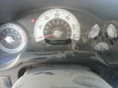

Wow how does a truck get that beat up in only 69,000 miles. Is the guy so rich that he can afford to best the s*** out of the truck?

Zack, my buddy at the dealership is checking to see it there are updates on the inner fender wells as we speak.
This little jewel goes to a local body shop tomorrow for those repairs.

Dropped off at the body shop today for repair in the inner fenders and skirts.
Anyone ever had any luck getting Toyota to pick up the bill on this type of problem?
I don't think that a TSB was ever issued and if any modifications were done, it wasn't covered under any warranty.
A few have successfully battled for, I believe.
You'll wind up needing to cut the fenders with +37s, anyway, possibly extend the outer depending on D60 junkyard find axle width.
May be better to rebuild the inner completely, at the very least, reinforce.
Well I'll find out in the next day or so if they are going to fit the bill. If not I might me rebuilding so I can make them more open.
