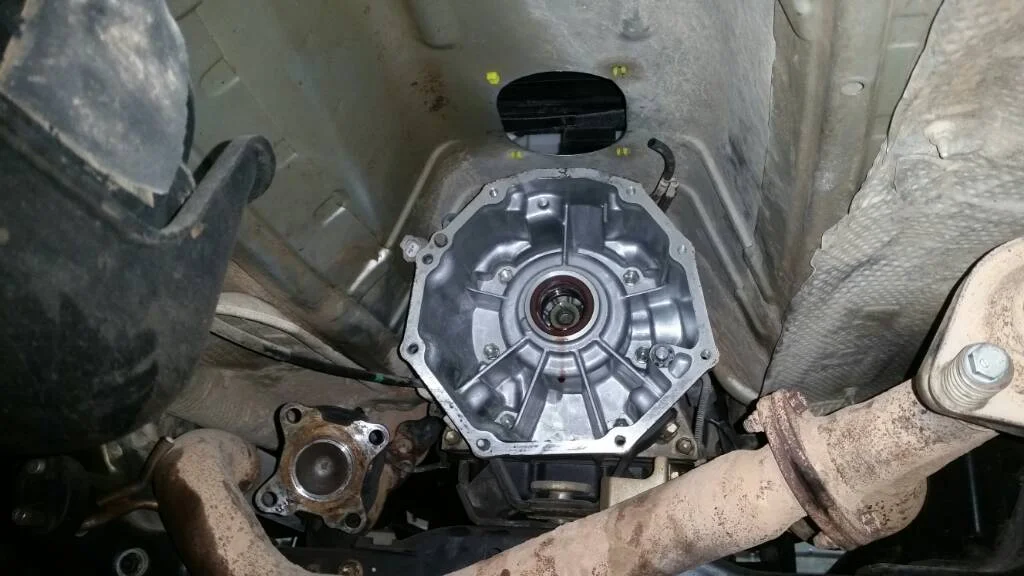

Adapter plate needed, other than that it's supposed to be direct bolt in.
That being said, this will be the first FJ that one has ever been installed in. Sooooo..... fingers crossed.
Yeah definitely let me know how "direct bolt on" it is.....its on my list.
Curious if you can clock it like the Lefty to achieve the tummy tuck? Or does it's shape naturally achieve the clearance above the frame rails?
Well it has begun. Verso here we come
I've asked this before in other threads and no answer....does the Verso clock upward to enable the tummy tuck? Or is it pretty much in the stock position?
I'm sorta surprised they didn't have the shift levers made for the FJ. Do they at least tell you up front that the levers only work on specific Toyota models?
This is the first fj to ever receive a verso t-case. They flat out told me there would be several issues.
They have been very helpful with all my questions and extremely receptive of my input on things that need to be noted or included with the kit.
It's good that you are breaking new ground and helping them sort out any issues. I still say that doing the Inchworm Lefty, then having Budbuilt give me "tummy-tuck" took my FJC to another level. The gear reduction of the Lefty along with the clearance/protection of Budbuilt encouraged me to push it's limits...Great Fun...
Breakover angle is my biggest frustration when wheeling my FJC. Looking forward to the evolution of this product. Price seems very agreeable if the kinks get worked out.
I understand this is the first FJC application for the Verso, but I thought it was designed specifically for this drive train. Just wondering if it wasn't tested on an FJC, what vehicle was it tested on? Surely there was some R&D period before they went to market?
