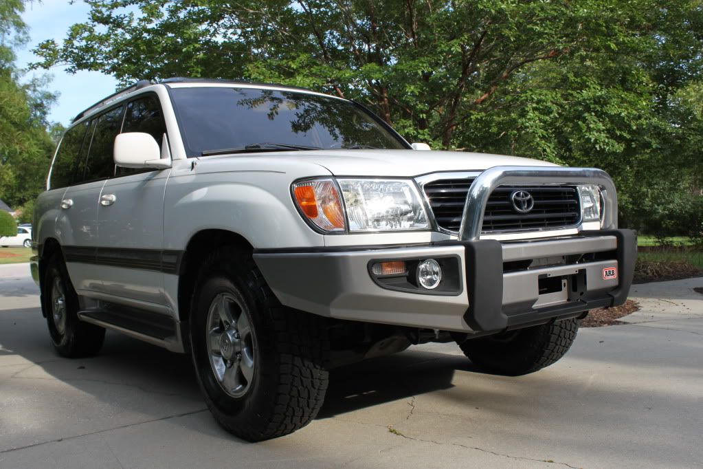

ARB Sahara, OME lift and Titan TW12,000lb. winch with synthetic line arrived today. I took the bumper to the powder coater today but they said they could not powder coat it again since it already is powder coated. So I took it to the body shop to have it painted to match the OEM bumper color. Truck should be pieced together and ready to be picked up in 2 days.
Should this line be spooled on in this direction?
yes you want the line coming from under drum...
Make sure you regularly check and lube the pivot pin on that "safety" hook. They have a tendency to corrode...
just let me install it for you....dont want you to embarrass yourself on here with more questions...LOL
Picked up the Cruiser today from the body shop. Besides them installing the hoop backwards I really am happy with my choice of bumper. It looks great with it being painted.
Looks great! Why didn't you mount the winch before you had the bumper bolted on? Looks like you are a stickler for detail and I know you wouldn't be happy if you got the bumper all scratched up while installing the winch.
