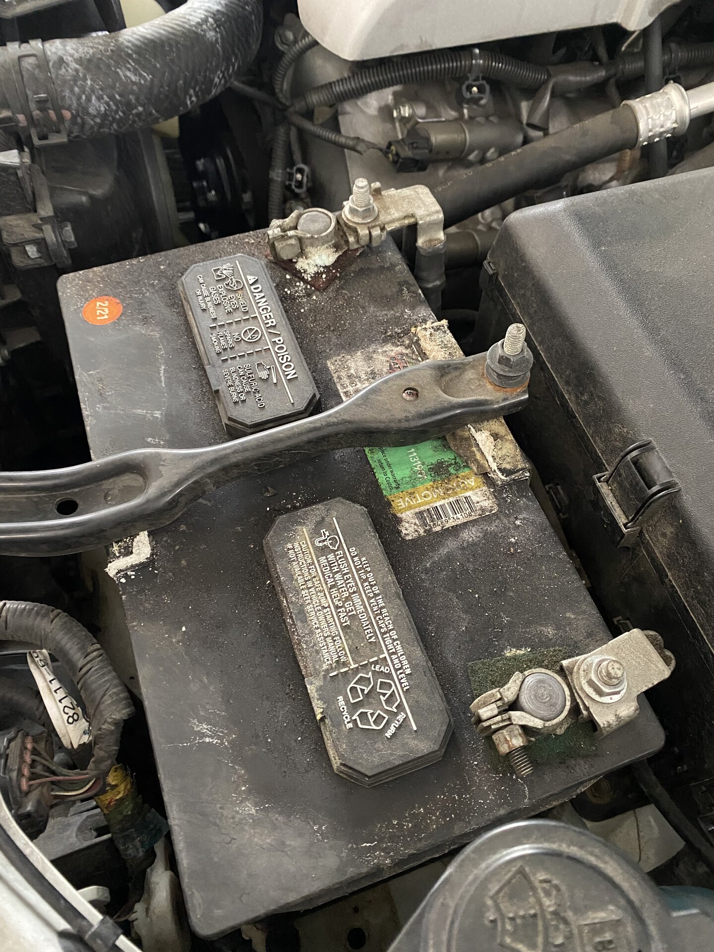

The interstate battery from Costco. Less than 3 years old. Has started leaking. Will replace with another one from Costco. Will clean terminals.
Don't forget to clean your battery tray. Acid kills ;)

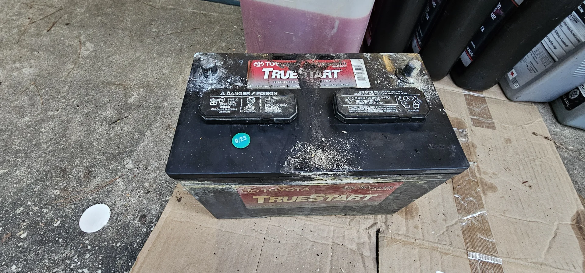

My Toyota Truestart is dying right at 3 years build date of 9/23 and 10/26 now. It had the original in it before that in my 2020 model so it only lasted 3-4 years. I'm going to switch to AGM. I despise the corrosion that comes with Lead Acid units. It bypasses the dielectric grease. I'll just top it weekly to get around the weak output of the OEM alternator

Is your rig a daily driver or does it sit a lot?
A healthy lead acid generally will not vent and corrode. When it does, it's usually indicative of overcharging, or more likely, sulfation due to sitting at lower states of charge.
You can put a float charger on the lead acid just the same to prevent the later.
Another option is a lead-acid with sealed characteristics of an AGM. Charge profile compatible with the electrical system as designed, but with AGM like qualities.
Daily driver with 50+ miles/day. I know it's not getting overcharged. I know about the diode fix to trick the alternator to charge an AGM but believe that it does not work for a 2020 and a year or two earlier. This is the only lead acid battery I have had to deal with for about 20 years and I dislike it. I much prefer AGM. I see the new solid state batteries but they are too new and I do not wish to worry about burning my truck to the ground being a beta tester.
It may be a truestart thing because mine did the same. Now running an Interstate MTP without the issue.

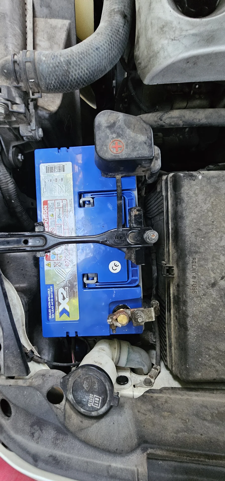

Going to pick up the X2 local. I have one in our Lexus and it's been fine for a few years. The Odyssey's are not as easily available. $424 for the X2 Group 27F after core and 15% discount buying online at Batteries Plus. In Dec of 2023 the Group 34 in the Lexus was $348 total at Batteries Plus.
Had to brush and use some vinegar to clean up the mount and terminals. Coated raw metal parts with dielectric grease.
Good looking battery for sure. I had one in my old truck I tried to get warranty coverage a little under 3 years in. BATteRiEs pLuS bUlbS wanted to hold it for 3 days to let me know if they’d replace it. I went next door to aap/az/whatever after letting management know that was unacceptable in no uncertain terms. I hope your experience is better than mine.
