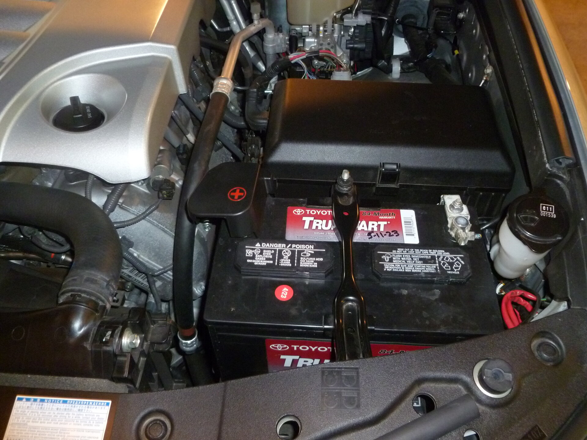

Replaced OEM Panasonic (2015 LC) after 8 years with this in May/23. CCA 710. Test frequently & satisfied with it's results. Good warranty from Toyota.

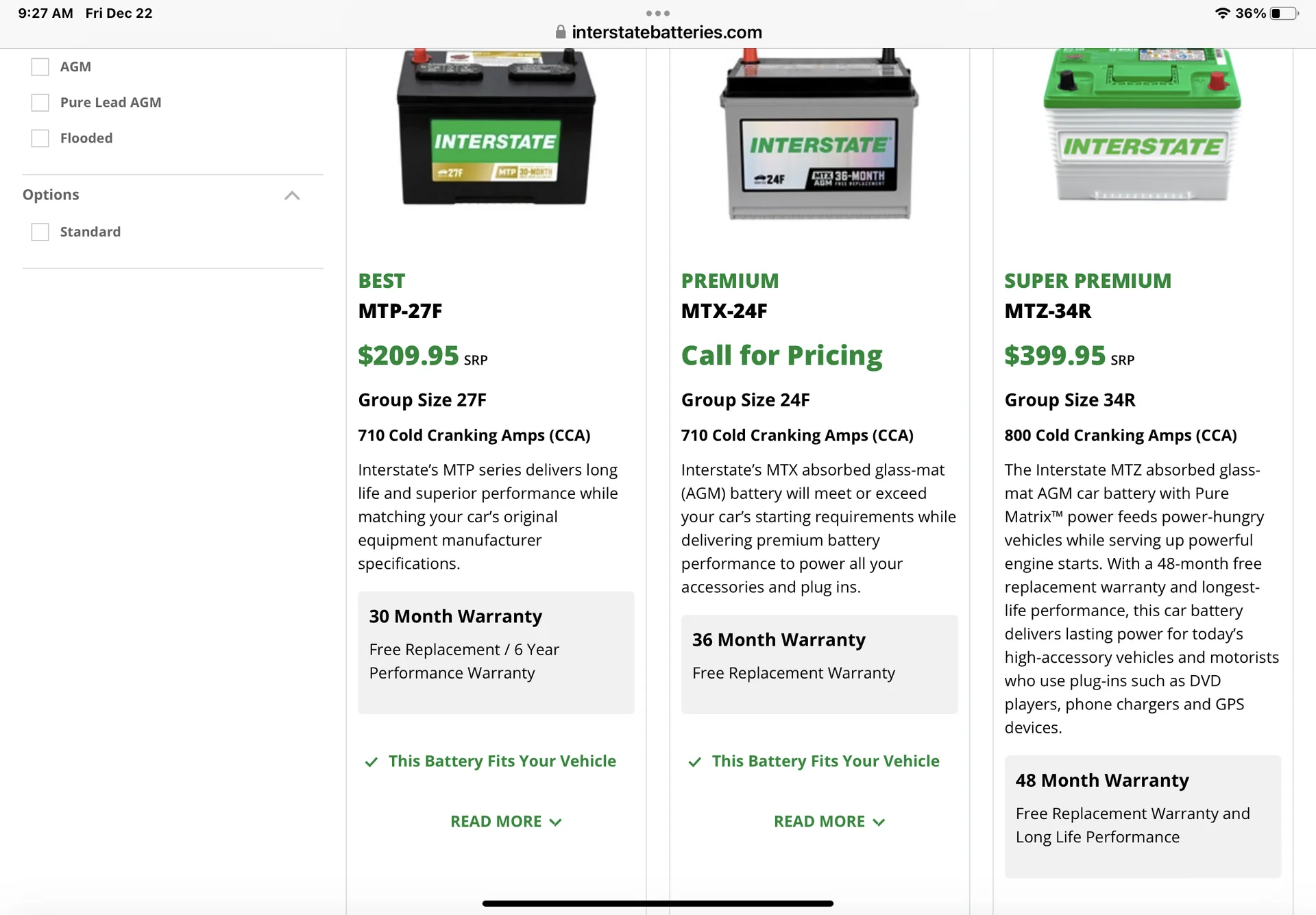

I was reading that they are made by Interstate - I looked at Interstates offerings to see which one compares (to the truestart) and the pricing. The comparable Interstate batteries only have 30, 36 or 48 month warranties.
