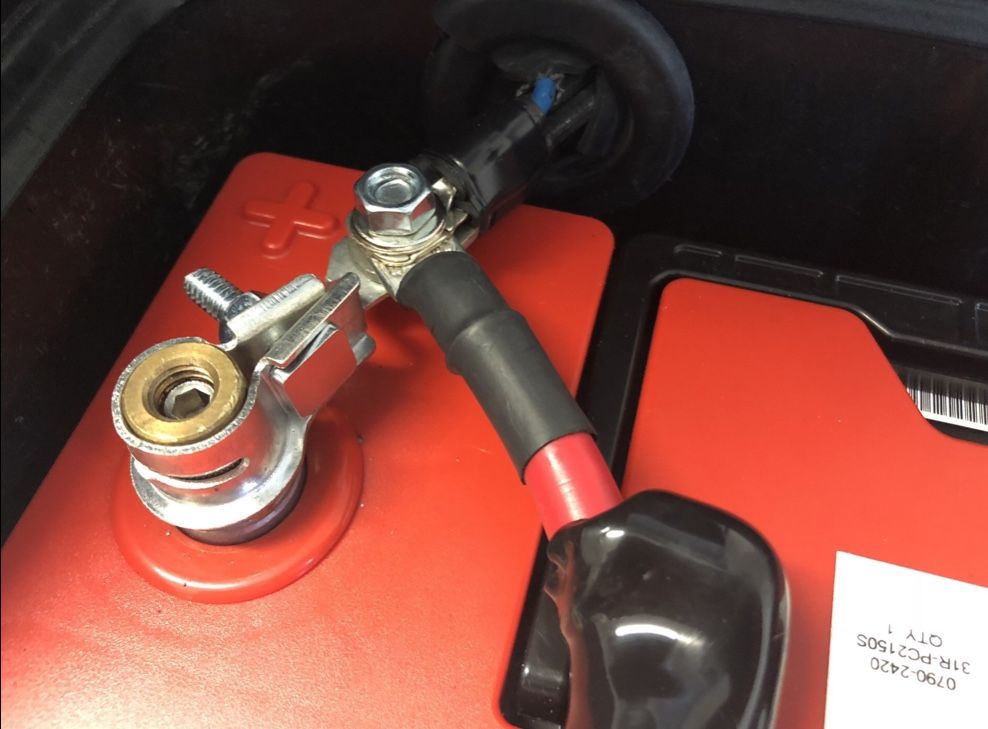

It should clear fine with the terminals oriented correctly. Here’s a few different ways I’ve had mine set up. 31R PC-2150S. The extension connector on the positive terminal is available from NAPA for around $6. @LandCruiserPhil also sells an extension kit.

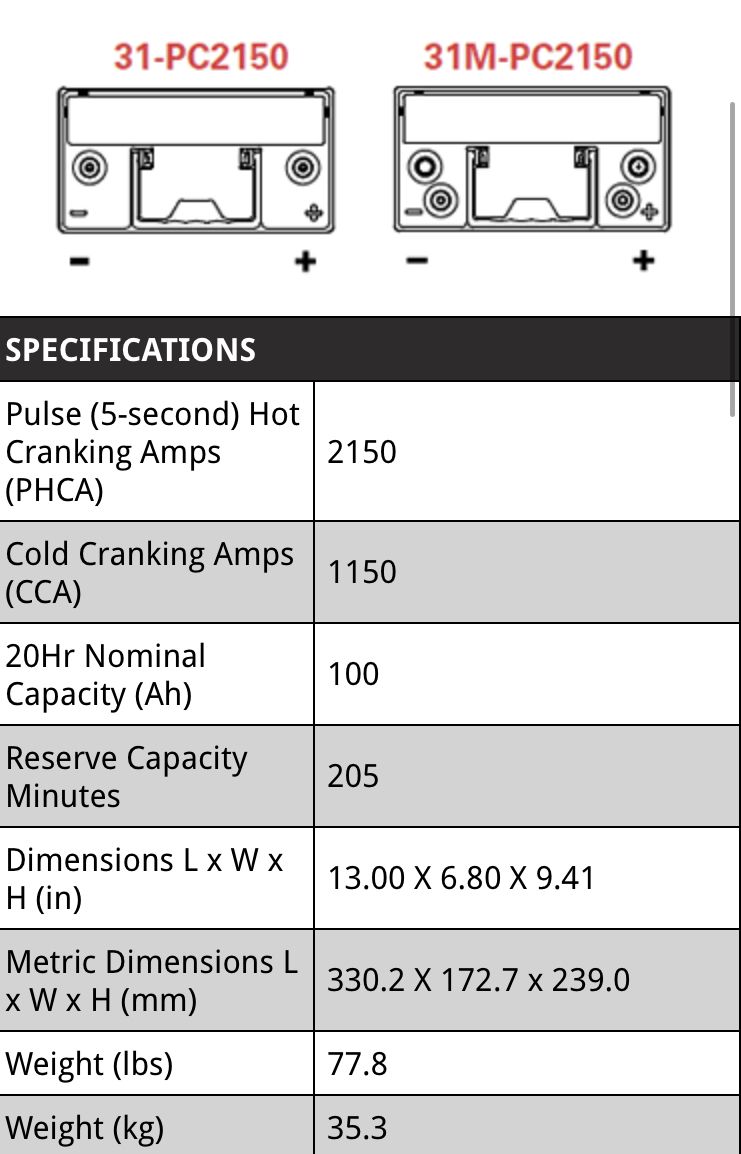

What are the specs on that battery? Did I read correctly that it has 100Ah reserve? That's really good but also probably really really heavy.
Roughly 25 lbs heavier than a group 27. Lighter than having dual batteries. It’s overkill unless you’re using it as an alternative to dual batteries. My 80 would be super fast with a lighter battery.
