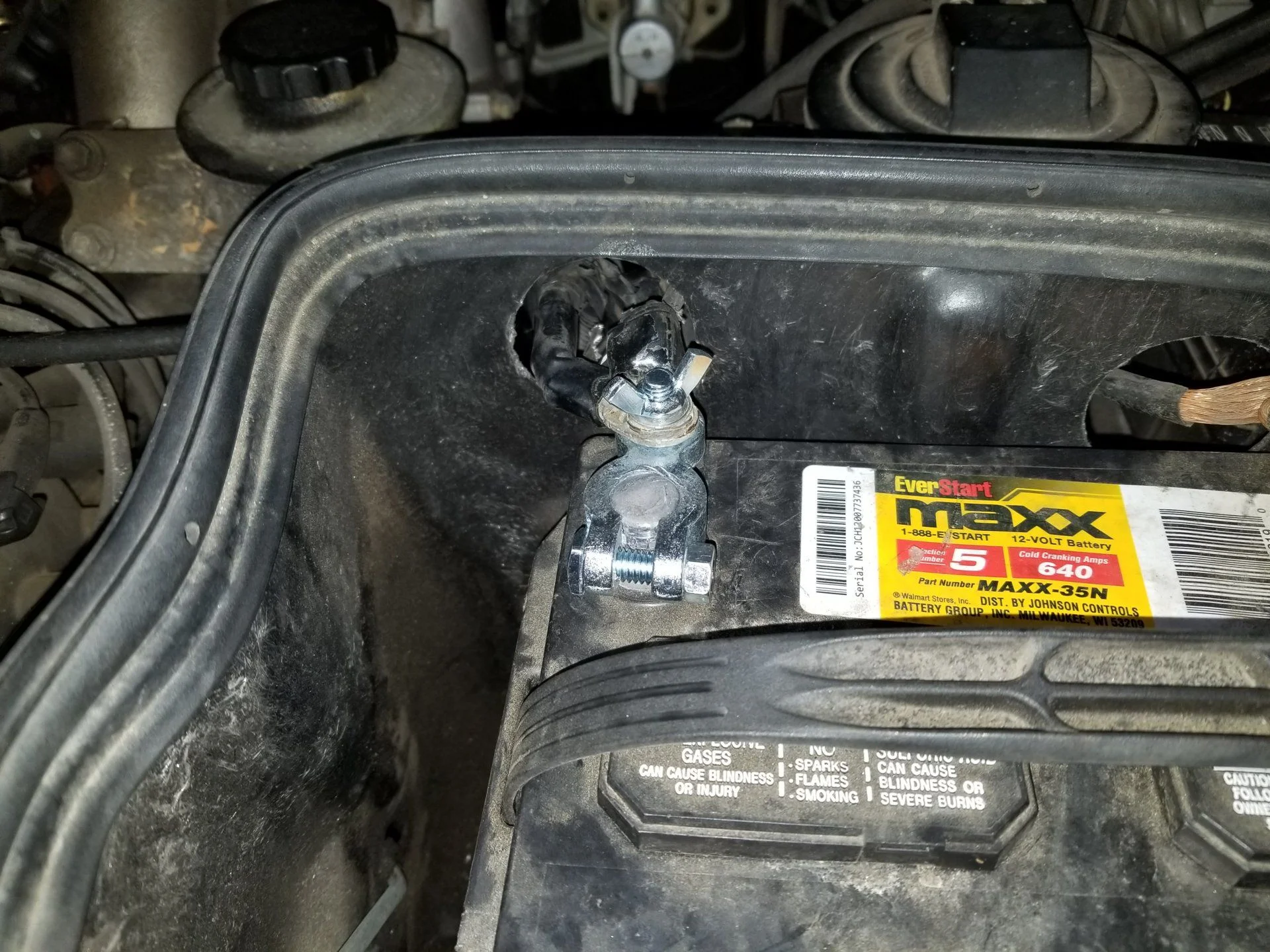

I have four sets of these Ancor terminals on various batteries. I like using the terminal wingnuts for easy batt cable connections/disconnections by hand. These are high quality terminals, but semi-pricey. I use the tinned brass ones (I avoid lead where I can). Ancor makes decent stuff. I am putting another set of these terminals on the batt in my new trailer this week.

I run a single homemade Ancor cable to the positive terminal of the batt hooked up to a Blue Sea buss bar (second pic above) mounted on the backside of the black plastic battery box. The buss bar is then the batt connection for all OEM cables and AM accessories, including a few Blue Sea fuse panels scattered around the 80. This keeps the battery clean of the myriad cables to would otherwise be connected to the batt terminal.
I did the exact same as @mct75 posted. Didi it on my 96 LC and on our son's 70 GMC K2500.

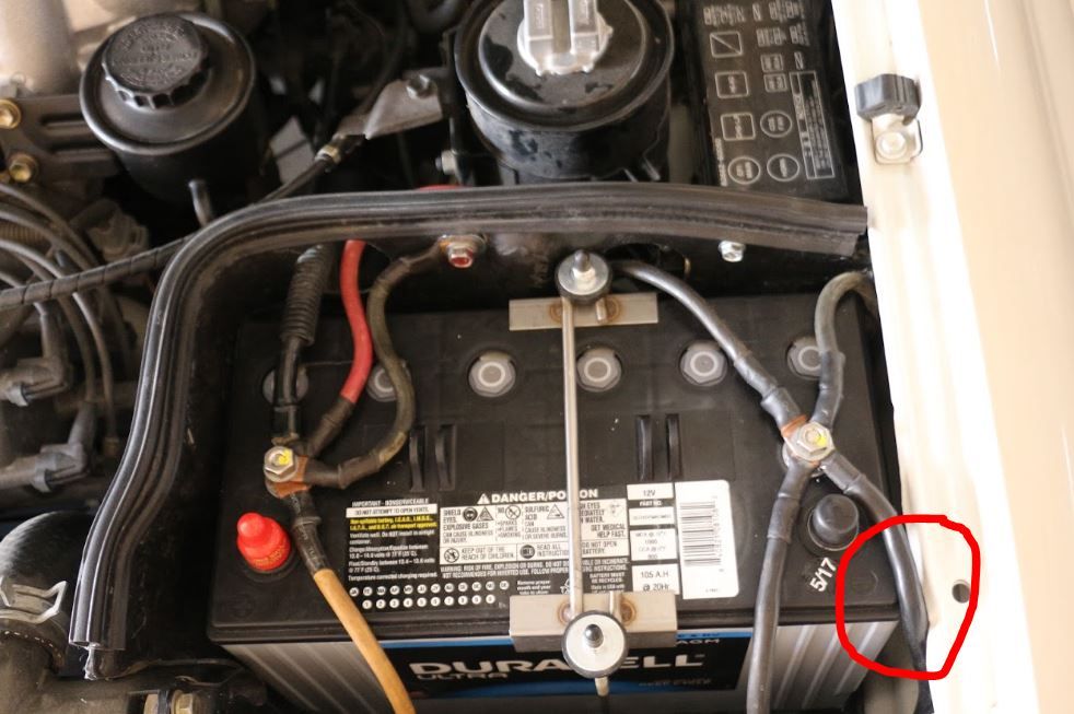

Its an additional #4 ground that terminates at the frame and not compromised, no worries.;)
But still, makes me question your commitment to Sparkle Motion perfection.

FWIW, I use the OEM positive side battery terminal on both the positive and negative side. For my spare battery I use the bolts like LCP has. When I upgrade to two Group 31s I'm going to steal LCP's idea on both. Just makes sense.
I cant put my finger on it....but doesn't look quite like my battery. What is this magical sorcery called?
All marine spec batteries have the extra threaded stud...
