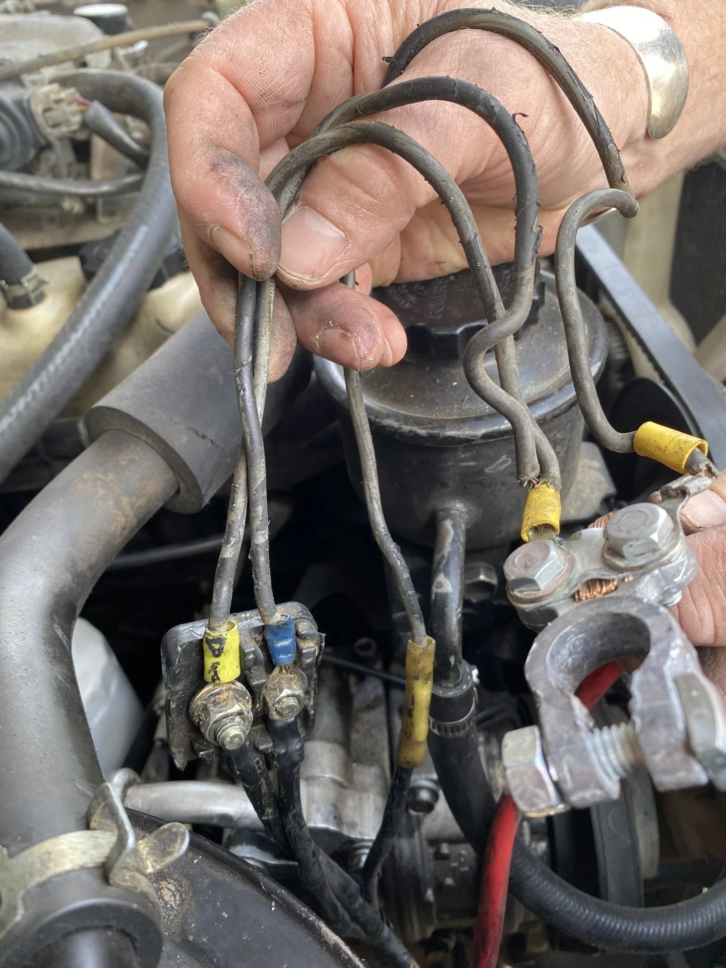

I found the fusible link, but how do I check it for continuity

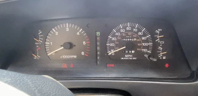

Video of trying to start the car + picture of the dash

Just looked at the fusible link more— I can’t figure out how to test for continuity, but all that wiring is bad so I want to replace it anyway.

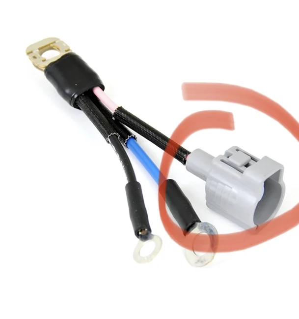

Where is the connection that I circled in red?

All the wiring in your picture (post above this one) is Previous Owner garbage.
The red circle is FL Main fusible link that feeds many critical bits. The alternator also is in that circuit.
I'd be cleaning up the wiring mess to try and bring it back to stock. Those crimps are obnoxious.

I second that it's the alternator. Replace the brushes and replace the fusible link and the little black box it connects into, under $40 for parts, done.
You can replace the brushes without taking the alternator out by removing the cover only on the back of the alternator. Clean up the PO's wiring mess and you should be good.

Ok. When I re-wire it I’ll try to add the connector back in

Does anyone know what that connector is called so I can add the other side of it back into my wiring
(edit: I found it)
