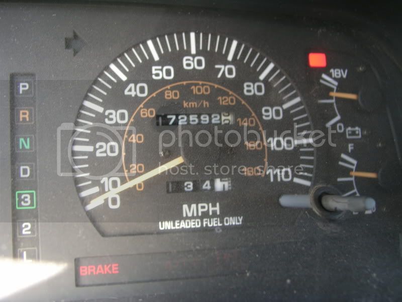

I've been having a curious, intermittent issue concerning my Battery Discharge Light, Emergency Brake Light, and AT Oil Temp Light.
On several different occassions, all three have been on, under different conditions.
First, and most frequent is when the vehicle is cold from sitting overnight, or has been started and only run for a short time. All three lights appear, and as soon as I put it in drive, and start to roll about a dozen feet, they go off.
Second time, on my trip back from MX, they came on while waiting at the Nogales border crossing, and stayed on through multiple starts and stops, but as soon as I was on the open road, they went off.
The e-brake is never on when this occurs, I've even tried cycling it. The battery level is fine, and the transmission is fine too.
What gives? Performance isnt affected, and no weird behaviors happen when they go on or off.
Loose connection?
Bad ground?
What?

That's the standard "low-voltage" warning combo. Usually means your alt's on the way out.
Only thing surprising to me is that your voltage gauge doesn't look especially low in that pic. Is that where it usually sits, or is it indeed lower than normal when the "christmas tree" lights are on?
