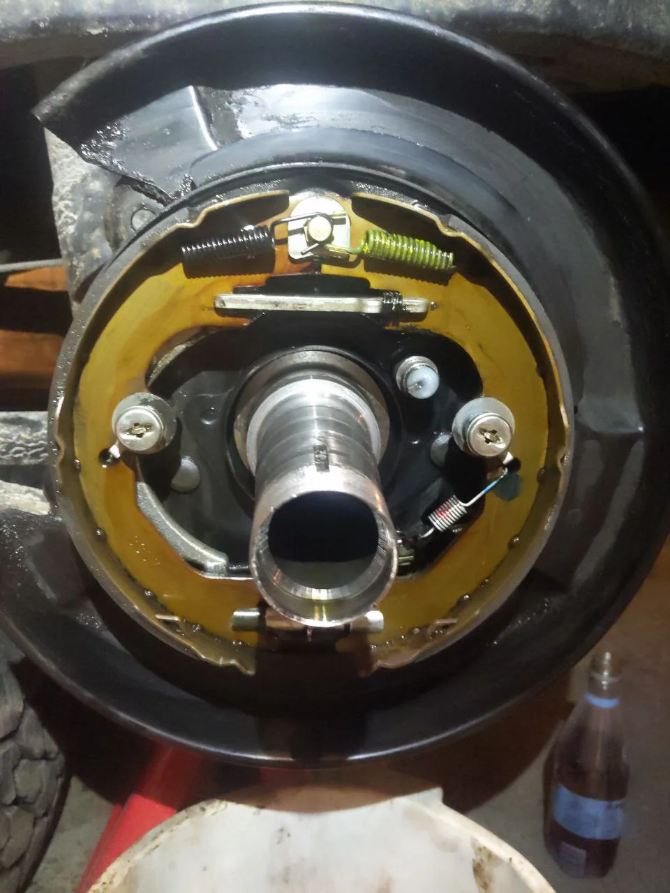

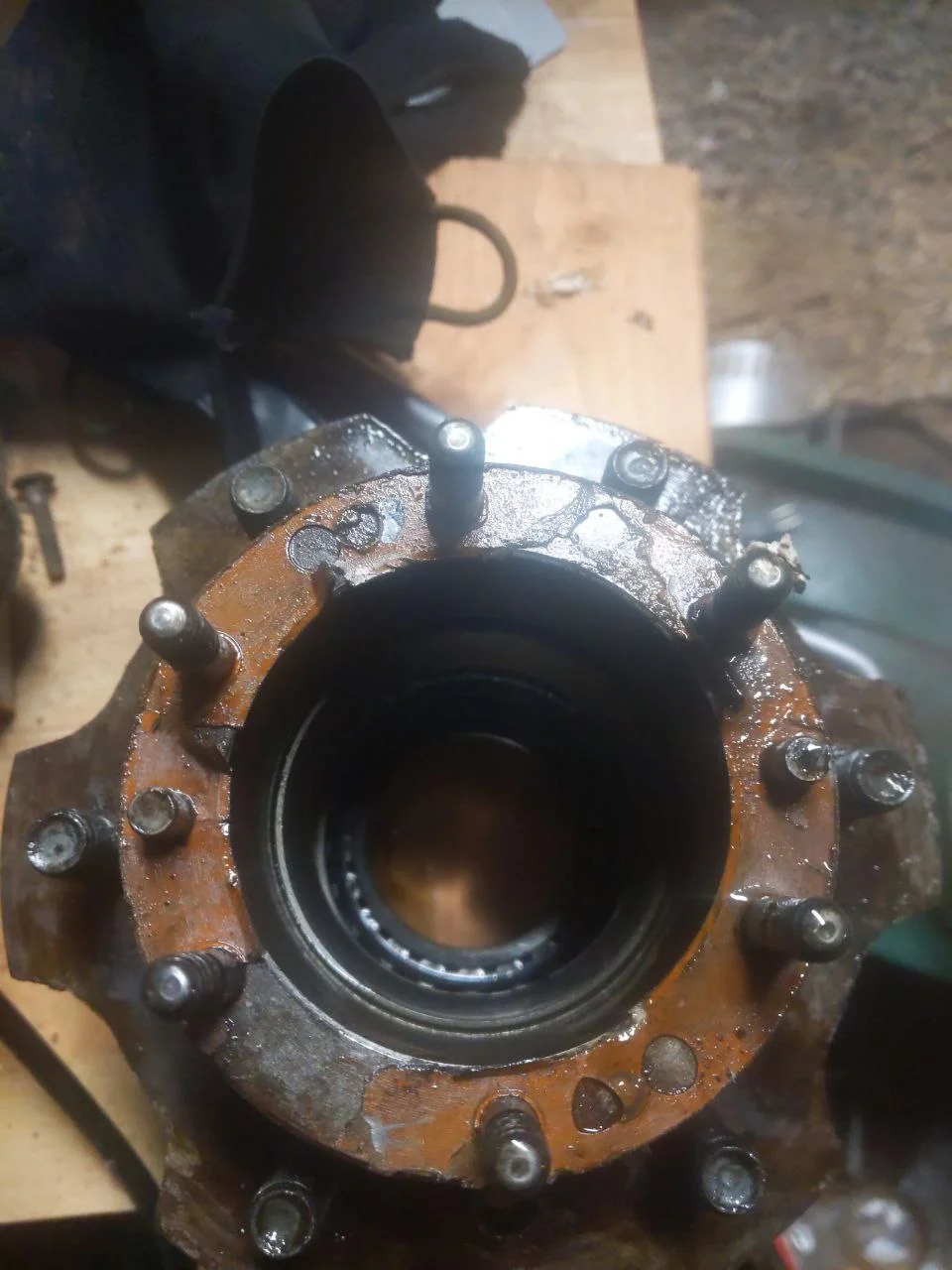

The rear left disc protector was covered in grease, so I was worried that it may have been leaking. I don't want to coat my new pads and old emergency brake shoes.
I tore into it, and it looks like it's been converted to an oil bath. Which I'm fine with and seems fairly common place. From what I can tell, the bearings are good. There's some wear patterns on various parts that I don't quite understand. The wheel bearings feel very smooth with a tiny, tiny amount of play, so I figure it should be tightened a hair.
What I now suspect is that the grease leak on the disc protector was never cleaned up, but that it's old and not current. It also looks like RTV sealant was used generously, even in the cones! Is that correct? I thought the cones should be completely dry, even on an oil bath setup.
Would appreciate it if someone could review the photos and see if this seems correct, or if I need to take care of anything else.

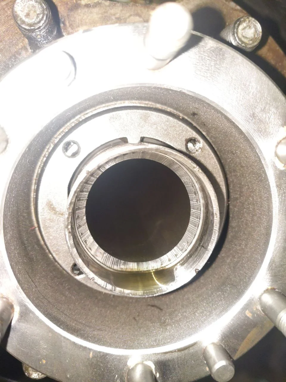

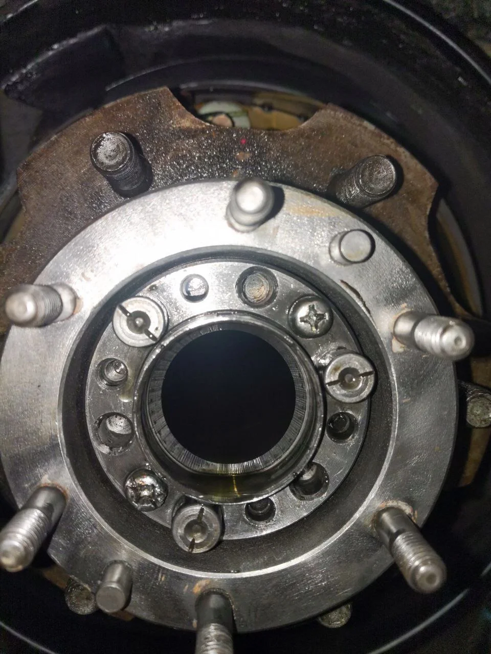

From what I can tell, the differential was correctly overfilled for oil bath wheel bearings. Is the use of RTV on the cone washers correct? Does it look like whatever leak it had before has stopped? Or is it possible something else is leaking, causing the grease / dirt build up? The rear right side is much cleaner. There are some signs of RTV on the rear right, but I have not yet torn into it.
How bad are the spots where the seals have worn the surface? Is there anything, other than snug up the wheel bearings, that I should do while I'm in here?
@ozarkmud, your outer seal, and the gasket, needs to be replaced. RTV is not correct.
I assume you're planning to drain and refill the differential, since you've lost gear oil through the bearing seal(s). It's always a good idea to remove the fill plug BEFORE the drain plug. I like the OEM replacement hex socket plugs over the (original) OEM hex head plugs. Both are available at the dealership, or from Absolute Wit's End. I haven't tried them (yet), but rumor has it the differential oil bags are the cat's meow.
While you will find no end to the number of people who say that oiled rear bearings (as opposed to greased ones) are fine, what you have in your hands is why I don't like this setup (and why I suppose Toyota didn't either). It's fine, as long as the outer seals are intact, but you only have one seal in that setup, and if it fails, you lose differential oil and open the system to contamination.
It's probably a good idea to replace both the cone washers and lock washers, along with the nuts, if they're rounded off. You need them to be there and function properly, and they're springs which relax with age. All three are available at the dealership, or from Absolute Wit's End.
You need to completely remove the hub and clean it anyway, so my (personal) recommendation would be to reinstall the inner seal when you reassemble it. I'd also use some crocus cloth on those nasty journals. They should be shiny. The crocus cloth is fairly slow at removing material, so there's little danger of removing too much material and preventing the seal(s) from sealing. I get mine from Lincoln; one roll will probably last a lifetime, unless you're MIG welding, then it won't.
Regardless of what you decide to do when reassembling it, note the orientation of the outer seal when you remove it, if it's installed backwards, it'll leak.

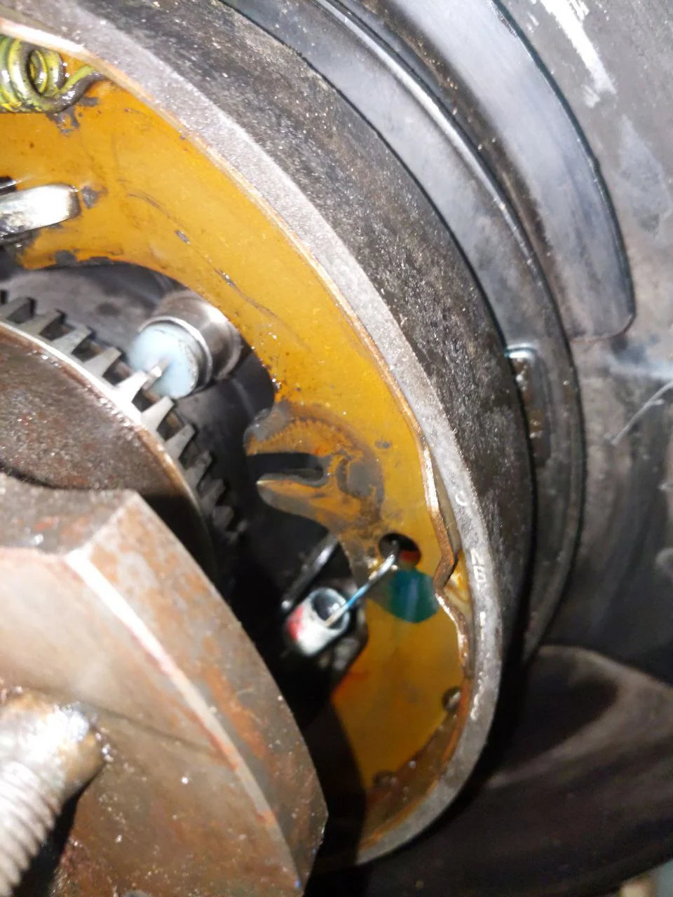

Your parking brake shoes are trashed; they'll have to be replaced due to the oil on them. I had the same problem on two of my 80's when their inner seals failed. One good thing though, you're parking brake linkage isn't rusted solid ;)
The wear pattern looks fine to me, but I'm here and not there (pictures sometimes lie).
One thing to bear in mind when installing the rear hub seal - make damn sure both the cup and cone are in there BEFORE you install the seal. And make certain the cup and seal are pressed in all the way, or the hub won't go on all the way.

RTV on the cones is weird
There should be no RTV anywhere. Use acetone to get rid of it completely.
Check the axle shaft for a groove where the seal rides. If you can feel it with your fingernail, you might have a problem. All that built-up grease and gear oil may or may not be fresh. Either way, it's a hazard. I can't imagine someone re-sealing it and cleaning up the parking brake pads without bothering to clean the rest of it.

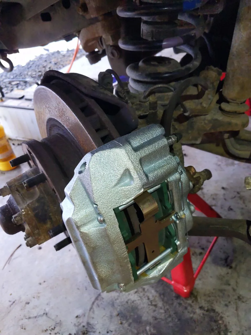

Alright, well the front brake calipers are on! No anti-squeal shims, unfortunately, but maybe next time.
I started digging into the rear left axle again. I brake cleaned a lot of the gunk off. With closer inspection, it did seem like there was a leak after all, with a light coating of gear oil on the steel part of the shoes. The gear oil has all seemed very clean, at least.
As I dug into it earlier, seeing so much RTV, I had assumed that it was a deliberate attempt at a oil bath setup. However, it's now clear that there still is the seal in the end of the axle stub. I'm not quite sure what to think as there was plenty of gear oil and it didn't seem to be mixed with grease. Just very questonable to try a gear oil bath for the bearings, while leaving in the seal itself, even if partly blown out. The bearings appear decent. There definitely is some wear on the axle shaft at the sealing surfaces. How much and how much it matters, I'm not sure.
Seeing how this all fits together, with the studs going into a blind hole, it makes no sense at all that the cone washers were RTVed. I've since noticed RTV on the cone washers in the front, too. :(

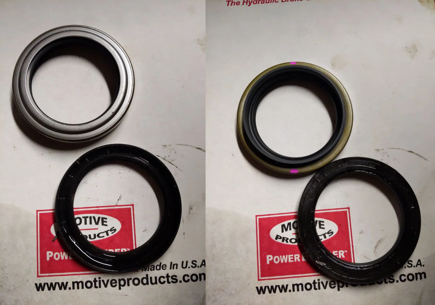

One thing I noticed is that the hub seal installed appears different than the replacements I have: 90311-62002. It's fairly clear in pictures how different it is to the OEM parts.
As far as the orientation of the hub seal goes, I'm assuming the metal is on the outside, or no? It would seem easiest to install it that way. And I'm assuming, from what's installed, that the axle seal is spring first? Edit: It sounds like the rubber flange sticks out, towards the differential, so have to be careful putting it in. The axle seal does have the spring facing towards the differential.

Made some progress this evening.
Here's the old vs new (OEM) seal
The old seal did make a great seal driver for the new one, at least.
I probably should've scraped the gasket first, whoops.
Much better.
I cleaned up the grease enough to know if a new leak is present or not.
Smeared a light coat of grease on the axle stub, even though I'm attempting a deliberate oil bath.
Hub installed, outer bearing, and lock nut thing.
Bearings adjusted. I had to do this a couple times to get it so there was no play.
More to follow.
Going for the oil bath, I attempted RTV but carefully avoiding the cone washers. I haven't done much RTV and was probably on the conservative side.
Could actually see a bit of it ooze out the outside, so hoping the coverage is enough. I wouldn't be shocked if I had a leak, though.
