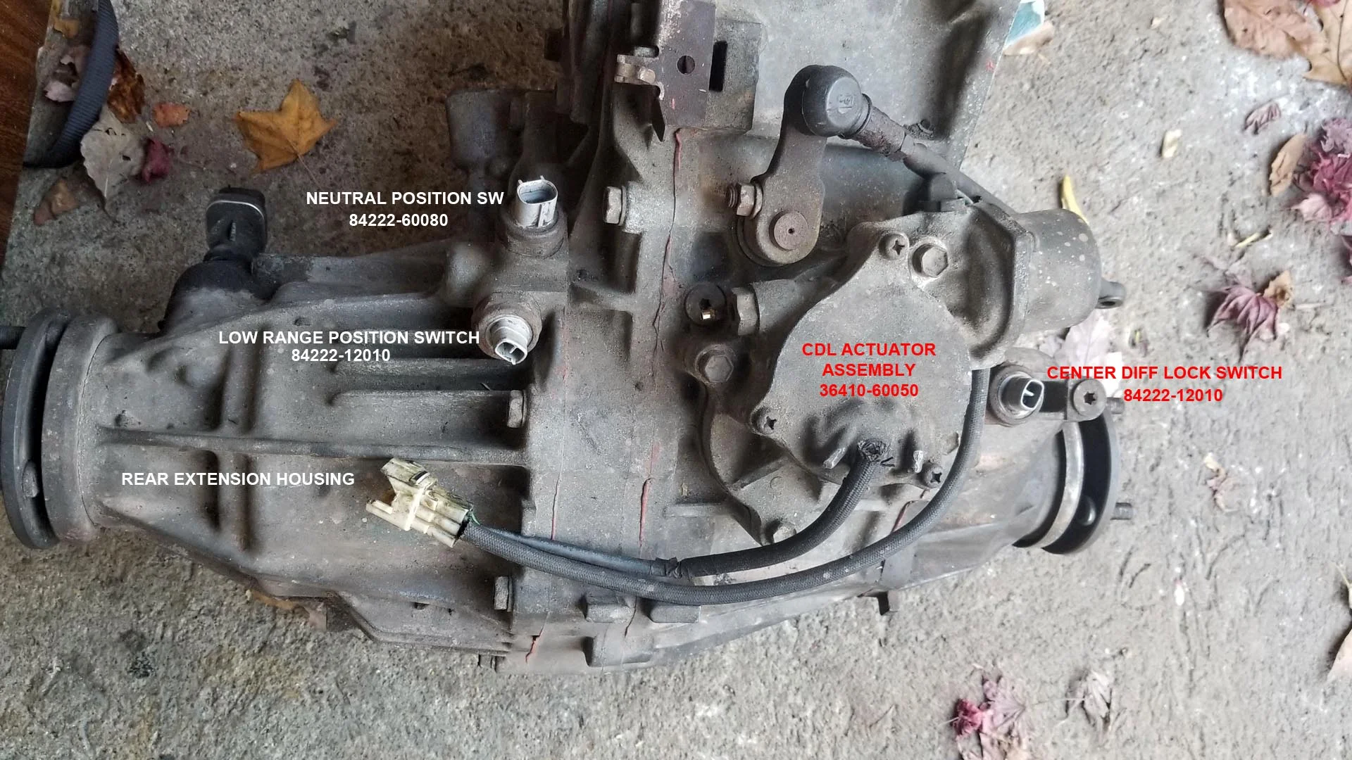

When I go into 4 low, it doesn't try to turn on the center diff lock (I haven't done the pin 7 mod, yet). If I also try to engage the lockers, none of them kick on. I do have a CDL switch ready to install, so maybe it'll work with that. No idea.
The low-range switch/sensor on the transfer case is probably bad. It might just need to be 'cleaned':
CDL Sensor/Switch - https://george4wd.taskled.com/cdl.html (It's about the CDL switch/sensor, but applies to all of the switches/sensors on the transfer case)
IIRC, the front and rear diff locks won't engage unless you're in 4-low the CDL is engaged. And as far as the electronics know, you aren't in 4-low the CDL isn't engaged until a signal is received from the switch/sensor on the transfer case.
Here are the switch/sensor locations from an older post by @jonheld:
transfer-position-switches-top-view-jpg.3162783
IIRC, the front and rear diff locks won't engage unless you're in 4-low. And as far as the electronics know, you aren't in 4-low until a signal is received from the switch/sensor on the transfer case.
In. OEM form the only way to lock the center is shifting to low range but if a dash switch is added the center can be locked. The front and rear will only engage with center confirmed in either high or low range.
Ah, this will be a good test then of the CDL switch. I can ignore the low range switch then. Although from what I understand, the shifting pattern is supposed to be different for low range than high range?
The picture shows a neutral switch. Is that on the transfer case? My lever just seems to have high and low.
'Neutral' is kind of the range between high and low. I haven't actually tested to see how far you can move the lever before it switches. With the transfer case in neutral and the transmission in Park, the AT/P light in the instrument cluster will light up:
