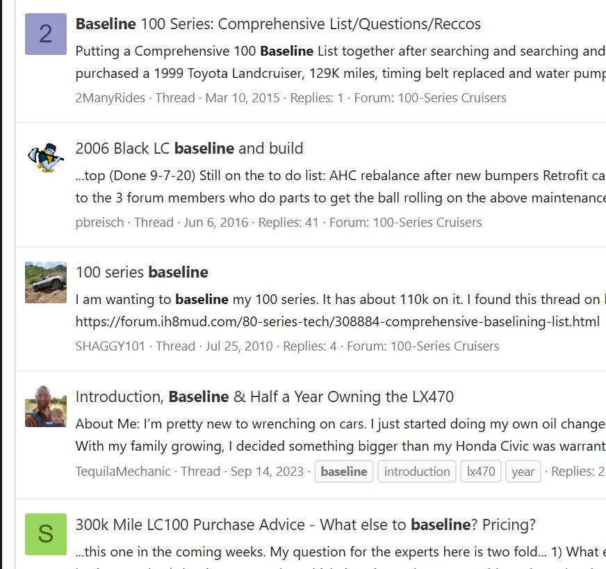

Tons of threads to browse on baselining.
