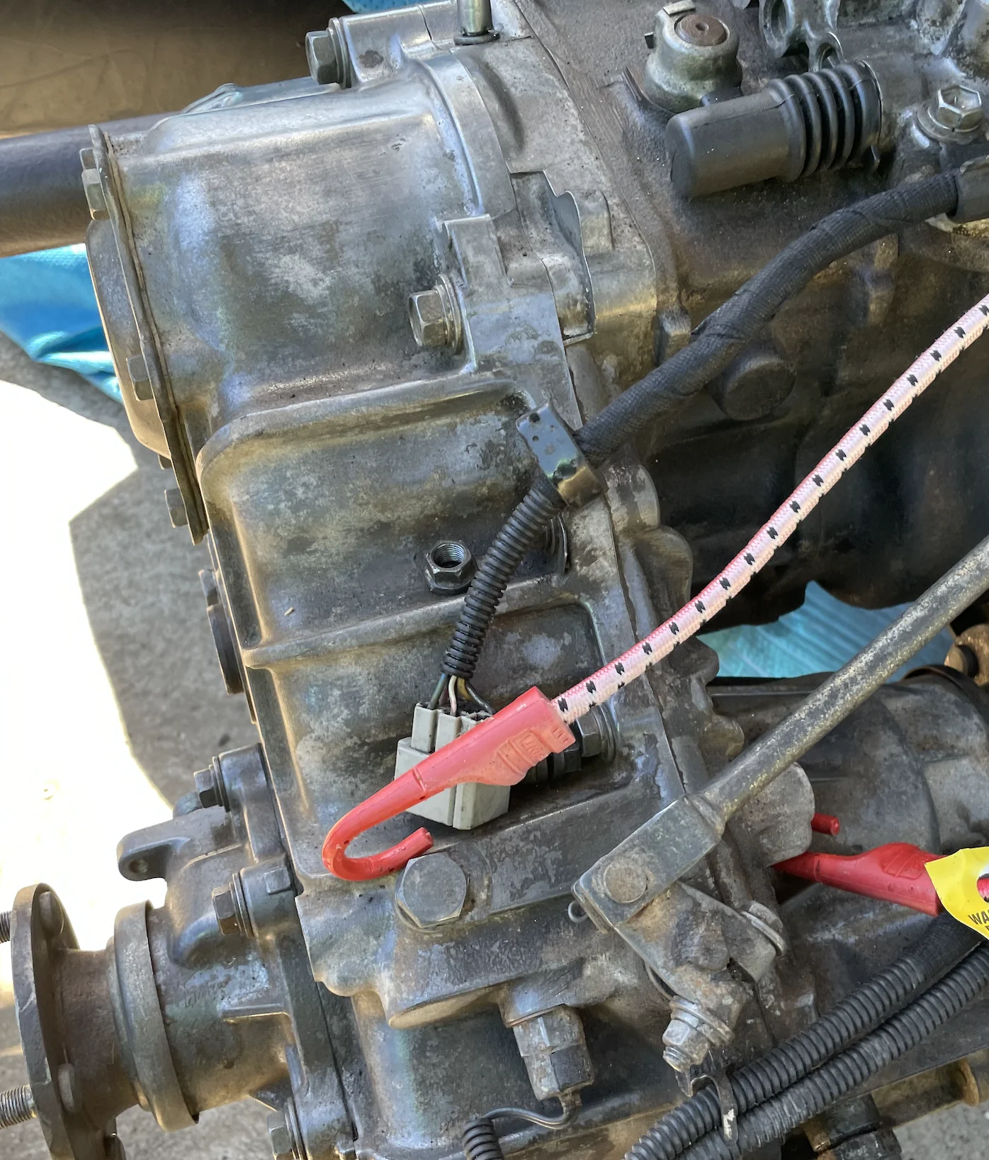

So, some tips to put it back together.
- Oil spiggot bearing and mail seal before you hammer it in. Goes in much easier and you wont bugger it up (like I dig).

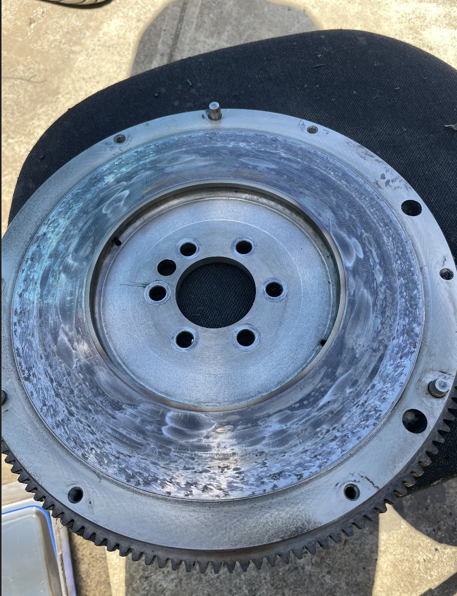

- Had to get the clutch resurfaced. i had hot spots on it.
Cost $70 at a local break and clutch shop and took only a few hours.
- Putting the clutch plate back in, is the second most difficult thing (again cause the bell housing is in the way). It really is a two man job, only to lift and hold, the plat, centre the alignment tool, and the other to thumb tighten a screw, and then turn the flywheel. I got it done, by aligning the helper dowle thingy to the top to take the weight while carefully balancing the thing.
- If the alignment tool DOES NOT EASILY SLIDE IN/OUT then its not aligned. when doing the previous step, i must have knocked it somehow when I tightened all the screws, and the centering tool needed lots of effort to pull out. IT means that you CANT get the gearbox in.

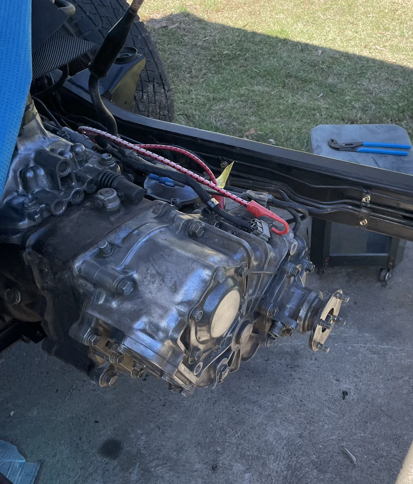

- The whole engine lift/balancing tool/chain lift turned out to be not ideal. The problem is that a landcruiser gearbox/transfer box weight is NOT evenly distributed, so its near impossibly while hanging for it to be aligned, and will sit 5% twisted to one side. between this issue, and the cantering tool issue I spent 3 hours trying to get it all to connect. I had to give up.
- The next day and a clearer head, I decided to remove and redo the clutch plate. I found that I could 'loosen' the plate screws enough, that the actual clutch could be moved, without pulling it all apart. This let me re-align the clutch plate (it did not look out of alignment, but it was). The next big tip. TIGHTEN THE CLUTCH PLATE SCREWS A LITTLE BIT, ONE SCREW AT A TIME. (dont tighten one all the way). You need to evenly tighten the plate, testing that the alignment tool is relatively loose, turn the flywheel, tighten another screw. Do this for 10 mins until all the screws are tight and still continue. Each time you tighten one side, the other comes loose. Eventually it will all be tight AND the alignment tool still has some play.
- Dont forget the clutch-fork. I didnt replace the throw-out bearing as the one the KIT came with was very different. bearing felt ok anyway. Also remember to lightly grease anything that will be touching other metal, but not enough to splatter everywhere when its turning.
- This now worked. I was able to manhandle the gearbox in, through the clutch fork, into the hole. The clutch fork has its own issues in that it has two sections to go through. Its possible to get these lined up if you focus on it. you can get the fork on properly first before targeting the hole. You cant actually see the hole, so instead use the outside bolts hole as a guide AND ensure its all going together in parallel by looking at the space (bottom/top/left/right should all me the same). the lift balancer became handy to help align this. ALSO, put the transfer box into gear, and twist the outputshaft. This turns the input shaft to help with the alignment. You can also 'feel' where the edges of the outputshaft are when you have it nearly engaged (you get a notched feel)
- I could not 'push' it all the way, once it went, but I came within 1cm. This was enough to finger tighten the gearbox bolts. Then, (after a quick beer, 10am), I just slowly tightened the bolts until it all came together.
Whole job, took prob 10 hours over 3 days and prob three dozen beers, mostly at the end. It would have been 6 hours, if I didn't stuff things up. I have NO IDEA how you do this from under the car. Would recommend a good gearbox lifter, and remember that the bottom of the geabox is NOT flat.
It can be done. I did this job on my back for the first time a couple weeks ago from underneath with the t-case attached. Yes, it requires a very solid adjustable trans jack, and secured to the jack solidly, and patience. It's a battle of half millimeters. Making alignment dowels out of some spare bolts is a genius trick learned here on Mud from 'those wiser in the know'.
Also grateful for my young strong son and his good eyes to help dock that thing. Fingers crossed we didn't mash the pilot bearing in the process.

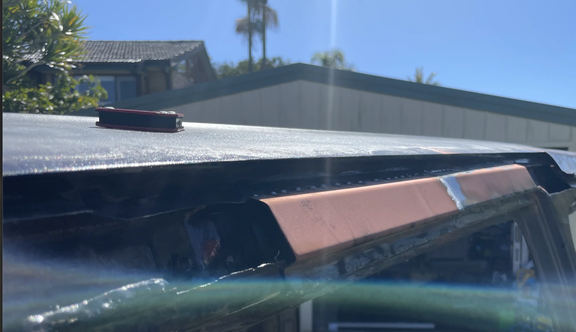

So starting to fix the last bit of rust in the Cab. Passenger side, in the roof, but has penetrated, from inside, chassis to roof, then into top door jam and gutter (all three levels of metal need replacing. Also the gutter down A piller, and a little in top corner above windscreen. All the usual spots.
One problem I had was the internal chassis, to the door jams. This is quite a complex fold of metal, and i was not looking forward to fixing it.
As I have a doner chassis (with rust in the exact same place, except to 10cm), I cut that small but out, took it to a local metal fabricate, and had him build me 4m of this channel. Its not 100%, the turn radius of one of the internal facing is a little off. The other issue is the top fold, is NOT straight on the chassis, but instead flows long and short, but its easy fixed. Having this prob saved a fair bit of time. NOTE, some of the metal near the pillar is dual-ply-edge (likely how it was built, when the pillar was spot welded to chasis. i'm having to cut this our, and just put the single 'ply' in.
I'm still putting putting it together.
I think the learning, is NOT to cut on the inner or outer fold, but instead cut half way into the vertical bit. (its a pain to weld those angles together). Also, I have a gutter section which I keep on pulling out and lining up to ensure that it will fit well. I still have more to do, but its getting easier.

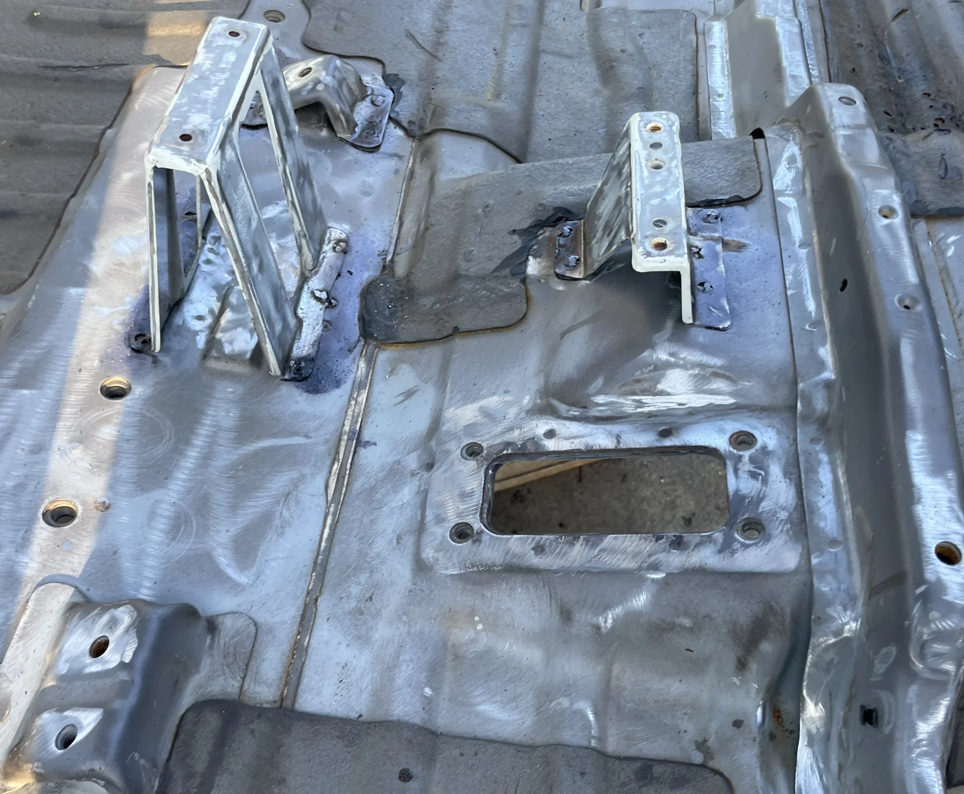

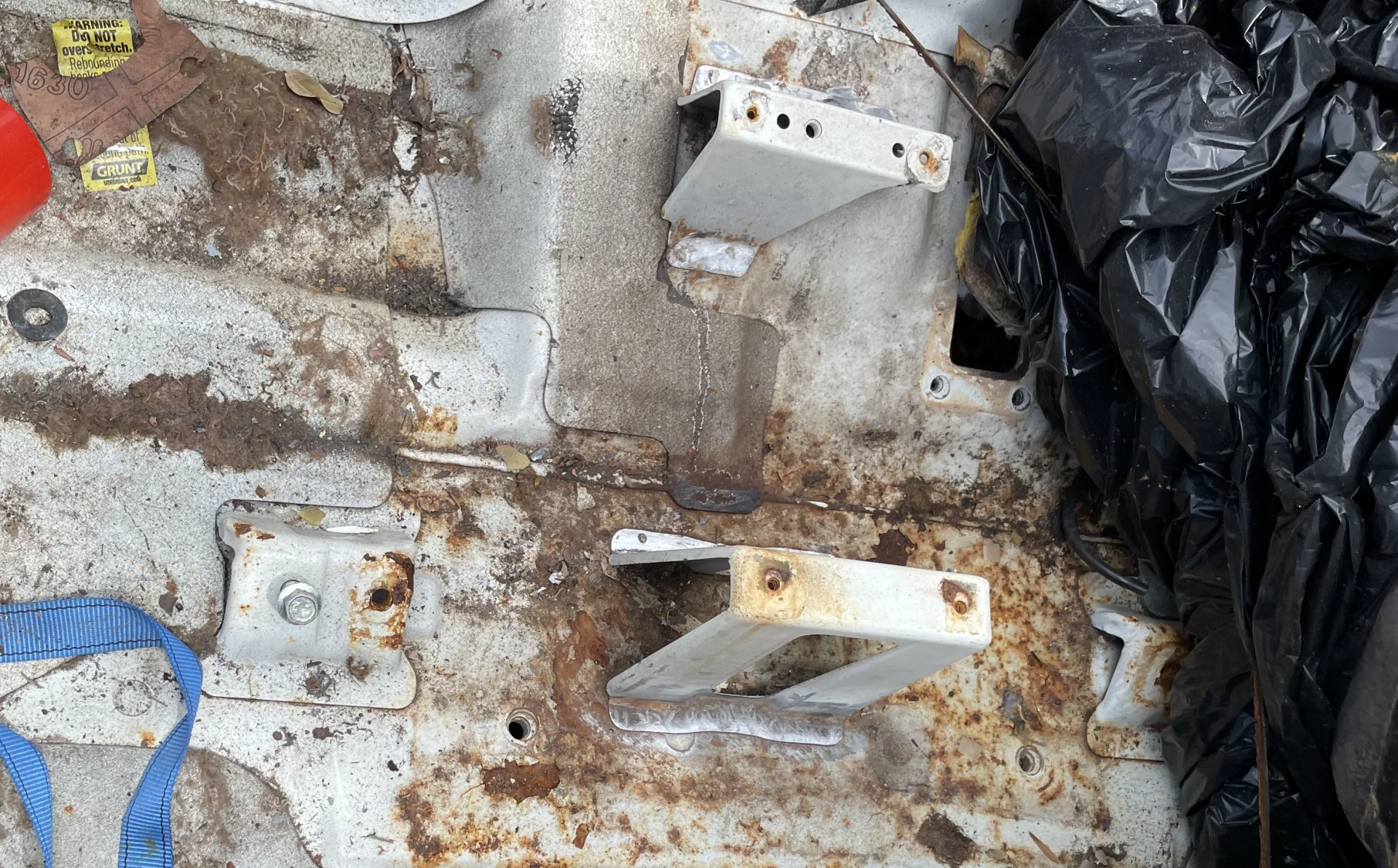

So, I discovered (early on) that old whitey had bucket seats, but the new grey cab had front bench seats. (I'm moving stuff from Whitey to grey). Only when you compare them, you realise that they are different mounts. So this is how you convert a front bench seat to front buckets.
These are the mounts from whitey. The seat mounts are dual holes (only one is used), and it has two raised mounts for the centre console. The forward one has an indent, as there is a ridge on the floor to go around. These two raised mounts need to be removed. I grinded the bases lightly to expose where the spot welds were. I then used a 10mm saw edge spot weld bit to drill these out, and with a little wiggling they came out easy.

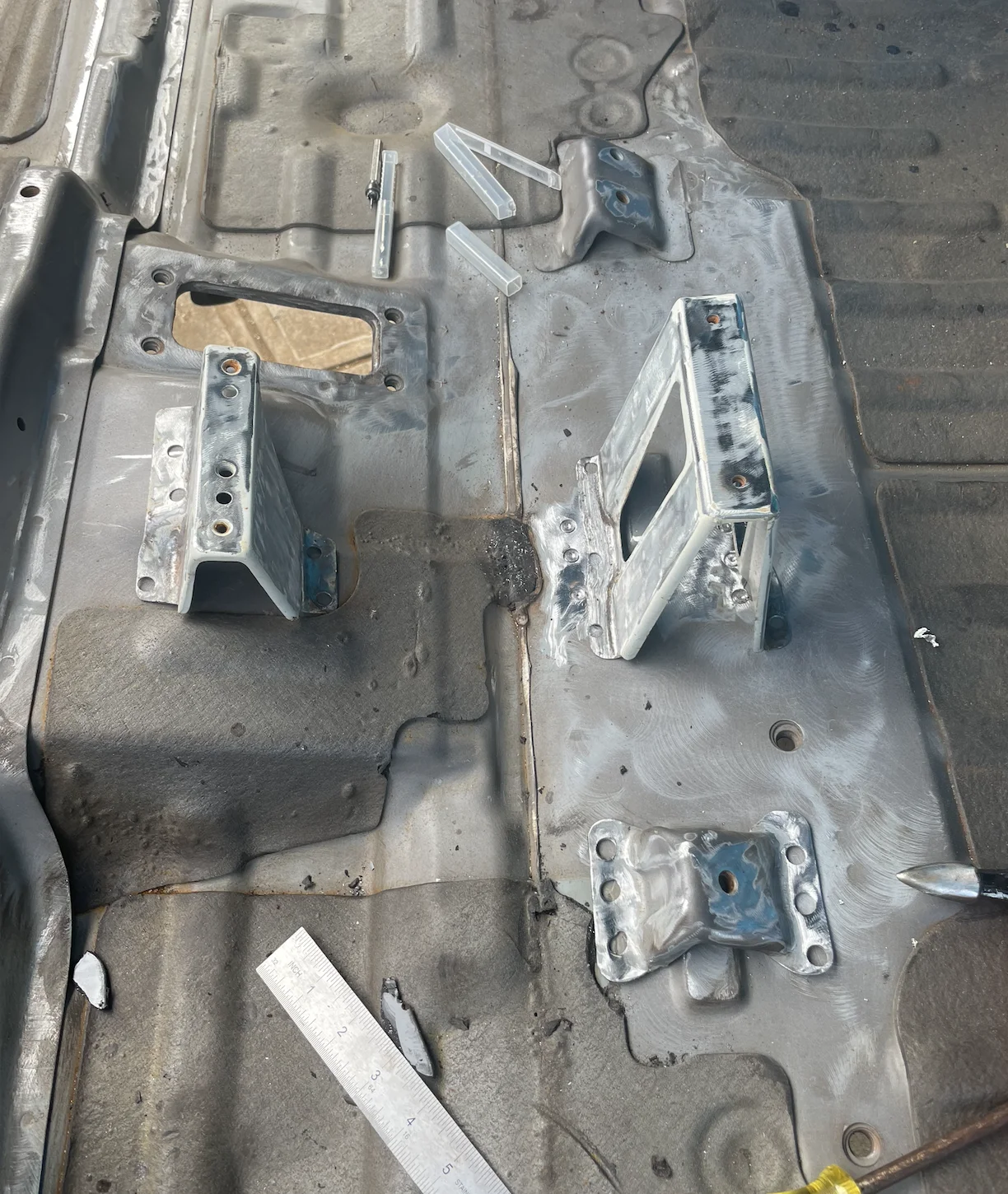

This is now in Grey. NOTE, the bench seat, has a SINGLE HOLE seat mount in the centre (just under that high mount). You need to remove this mount (using spot weld removing bits again), and put it back where the passenger bucket will go. (Or get the seat mount from the doner)
This centre mount, then moves to the mount under the passenger bench seat. In this pic you can see the rough positioning of them all. You have to remove some of the sound deadening for the new seat mount position and bring high mount.

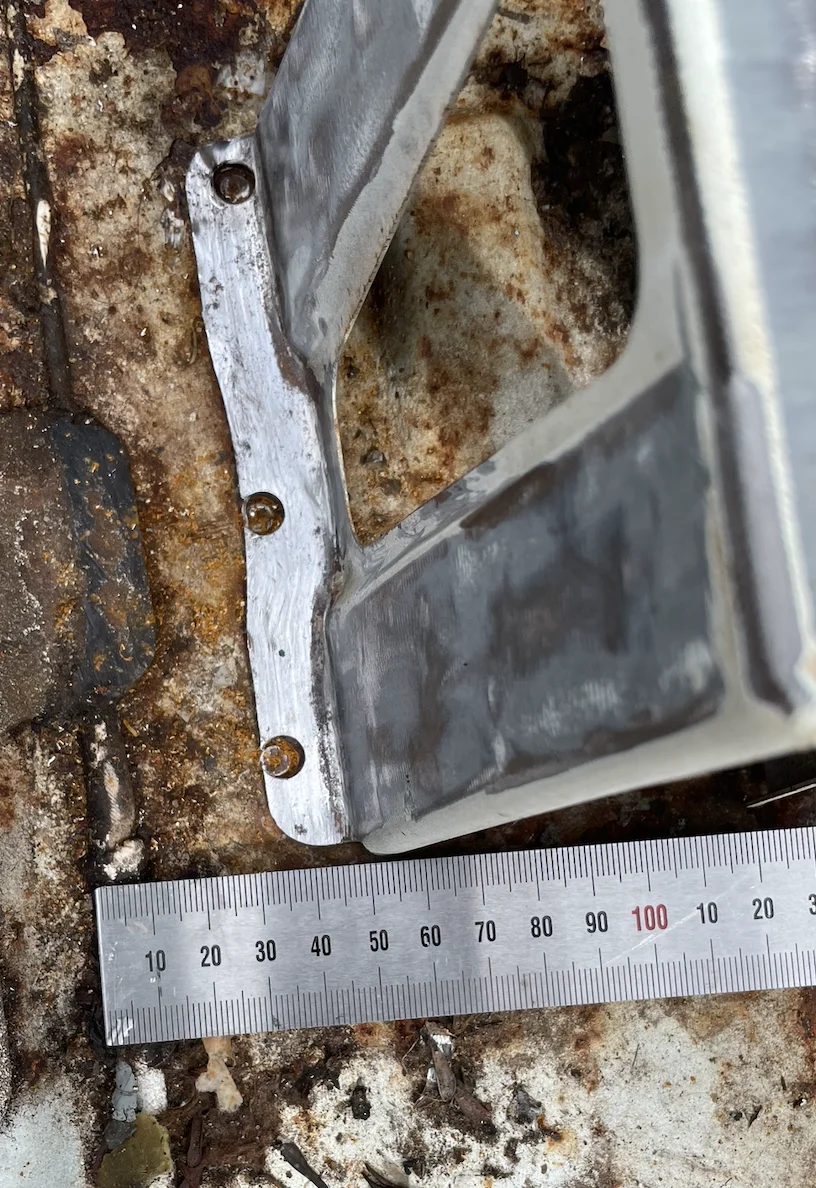

I took some detailed measurements from whitey to figure out where things go. I did the seat mount first, as the rear high console mount aligns with the two seat mounts (long ruler to measure).
This is after. all welded up. I remeasured the space between the bolt holes to ensure they align correctly. The Bench mount is a single hole. but the bucket is a dual. I dont think it matters, but the final config is a mix of both. I guess the real test will come in a few months when I bolt in the seat and centre console.

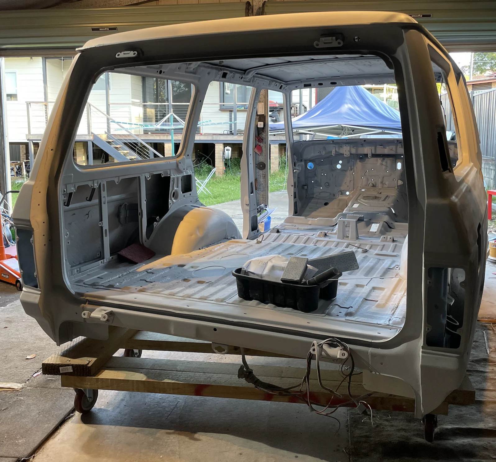

Quick update since last time. I've decided to devote 100% of my time to the project when its not raining (Sydney) or working. Which sums up to about 3 hours over the last 3 weeks. bloody rain. The new cabin is all epoxied, and I've seen a small bit of rust poke through, but I can tell I didn't hit it correctly, easy fix. During a quick break in the rain, I wanted to do base colour under the cab (white) and on the firewall. I did a bit of research to choose the colour. Some people say Black, but that actually makes leaks hard to find. Others say Raptor, but I know from experiences its damn hard to get mud off raptor. I could have gone a stone sealant, but I also likes the look of body-colour. I was worried about strength, but after I put 2-3 coats on, 2K Base Colour, properly applied is tough as hell. Way more than all the 1K spray cans I was using on chassis/engine parts.
So body is now straight and primed.
something to consider when you are doing these large rust fix jobs. Along one side, I replaced quite a bit of metal, from gutter up to the roof top edge. It's damn hard to get back to the original shape of the roof with filler etc. I've now done three complete primer coats, and in between then copious amounts of filler, sanded back trying to get the lines right. Its quite hard, as when you start doing filler, you loose 'sight' of how straight it is or is'nt (cause its pink or green filler on grey). only when you re-prime the lot in grey do you see the bits you missed, even when trying to feel edges etc. Also, you cant see s*** sanding in sunlight (hence the tent thingy). Thinking back, while a whole roof cut replacement might seem a lot of work, it might not be compared to trying to get a straight roof from your welding. Spent hours on this so far.
2nd learning, DONT CUT CORNERS stripping the roof. Get it back to bare metal, however your doing it. done leave any paint or bits, as this will show straight into the final prime.
Some other things, Epoxy primer, sprays flat, and thin, and a bit plasticy. Seals it up nice, but and sanding goes through it. I then used high-build primer, which splays thicker, and rougher and MUST be sanded before filler of further coats, so I reckon, only use it on flat surfaces when you need it, dont spray it on internal, complex shapes.
I went through 4L. (actually 5L, when include hardener) which did, 4 coats (2 full coats in and out initial, and 2 last coats, mostly out) of concept EP41 2K epoxy primer, and prob 1/2 of high-build concept 2K primer, on 4 coats (2 coats, on two seperate occasions). Using a devilbliss FSG 5, 1.8m tip. (this gun is great). I bought a full pack of 3M PPS2 cups, which saves a lot of time. Using a spray gun can cleaner as well, on a cheap 5HP 50L compressor (its pretty much on all the time each coat, and I pause when I switch sides to let it catch up, hasn't been a problem). I'm priming DIY, outside. Have not had dust or bug issues (maybe 1-2), but I'll do final coat in the shed. Using proper protection, on mouth and eyes, and disposable gloves, but not a paint suit.

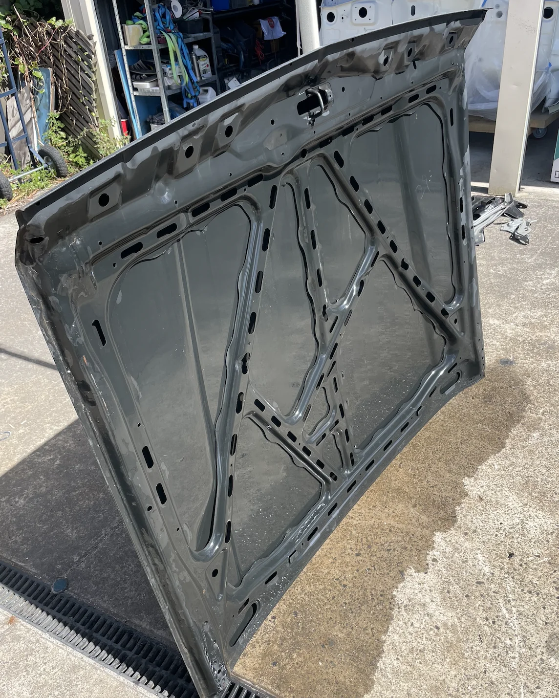

Next steps. a). Doors, bonnet, tray etc. All other internal metal bits,
b) Seam Seal, including self-leveling sealant in gutters, and prob another Epoxy coat (moving to PPG paint, as found a local shop thats better).
c) Wheel archers, stone coating
d) Colour (Toyota White 033 for this one).

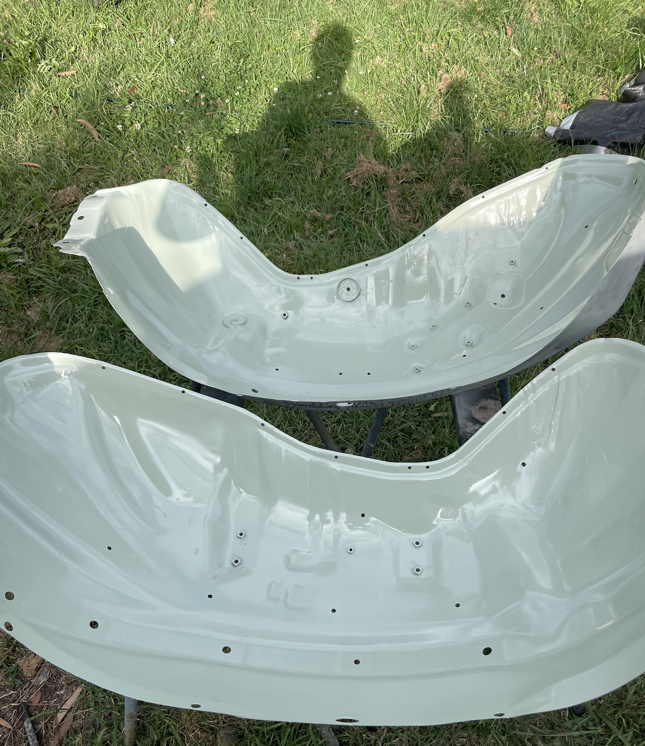

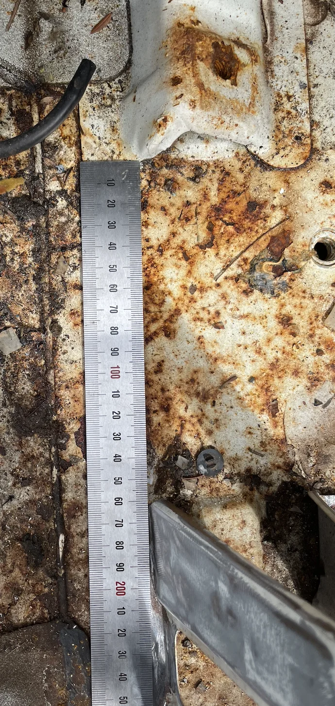

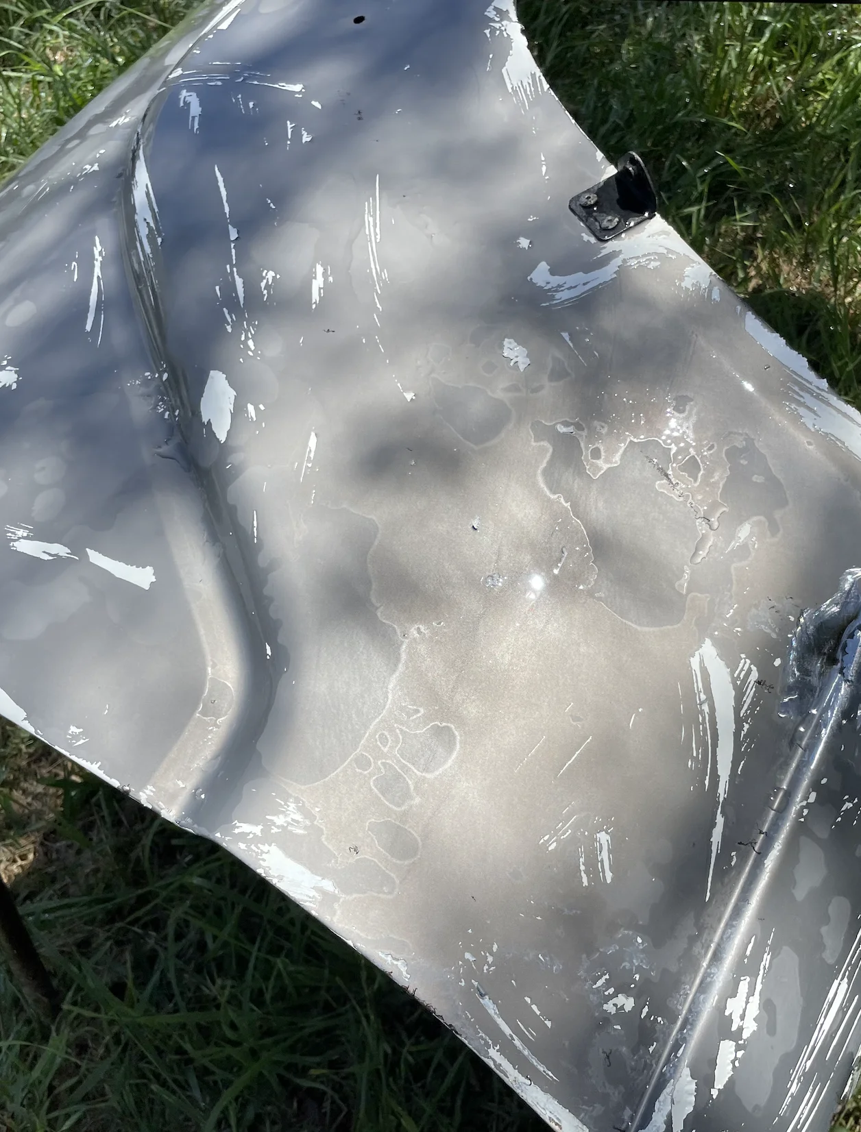

So fender weekend. Pull them out from under the house. Remembered I still had some mending (Rust) to do, little on the top, near the side mirror, and lower panel. Only like 1 inch on each, and rest is fine. Strange both sides had same issue at the top. Under the very top part of the fender is another bracing panel, thats only 3mm off the outside panel. I found on one side some leaves stuck in between. I suspect thats how the rust starts. Might hit it with something to stop this.
Anyway, as a learning from the body, I dont want to hit the fenders with heavy sanding, as any slight dig into the metal shows through. I decided to use my CAM's paint stripper instead. This actually worked a treat. I started by hitting the entire thing with 180grit DA sander. (this helps chemical get into the paint, you could prob go to 80, if your carefull). I would drop 4-5 blobs on the fender, then user a paint brush to spread around (wearing good 3M breather). Leave for 15min, then hit with power spray to wash off. This would get 95% of it, but some remained, so just dabbed where it was left, and got most of it off. Under the paint is this other layer, that looks an anodised layer. You can sand it off, but I dont think its needed. Its thinner than pain, and does not show through to pain coats). I did one fender on the inside with stripper (PS, dont use stripper on complex parts, or seams. You dont want it stuck in a corner somewhere not washed off). i also found 3-4 'blooms' of rust. under the paint, but not through it. It looked like a spider web 1cm long, and easily removed with sander. I suspect pin-holes in paint, start this, which turned into much larger area's. This is why you strip all paint off, and dont just cover it. One of these was larger, and I think nearly digging in.
I also finished with some bi-carb/water spray to neutralise the stipper. I did both front fenders, and inner fender this way.
Here are pics after the 1st round of stripping. 2nd round got most of the left over off. the strips, aligns with the original 'sanding'. Maybe 80grit would let the stripper work even better. I'll try that in future. That weird pattern in the pics, did not show up in real-life, and I suspect was just part of drying. It was not present when finished, only clean metal.
A few tips. (happy for other suggestions).
I did this outside. Dont do it in direct sun. The stripper will Boil on the metal, and is less effective. Its ok to just poor blobs direct from the can, as long as its that consistency of thick tomato paste. Do all of this in one day (sand, strip, clean, neutralise, sand again, prime). Dont let it sit, or rust starts. You will get flash rust immediately using stripper. I did'nt pay much attention to those area's that wont be visible (under light assembly etc).
After stripping, I wanted to epoxy seal straight away ( if you dont, you will need to re-sand all again, as flash rust starts). I tool the 4 parts and completely sanded them back using 180grit DA, and 240grit hand. I had to dig into those rush blooms a bit. I'm starting to learn not to get rough with sanding, if you dont want to spend hours with filler. On things like, back of fender, and inner fenders, you wont get all the paint off. corners, and bits are just impossible.

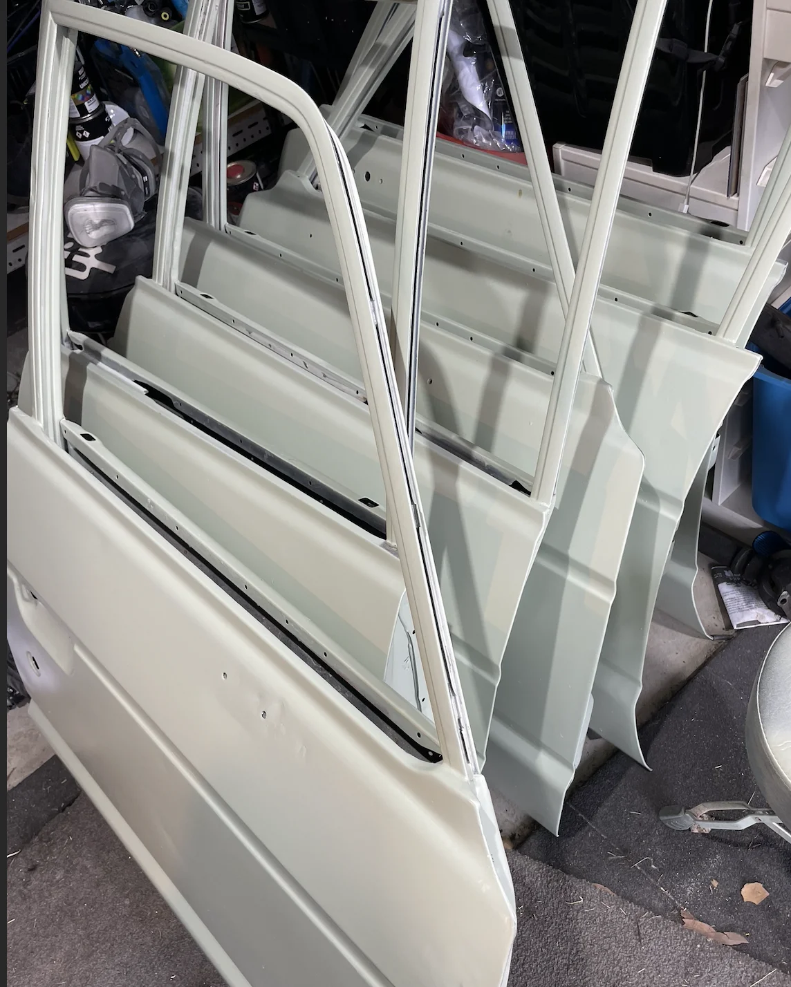

So I underestimate how difficult prepping panels is. Minor dings are straight forward, except if on and edge or something. Where I've done a weld-fix, particularly on a curved surface is so hard. You fill and sand, fill and sand. looks good, but then re-apply a primer, and suddenly its off. I'm learning that powertools cant be used for this fine work. has to be large blocks in sweaping movements, to get a nice curve. (then your prime, and because your so focused on that spot, you apply too much and get an drip, back to square one. The top-edge of the fender was the most difficult. Its that place that will get seen a lot, and will stand out if not right (both fenders had rust fixes in this area).
I've completed the fenders, ready for top coat. All doors are done in first-epoxy sealer, as well as tailgates and bonnet (got a New-old-stock bonnet for cheap, with just one small ding).
I did 6 doors, only because I got into a bit of a process, and would rather have them sealed if they need to sit a while.
Only when you get into this level of detail do you notice issues. Like replacement holes for side mirrors. One of the doors, which looked great, turned out to be full of bog, evening our a previous weld-fix. The fix is good, no rush, but I'll decide later if I'm going to use this door, as its a bit of work again.

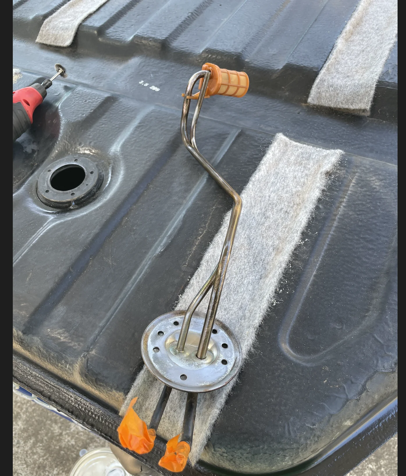

Cleaned up the fuel Tank. Removed the guage unit and fuel-send, and stuck a phone camera in to look around. Some very small bits of rust, but none that is loose. Pulled the fuel-send showed that its connected via a windey pipe to a orange filter. Filter is still in good shape, but was a bit tricky to put back. Everything is getting wire-wheeled and sealed with paint of some-type. I've discovered 'high-Temp' black and clear, which do a great job. The black is a great Matt-Black, and seems to go on better then any other black I have. Put fuel tank in, with a bungy-chord to hold it up for now. Also had to put the spare-wheel chain back, as the bolts are under the the fuel-tank.

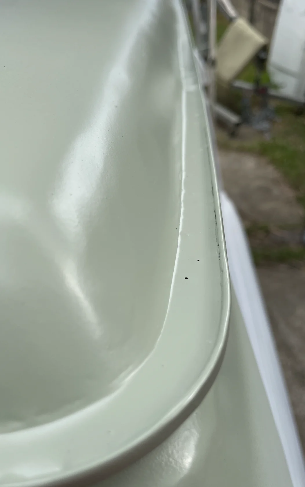

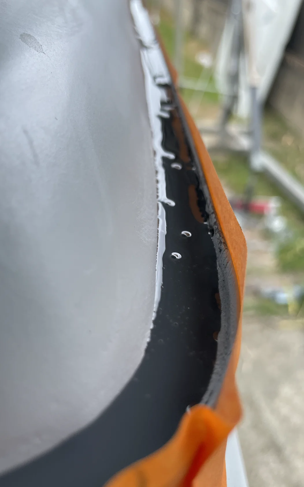

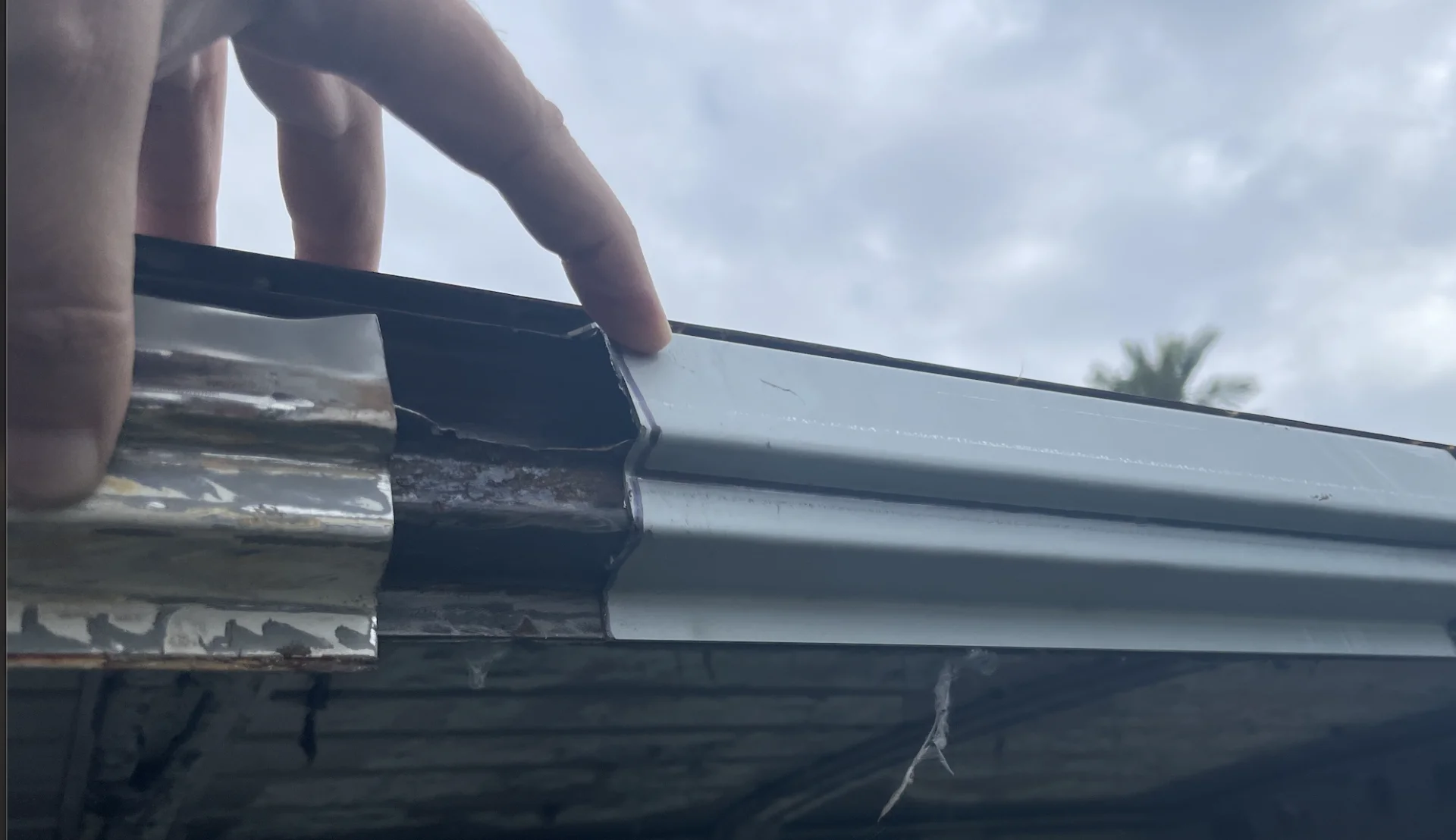

Back to the body, while waiting for some parts. I'm applying seam-sealer. Many of the gutters were replaces, and welding of the roof parts on was messy in some parts. I wanted to use a self-levelling version. did some reading on it, and seems good. Had some problems procuring this in Australia (suttons had it) and its not cheap, but I picked it up on sale. It comes with a special applicator to mix it. I also had to buy a special dual gun, so I'm invested in this stuff. I masked the area's on the gutter side (and in hindsite, you should also mask the body side as well). It lays easily, comes out grey. It slowly levels out over about 6-8mins before it starts to solidify. I 'blocked' the ends near the windscreen, as this would have drained it. This worked ok, and is needed. Some pics.
So I had some small bubbles along the way. I noticed them after 10min, and popped a few, but the sealler had already gone tacky. I assume this is just in the sealler, and not likely all the way through, so I will ignore for now. Now its hard, nothing I can do about it. Quite happy with the end result. I guess the alternative would have been non-flowing sealer and just use finger to level it off. i think this is worth the extra cost.

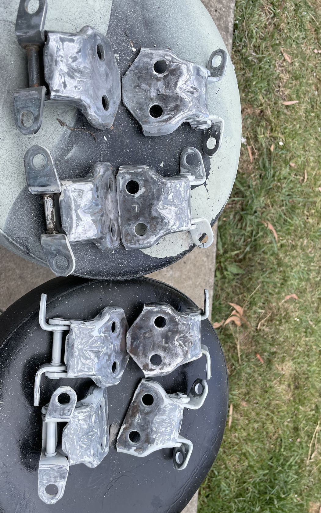

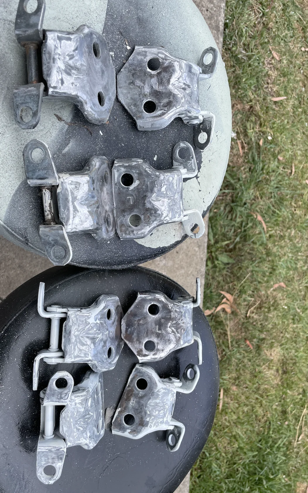

Lesson #483 in dismantling a 60. You need to pair and label the door hinges. This is prob 8 months after I removed them. They are labled. "L" and "R" and "1" and "2". And also stamped with some additional numbers. The shapes appear to be in 3 styles. So I hope this is a match. Next step is to Paint them the body colour. I wont know if the pairs are correct till I fit the doors. I might have to re-paint once fitted, and that seems to be the norm.

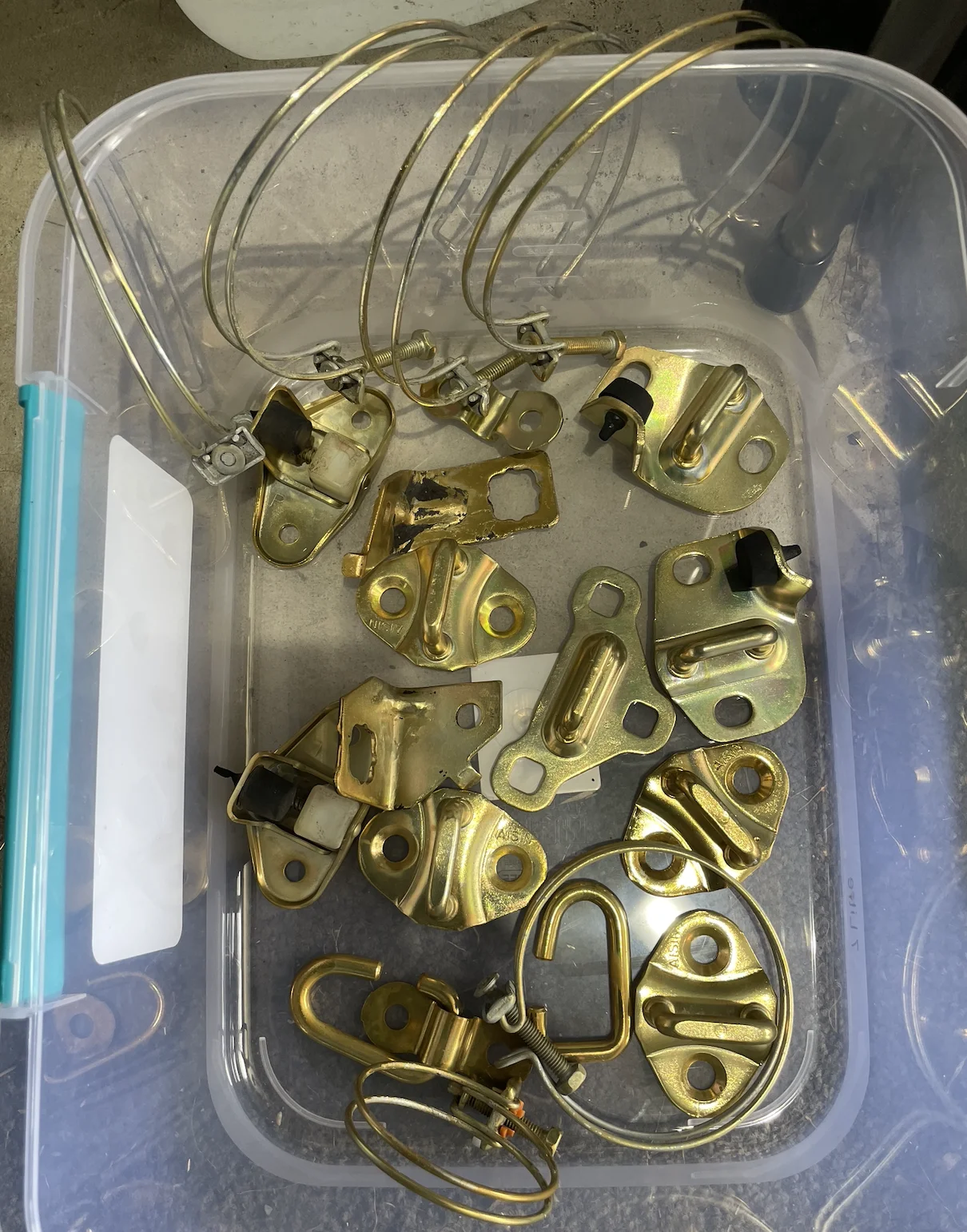

So, all the 'inside' panels have been painted in colour. Inside doors, hatch, under bonnet, inside fenders etc. This was just done outside DIY. turned out great, but not shop quality, with a bit of dust. This cleaned up ok, but it tells me I cant paint the 'show' sides this way. So while I consider how to set up a paint booth in my shed, i got out the electroplating kit. This is your basic Janes 10L Kit. setup all the process and tubs. Made a few mistakes along the way. main issue is leaving stuff in baths for too long (i.e. forgetting it). The rust cleaner that comes in the kit is great. Cleans up anything, so I even used that on some other bits. Takes about an hour per round, and I can do roughly 3 bits per round. Takes some time, and you cant 'miss' step in any way, but thank goodness the cricket test is on. So I'm doing;
- Door strikes and screws
- All rear door/hatch hardware, including springs
- back seat strike
- bonnet latch
- some other stuff. including power-steer tub
This is how its worked so far:

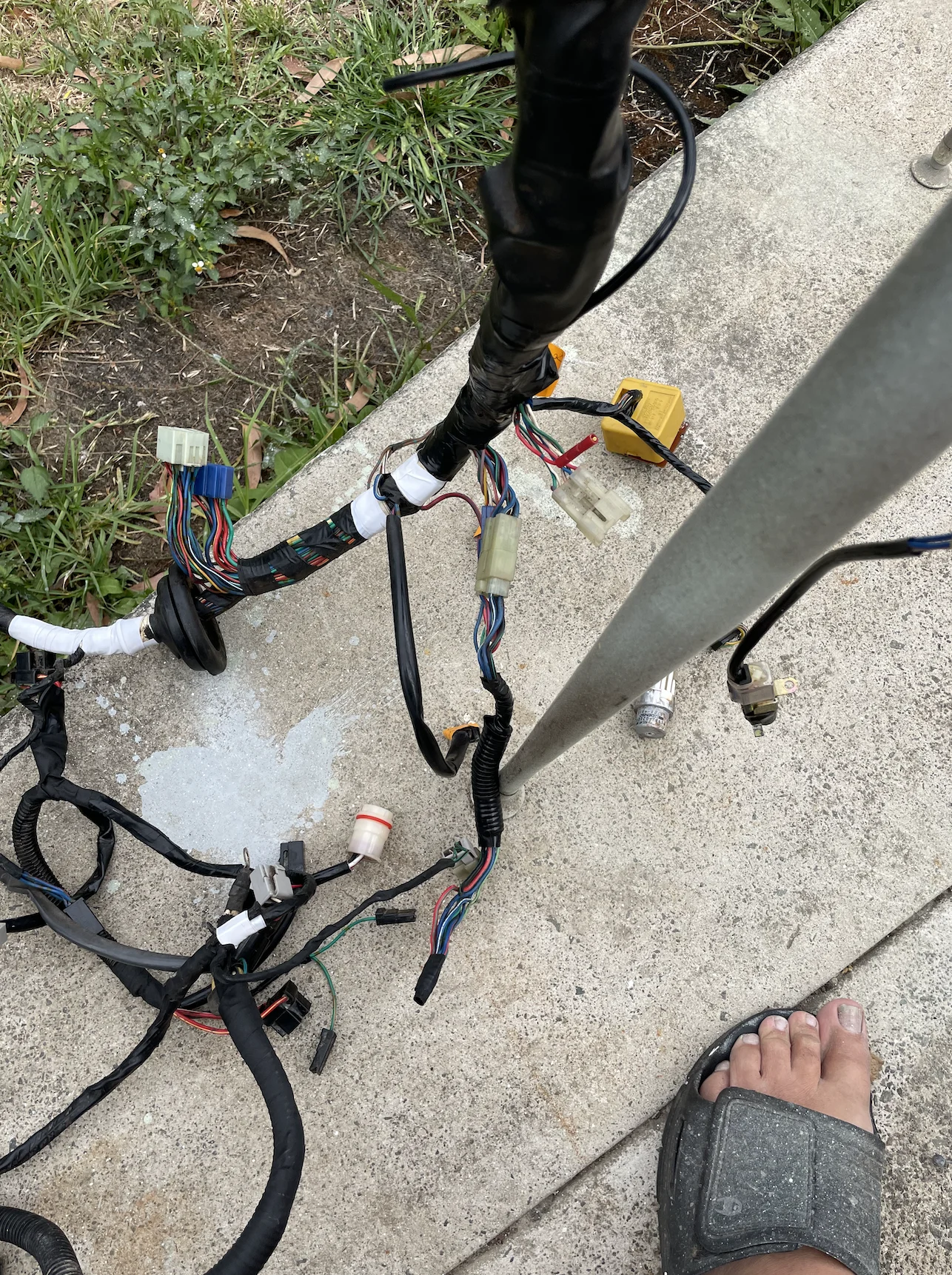

So in the hour long sessions while plating I decided get the wiring loom out and clean it up. I'm using an old table with no top, which is use-full as I can go around the loom and easily get under parts. Basically any tape wrap that is loose I'm removing and redoing and this occurs a lot. I got some proper loom tape (car builders) as well, but using that mainly for internal loom. I'm degreasing it all, cleaning it up, getting into all the connectors as well, and using contact cleaner on those. Finding all the PO edits and removing them. I'm also re-taping the white and green OEM bits, just to make it all nice. I labled most of the connectors when I removed it, but then discovered I used two types of marker during the labling, one of which had faded. Hopefully this wont be an issue later on. I found some future issues to fix. Namely, the inside door looms were originally cut, so I'll need to find some new ones. I really don't think, they can be repaired as the cut is in the parts that need to bend a lot (door jam). )PS>. Anyone every removing a door or rear hatch, please don't cut the loom, just disconnect it. Also found a couple of cut wires, so that will need some tracing to see what they are. Overall the loom is in good shape.
But I want to wire in some additional items into the new cruiser. But the while the fuse box has 3-4 spare slots, it has no common rails, so its a bit pointless using it (and the slots have no 'plugs' in them, which I have no idea where to source. I have seen some 'spare' connectors in the loom, which I know exist, which might do for power to a UHF. I want to provide power to some BMW e46 electric seats, but I dont think I can use the loom for this.
Some pics of this part:

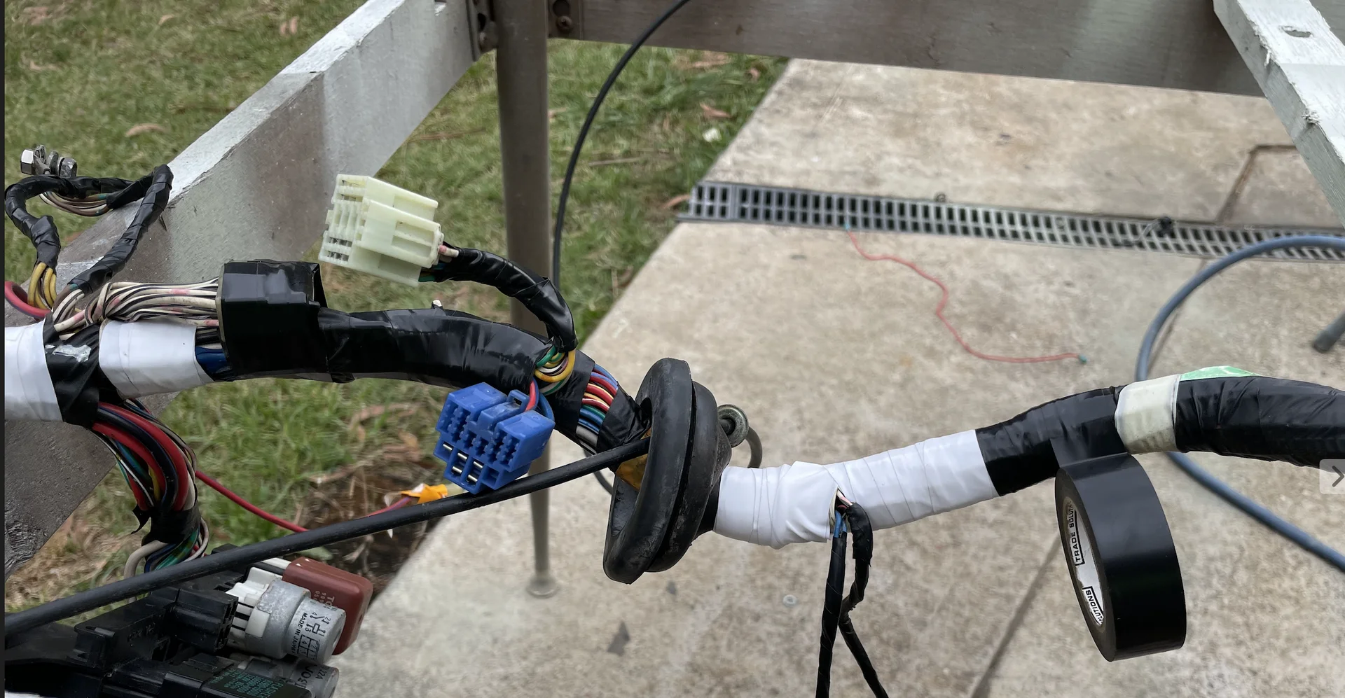

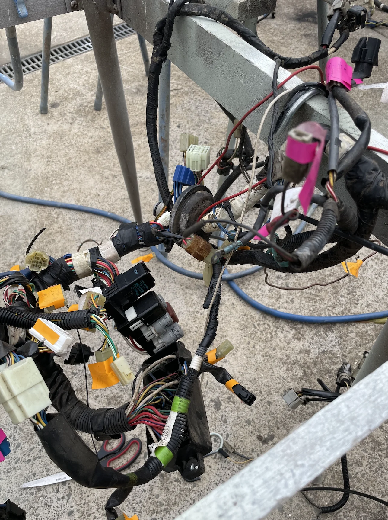

Some more wiring loom. I pulled out all the wiring, and laid it out like it was on the car. I decided to make a couple of video's on this, as it may help someone in the future and it explains how the wiring in the FJ62 works.
Firstly, the relay and fuse box. I've only had to replace one relay - flasher, and I found it a real pain in the neck, firstly because of the location of the relays and secondly because it was not going to budge. With the whole box out I can see why? You really cant get to any of the hold-pins on the relays without removing the whole thing. This should explain.
fj62 relay and fuse box
Next I decided to walk through and explain how the whole loom works. You really dont see how this works in the car, but the entire engine bay and instrument panel loom is one entire piece. The rears can disconnect and you can see how the doors work as well, and also how the rear works, which is all connected through the passenger side loom. NOTE: This is an Aussie FJ62 GXL, Petrol.
FJ62 wiring loom walkthrough
