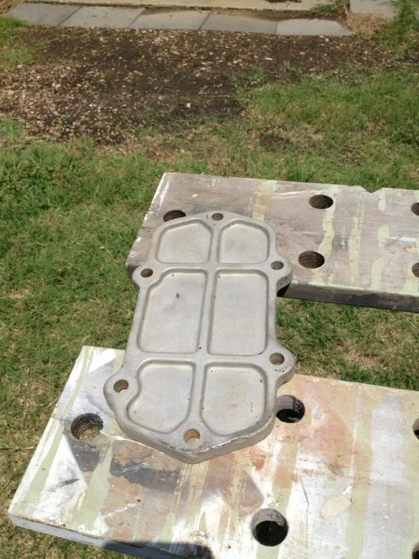

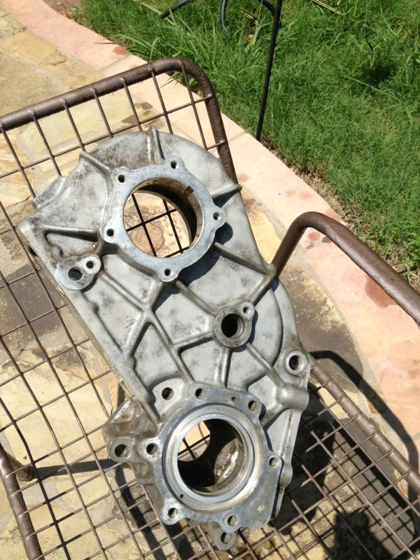

I cleaned some transfer case pieces lately. I have more to clean, but I have a couple pics to tease you all with for now.

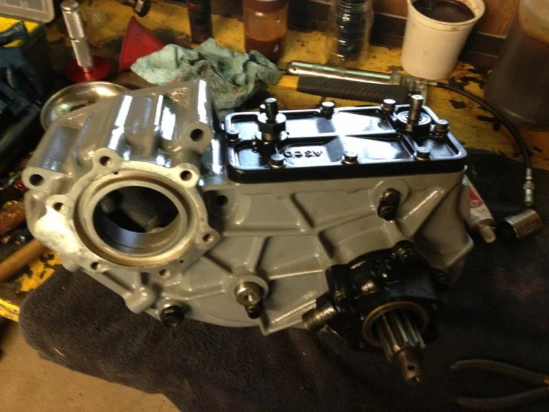

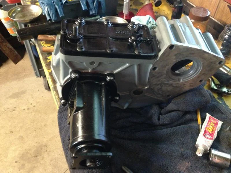

I rebuilt the transfer case today. I could give a big writeup, but I used a combination of the FSM and Coolerman's site for step-by-step guidance, so I will just link to coolerman's site and those of you that are interested can look up directions.
http://www.globalsoftware-inc.com/coolerman/fj40/34A.htm

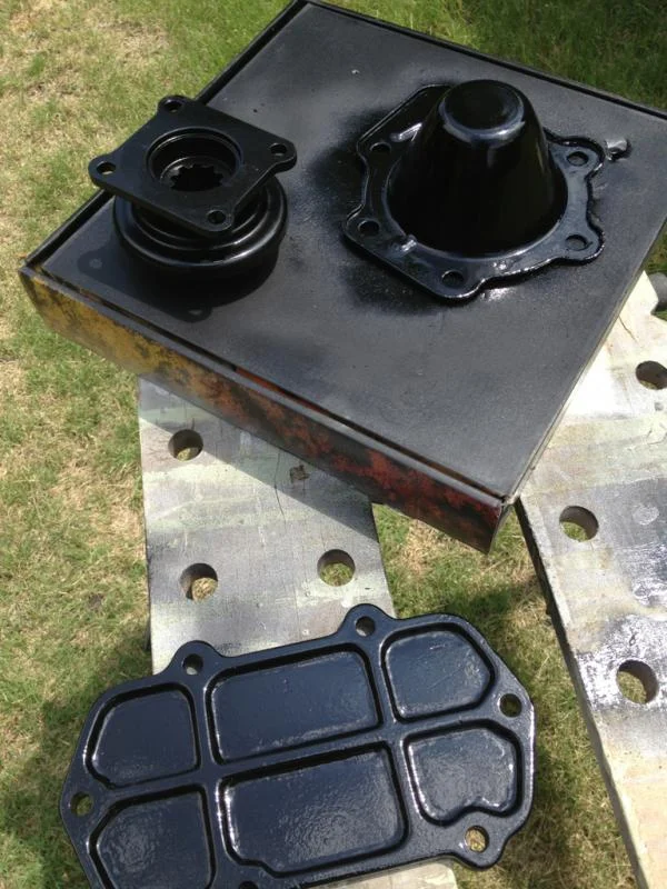

I painted all the covers and cases, I replaced all the bearings and seals, and I generally had to do everything twice to make sure all the pieces were installed correctly because I am mostly just a dumb hick.
By the way, I am aware that painting the aluminum parts is not "factory". It's my party and I can paint what I want to!

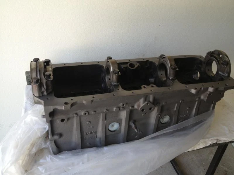

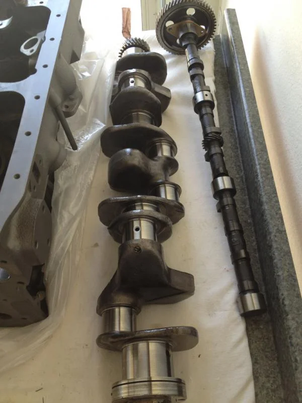

Got the engine parts back from the machine shop. They were able to leave everything at factory spec... That means I get to reuse the original pistons.
Further, they had a ring set sitting on the shelf for my standard pistons!
Block prep, new cam bearings installed, new freeze plugs installed, check and polish cam and crank, clean and check rods. Guy complimented how nice and straight everything was. Time to go find standard size bearings and a full gasket kit.

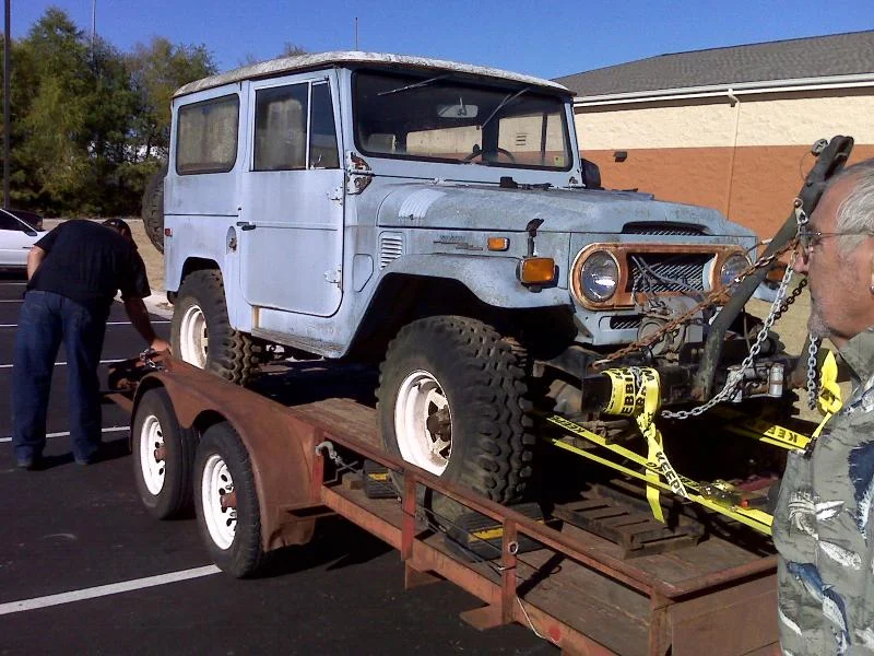

I have enjoyed following this build thread! I have a similar situation. I inherited a 1971 fj40 in November of 2010. It had been sitting for about 15 years before I got it. I trailered it from Little Rock, AR to Sachse, TX. Since that time I've slowly been disassembling it and trying to figure out what direction I want to go with it. It was complete when I got it and I'm leaning towards keeping it that way. I'm curious what machine shop you used to inspect your engine? Here's a picture of when I picked it up. I need to start my own build thread.:) Keep up the great work.

My project is just north of Wylie. You are welcome to come inspect the various messes I have made sometime.

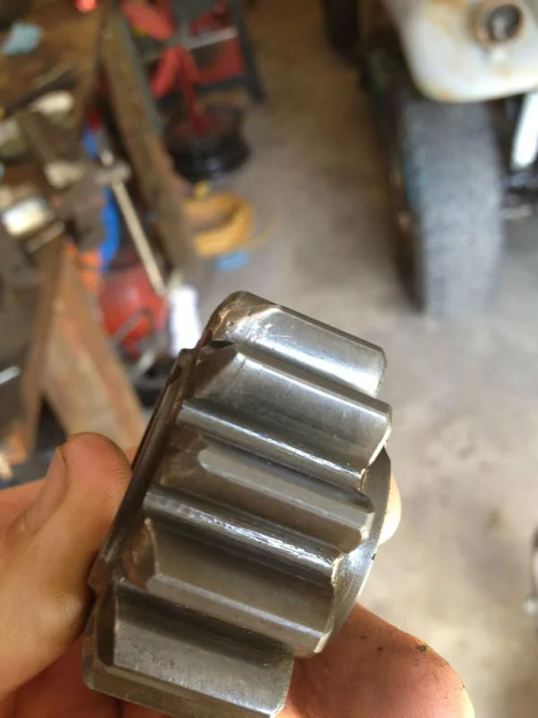

On other news, I tore down the transmission and painted the block today. Block looks great! Transmission guts are all good except for the little reverse gear. It looks like my uncle tried to jam it in reverse while rolling forward or not clutching or something. One tooth is a little worse for wear. Fortunately, I drive like a grandpa and this gear is for reverse. The damage is only going to effect engaging reverse, not driving in reverse. I'm comfortable reinstalling this gear after I de-burr the damaged tooth.
I'd be more concerned about that gear's effect on its mate. Can you source a good used one from specter?
Yes... for $106.25 plus shipping.
The mates for the damaged gear are both in good shape. The only damage on any part in the transmission is shown in the picture. That part of the gear tooth does not contact any other gear teeth except during the transition time that the reverse shift fork slides the reverse gear into mesh with the reverse idler gear (the damaged one).
Once the burr is removed, this gear will be serviceable.

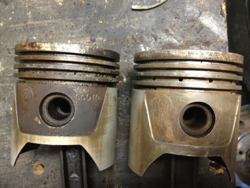

Today, I worked on cleaning transmission parts and engine parts for the various rebuilds I will be doing this summer.
The pistons were badly clogged with carbon. No wonder the oil rings were failing. Oil couldn't get to them.
One before and one after. Grooves were cleaned with a fragment from an old ring. An appropriately sized drill bit was loaded into a t-handle to use like a reamer and open the oil passages in the 3rd groove. All the rest of the carbon was removed with a light application of a small brass wire brush. They will go into the part washer before reassembly. This is time consuming, but that makes for a good hobby.

Also, here is my de-blurred reverse idler gear:
That looks good. So long as it is not needed under load it should be perfect. $110 for a replacement is lunacy.
The carbon on those pistons is amazing! I rebuilt a 2f head once where we struggled to get the valves out for all the carbon on the stems. That engine ran like a top after the rebuild though.

I have had quite a few parts that were hard to remove due to carbon. This was never going to be the "easy" project, though.
