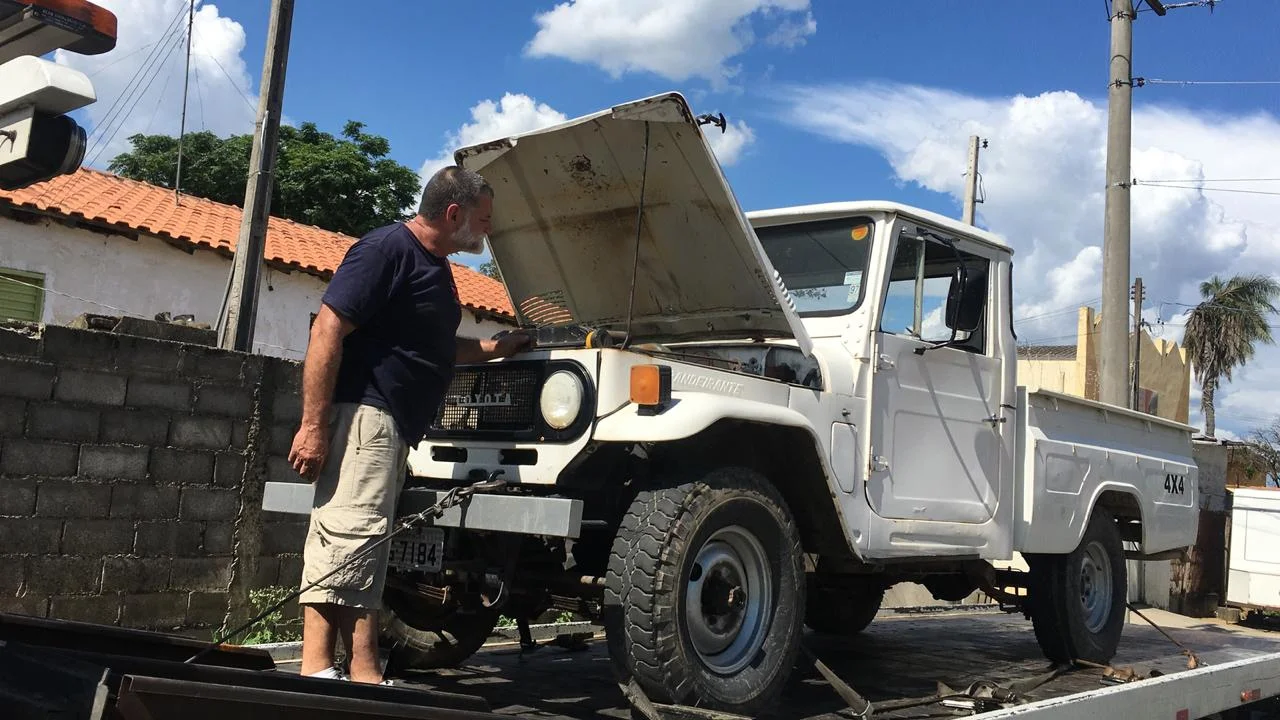

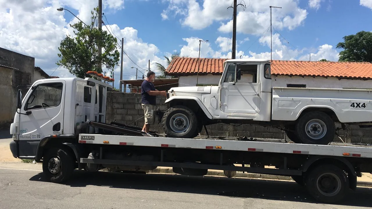

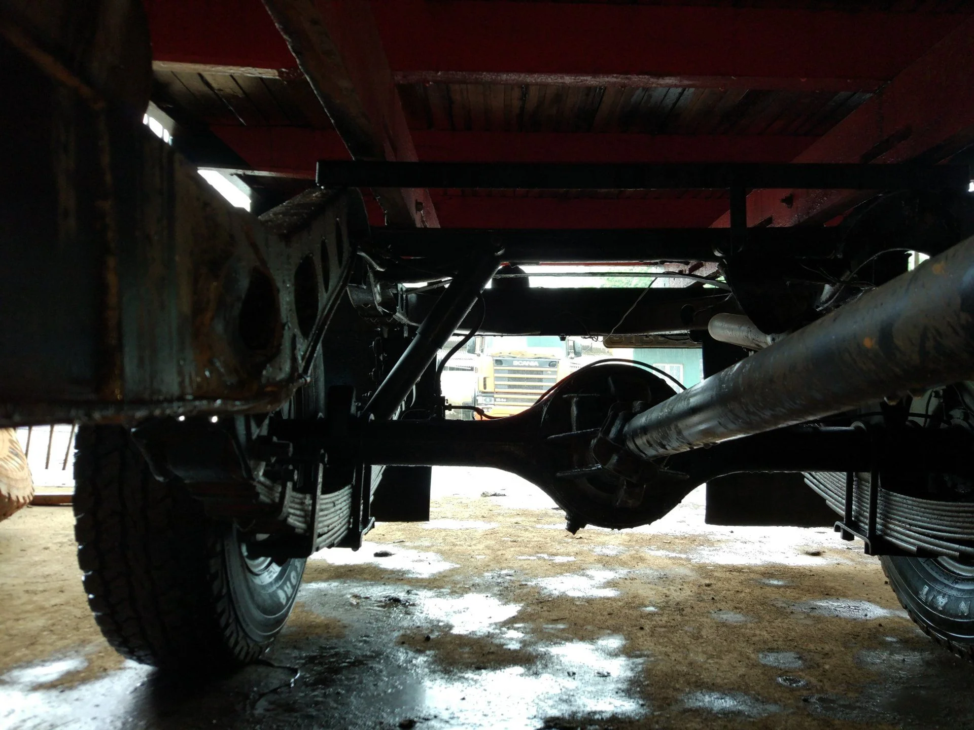

Bandeirante Bandeirante Pics

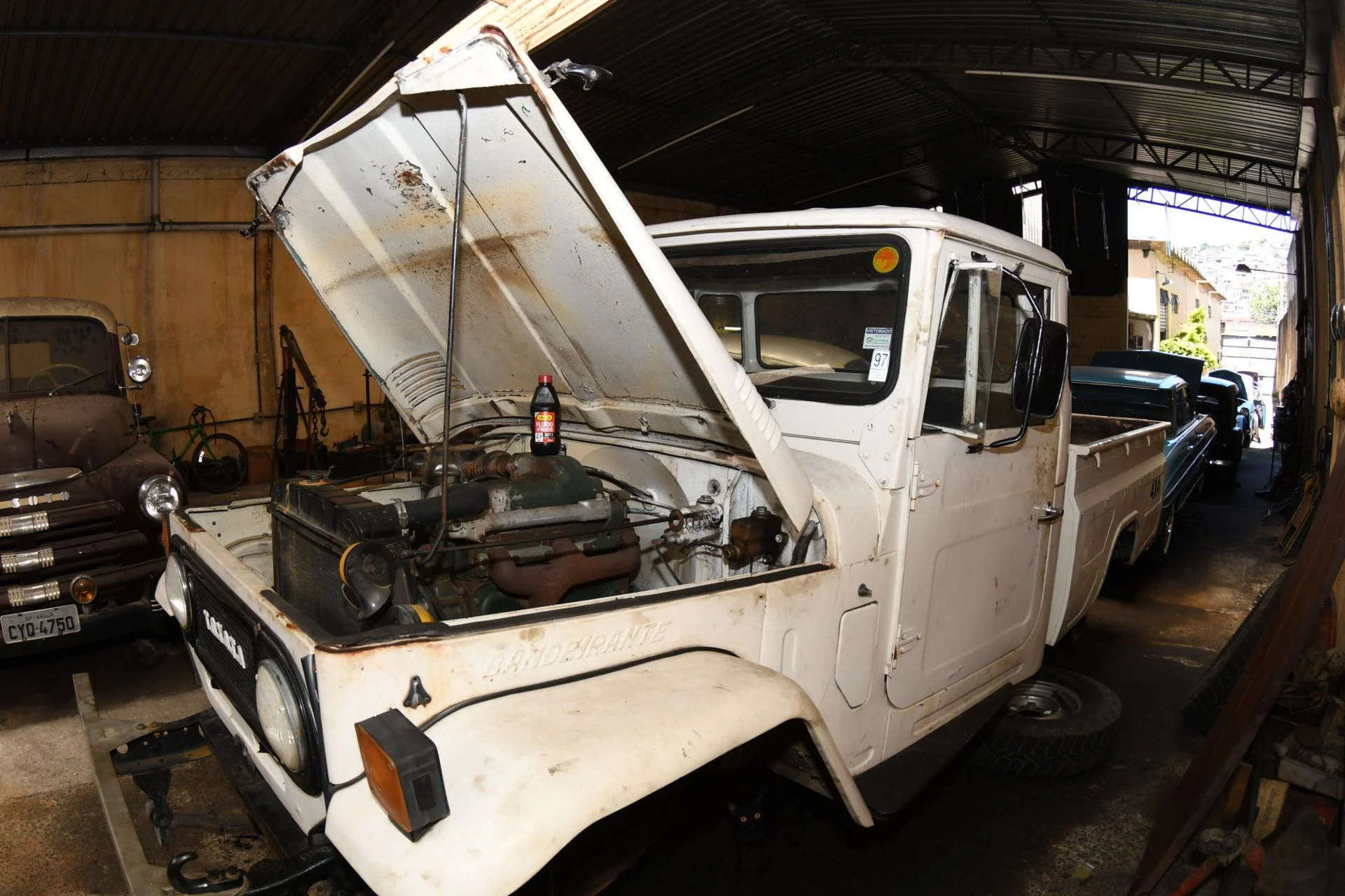

Trying to get this one sorted out. The lack of original comparables as well as documentation will make the restoration near impossible. The pics you sent are perfect to compare and contrast the components. Just sent you a PM to talk about the importation process.
@pbgbottle Here two other pics along with the mercedes OM314 engine manual (dont recall where I got it, probably somewhere here OR on the Brasilian 4x4 forum) in case you are interested.

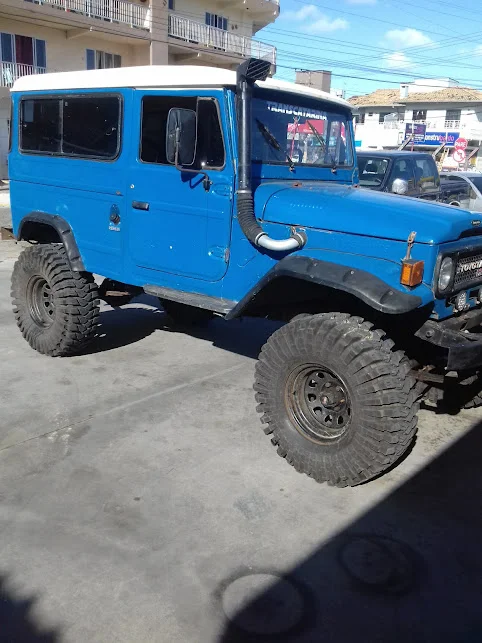

Hello all, greetings from Brazil!
I'm new to this forum and I would like to post a pic of my bandeirante.
It's a 1989 OJ50LVB "Jipe Longo" (mid wheelbase) powered by a turbocharged Mercedes-Benz 314 engine. Upgrades include 37 inch tires, 37/9 rack/pinion differential ratio (to compensate for the much bigger tyres), SOA, snorkel, leather seats, rear mirrors from a Mercedes Benz truck (I'm 6ft 5" and the original mirrors were very tiny for me, especially after the soa conversion) otherwise quite standard rig. The tranny/Tcase are from toyota (syncronized 4 speed), that mated perfectly to the MB engine (the clutch disk and pressure plate are from Mercedes, the rest are from Toyota).
I am owner of this bandy for 7 years, but living at seaside has take its toll on the bodywork. I'm currently replacing the bodywork parts for aftermarket fiberglass ones. The steel parts are quickly becoming beyond any repair. The roof was the first part swapped...

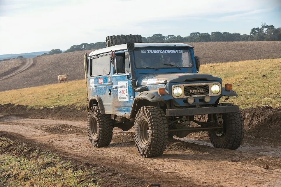

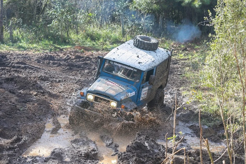

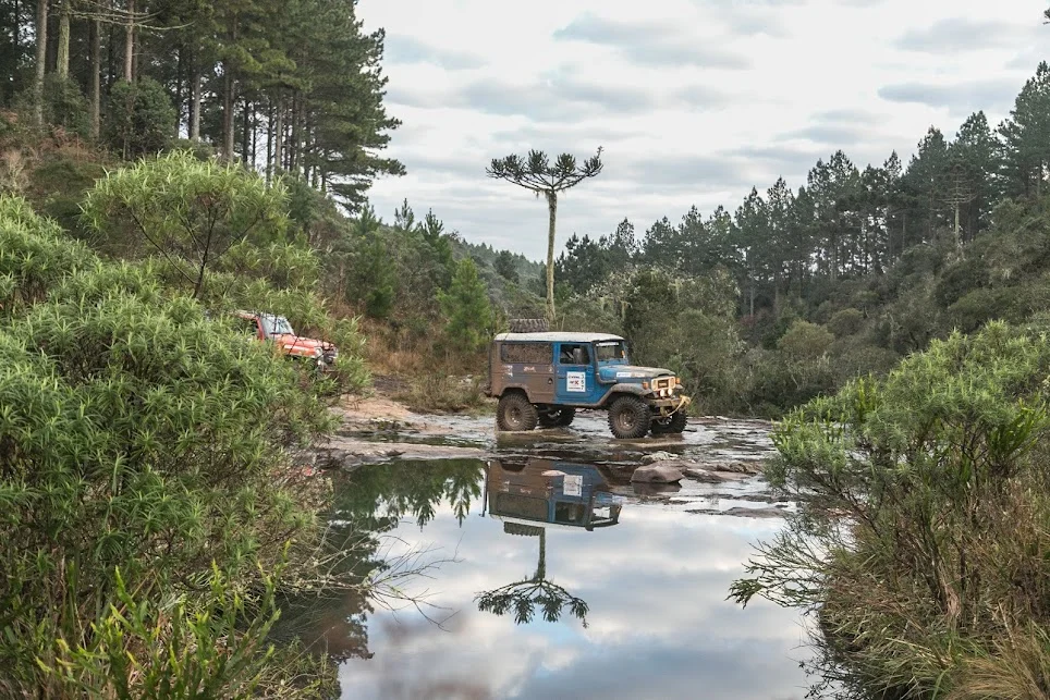

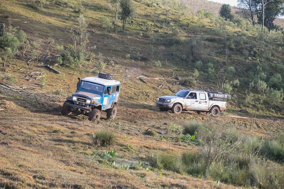

More photos, taken during 2019 "Transcatarina Rally" (a 500 mile long adventure across Santa Catarina state, in Brazil). The front bezel used to be painted in white, but were later reverted to black by mistake (funny long story)😆
