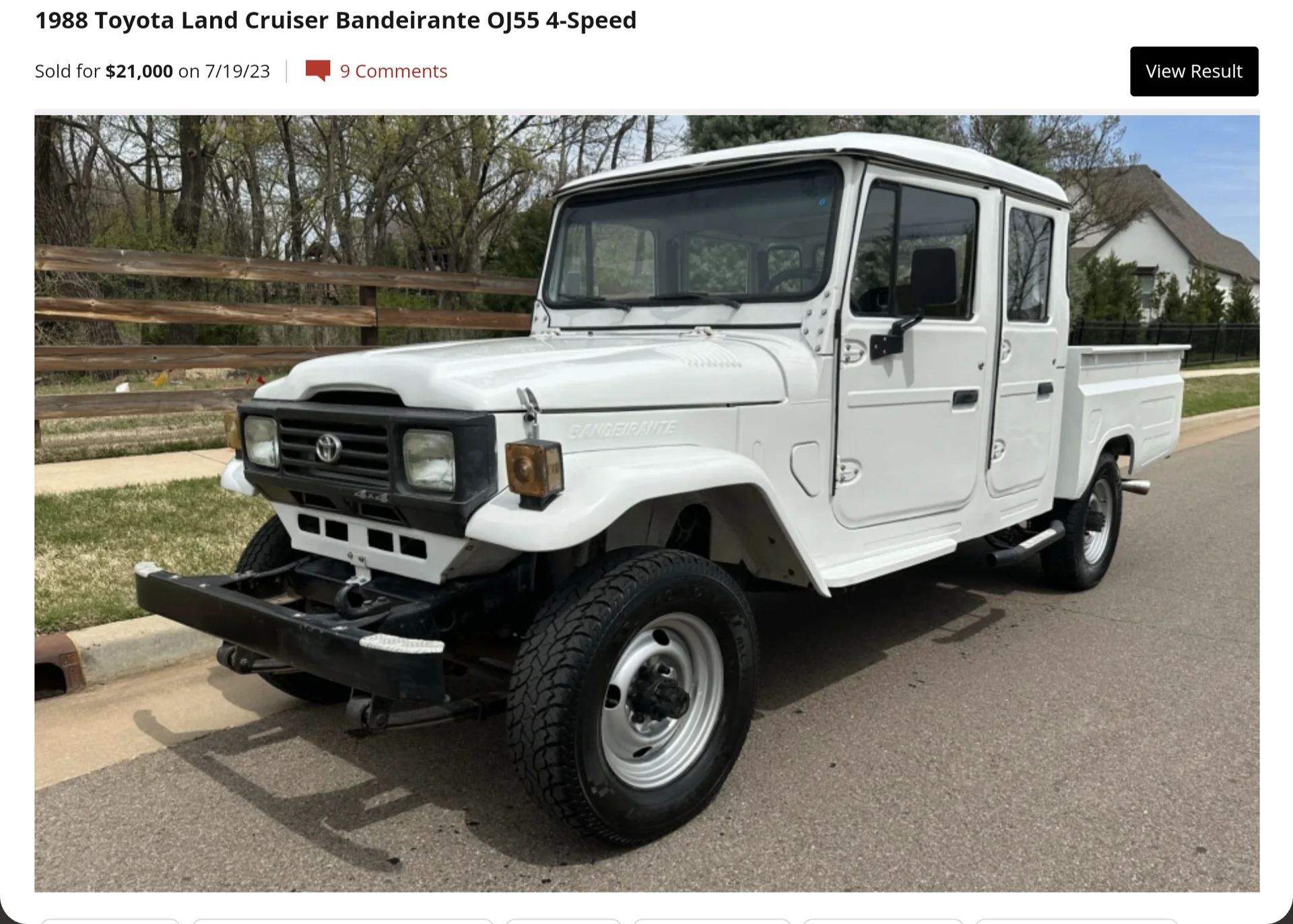

I just won one of the latest bringatrailer auction for a 1988 Bandeirante build! I love the way these Land Cruisers look and when I saw
a Bandeirante, I had to have one!

Congrats on your purchase mate! :cool:
Looks like it's going to need some work, but it's a good start.
PS. Great (and unobtenia) OEM Brazilian steelies!

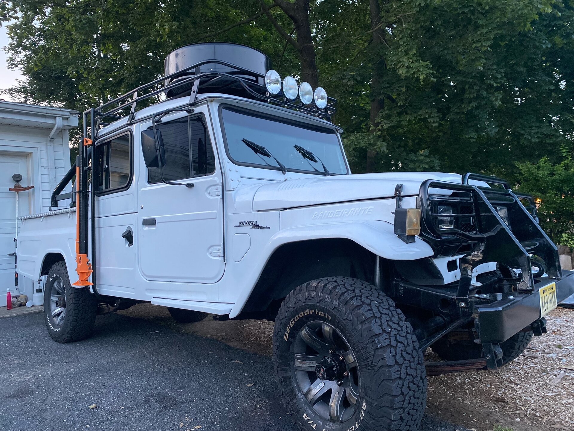

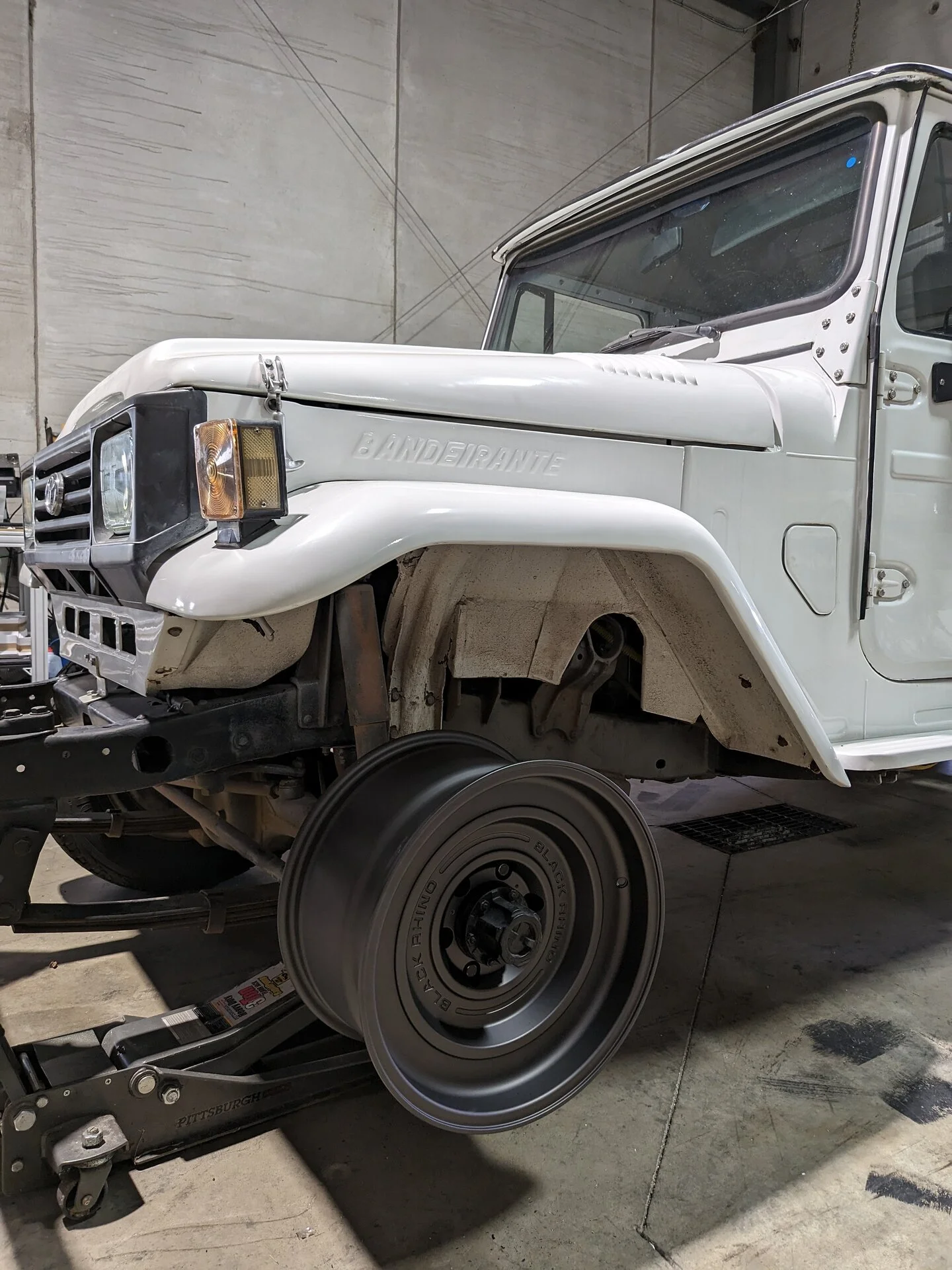

Thanks everyone for the responses. Yes, you guys were correct. There definitely is sub-par work on it, and welds from a 3 yr. old are seen on different areas. But fortunately nothing major. I'm still trying to figure out the lift. I'm looking at the SOA kit from Ruff stuff. Does anyone know if the axle housing are similar to FJ40 or FJ 60? I'll be getting the high steer kit as well.

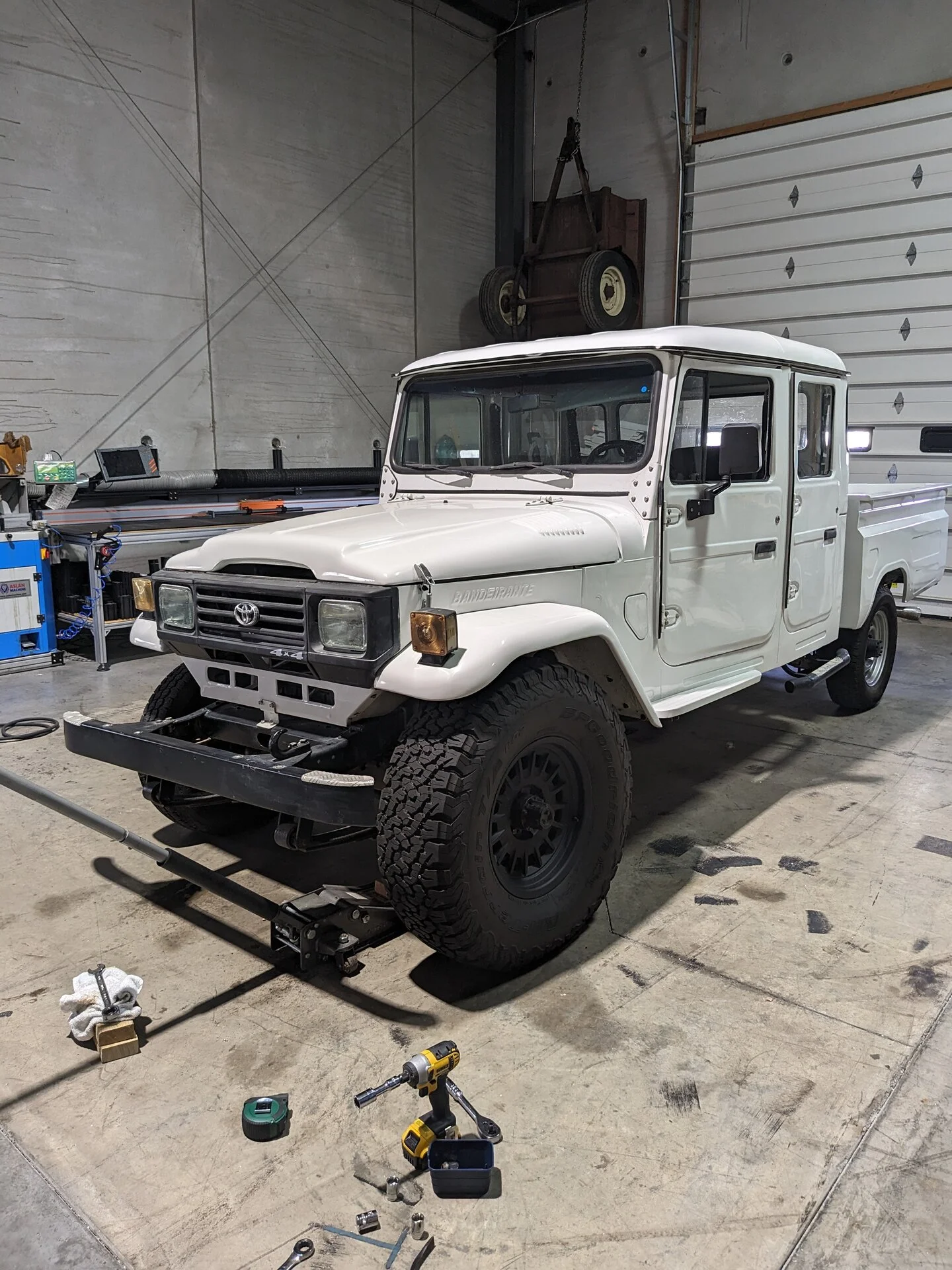

Besides the bib would switch to Toyota turn signals. Reminds me of FJ40s that people put a generic square tail lights up on the tub. What's on there looks like they were picked up a chain auto parts store.
On the bib the bezel changed 1/79. Heard years ago that was to move the headlights further apart for a requirement in Europe. But what also changed is it's thinner to make room for an A/C condenser. Just something to keep in mind.
Well, it's Toyota, but Toyota do Brasil :) THis it how they look down here.
I am aware that what was used down there. Just if plan to put a bib made in Japan might as well finish the look by using true FJ40 turn signals. These look like some generic sourced in Brazil not something made specifically for a Land Cruiser.
Already got a bib, bezel and headlights rings ordered. Lol. I'm also ordering several parts to replace in the interior and the vent window frames from Brazil, Here is the look in going for!
As for the turn signals, looks like these have 2 holes, vs the FJ40 1 hole mounting? I haven't looked into it that far to see if they're compatible.

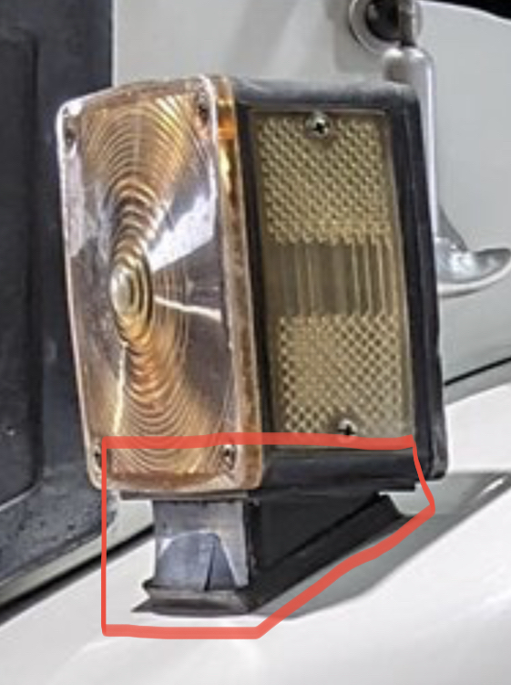

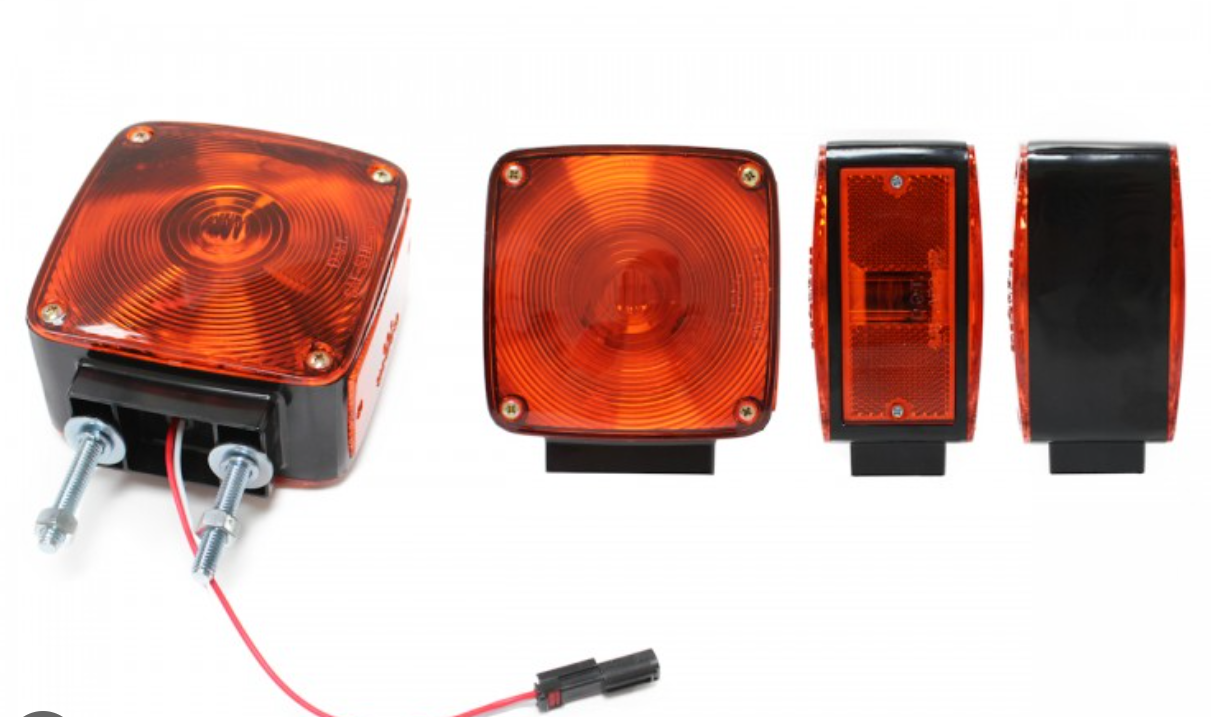

Modern Bluebird school buses have 2 bolts fender signals...Never actually bought it but looks like a good candidate.

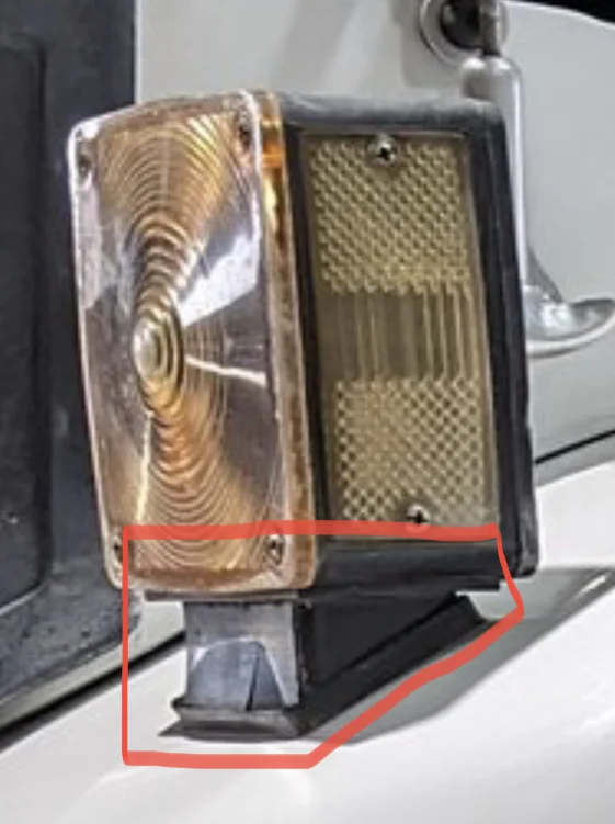

Zooming in on this Photo, it looks like a wedge beneath it. I suspect these lights are aftermarket and someone made a wedge to try to make them fit. But it looks like the angle is slightly off. :D
