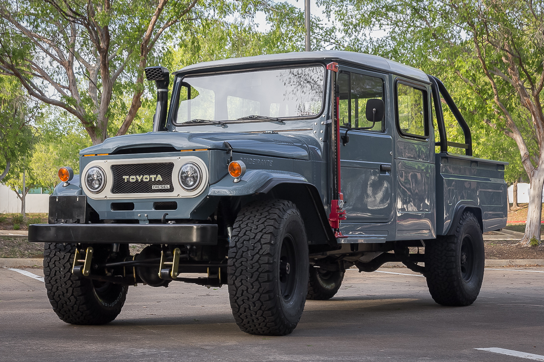

Besides the bib would switch to Toyota turn signals. Reminds me of FJ40s that people put a generic square tail lights up on the tub. What's on there looks like they were picked up a chain auto parts store.
On the bib the bezel changed 1/79. Heard years ago that was to move the headlights further apart for a requirement in Europe. But what also changed is it's thinner to make room for an A/C condenser. Just something to keep in mind.

The indicators are quite likely a local component. Changing them to OEM indicators may require some fabrication.
The 40 Series Land Cruiser front bib changed in 1979 to meet safety regulations regarding headlights separation. The headlights from 1979 to 1984 have an additional 1 1/4 in. (32 mm) spacing between them. Interestingly, it was one of the reasons why Land Rovers had their headlights moved outwards, but that is another story.
Bandeirantes got the newer front bib sometime in the mid to late 1980s. The square headlights appeared in the 1990s, at around the same time the Mercedes engine gave way to a Toyota 14B-T. It was an effort by Toyota do Brasil to keep interest in the Bandeirante alive. By then, new regulations allowed car imports, which included competitors like the Defender and the Pajero/Montero.
Market share and emissions/safety regulations led to the closure of Bandeirante production in 2001. Some 100000 trucks were built.
An OEM front bib may or may not fit the Bandeirante.

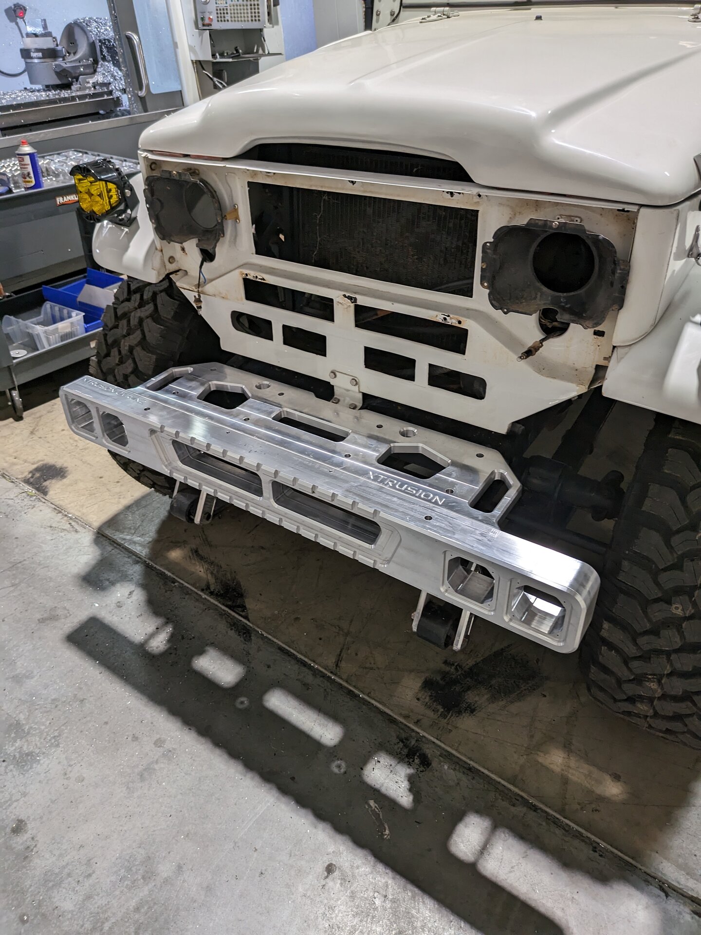

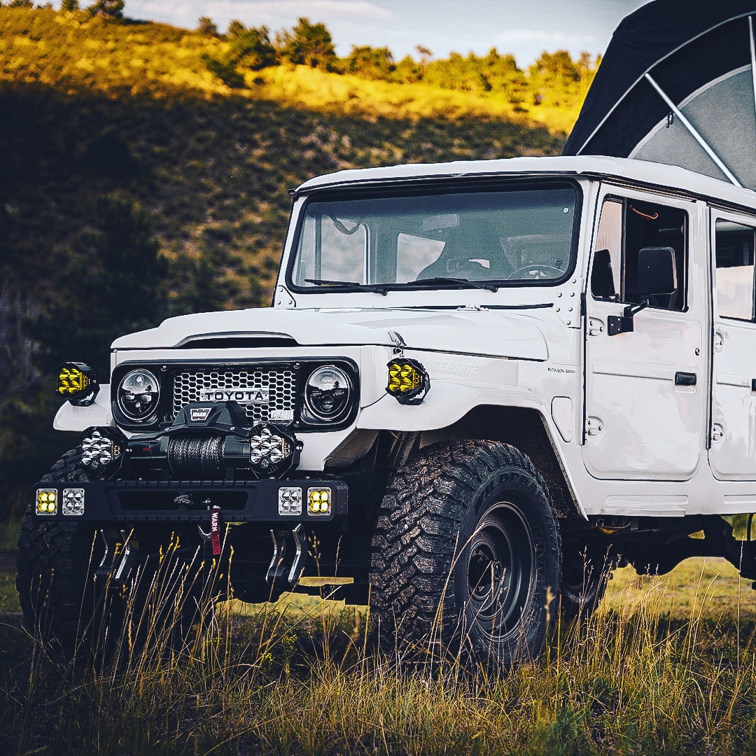

This was the end result for the front end refresh. Went back to '88 styling.
We machined our own bumper and Winch Plate, which turned fantastic.
However I still haven't done anything with the suspension. I just made shackles to lift it temporarily.
I have the SOA kit from Ruff stuff, and hight steer kit from Trail Gear, but looking to maybe doing 3 link front / 5 link rear.
Still sorting a lot of electrical stuff and gotta re-up the seat brackets but overall it's turned great.

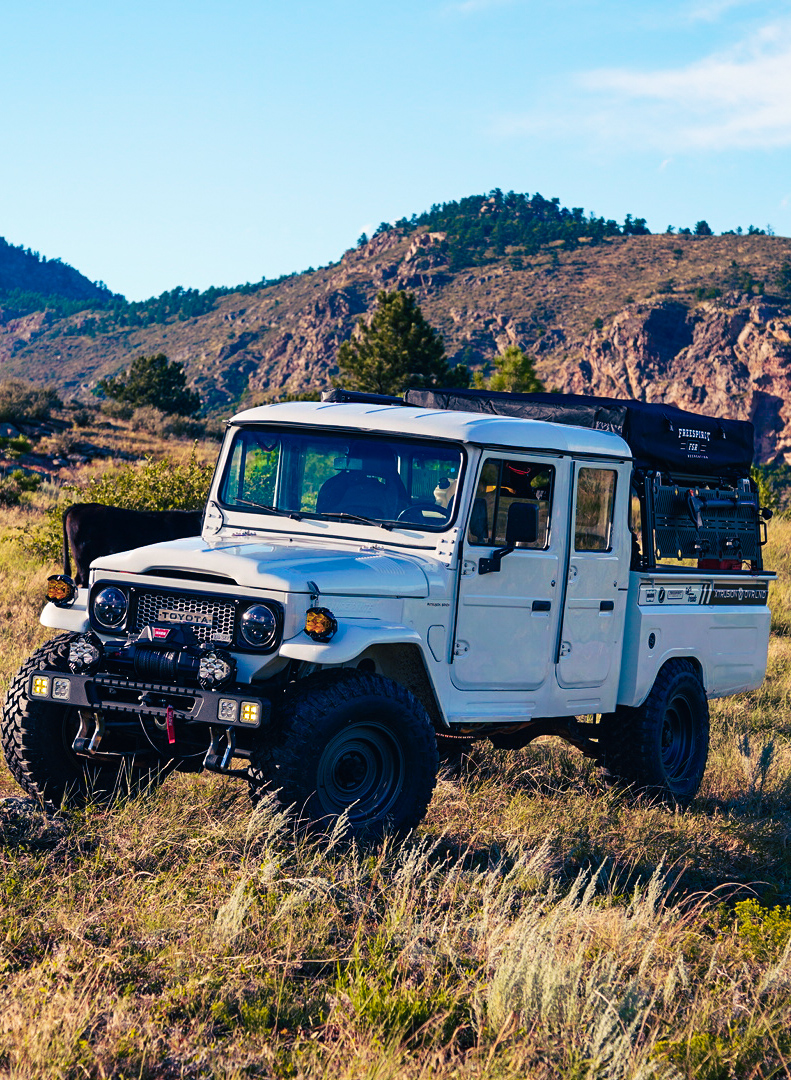

I installed 16x8 -13 offset wheels, my tire size is 315/75 16
The stock FJ blinkers work just fine, however, they stay a little inclined forward. But not a big deal.
By the way, I saw your truck at the Overland Expo in Loveland - CO
Your rig set-up looks awesome. How can I contact you to get a quote for the tent rack set-up you were using?
Awesome job.
