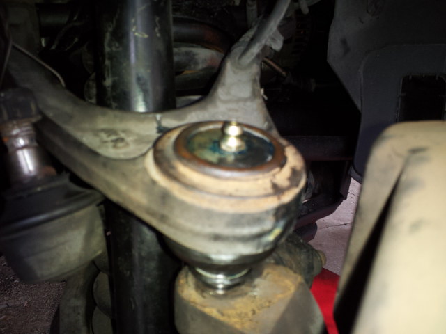

Doesn't look to me like the one with the torn boot was seated far enough into the seat. There should be more visible thread, and more compression of the boot, at least compared to my 555s. The other one without the torn boot looks right.
My lbjs were pressed all the way in gator. One concern at install was that they went in too far actually as there was a tiny space between the retainer ring and the control arm.There are other threads about 555 not installing properly btw. For me, there are no attributes of 555 bjs that meet the minimum standard for an owner that intends to invest in and safely drive a a tlc.

2. Paint with good quality sprayer the whole arm after installing the ball joint, but remember to protect the rubber boot. Or dont install the boot for the upper control arm till you finish painting.
3. For the lower control arm, the late versions of 555 boots are not good as the previous ones. So you have to install the OEM boots number 43345-69015. There's a pic down.
4. The big reason of the fail of the ball joint is that getting heated from the heavy duty jobs with no regressing, so the rubber gets stiff then fails and gets cracked. So grease it monthly from the grease nozzle that you followed in step 1.
