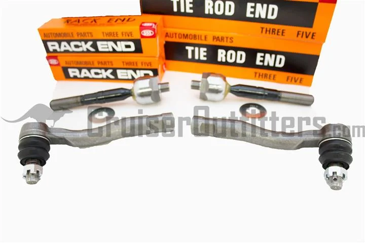

Says right on the top, 555. I replaced my upper and lower last fall with 555, they've been awesome. Other than the super minor disappointment that the top metal isn't sealed somehow and you need to hit them with a quick shot of paint, they're great. Thousands of folks in the LC community have been using 555 joints for TRE's, ball joints, etc. with no issues. Hit up @cruiseroutfit, he can tell you about the quality.
Genuine 555 joints are a fantastic replacement option. We've sold tens of thousands of their parts form applications ranging from rock-crawlers to desert racers and trucks driving around the globe. I've had them on my personal 100 for 40-45k now. We stock individual joints and full kits just for the 100/LX470 too

I've never seen Sankei 555 branded boxes before, always reboxed in another brand's box. Didn't even know they had their own branded boxes, pretty cool.
Got mine from Napa for just under $50 and they came in the same boxes pictured above.
Probably the same ones I bought. Altrom SB-3812
