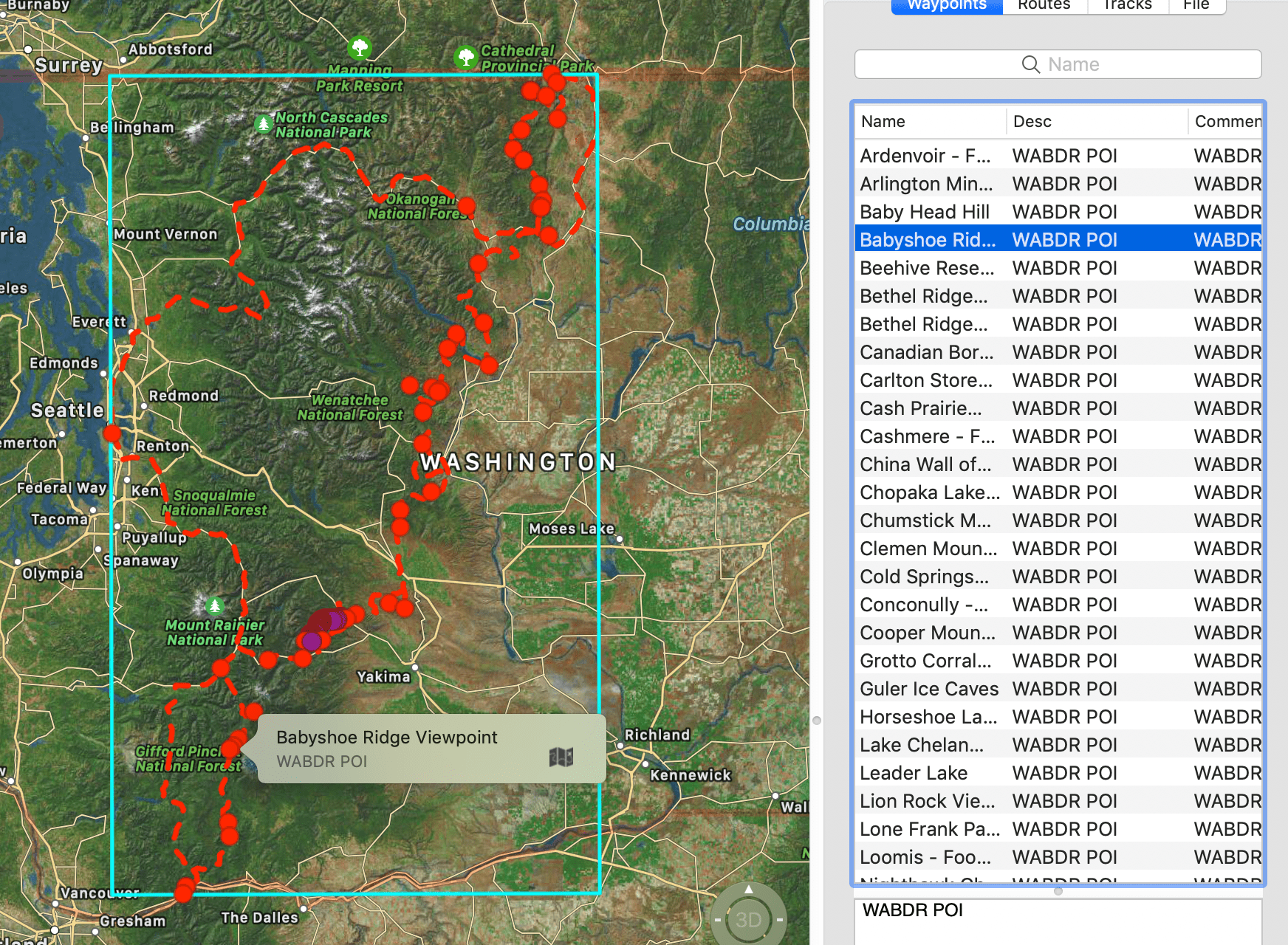

I am thinking about setting aside 5-7 days at some point in the near future to tackle WABDR or similar track in the Northwest to try backcountry driving/camping and would be very grateful if mud members can share their experience and gotchas in overlanding backcountry tracks. Aside from food, water, hygiene and clothing, items that I a more interested to learn about from you are:
- Your vehicle mods and recovery gear that was helpful during the expedition
- Fuel Supply (figuring out re-supply points)
- Tech and Radio Comms
- Preparing for Weather changes
- Terrain types and how it impacted your vehicle
Attached is the latest WABDR GPX snapshot from Washington Backcountry Discovery Route (WABDR)
Thanks!
