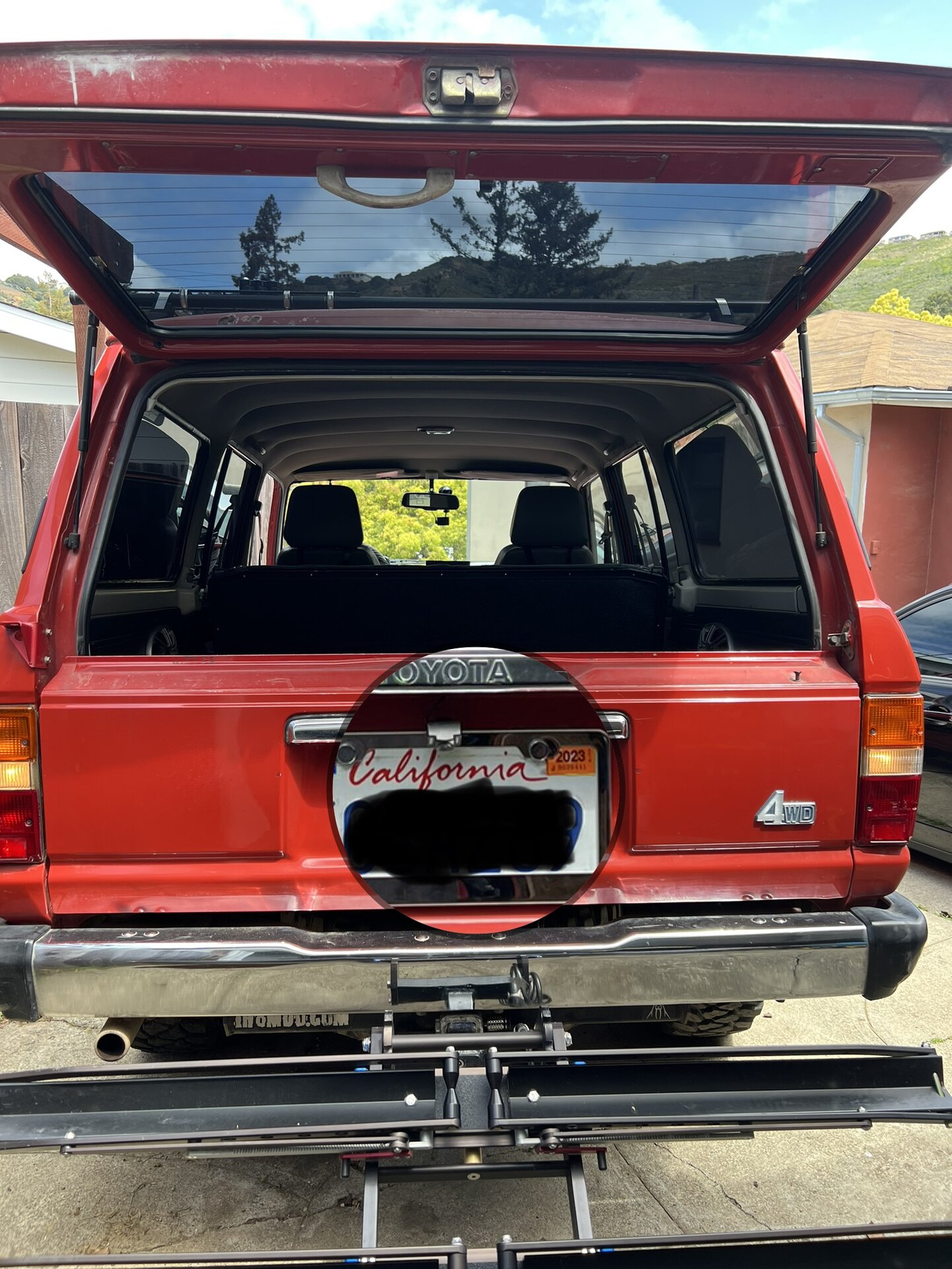

I finally got sick and tired of my mirror falling off in my hand every time I adjusted it. I ordered a mirror arm from Joey at (Witsend.com) it’s really nice and sturdy. I also ordered an Auto-Vox, combo mirror/back-up camfrom Amazon. My 07 Tacoma came with one of these aftermarket mirrors and I’ve become completely dependent on it.
Install was pretty simple. I tapped my trailer reverse wire, which came right off the tail light pig tail. I found some solid metal in the rear quarter for ground.
Here’s some pics…

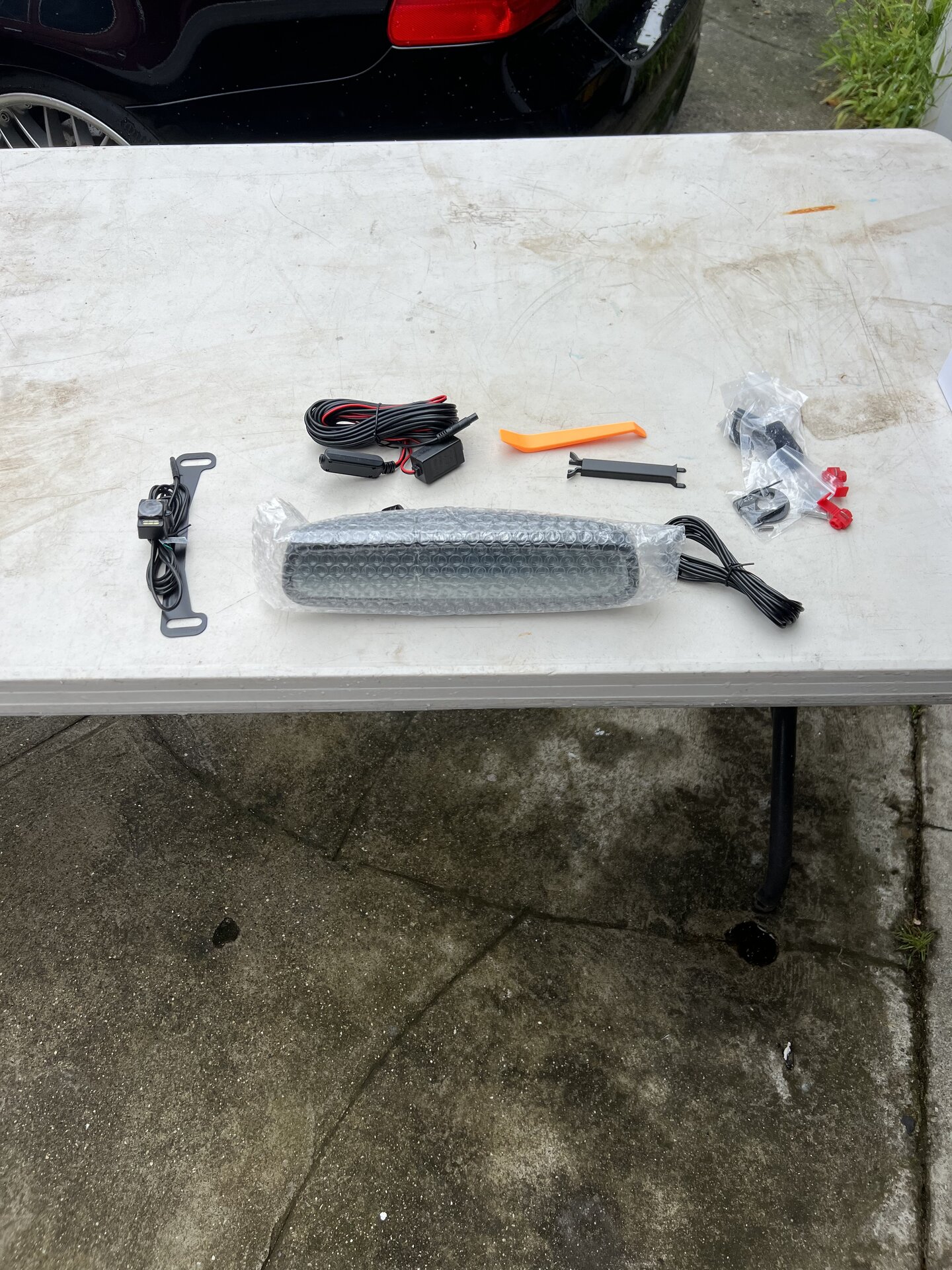

Here’s the kit from Amazon

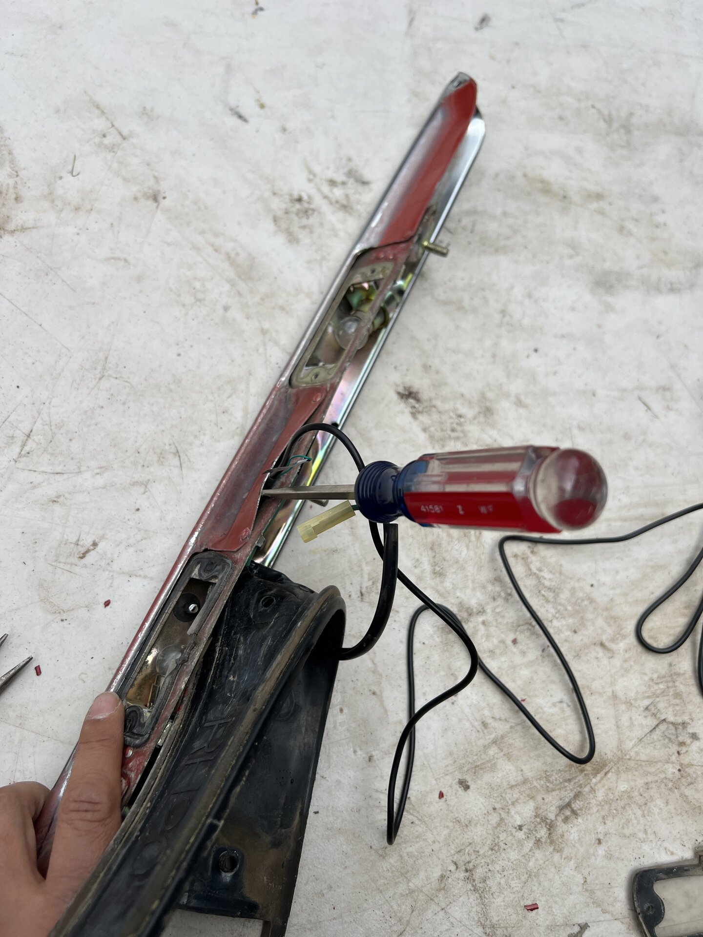

Removed the plate light assembly as you need to feed the wire thru here. You have to remove the rear door carpet kit to get to the 3 nuts holding this on.
Fed the wire thru here…

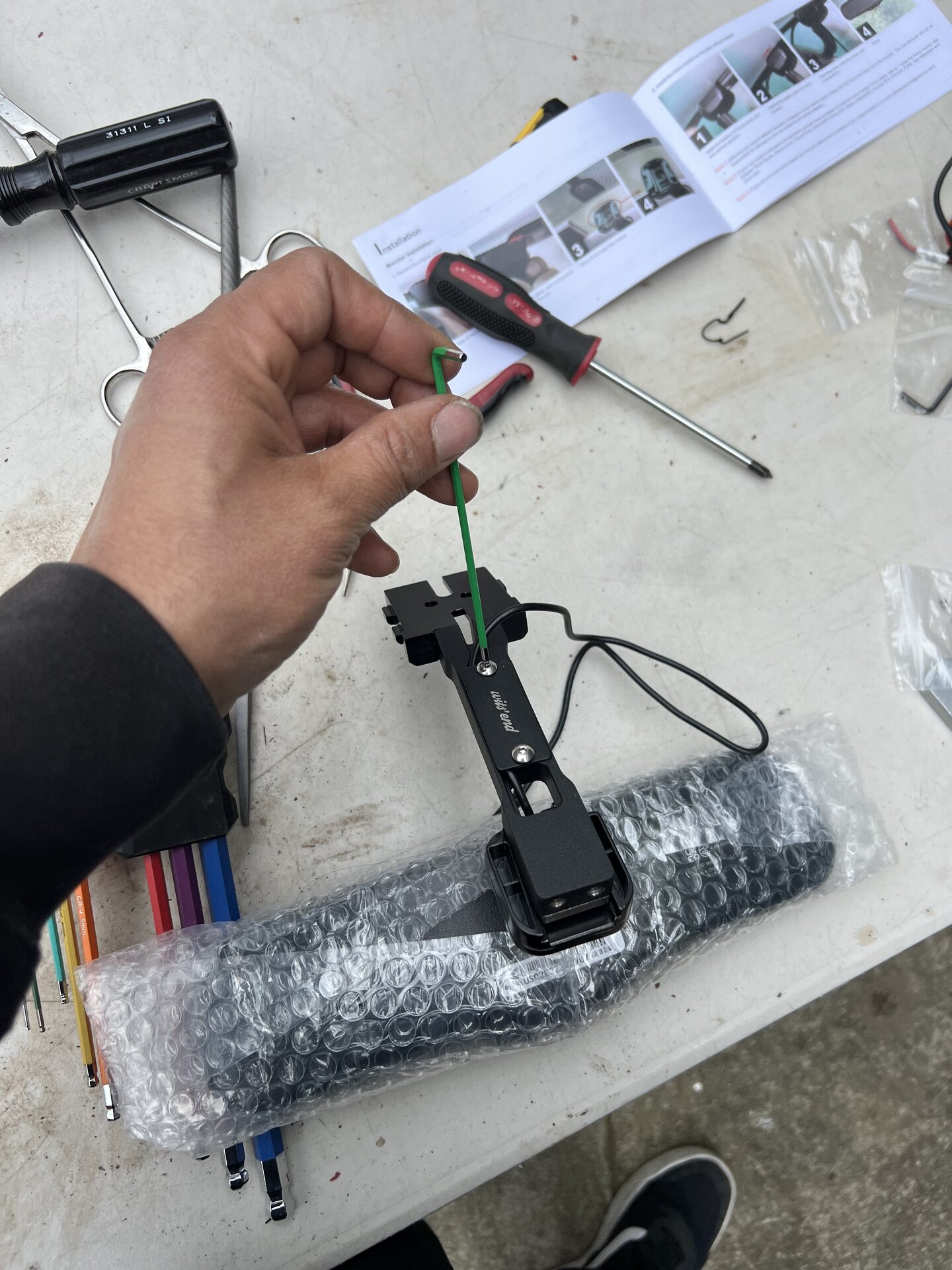

Here’s the arm from Wits End. You don’t need any of the adapters from mirror kit. The Wits Wnd one mounts right up. You tighten it down with a small Allen wrench.

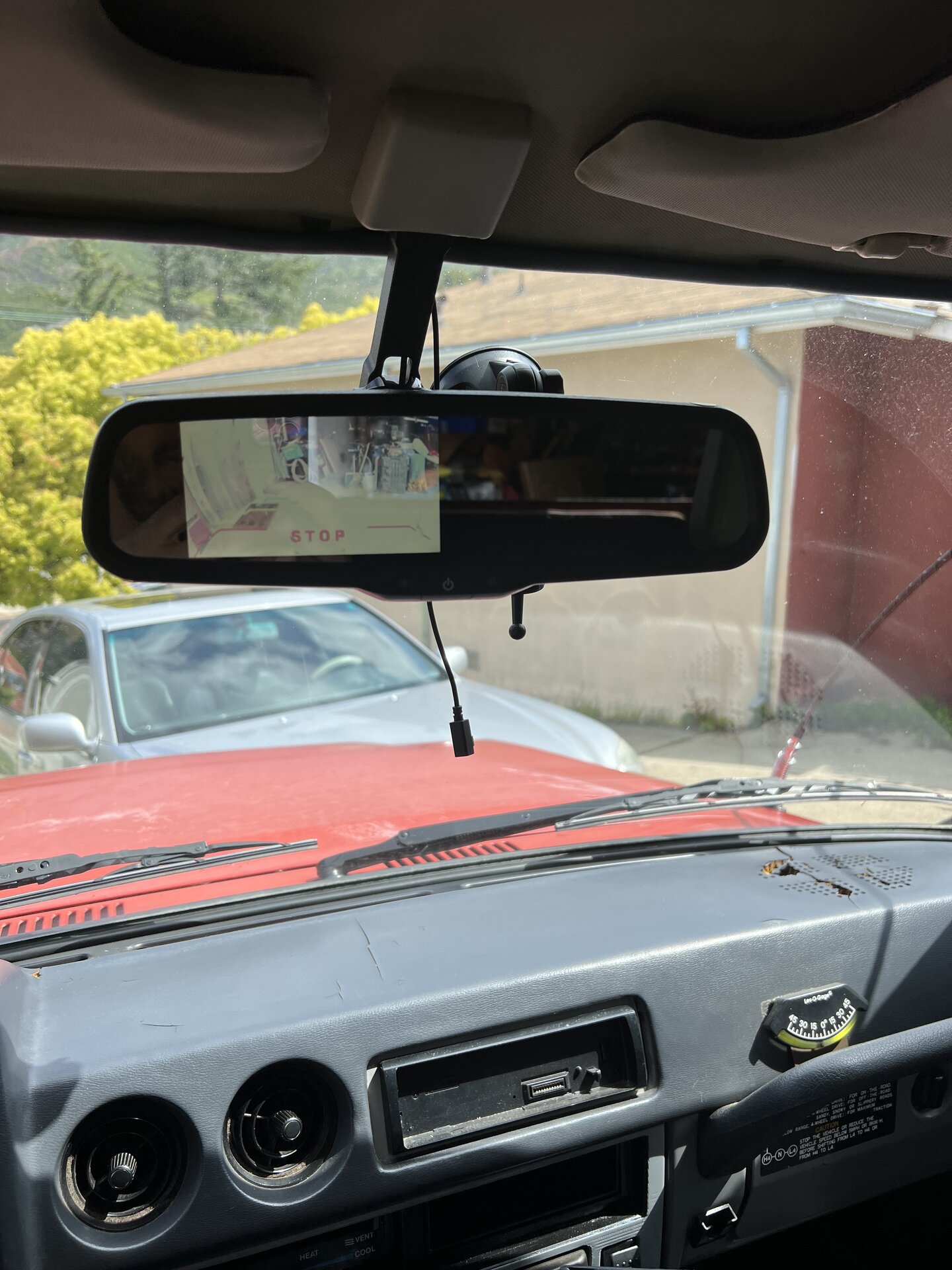

Mounting the mirror up to the arm.
I cut a slit in the driver side plug in the tailgate to run the camera cable thru. Then I just ran the cable under the back end right next to the eye hole for the spare tire rod thingy and zip tied it off to my trailer wiring below my bumper.

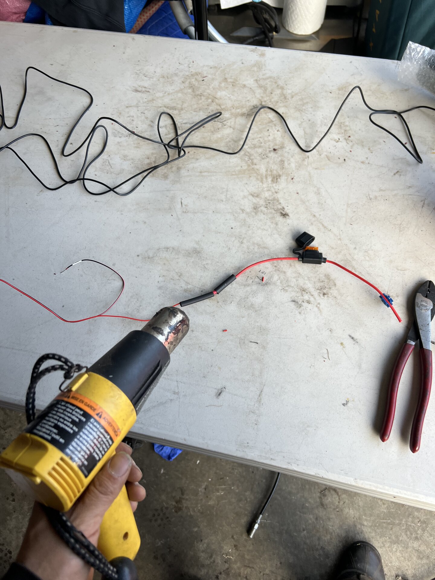

I had a 10 pack of these fused cables laying around that I got on Amazon so I used a 5amp fuse.
Little heat shrink…

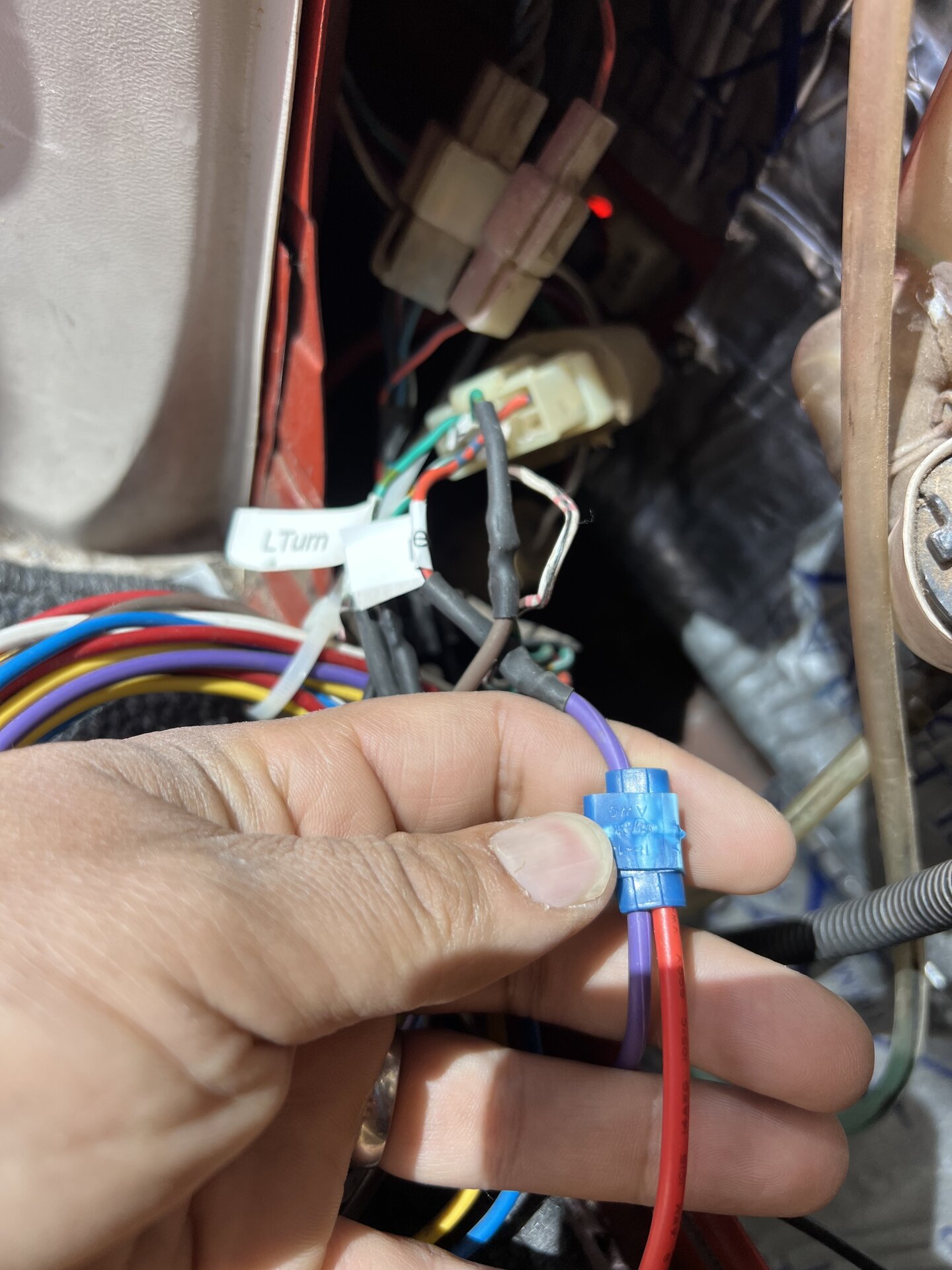

I jumped into the driver side rear quarter of the truck here with my trailer lighting enters the truck. No drilling!
Doh! I don’t have a good pic of where I tied in at but it was right off the t alight pigtail. I marked them all with my P-Touch back when I wired it all up for my trailer so it was super easy for me to locate the reverse light wire. I’ll go back in and snap a pic of it later if someone wants me to…

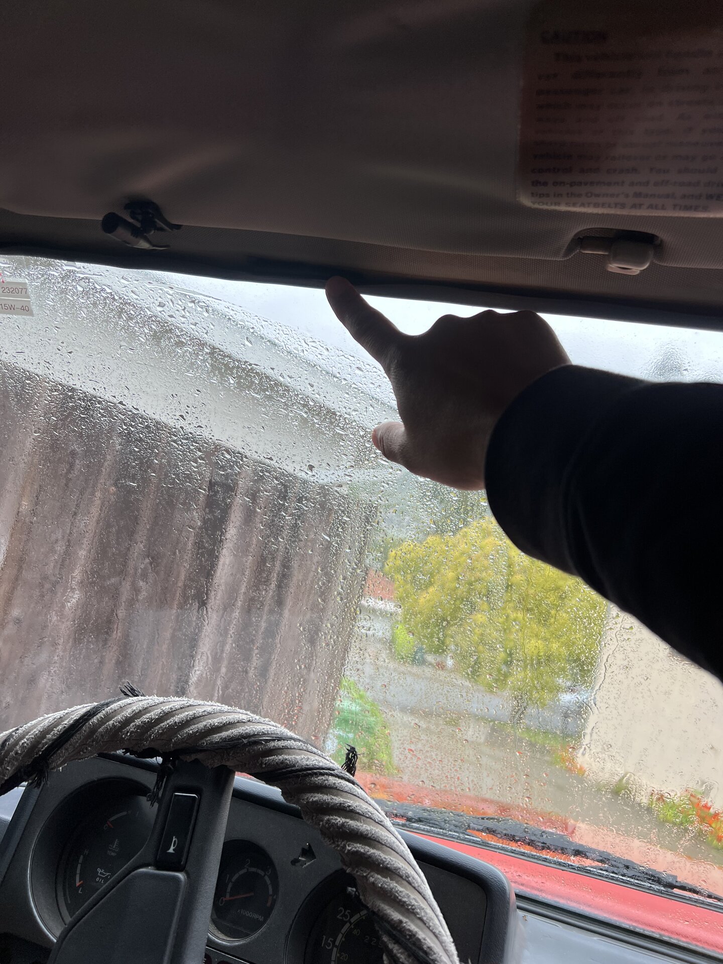

This is awesome. I had this on my build sheet as well! Glad to see your solution. How did you run the wire in around the windshield to avoid headliner?
Ugh… removing the headliner would definitely be the better solution. This brings me to my one complaint about the mirror... The connector is too close to the mirror (about 12”) itself which means you have the connector to deal with in the headliner routing.
The connector… Wish it was like 6’ instead of 12” from the mirror.
I used the orange pry tool to push the wire as far into the rubber seal channel as possible. Mind you I’m also running my stereo cell phone mic wire in this channel as well so it’s a bit crowded. The other side has my dash cam power cable running in it.

Ya know… there’s a bunch of old wire between the battery and that reverse tail. I’d rather blow a fuse than blow the mirror up.
I’ll try and pull the cargo panel tomorrow morning and snap a few picks.
Nice report, adding my own backup cam to my new stereo head unit soon. Why did you add the 5A fuse in the way you did and can you detail here you ended up putting it? If you have it all still open, it would be great to see how you have added both your trailer wiring and your backup cam into the same spot without making a mess of connections off of that single reverse light wire, something I am thinking about as I consider adding a third addition, a backup light off my new roof rack as well.

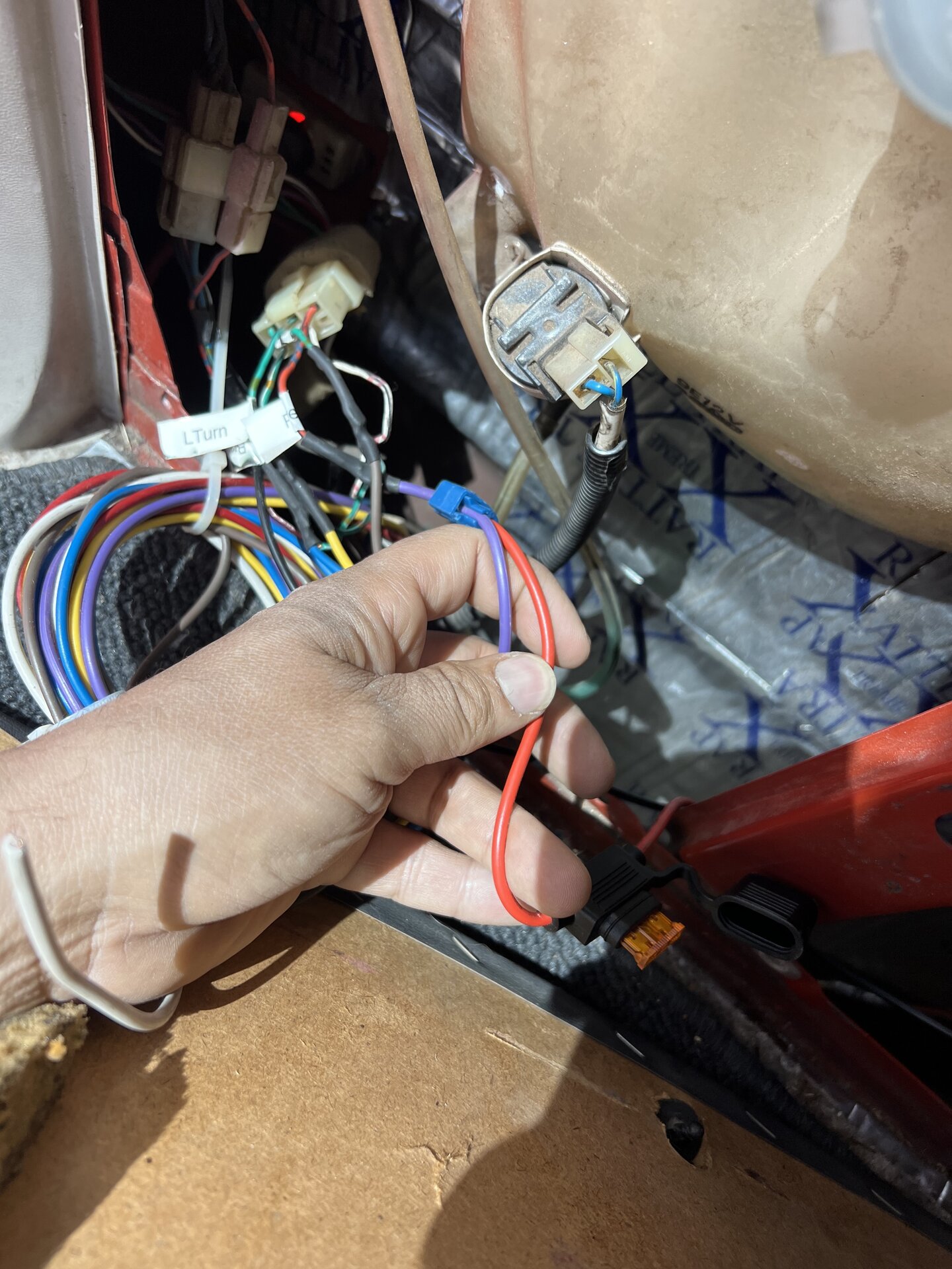

Here’s a couple pics of the tail light pigtail.
This is the reverse wire.
How I jumped the mirror in with a dual wire splice clip.
Extra trailer wire…
