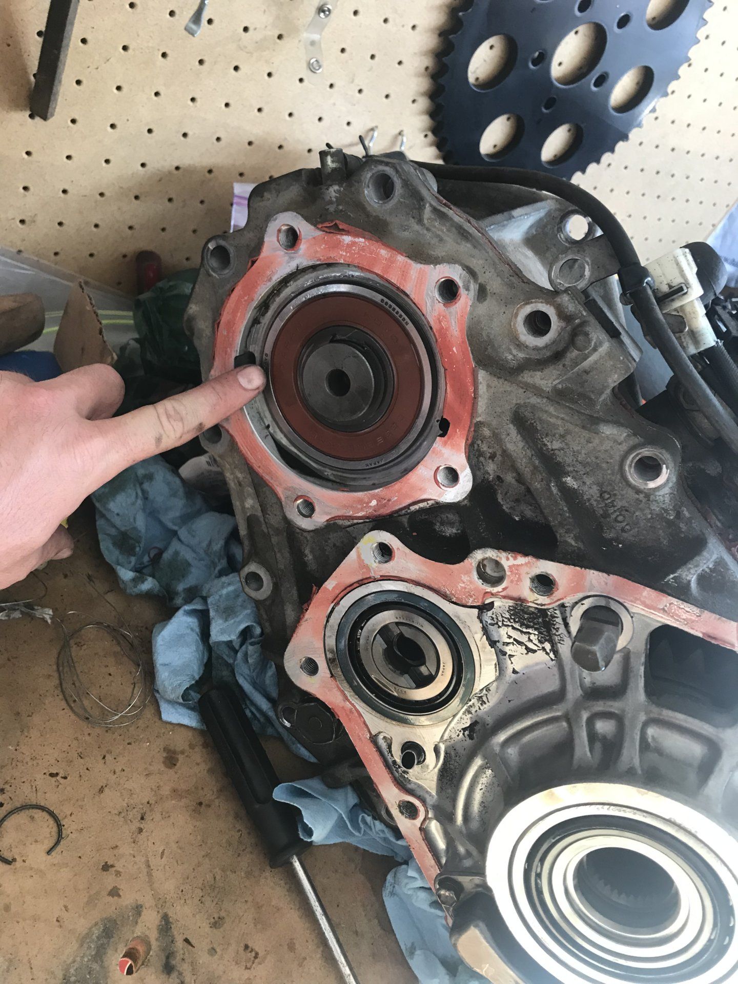

I can’t get the bearing I’m pointing to in the picture to not come with the cover as I’m trying to separate it from the case. It’s like the bearing has a lip that will not let it come past it (yes I removed the clip). Any ideas or is this a non issue of the shaft and gear come out with it?

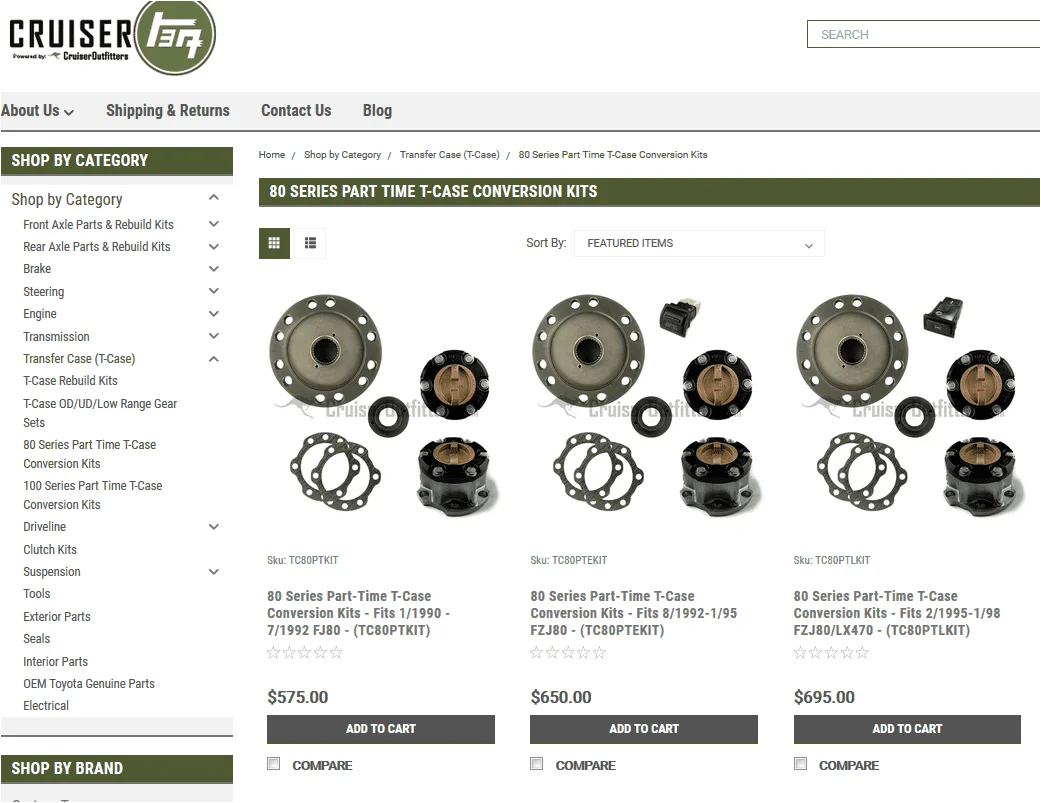

What do I need for a '91 HDJ81 auto, to make 4WD switchable? I do have center diff lock button on the dash and manual Hi-N-Lo lever.

I’m still waiting to confirm how to get the cover over that bearing. It looks to be all gears. It’s not a very hard install at all so far. I would be done already if it wasn’t for the weekend and the hang up on the bearing.
Thanks
You would need Part# TC80PTKIT - $575/kit
Fits 1/1990 - 7/1992 FJ80 or customers who already have a Center Diff Lock Switch
Includes T-Case Spool, 2xAISIN Hubs (Gold, other colors available) & Hub Gaskets.

I can’t get the bearing I’m pointing to in the picture to not come with the cover as I’m trying to separate it from the case. It’s like the bearing has a lip that will not let it come past it (yes I removed the clip). Any ideas or is this a non issue of the shaft and gear come out with it? View attachment 2077674
Did you get this sorted? If not give us a buzz at the shop
thank you for the part number, how hard is spool to install?
That will be quite relative to your skill level, most don't find it terribly hard. 3-4? hours all said and done for a spool install
