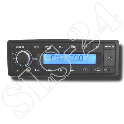

So I found a Clarion 24 volt stereo for $250 dollars. Unless you guys have any better tips for a 24 volt system then I will lean that way.
I put a 24v VDO deck in my 60. Got it off German eBay.
It's been decent for a couple years now. Ended up being similar money. Think it was just over 100 euros or something?
Probably more now I guess.
I like the simple 24v deck solution. I tried various 24/12 converters in the past. You can get cheap ones that'll run a stereo easy enough.
They're fine as long as you don't need the memory wire connected. Then it all goes to s***.

This is the 24v deck in my 60.
Got me curious what they were worth these days.
I paid 107 euros, now it's 139. :meh: .
No complaints so far, pretty simple. Plays Bluetooth music off a phone, or you can put a usb stick in.
No cd player.
did seem kinda sketchy ordering from Germany but it worked out I guess. There's a few variations of similar decks on there. Used in the big highway trucks over there I think.
