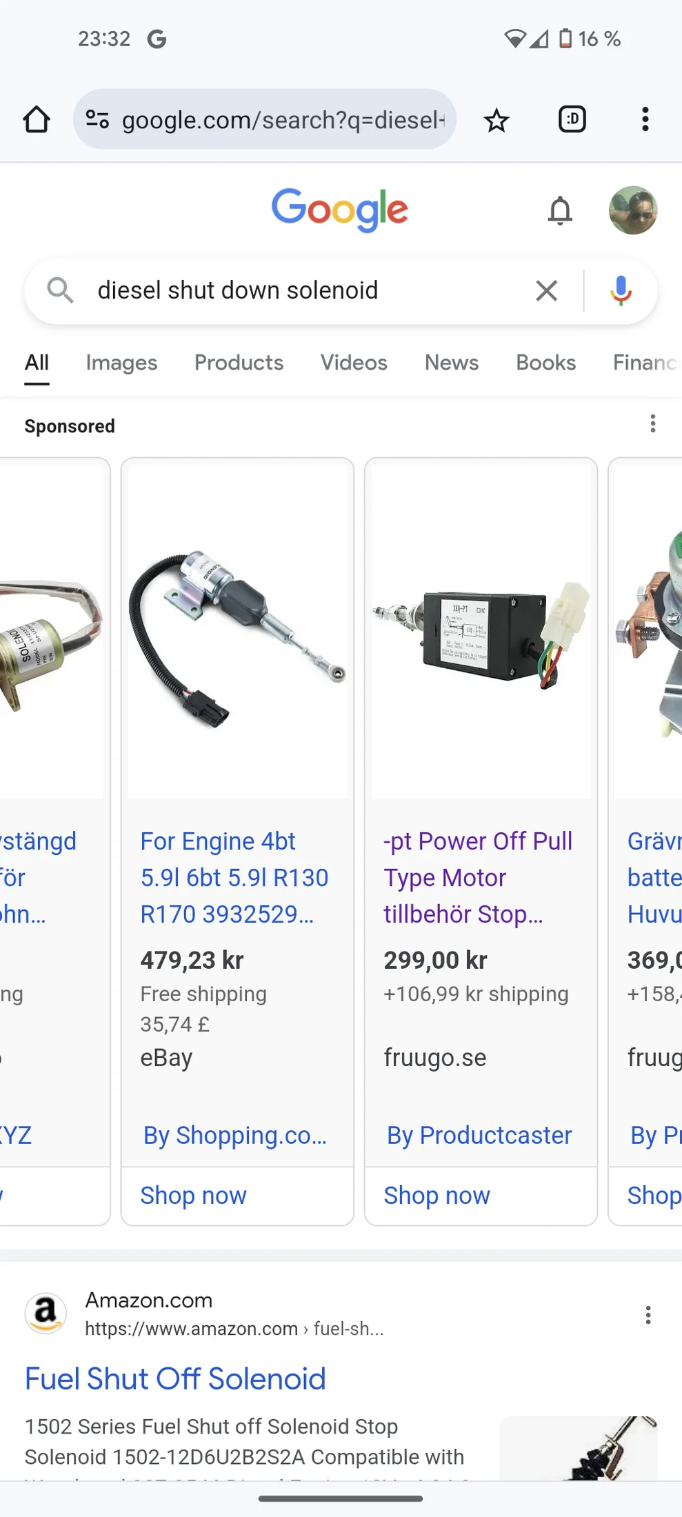

Searching for flamout solenoid valve finds an awful lot of solenoids that look like they'd work, ranging from cheap and Chinese to more expensive German ones...

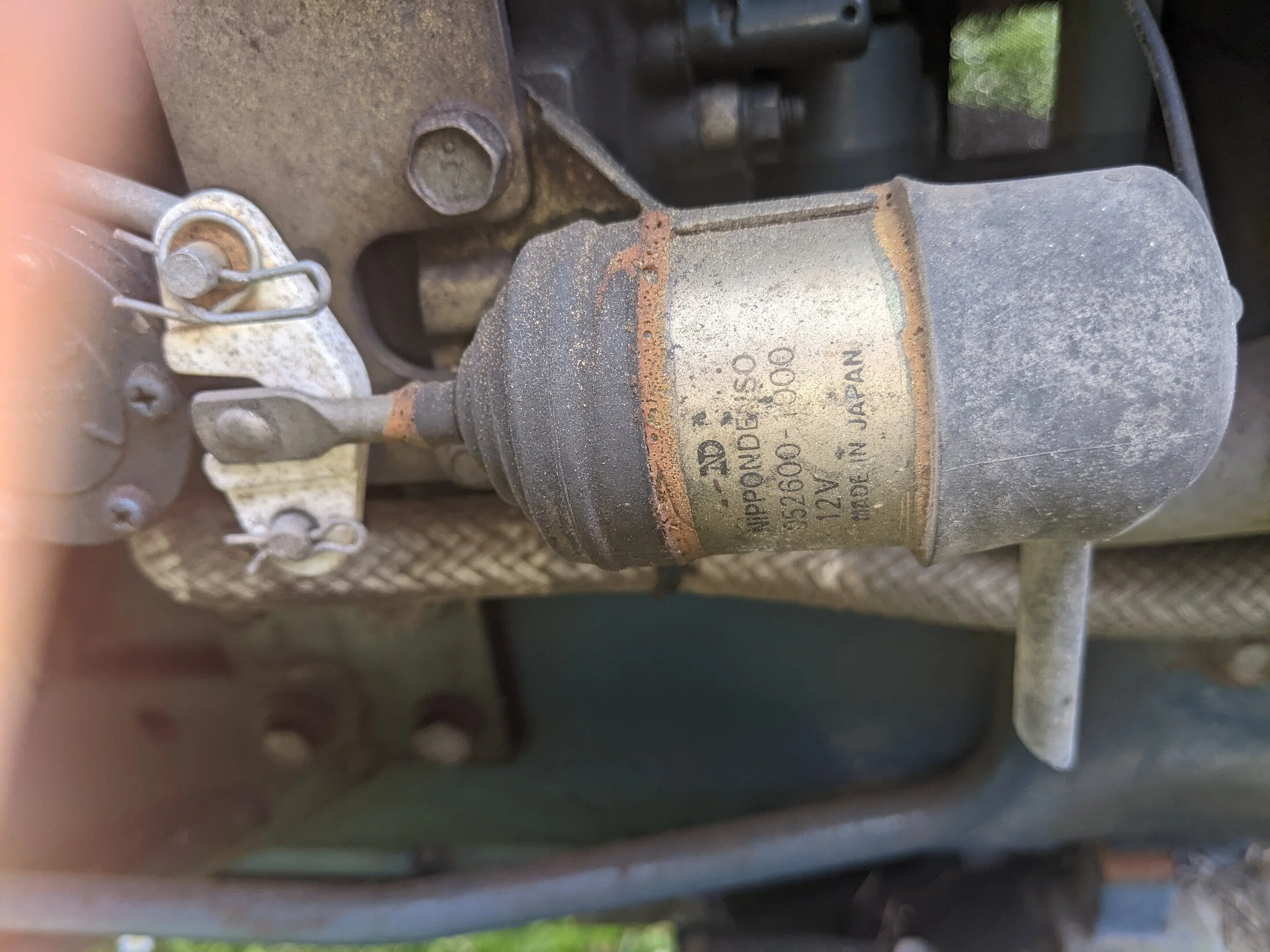

Not to hijack the baby blue thread, but this is what the Kubota has.
Interestingly, when key is turned off it pulls for 5-10 seconds, then relaxes. Only 1 wire to it .
Electrical system on the Kubota is a joke, (2 fuses) but something must be controlling it.

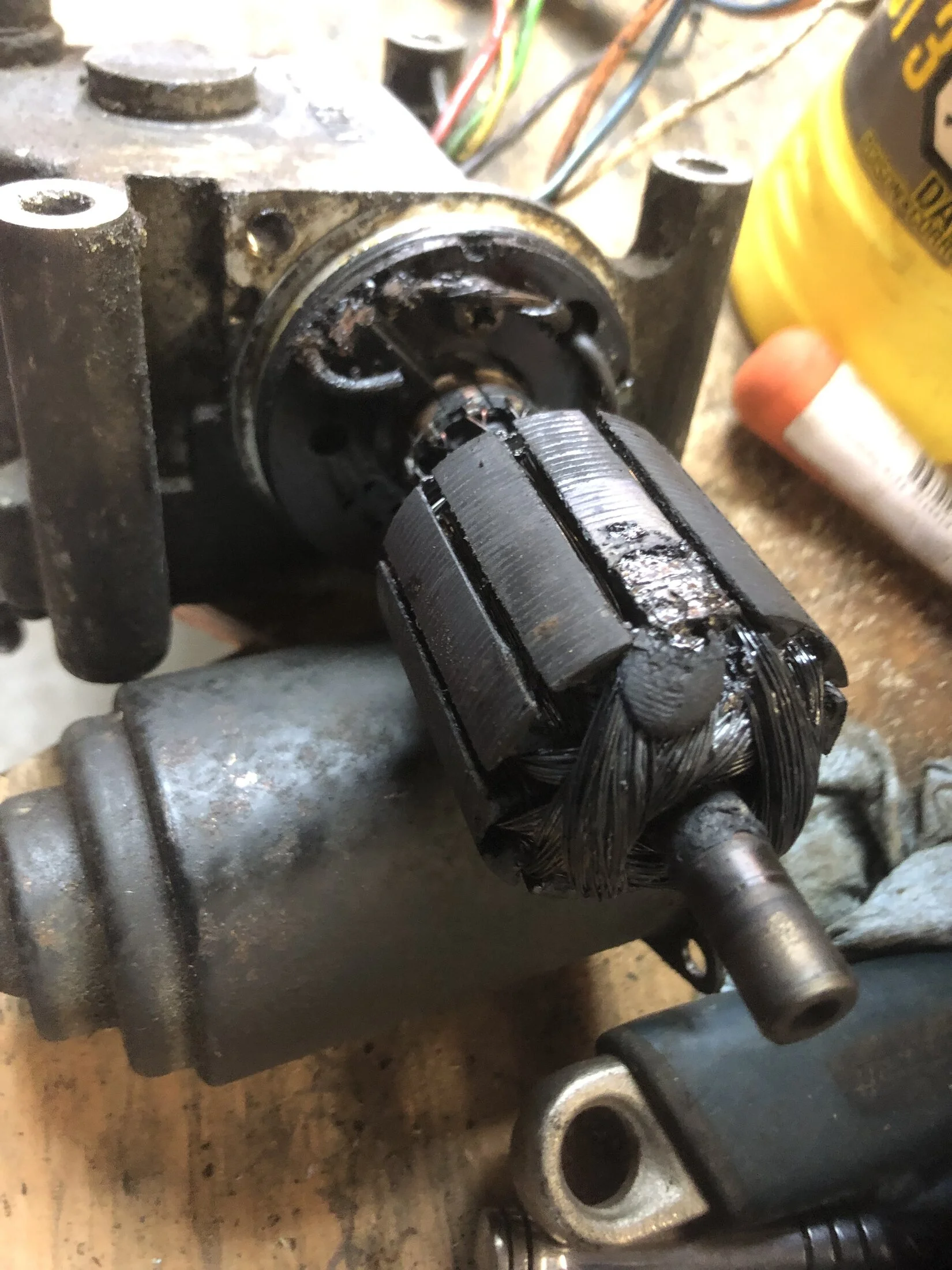

well after inspecting the fuel control relay and confident that it’s not the problem. I redid all the crappy wiring to the edic just to plug it in and arching and smoke in one of the wiring harness plugs. It melted one of connections half way down to the stub. So I went deeper thinking it had melted a wire and it’s grounding it self out Just to find this. This edic motor is pooched.
Anyone have a spare 24v edic? I’ll trade for a 12 volt one or cash?
