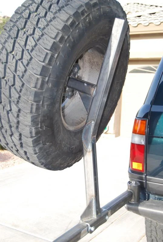

almost got it done. worked on it on saturday. just a few small things left. loving it, thanks alot Brittan.
Do you think you mounted that spare high enough?:hillbilly:
Looks good!:cheers:
Do you have good rear visibility with the tire mounted drivers side biased and that high? It seems to be a hindrance, no?

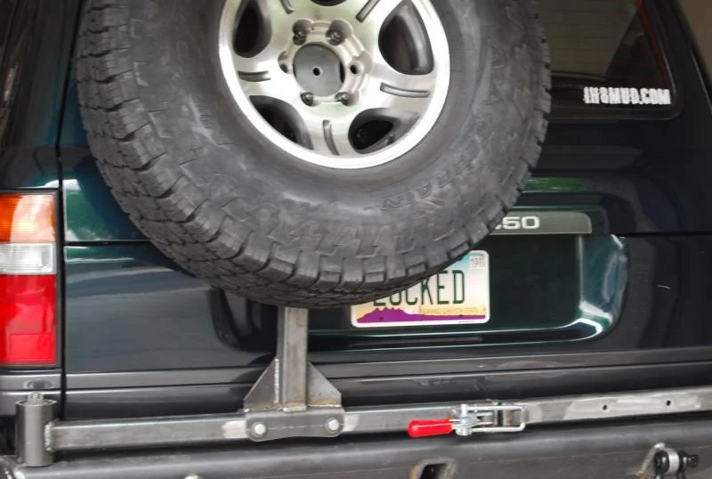

Oh, its definately high enough. I dont see myself scraping this thing on the ground. Plus it allows the license plate to be seen in its stock location, without moving it over. It does block some visibility, but between the PS rear view and the 2 side mirrors I see everything. Right lane change is the same, and a left lane change is always done with the side mirror anyway. Oh, and heres something I noticed and showed Brittan and Jackson after it was mounted. From the DS, at a angle looking at the plate, my LOCKED plate could be interpreted something profane. Do you guys see it?

... Oh, and heres something I noticed and showed Brittan and Jackson after it was mounted. From the DS, at a angle looking at the plate, my LOCKED plate could be interpreted something profane. Do you guys see it?
That's perfect,,, for you!:o
The spare mount looks very close to the hatch/window. They always flex/move some, the higher it's mounted, the more it will move, have you stress checked it for contact? Then again, taking out the window would be good entertainment,,, for us!:hillbilly:
Yeah Kevin, we pushed on it pretty good to see if it makes contact. It didnt. Plus, it will hit the tailgate before the window. Brittan is going with the exact same design, except the back support bar is going to wrap over the top of the tire so he can mount his HAM radio antenna.

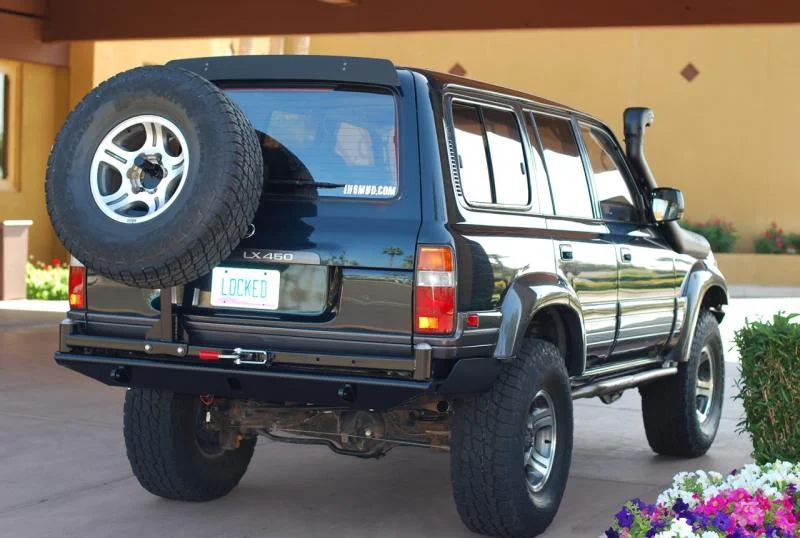

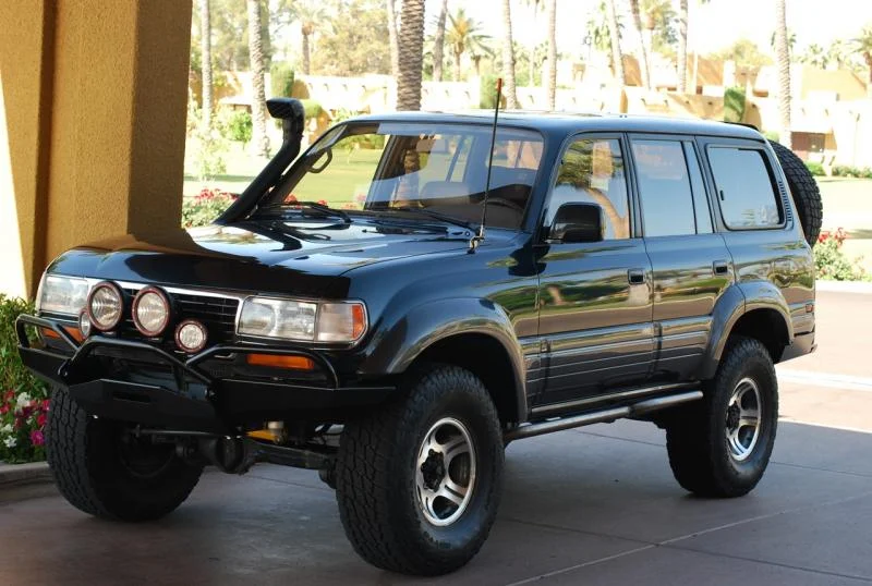

the finished product!!! washed up and ready for Moab on Wednesday. Couldnt of built the rear bumper without the assistance of the great guys in CSC. You guys are awesome.
Very nice!
Why no tubing on the wings?
just didnt like the looks of them on there. It looked like even if I angled them out as far as I could, they still wouldnt fully protect the flare. Im sure alot of guys would of put them on.
