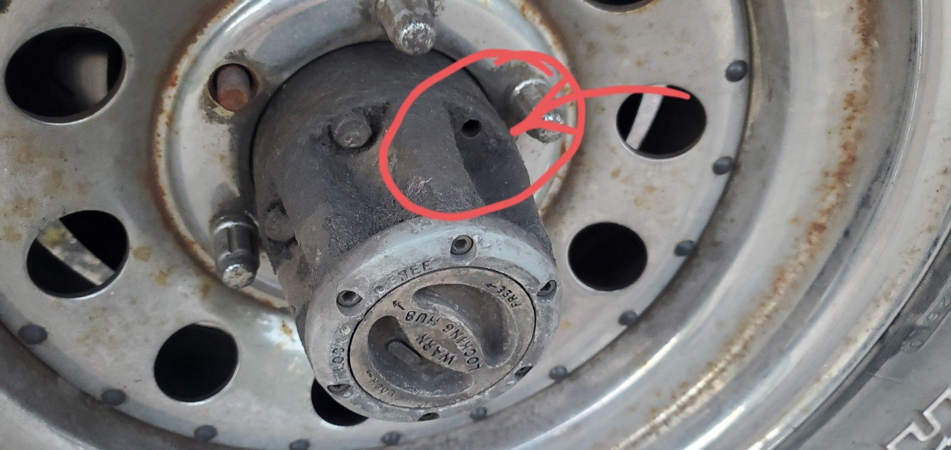

Hello and thanks in advance for any advice. I recently purchased my brother 40 and it needs some bolts that are missing from the axle cap. Curious if anyone can point me in the direction of replacements or alternatives.

I used this set and switched from bolt to stud.
I'd do that but I am not in the same place as it is. Trying to be proactive. Worse comes to worse...ill do that when I go pick it up. Thanks for the assist.
You could always pull one of the existing bolts and buy matching ones of a grade 8 or equivalent. It's pretty easy.
M8 x 1.25 x (25 or 30) should do it
that one bolt is not critical and you can safely drive without it.
