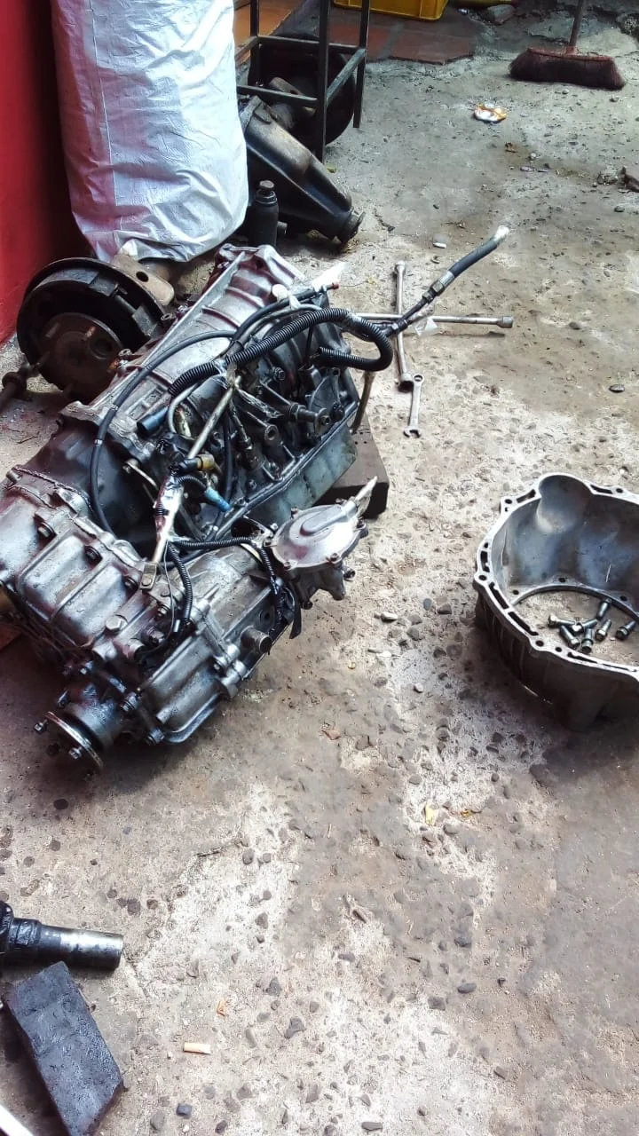

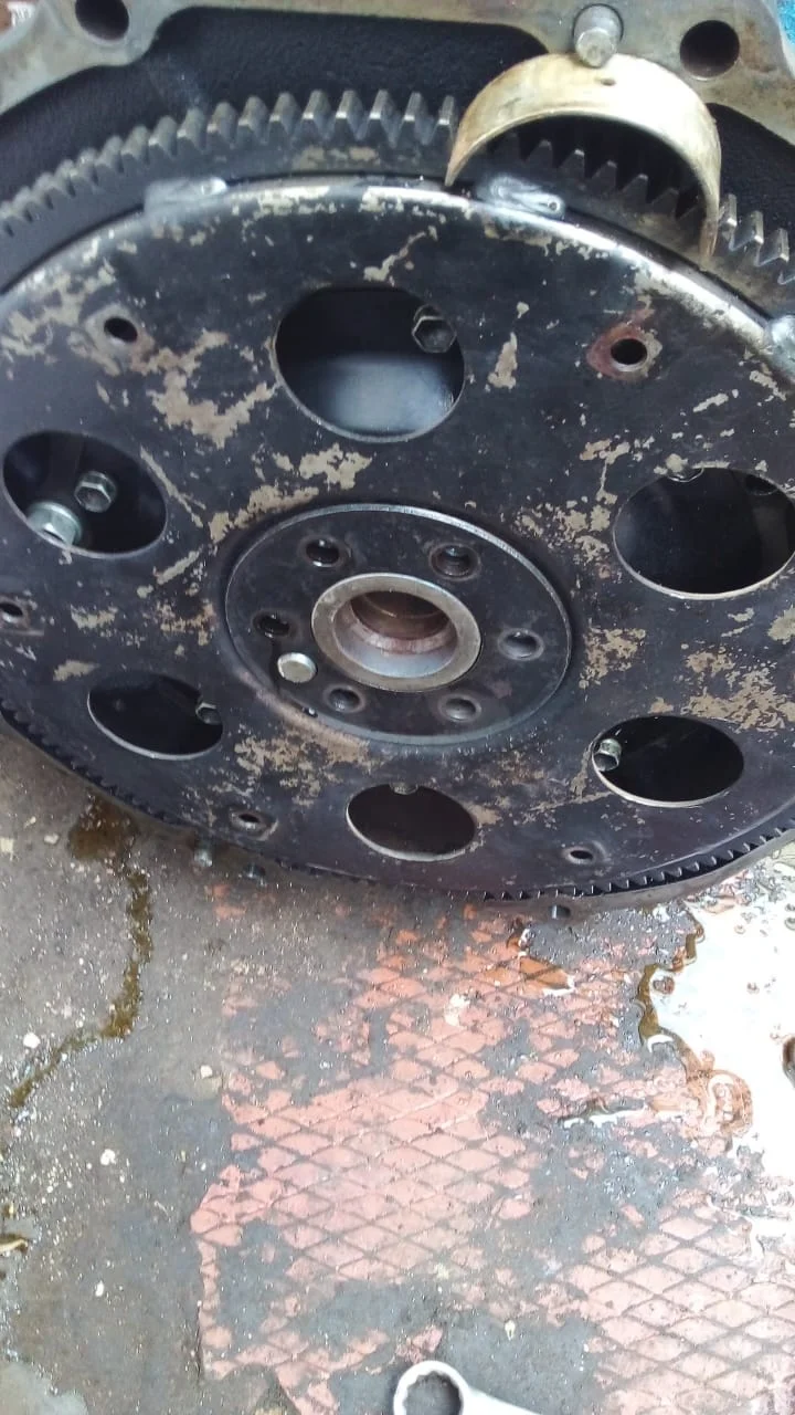

Hello everyone. I'm working on my FJ 40 and I want to change it's transmission for an FJ 62 automatic transmission. Do you have any suggestions?
Please check out all the photos.
it's possible but very long and will most likely cause issues with the rear driveshaft
When Downey Off Road Mfg. made an "only one on earth" adapter to put a 700R4 behind the Landcruiser 6 cylinder engine, an FJ40 would not have had a rear drive shaft, only reason mine worked was because I had it in an FJ45.
