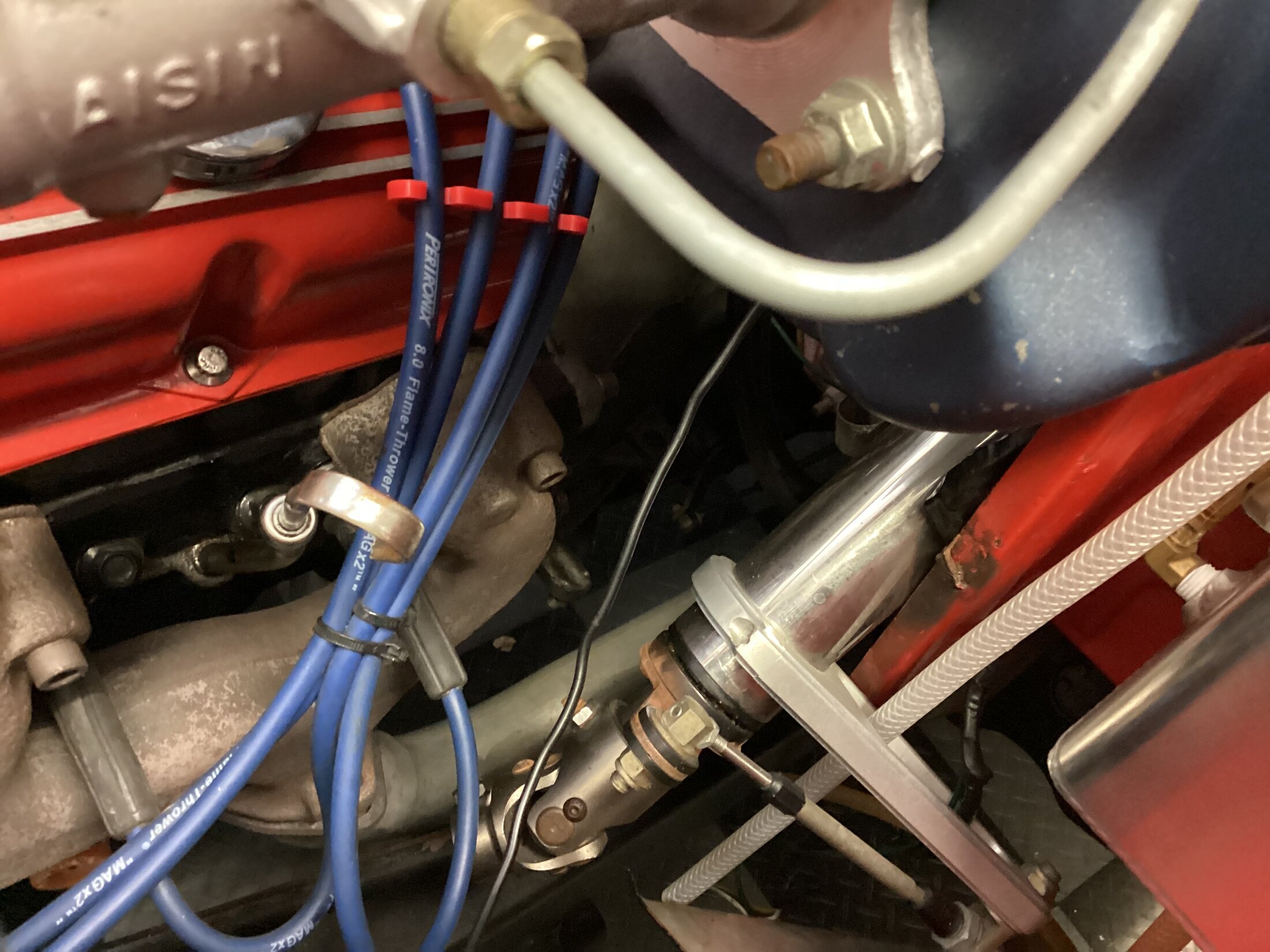

32” Ididit column, Lokar shift mechanism. 67 FJ45
I used a 32” GM tilt / shift column from Speedway with their 15” GM early 1950’s truck steering wheel, Saginaw power steering in a 5.3 LS / 4l60e swap. Just google ‘FJ40 LS swap’ and a ton of information will be at your fingertips.
The part numbers will be in the threads.
The overdrive allows you to run a comfortable 2000 rpm at 65 on 33’s and stock 4.10 gears.
It’s a lot of work but worth it.
