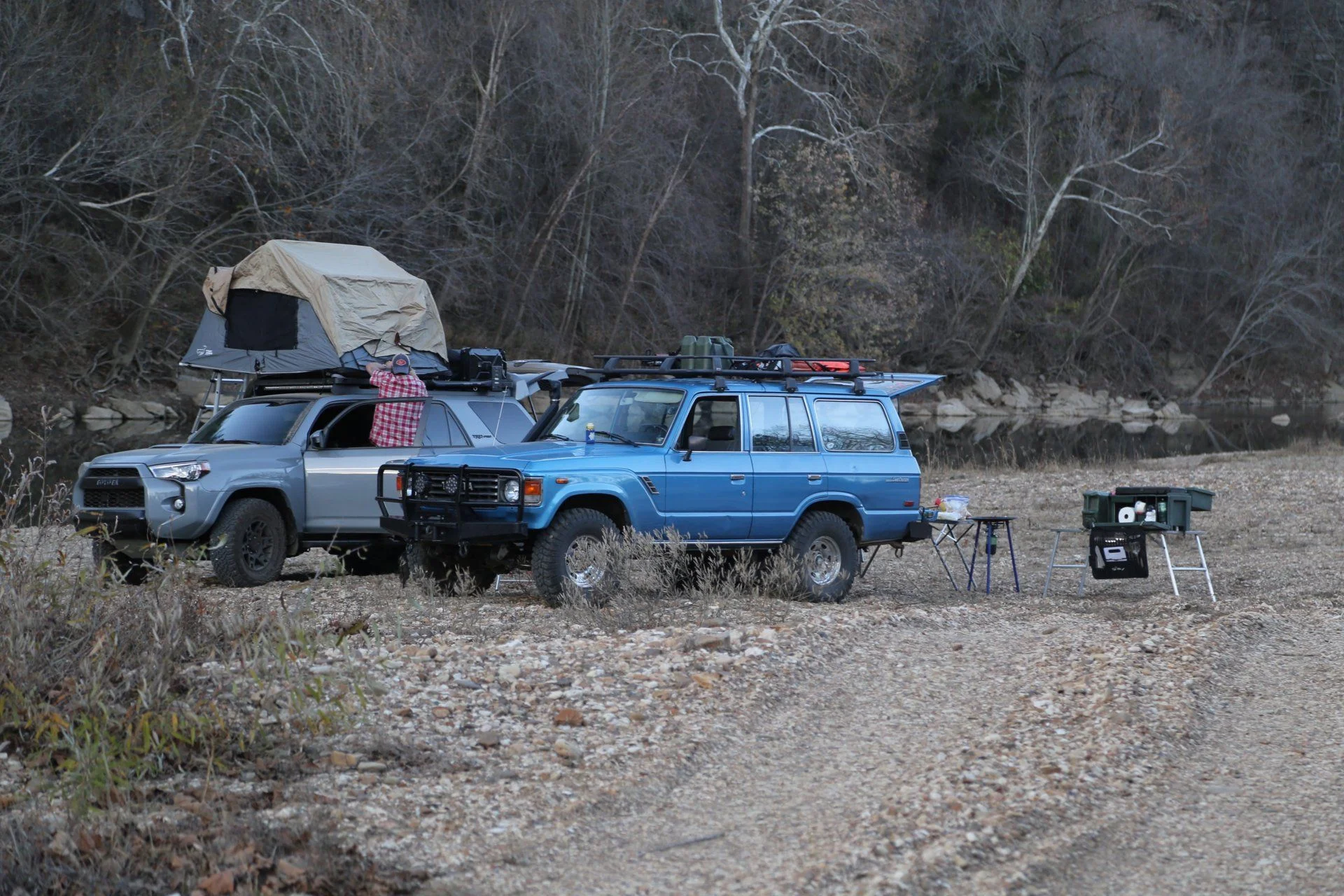

I’ve got a few different vehicles I take overlanding, depending on where I am going.
If I can work the trip around work, I take my TRDPro. Last year I put my RTT on and spent 10 days exploring the west
It was good, I’ve had RTTs for years I just. Hate screwing with the covers on the roof. Trailers make them so much easier.
if it’s within 8 hours I’ve begun taking my Fuel Injected FJ60 and for big trips I always take my 100 series.

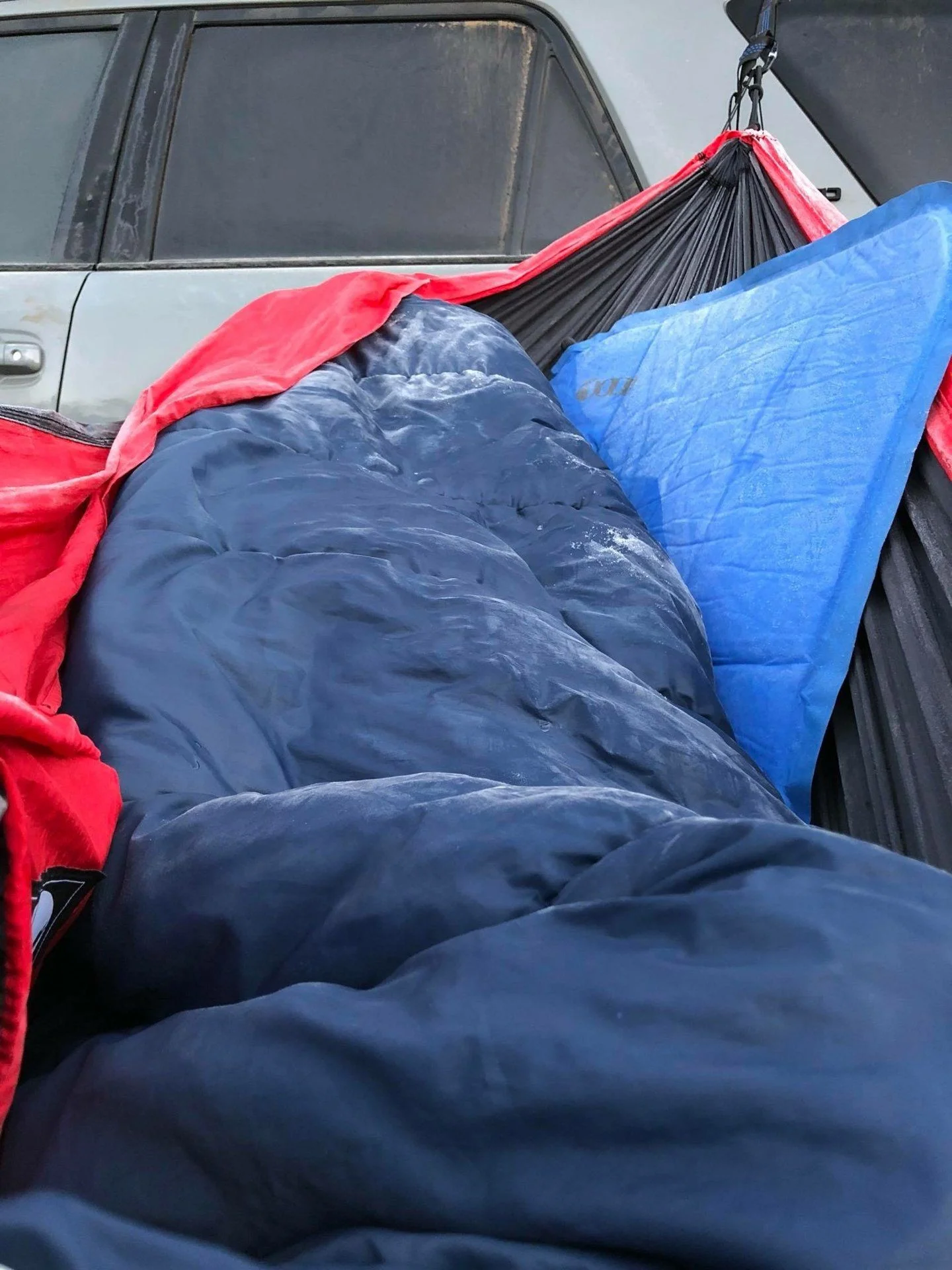

I’ve been trying to find the best solution to sleep but I kept going back and forth to a trailer, tent on the roof or an Eno.
Last trip I took I did not want to drag the extra weight behind my FJ60 and the ARB rack I have does not work well with a soft RTT so I froze in my Eno.

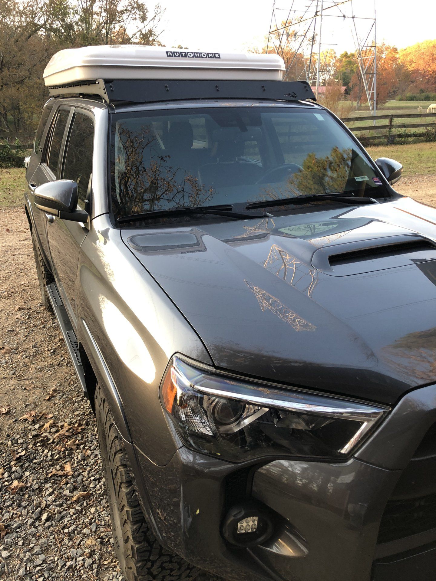

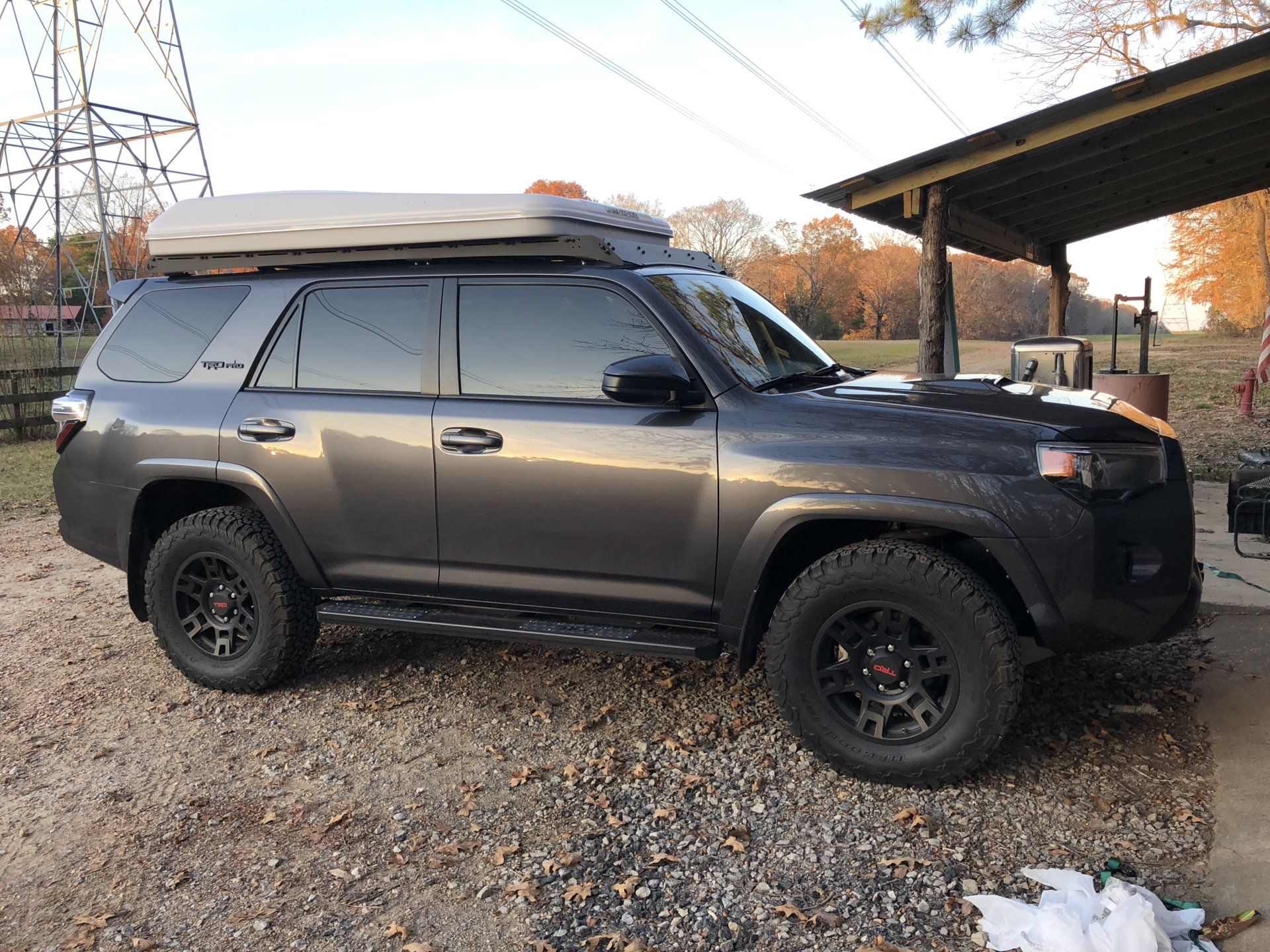

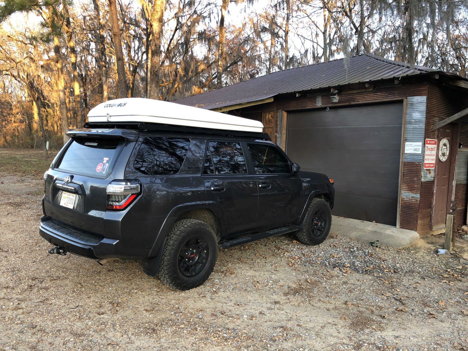

I was in town so I rode over, un crated it and brought it home on the Prinsu equipped 4Runner. With this low rack system, bolting it down is a bear but there was no wind noise on the interstate 50 Miles home.
The Columbus Small is the perfect size for the 4Runner barely sticking out over The sides.

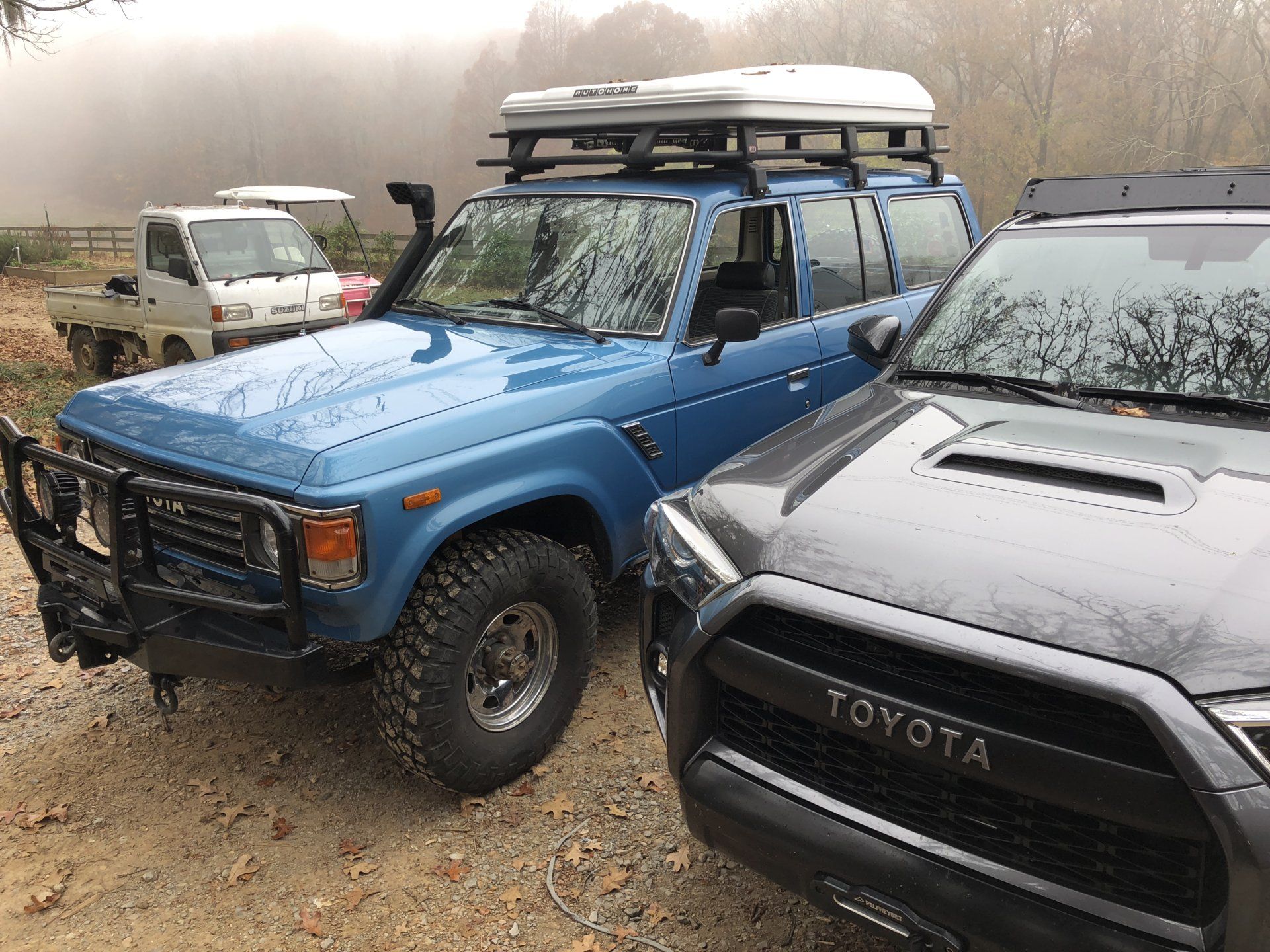

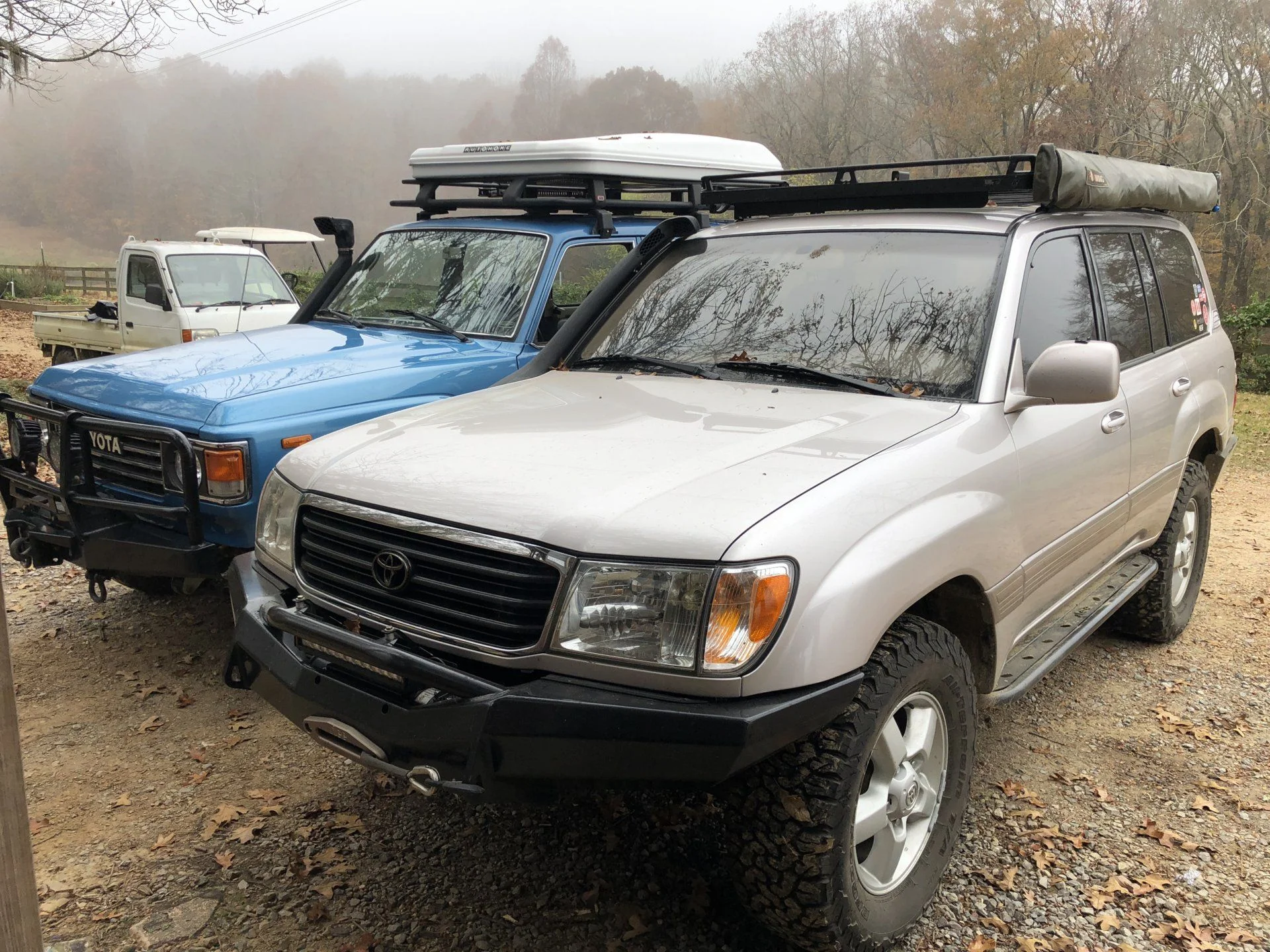

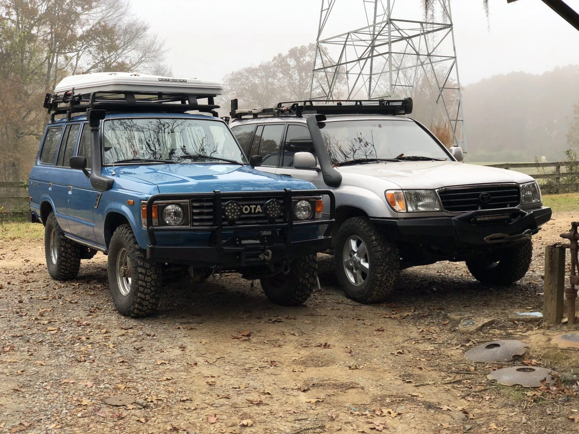

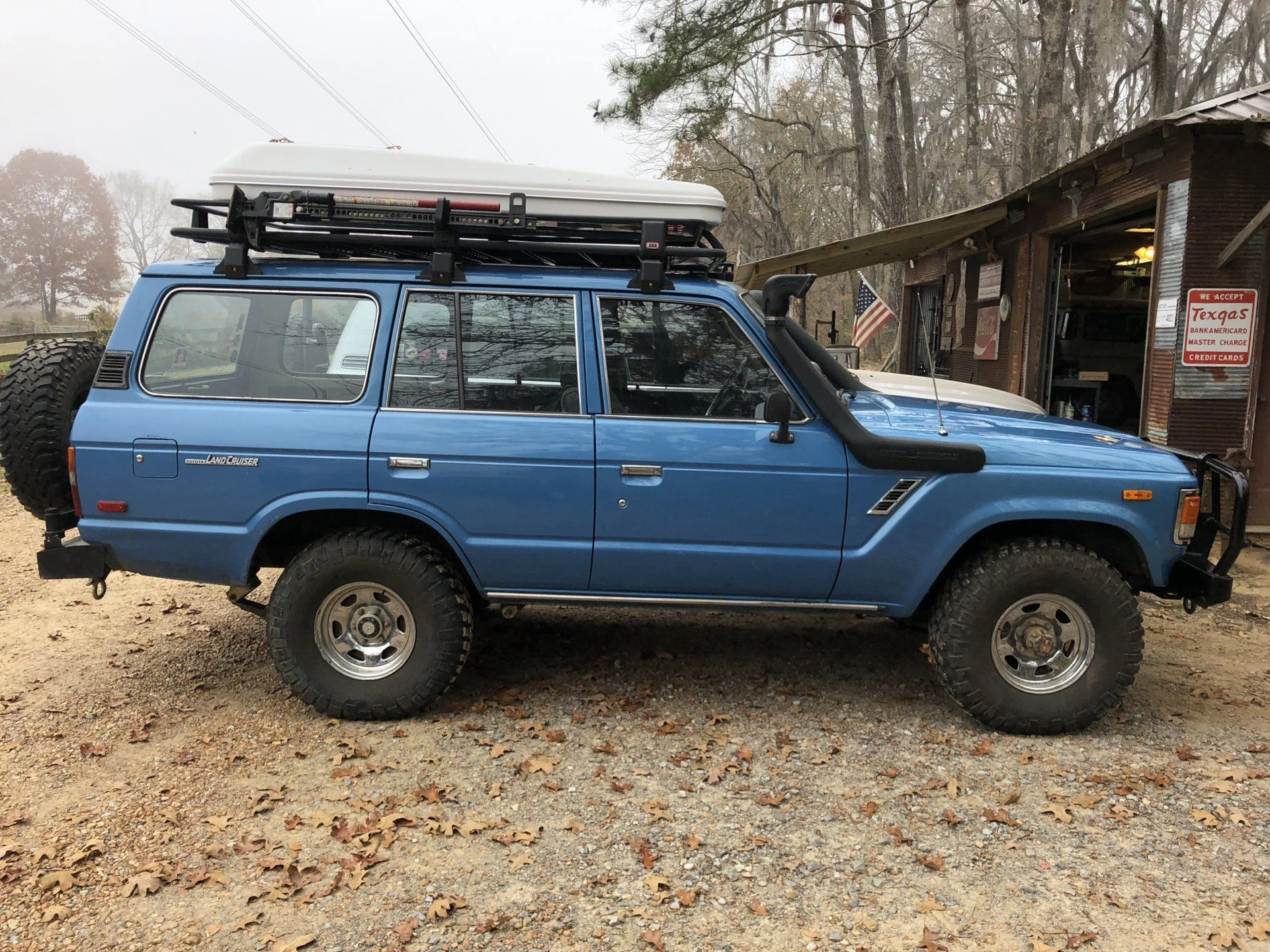

The next morning I moved the Columbus over to the FJ60 by parking next to it and then sliding it over.
This was the first sad moment.
The old school aluminum ARB rack looks superb but it does not work with RTTs well due to the sidebars. The tent sits way too high.
I’ll be moving his rack to the Pig and getting a front runner for the 60
The main reason I got the tent was for the 60. It really really does well under its own power with the new 2F and AFI injection but the trailer will be asking a lot. If I need more space I am in the 100

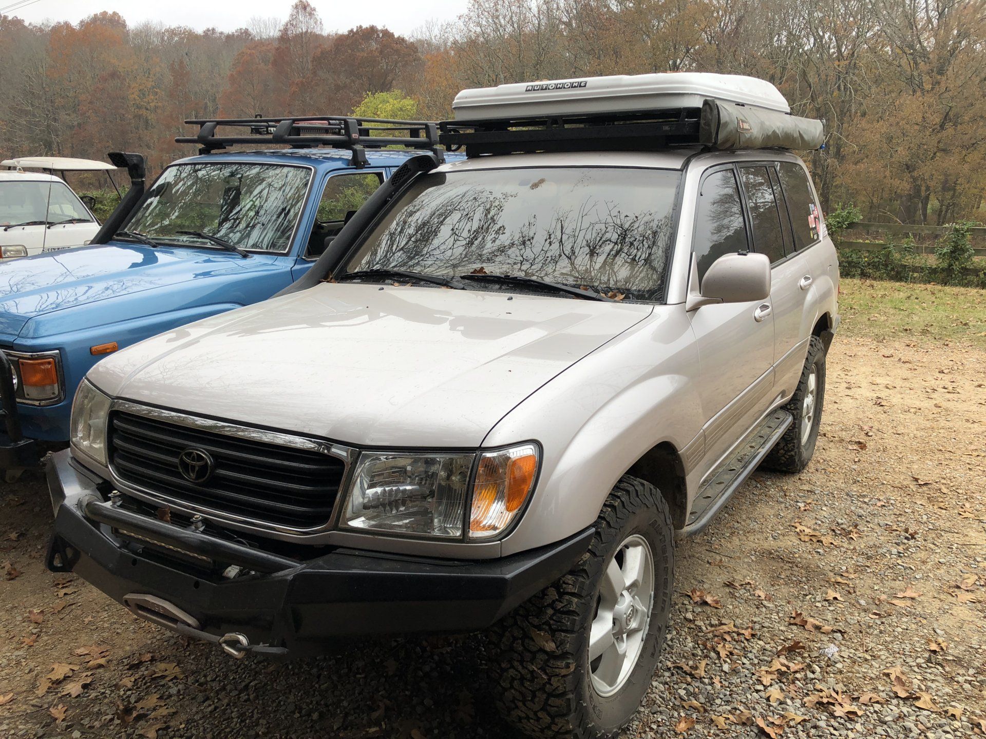

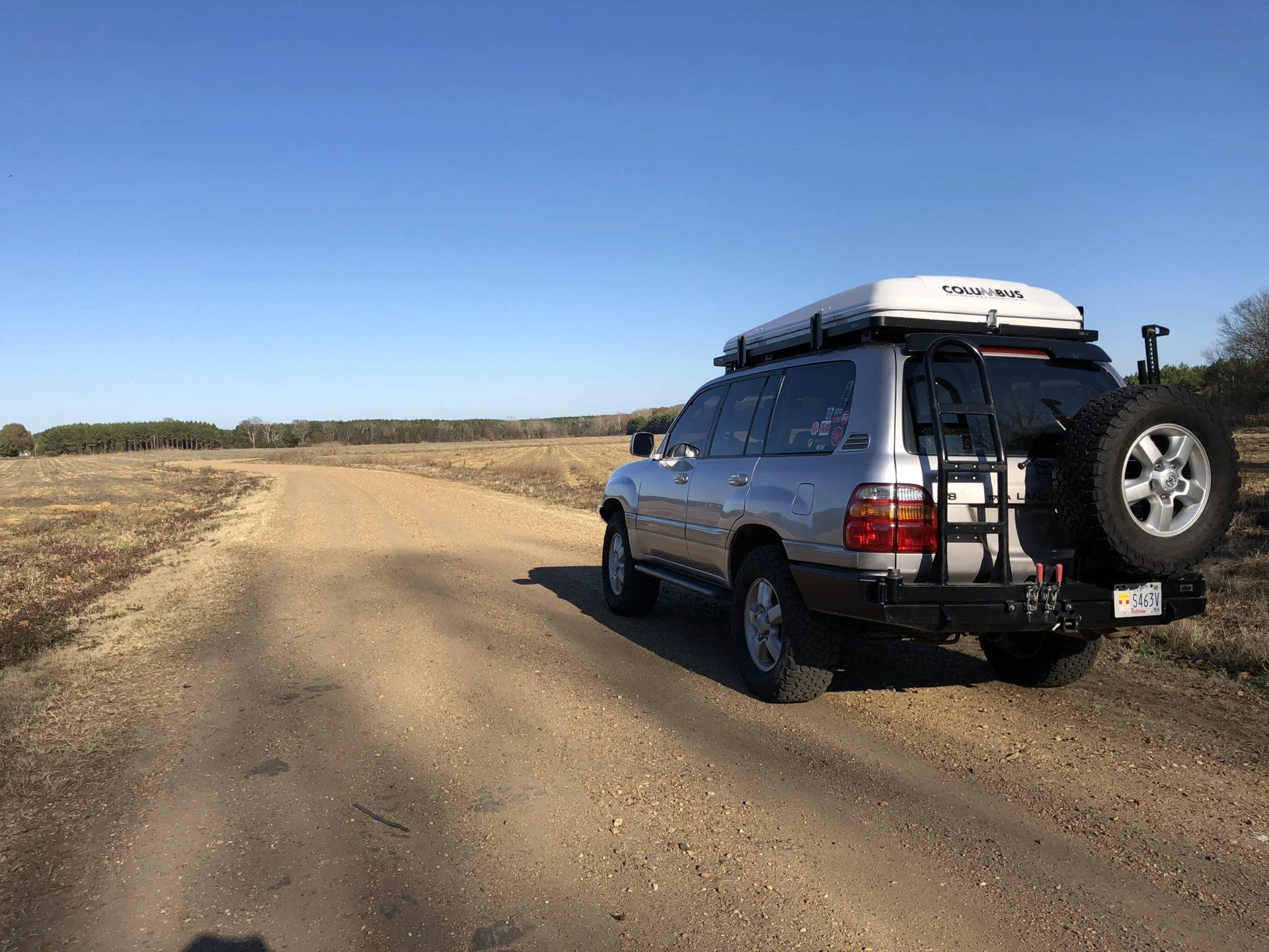

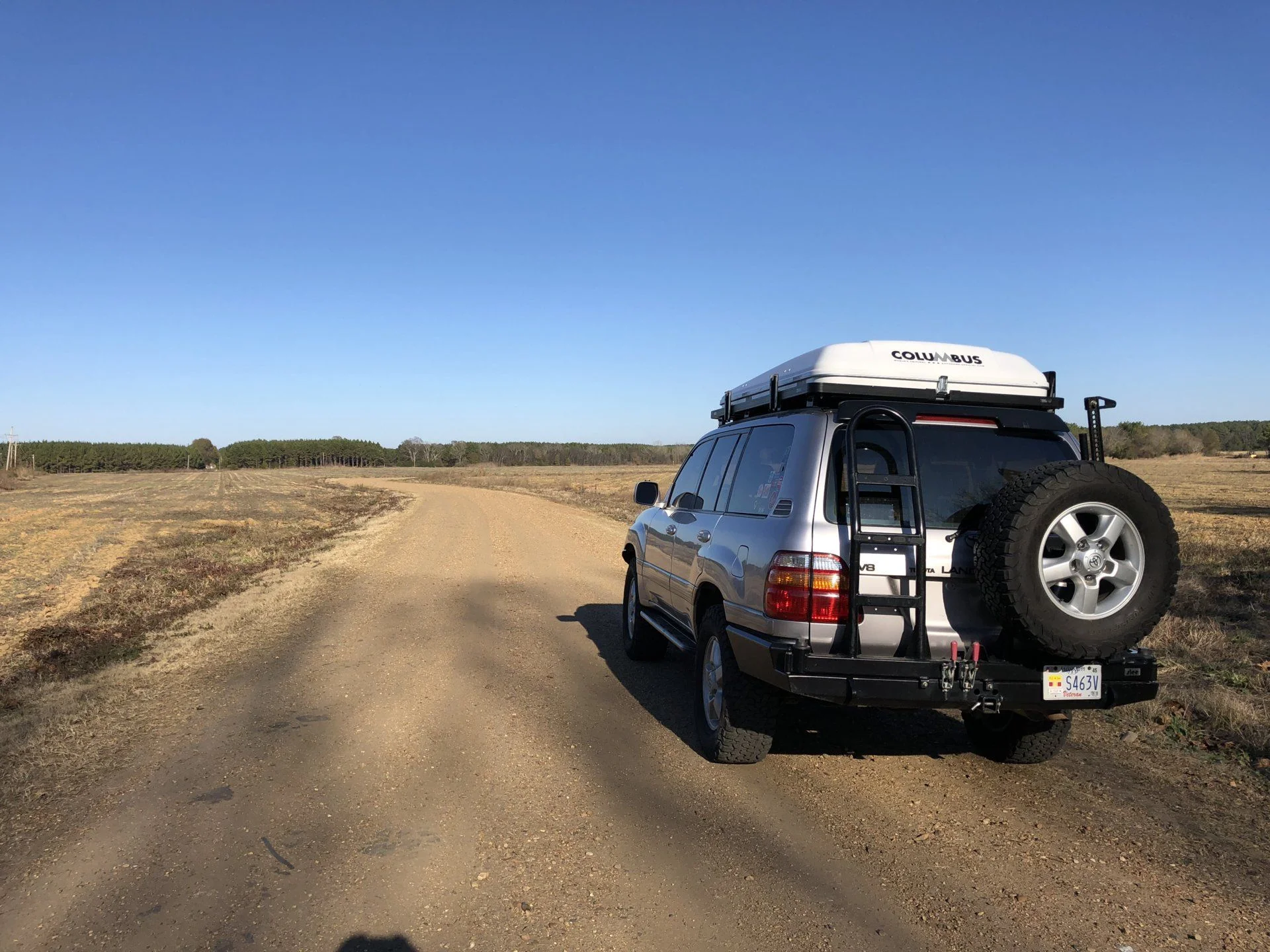

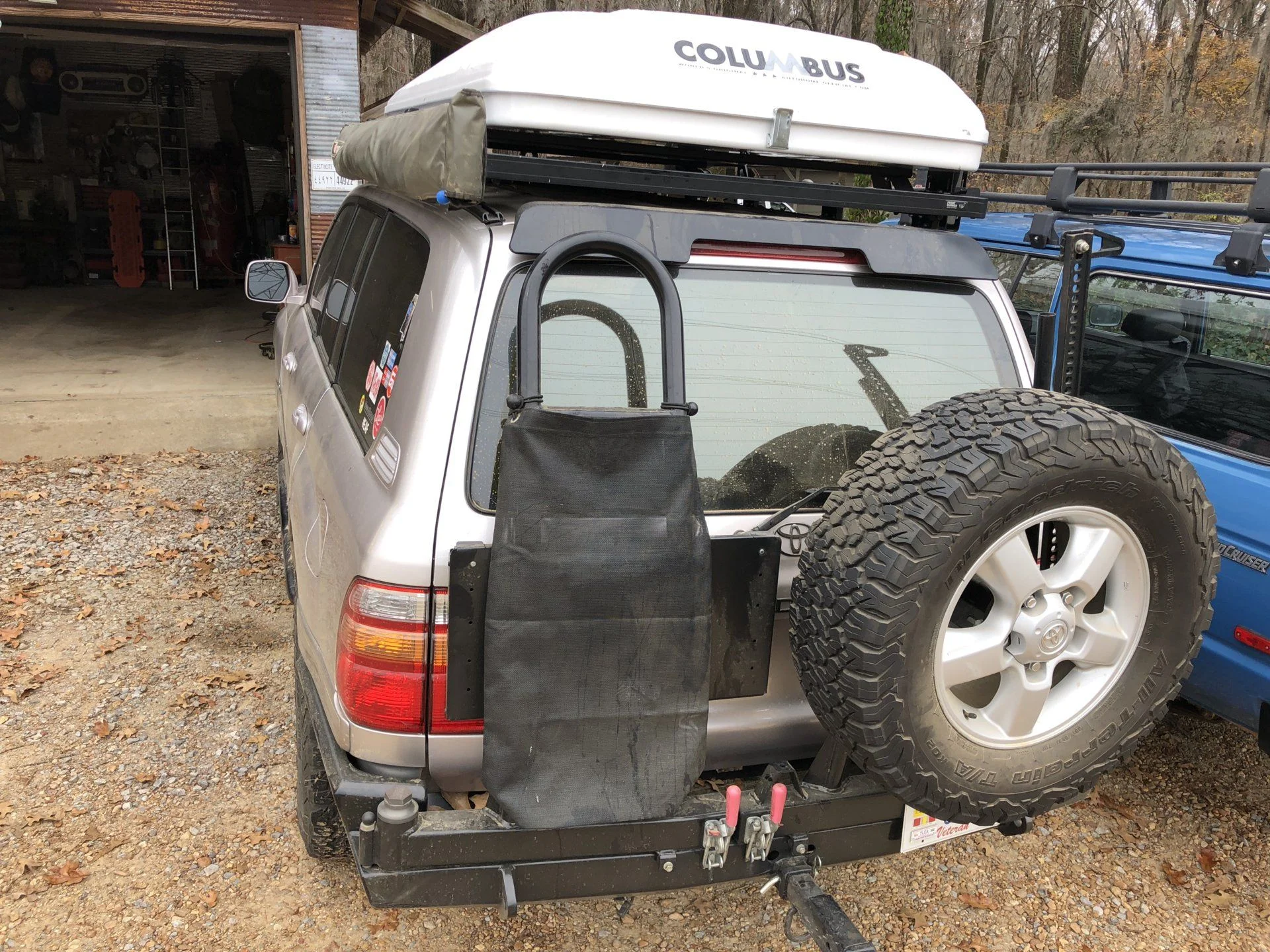

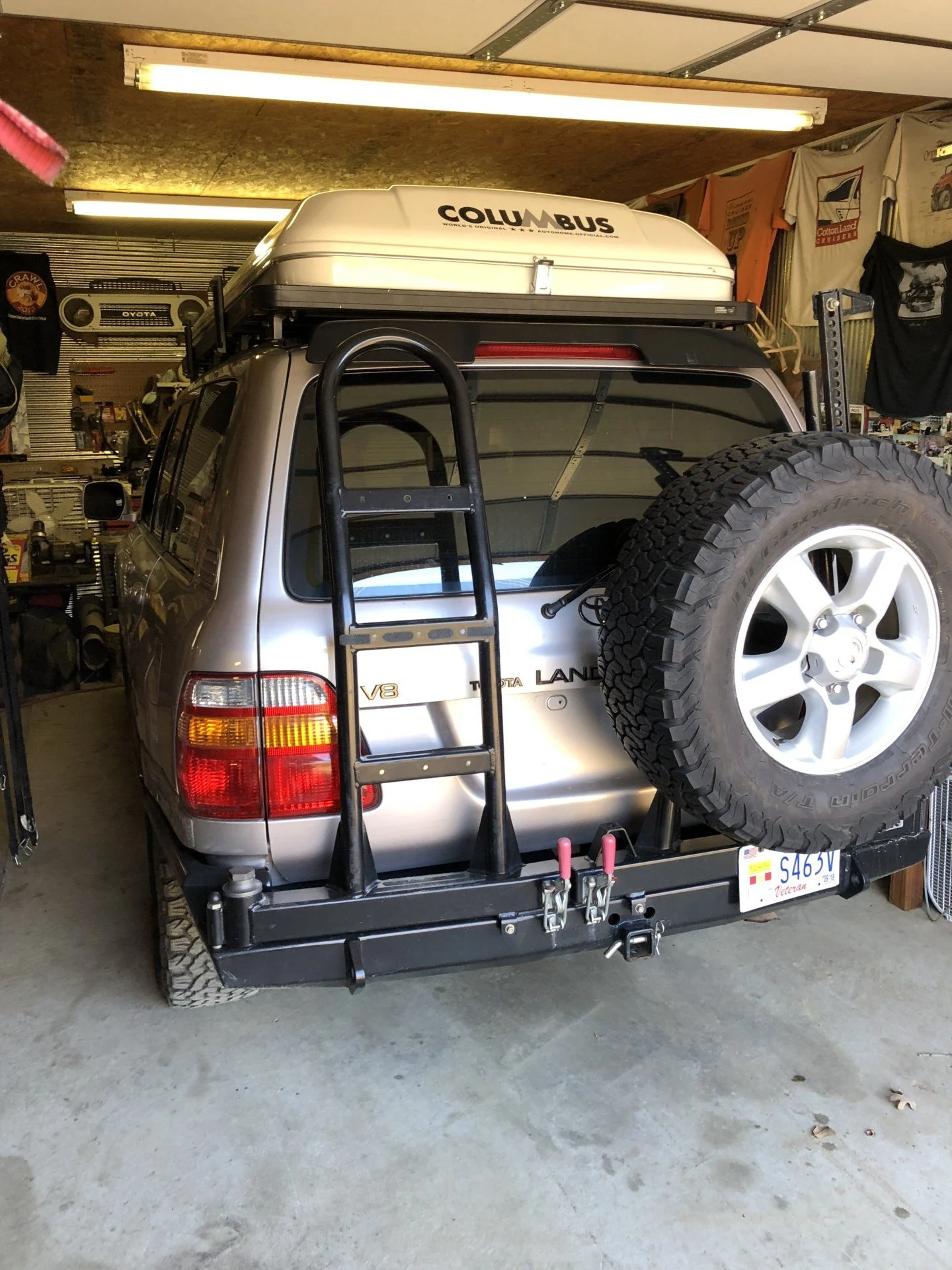

Sooooooo, that brings me to the final install on the 100 series.
I slid it over for the final time of the morning and it fit right down on the full size (13 slat) FrontRunner rack. I have the Foxwing on one side and a shovel and axe on the other.
The good thing was, it fit nicely inside my rails so all that stuff can stay. I use it often on the trail so it’s not just poser stuff.

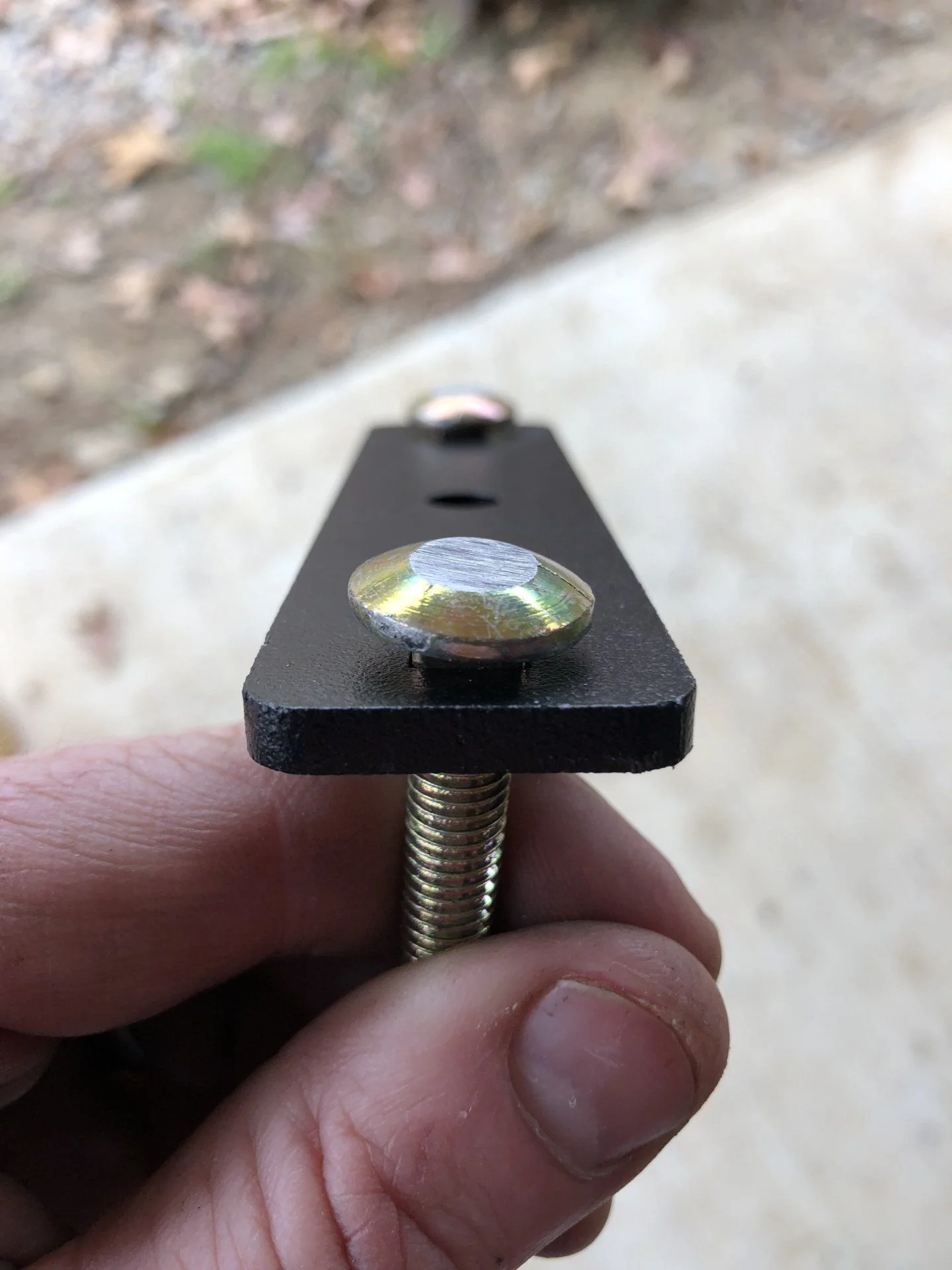

The AutoHouse comes with sandwich type mounts designed for thin bars like Yakima, Thule or even my Prinsu
FrontRunner sells the wider mounts for their thick bars for $30 or so. I had to clearance the carriage bolts a bit to make them work
I slid it all on and there was no way I was getting my hands under my rack to bolt these things on.

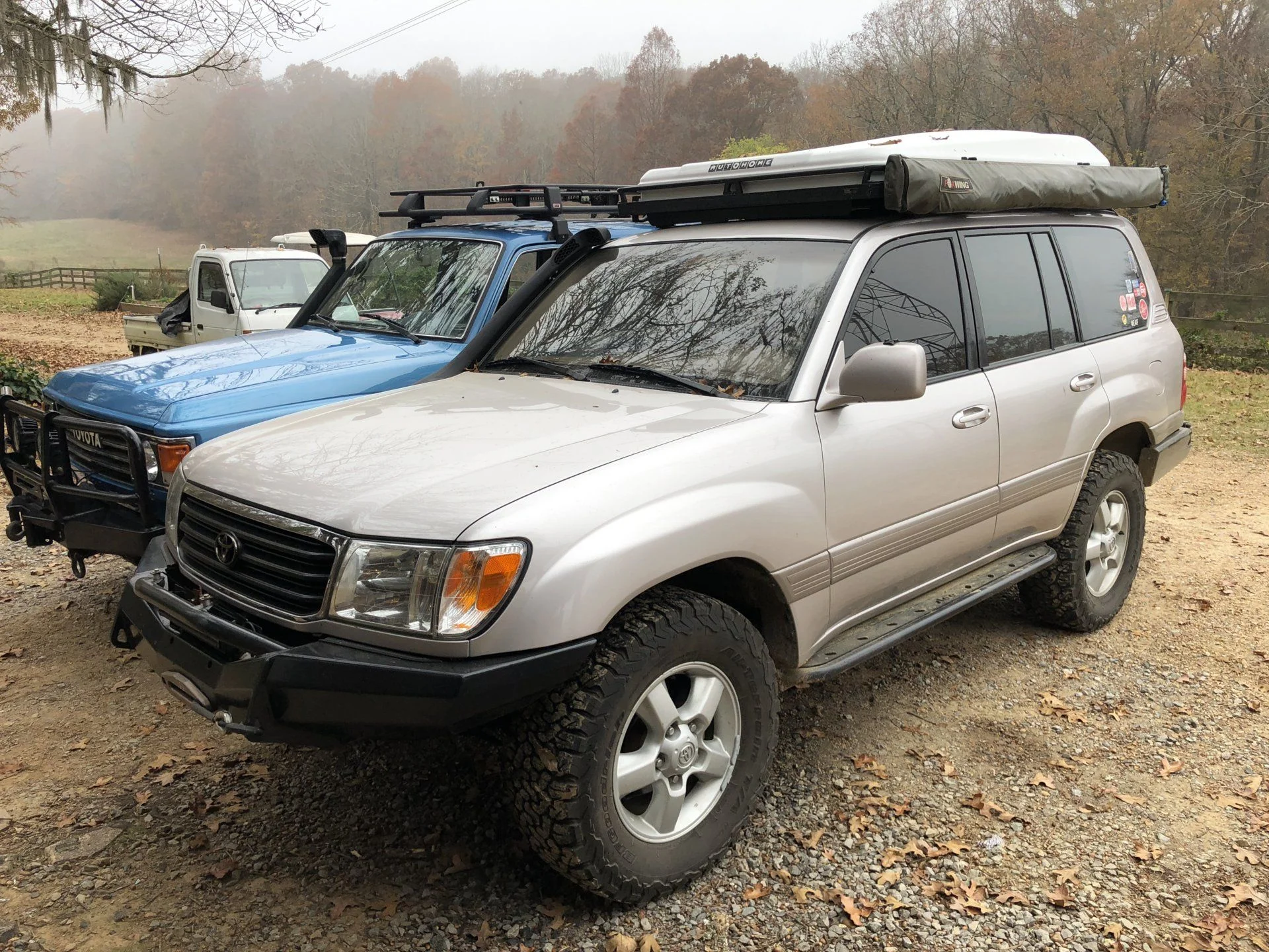

Instead of removing all the stuff off the rack I bolted this extra set of short crossbars to the rack with some tall RTT brackets from FrontRunner. This raised the entire tent up 3.5” taller but it is going to make removal and reinstall in the 60 a snap.
I’m happy with this. I drove it about 20 miles. It’s got more noise than the rack alone but not as much as my soft top tent up there
This thing is stupid easy. I got the ladder jacked up a bit in the billow strings during my demo but I’m not sure anything could be easier than this.

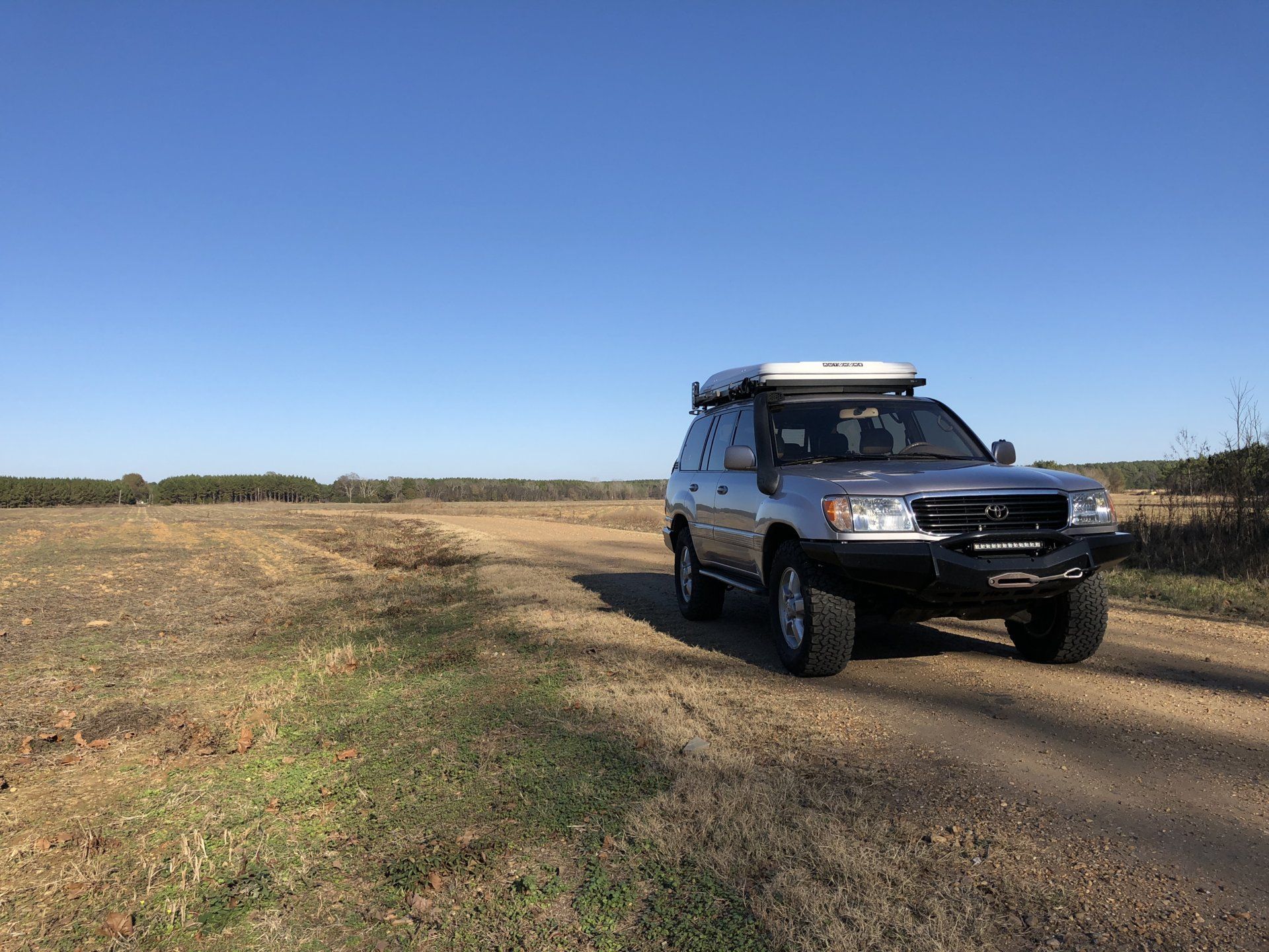

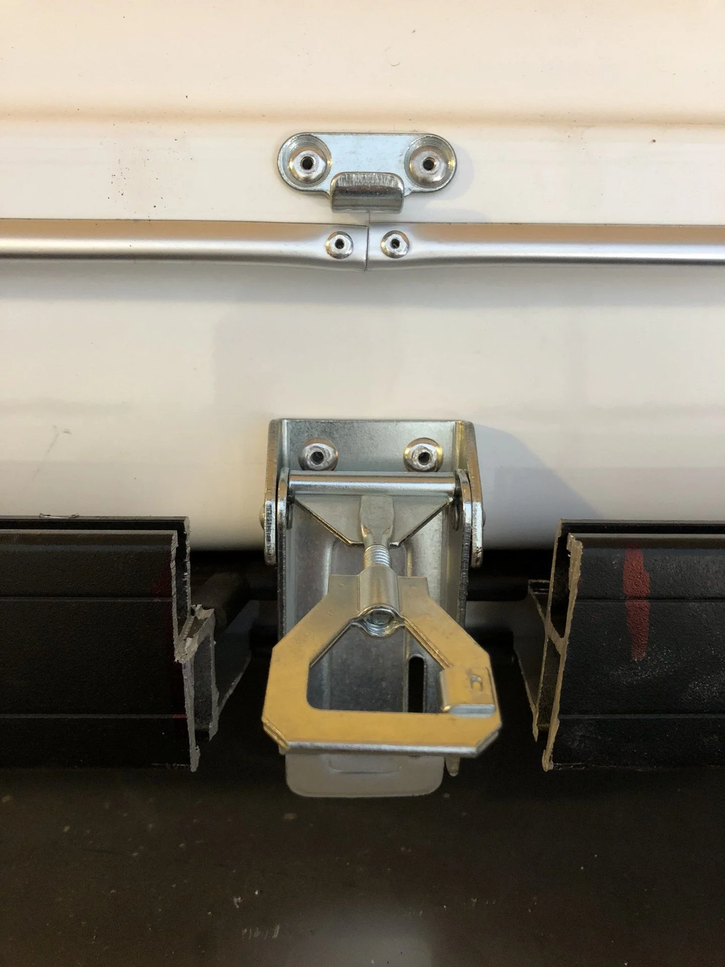

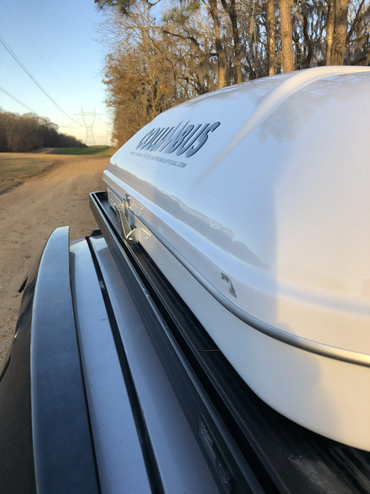

So after driving around with the AutoHome on my 100 the wind noise with it up on the crossbars was brutal. Also I could not fit in my 8’ shop door any longer so I embarked on making the tent work on my 11 slat 85” FrontRunner rack

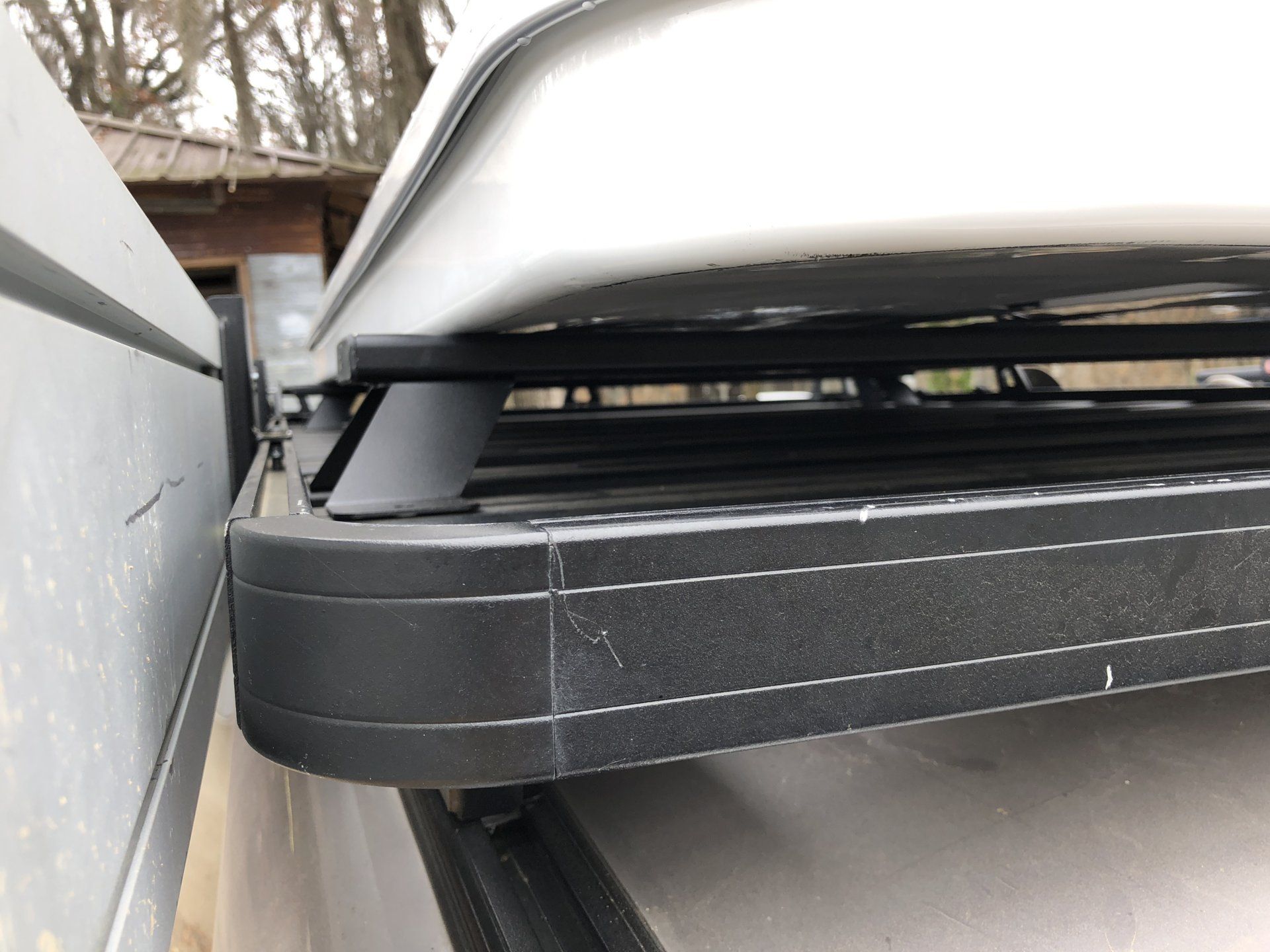

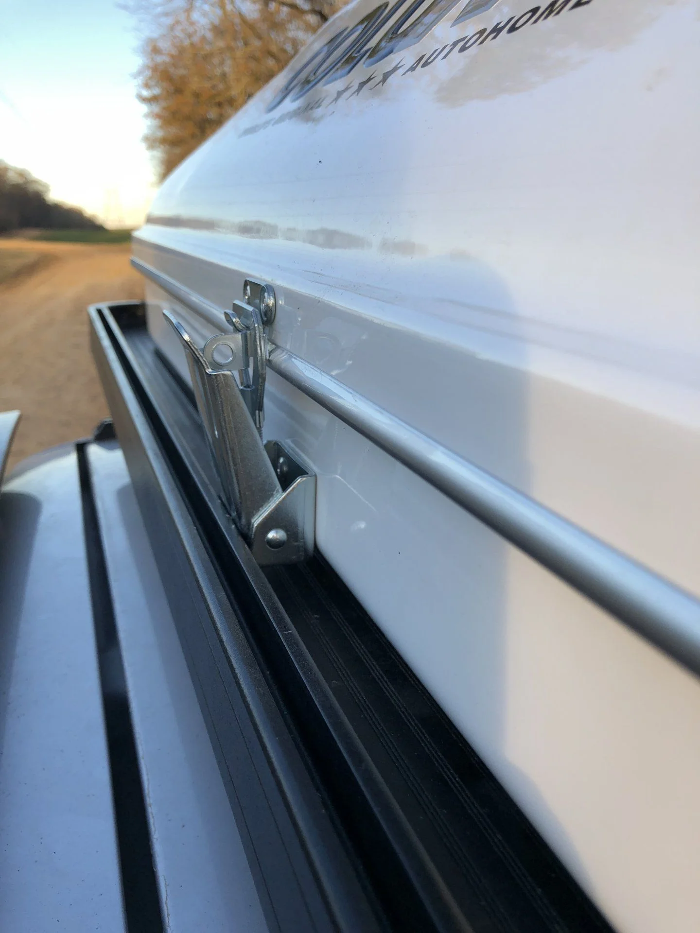

After getting the tent off the crossbars I found two problems.

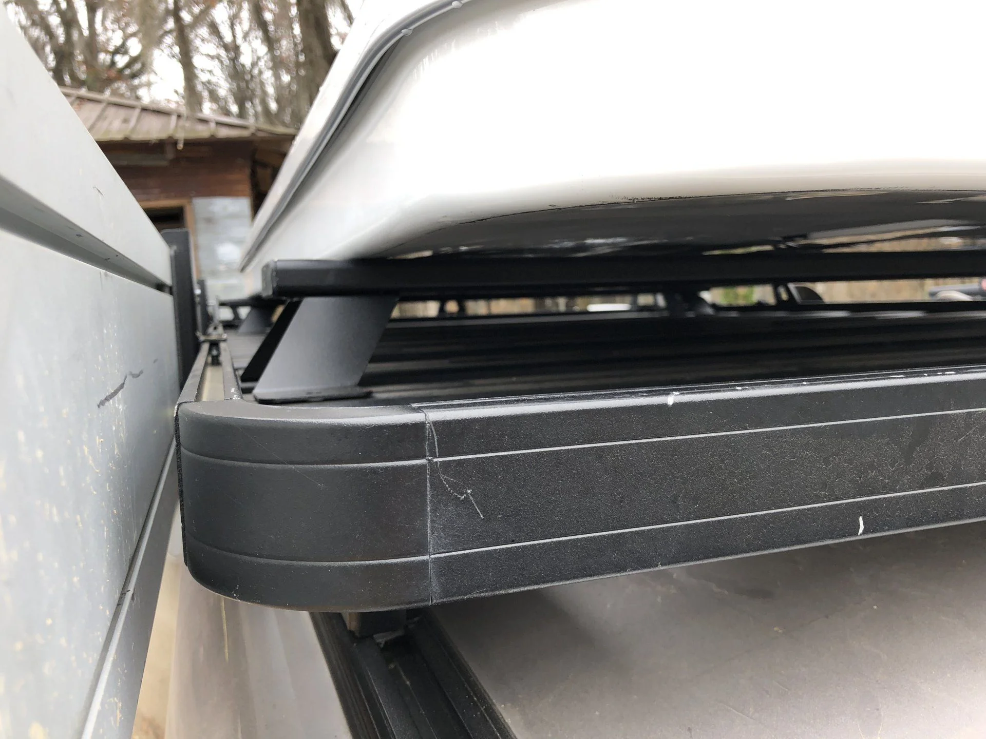

1) my rack is the old style mounts rails and it sits about 2” lower to the roof than the current ones sold and there was no way for me to reach under the rack to bolt the tent Down

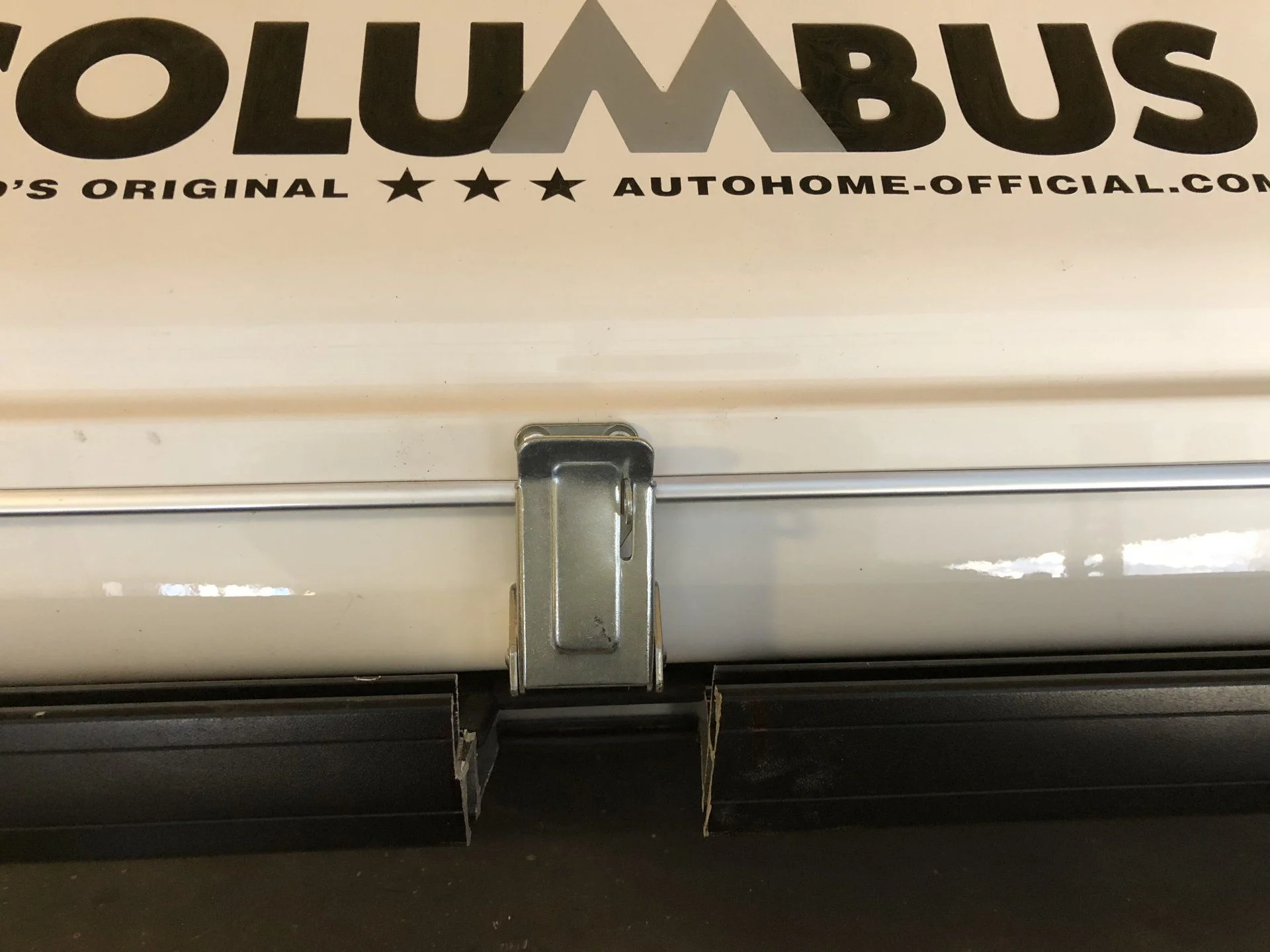

2) the way the latch works, the rear rack crossbar interferes with the latch for the tent
I got home early today and pulled it into the shop out of the 30 mph north winds and started hacking on the rack to make it happen
The main rail on the front and rear are wide and there is plenty of strength left after hacking out this hole. I’m going to figure out something to make it prettier
I took it for a drive and 100% of the wind noise is gone.
I’m stoked.
To get my hands under the rack I unbolted one corner at a time from the truck and lifted it about 2” with a block of wood and I was able to get it done.

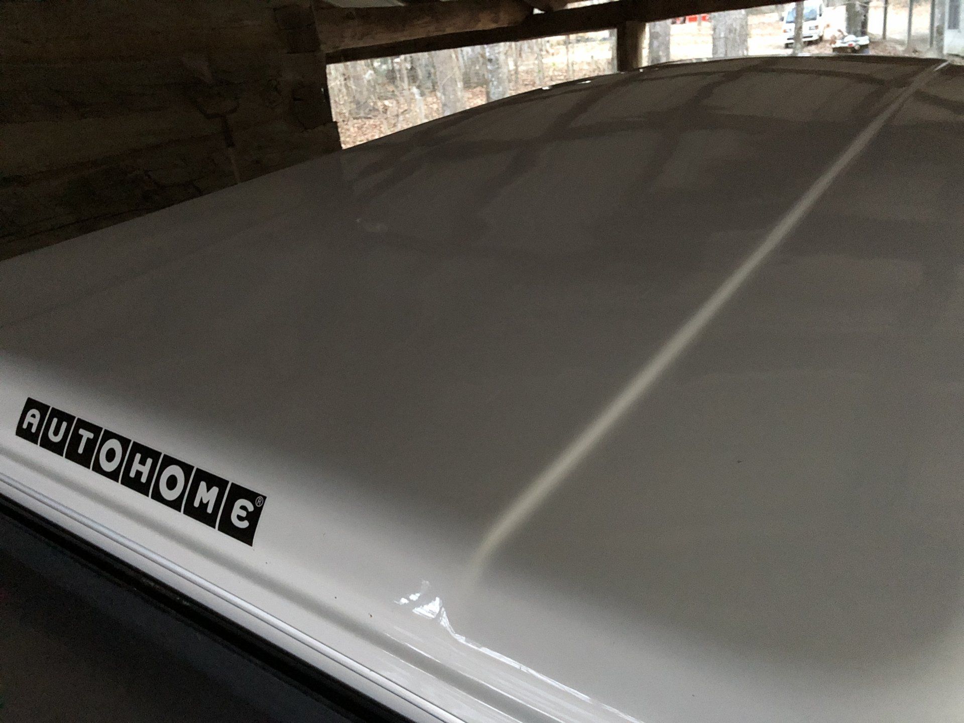

Any chance you have a pic of the top of your Columbus? I have solar on my 80 but this would cover my panel unless I reinstalled my solar slide out. I'm thinking of going with a flexible panel that I could adhere to the top of the Columbus. Wondering how wide and long the flattest area is. I know I could go with Yakima feet and load bars and attach to that but want something "different" and lower profile.
It’s a flat 24x36 ish in the front middle
