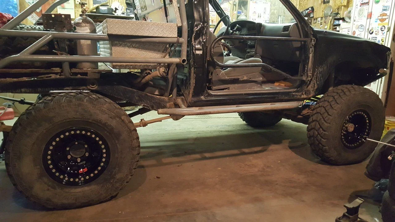

Had I not gotten a deal on my powertank I would definitely go with the home brew setup.
I got lucky. One of my clients have me a 10lb o2 bottle. Then airgas just swapped valves with me. Picked up an ultimate air 140psi regulator, done.
I have basically everything I need from an old kegerator set up. Just need to get a tank. the tank stuff isn't too bad. You can usually get a tank from Praxair or airgas for a core deposit and they give you the $ back when you bring the tank back.
Kegerators are usually set up for like 7psi... no?
I got my tank today. My local airgas place only sells the tank. So I had to buy one. It comes full! Then they just swap it out for 12$ when you need a refill. They only swap in my town, I'd have to drive to Indy for actual refills, but a swap is okay by me.
I got a 150 psi regulator on Amazon for 40$. I'll look into the coil type hose, but I have a regular hose and all the fittings to connect it so I may just put that in the bed box and attach it as needed with a quick disconnect.
I'm very happy to have the new set up.

Mounting my tires on my new beadlocks.

beadlocks is done. Test wheel in my woods is scheduled for tomorrow. 3 days and no air loss, I musta done something right.
