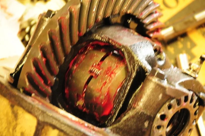

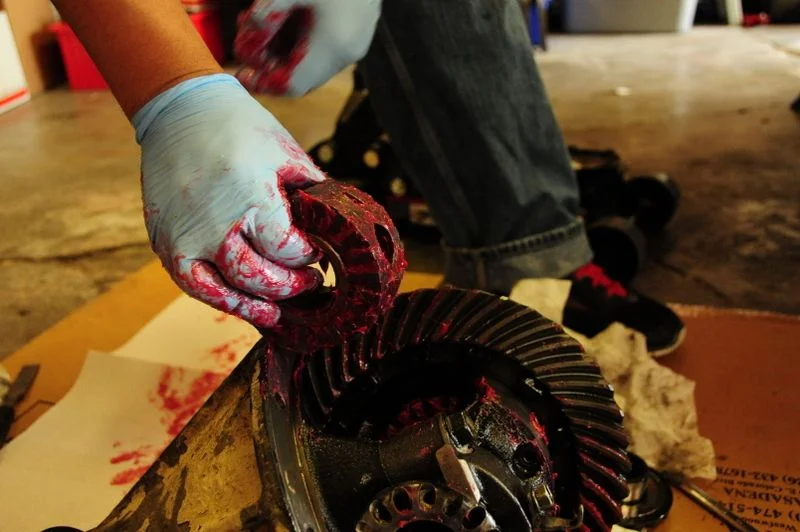

I have a lot of pics, trying to figure out the best way to show them. I guess they can go here but maybe putting them all into a gallery wold be better...
I think it might be time for an entire new write up in a clean package that can be added to the reference sticky. Anything will help though.
Install pics...
