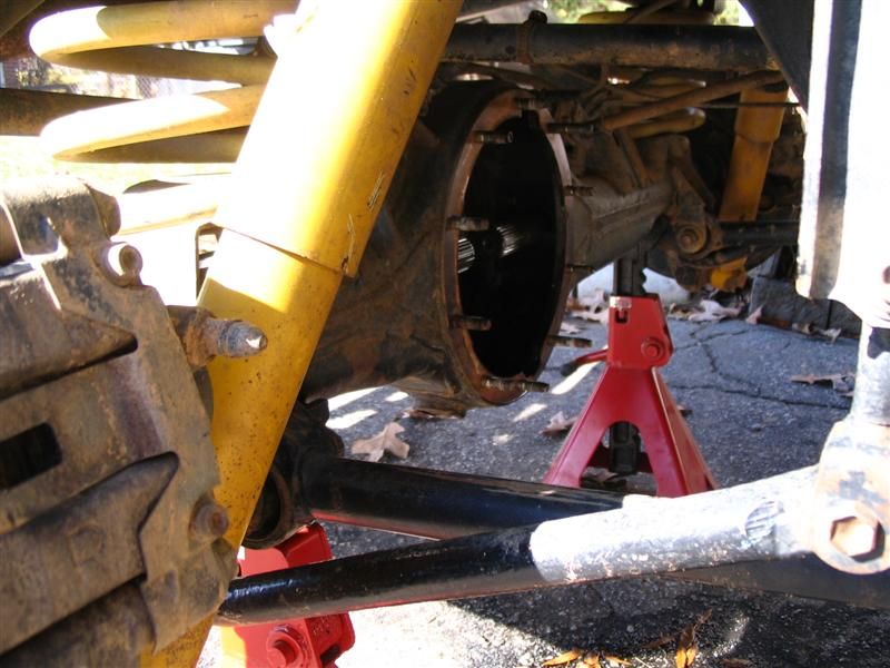

Couple of tips for anyone getting ready to do this on a 95' 80 series:
1. put the cam gear on the ring gear side first. It's easier when you have space to work around the ring gear.
2. if you are near to or out of spec just slightly, clean the grease off the parts and put them back together. THen you will most likely be in spec.
3. Torque specs are -6 nuts holding the cone washers on the axle hub are 25 ft/lbs.
10 pinion bolts -- 54 ft/lbs.
pinion shaft pin in the diff -- 20 ft/lbs.
4. If you have an earlier year 80 series that is a semi-float, you have a c-clip rear end and the process is completely different.

Same process on a '91 80?
Is this the same process as what I would have with a '91? Or is there a difference with the earlier version?
earlier versions have the C-clip axle. It is different. First thing is you access the gears from a cover on the rear of the diff (the full floater axle you take the entire third member out from the front).
It is different but not difficult.
differences on a 1991?
So I would not have to take the third out.
Do you still have to pull the axle stubs out?
Does the "earlier" models mean anything earlier than a '95, or earlier meaning before the '93? I have a '94.
Thank you for excellent write and pics. Im much more of visual person. I want to install one, but need to make sure all my "ducks" are in row and get the proper space/tools/parts before tearing apart.
yes, you will have to pull the axle stubs out
it's really not bad. The tricky part is getting everything lined up to slide the c-clips back on the end of the axles. That was the hardest part.
By earlier model he means rear drums which will be the semi-float axle with c-clips. Some 93 & 94's came like this. If you have a semi-float you will also have an inspection plate on the backside of your rear axle. That is what you will remove to install your Aussie Locker.
just did my 60 this Saturday and removing c clips is easy...and I pulled axles out completely and installed new axle seals while I was at it since the others were a bit used and old.
Installed c clip on long side normally...but when on short side you have to get everything back in expecpt pin....and push short axle in until you can see the clip slot...then carefully insert C clip in the gap and hopefully it will fall into place pointing downward so you can get it seated...then pull sharply on axle to seat it in the new parts and install your pin.
Took us a couple tries to get the c clip in.....LOL But all was good and it works great.
