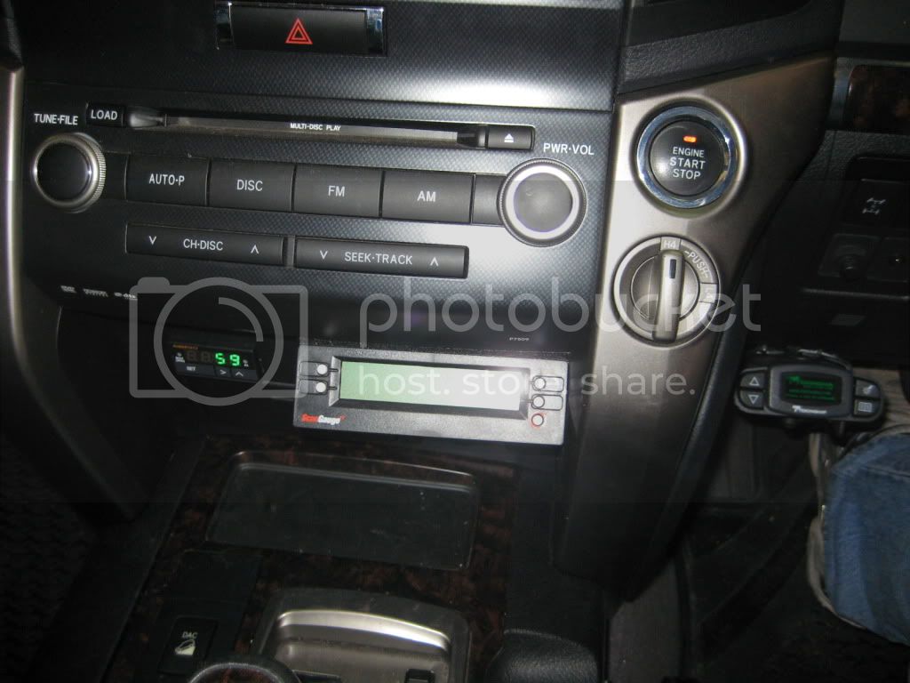

Fitted EGT Probe/Gauge (pre Turbo) with buzzer alarm, Scan Gauge 11 and Brake Controller. The Scan gauge helps correct for speeds and trip computer info etc that were slightly out due to the 35's (could have lived with it, but like all the additional info I can now see also).
Getting it set up for a big outback trip next year:steer:, what do do next:confused:
