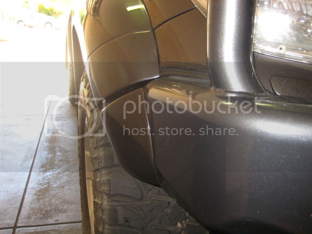

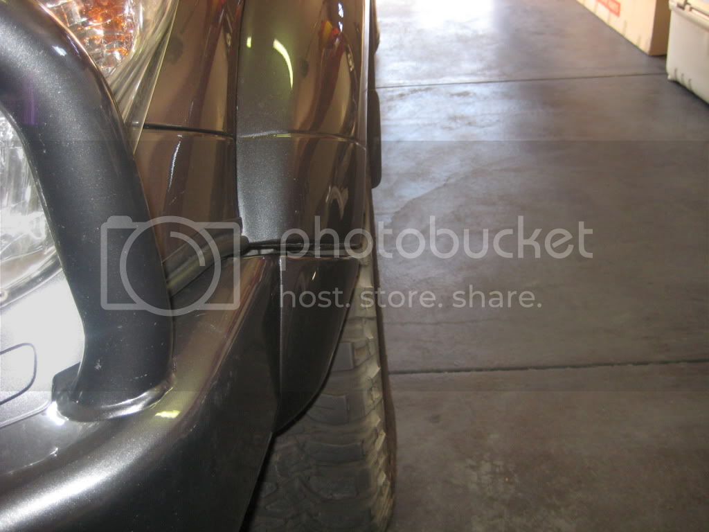

Looks good, but since I've already bashed that corner of the ARB on a couple of VW-size rocks, that add-on looks like it would be an easy target. I'd prefer that the flare taper off before it gets to the ARB - if possible.
They are tough, but I would guess I'll eventually break them (easy enough to fix/paint again). Tapered above the bar would be the best option, but as the tyre stick out to the flare any reduction (the taper portion) would make it illegal herel.

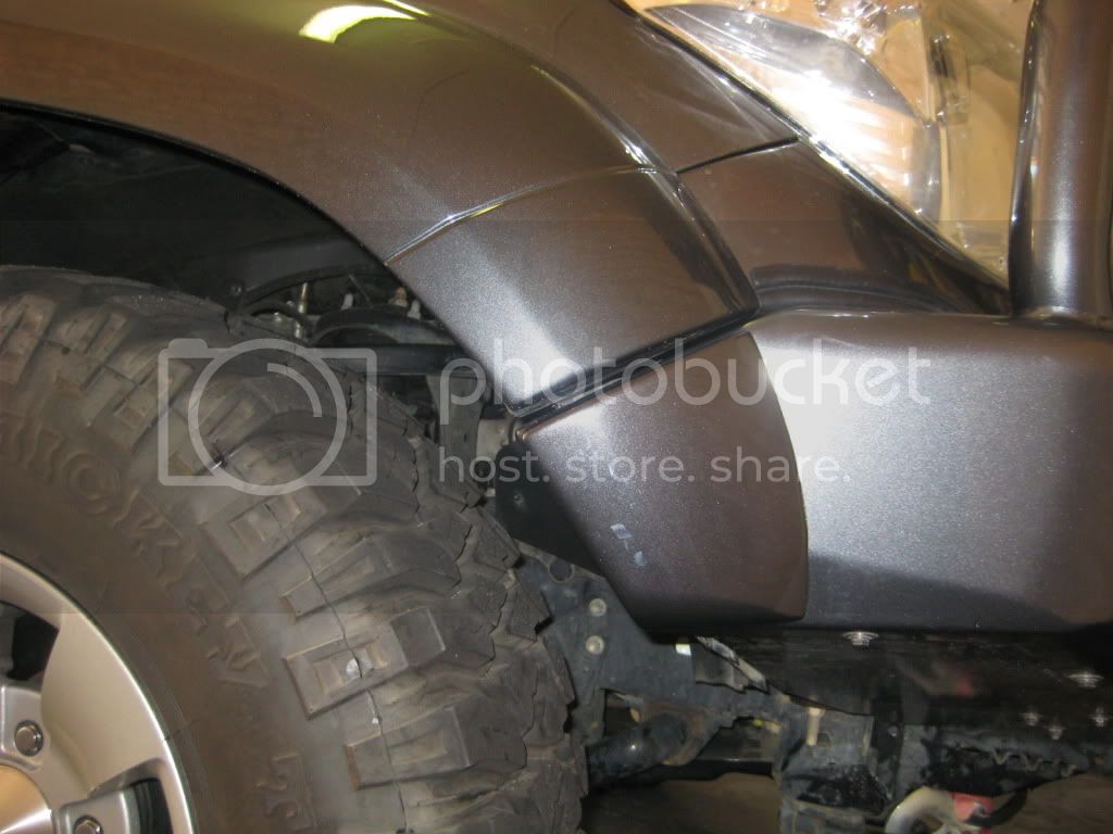

Finished off and fitted the Bar pieces (hopefully they don't become sacrificial anode's on a rock
) they streamline the flares in well now.
very nice work on a good looking rig.

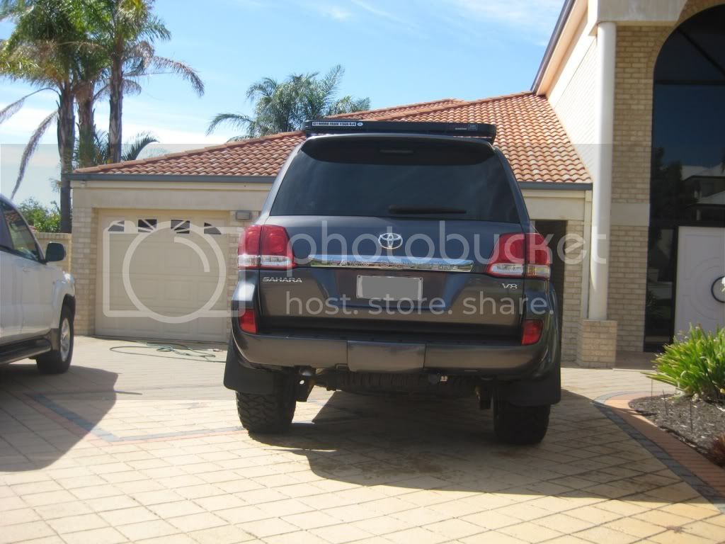

Finished shots, including new Snorkel.
Getting used to the look/feel of the 35's, looks a bit like a pimped Prado next to the Wife's in the last shot.

I'm guessing it wont fit in that garage? :grinpimp:
JB,
Does it by about 1" :cheers: (with Rack on).
Another reason to rule out 37's though :D, or at least use that excuse to justify it to myself, as I'm used to the 35's already:p. It wouldn't take too much more to do, must resist:bang:

Nice work! - I've never really spent time here in the "hi rent" section of MUD, but I like the work you did & it looks like it's not your first time working with fiberglass.
Are the white sheets you seem to be using as forms a delrin material? I ask since I plan to do a little fiberglass work in my 80 & if the product(delrin?) you used is non-stick to poly based resins, then that would be helpful to know as I'm working....
I used a low adhesive polyurethane tape (3M product), Glass comes off well and the tape comes off the car well also. Light coat of wax will help if a tight spot (I didn't need it). Only issue with it, if a hot batch it bubbles a little!
