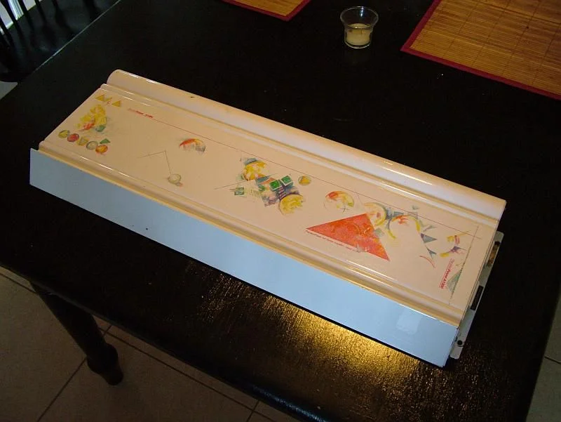

Interesting.... I still use those amps to this day. I used them in sound quality car back in the early nineties (also an IASCA winner). I currently have A600 and A404 on 04 LX and 13 ISF, A606 on my 76 FJ and 14 RX350 and Spare A606, A600 A404 on my cabinet which was pulled from 12 LS when I sold it. At one point I swapped my amps to XTants but I ended up going back to PPI.

Man that's awesome! I was a huge PPI fanboy until they started going downhill after the Power Class amps. I sold all of my Art Series to make the move to Power Class and those were some awesome amps too. The PC2350 that took the place of the A1200 was just as beautiful in its own way. They made some awesome signal processors too. The PAR-245 1/2 din in dash EQ with selectable center EQ bands and selectable Q value was probably one of my favorite pieces ever, no matter my amp/speaker setup I used one of those for 10 years. Man I miss that stuff.
