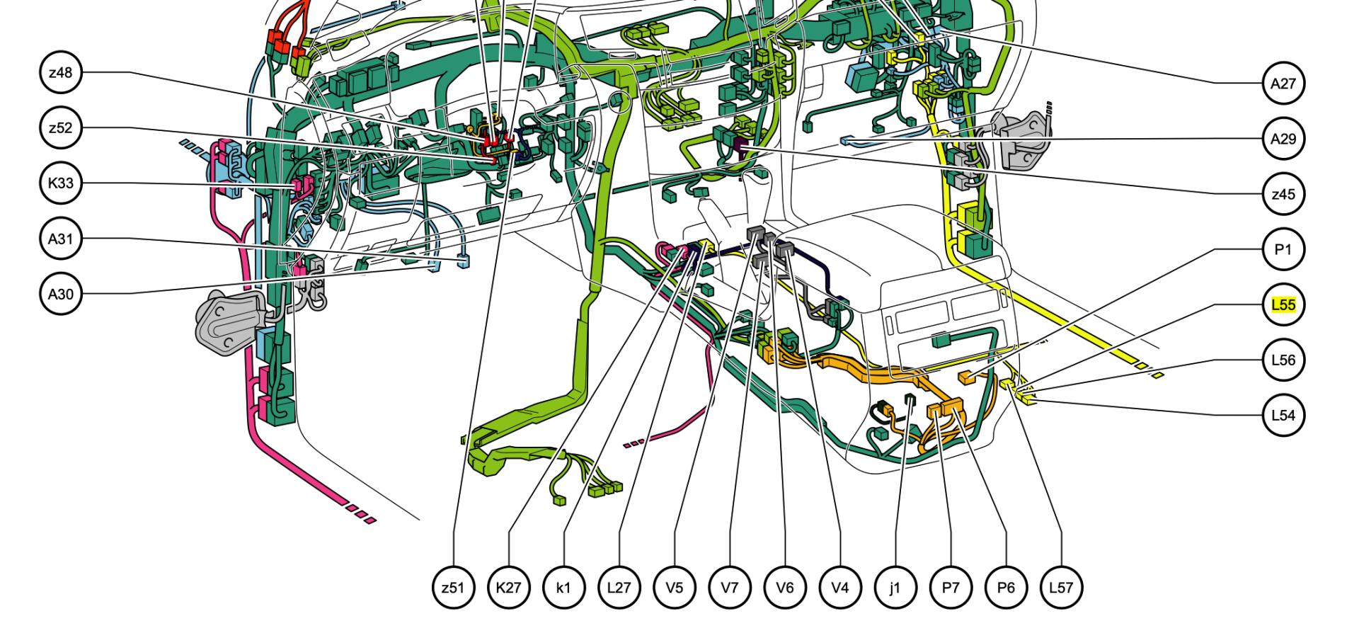

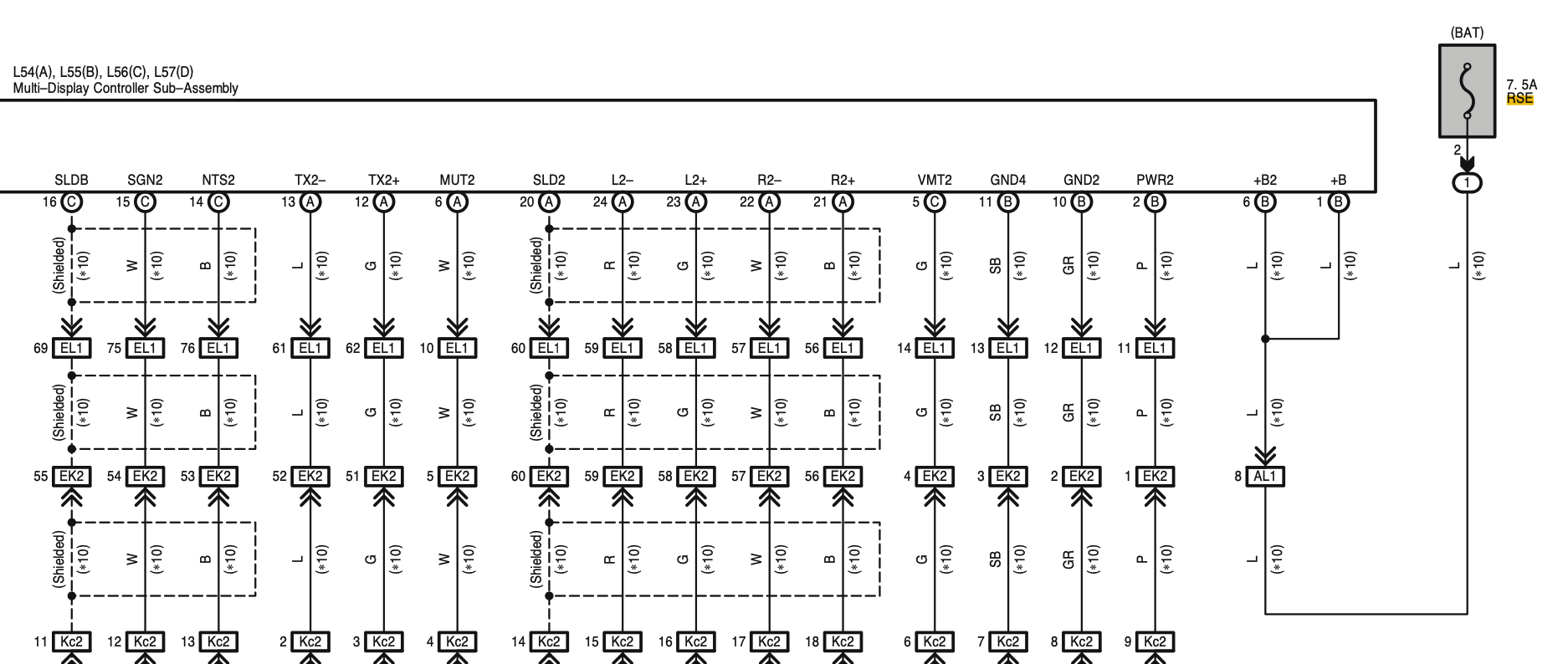

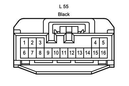

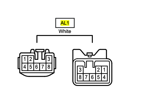

Unfortunately there wasn't a 2012 model in the US. I looked at the FSM for manufacture dates before Jan2012.
I hope this will help at least get you started. If the items are mirrored it shouldn't be too hard to track down.
What the RSE fuse is linked to -> (connector AL1, pin 8)
Where AL1 is located
What AL1 pinout is
The other location to check is the television display assembly, L49, pins 14 and 28. I assume that is in in your headliner. <edit added the location and pinout>

Thanks Grinchy.
I think the US 2013 might be a closer match, mine doesn’t have the roof mounted TV screen as it has the 2 rear of front seat mounted screens.
Another online diagram I googled earlier showed the RSE fuse feeding the dash display I thought, however that was working fine.
Ok. AL1 is in the same place, but in 2013 heads down to L55 in the center console.
