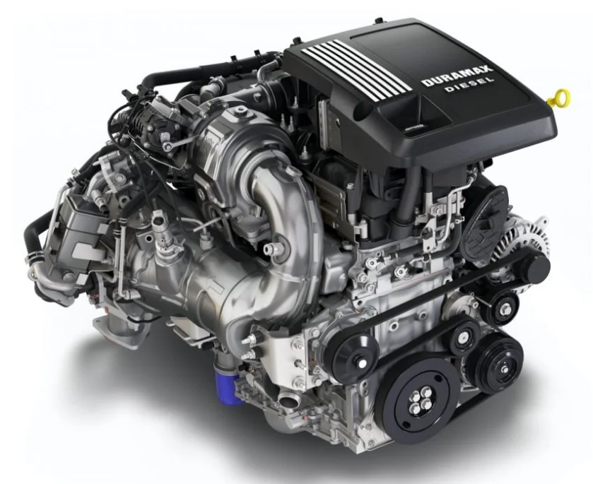

I personally don't know much about this GM engine, is it common rail? DPF? What is j/y price on these 15k mile engines? How long has this platform been on the market?
Cheers
Answered most of my own questions quickly by searching.
Ya, no thanks. All kinds of things I don't like, this is a Land Cruiser forum so I am sticking to my opinion that the 1HDx series of engines far exceed this platform for a variety of reasons.
All I see as a benefit is perhaps cheapish to acquire. Decent power numbers I suppose too in stock form. Example;
Not been on the market long enough to be tried and true. Potential probs with pumps and injectors as well as other known issues. How reliable will these be in 20yrs? Aluminum block & head on a diesel, I prefer cast iron head & block. I could go on. I will stop being the hater in this thread though as a lot of you seem pretty excited about this swap.
