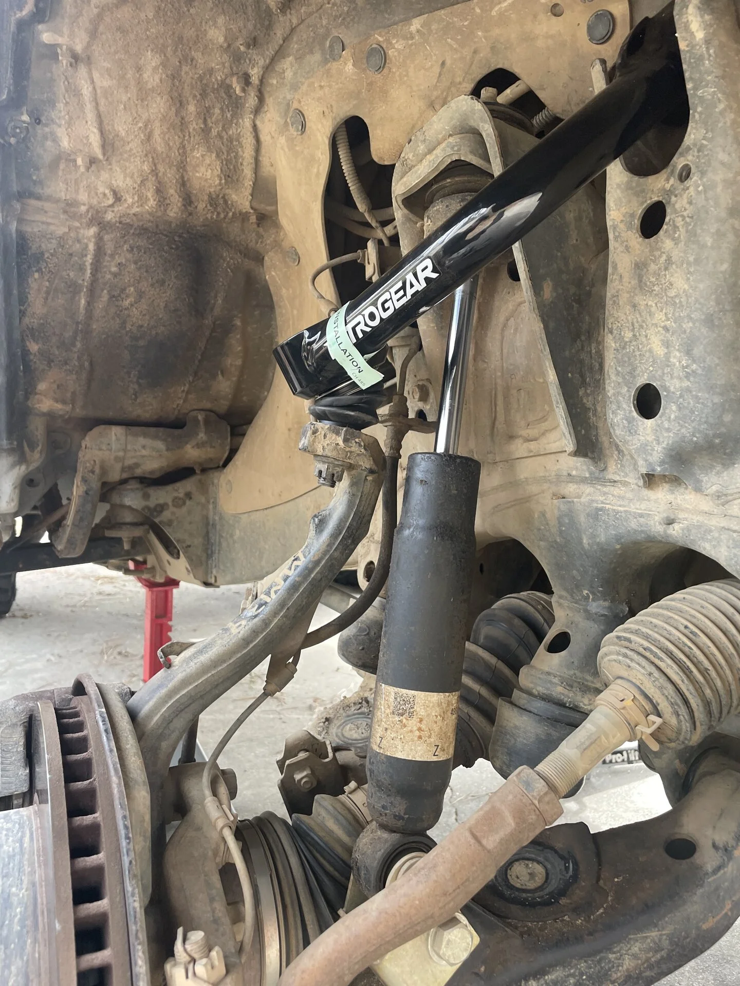

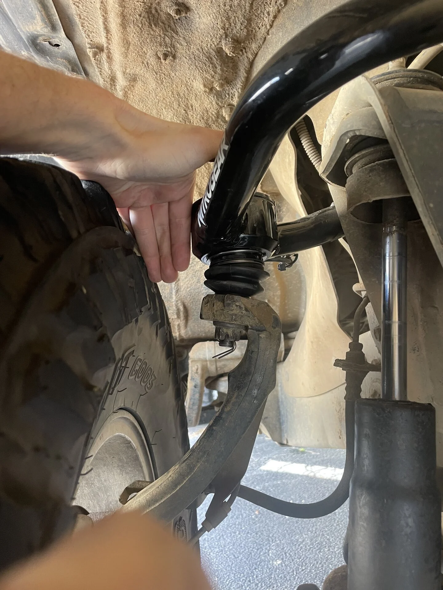

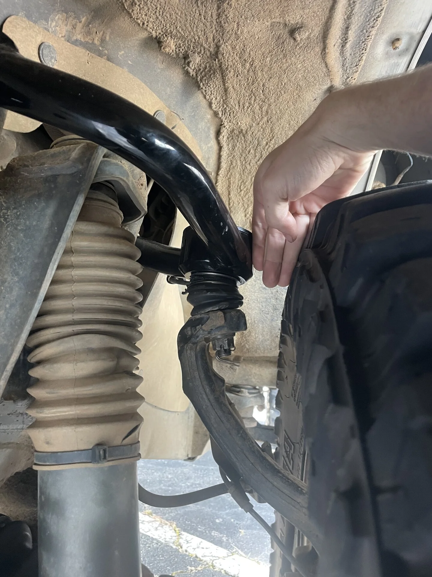

I just installed a set of Nitro upper control arms on my 1999 LX470 and immediately changed my mind.
I'm looking for a set of used SPC upper control arms for a 100 Series. I can ship the nitros and wait for you to install them then send me the SPCs. My truck is not my daily driver.
The nitros have less than 50 miles on them. I installed them, drove to my alignment shop, then drove home.

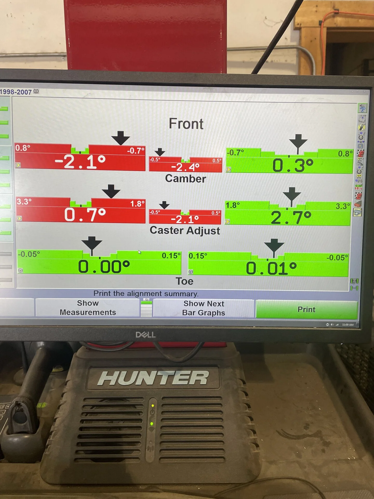

Was the shop able to get alignment numbers into spec?
No. I do my own alignments because I've had too many bad experiences with techs not understanding overhead caster adjustments.
The numbers above^ are current on my truck with the cams maxing out caster (spindle/knuckel pulled towards firewall as far as possible).
I determined that I bent my DS spindle at some point last year which explains these terrible numbers.
