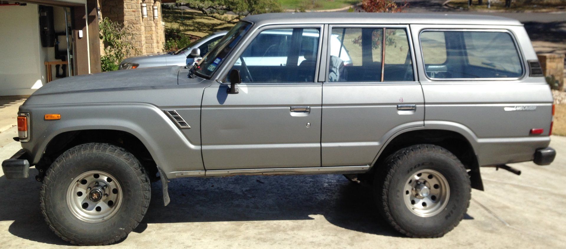

Here's the way it looked when I started:
Not bad, fully functional, but with a hasty re-paint job that is peeling, ornery suspension, stinky cabin and a 2F that desperately needs some TLC. It was the property of a south Texas rancher for the better part of 30 years. That probably explains a good bit of the smell.

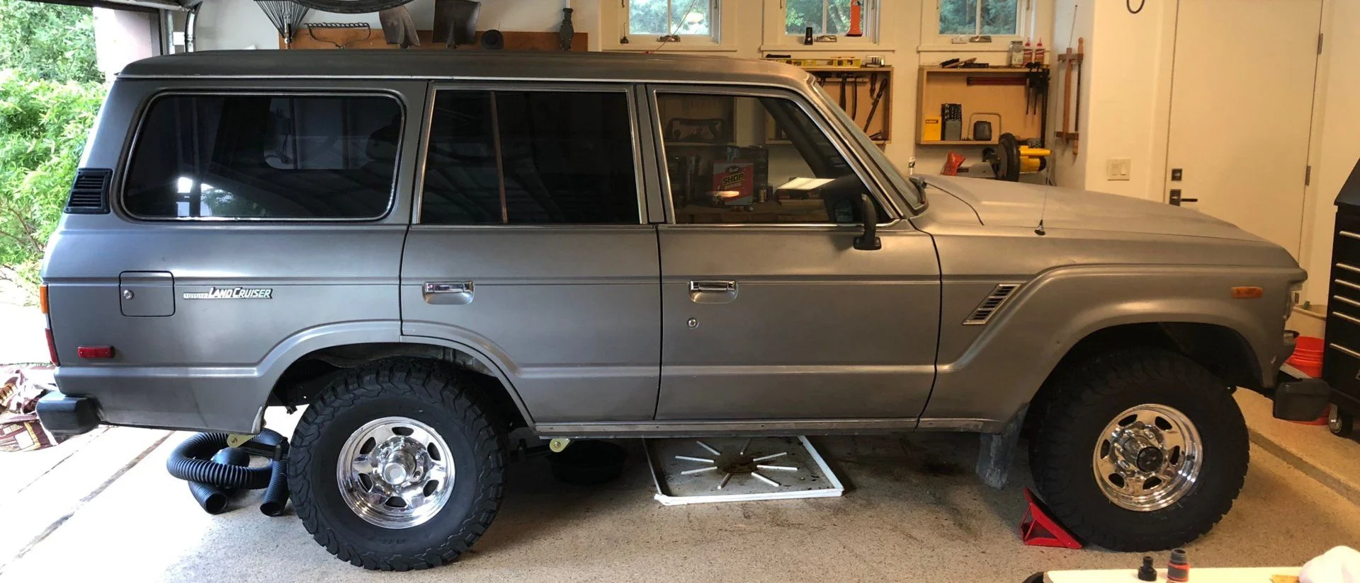

Well, a couple weeks ago I finally completed the leaf spring replacement, refurbed a set of original 15" chrome wheels and mounted BFG 31" ATs on them. At present the Cruiser sits right about at the original ride height, as far as I can tell, and I could not be more pleased with how it turned out. Here's an initial pic, but I will add some more this week over the holiday. It was definitely a project doing it all without a lift, but with all the experience on this forum, I never really felt unsupported!
Compared to the original:

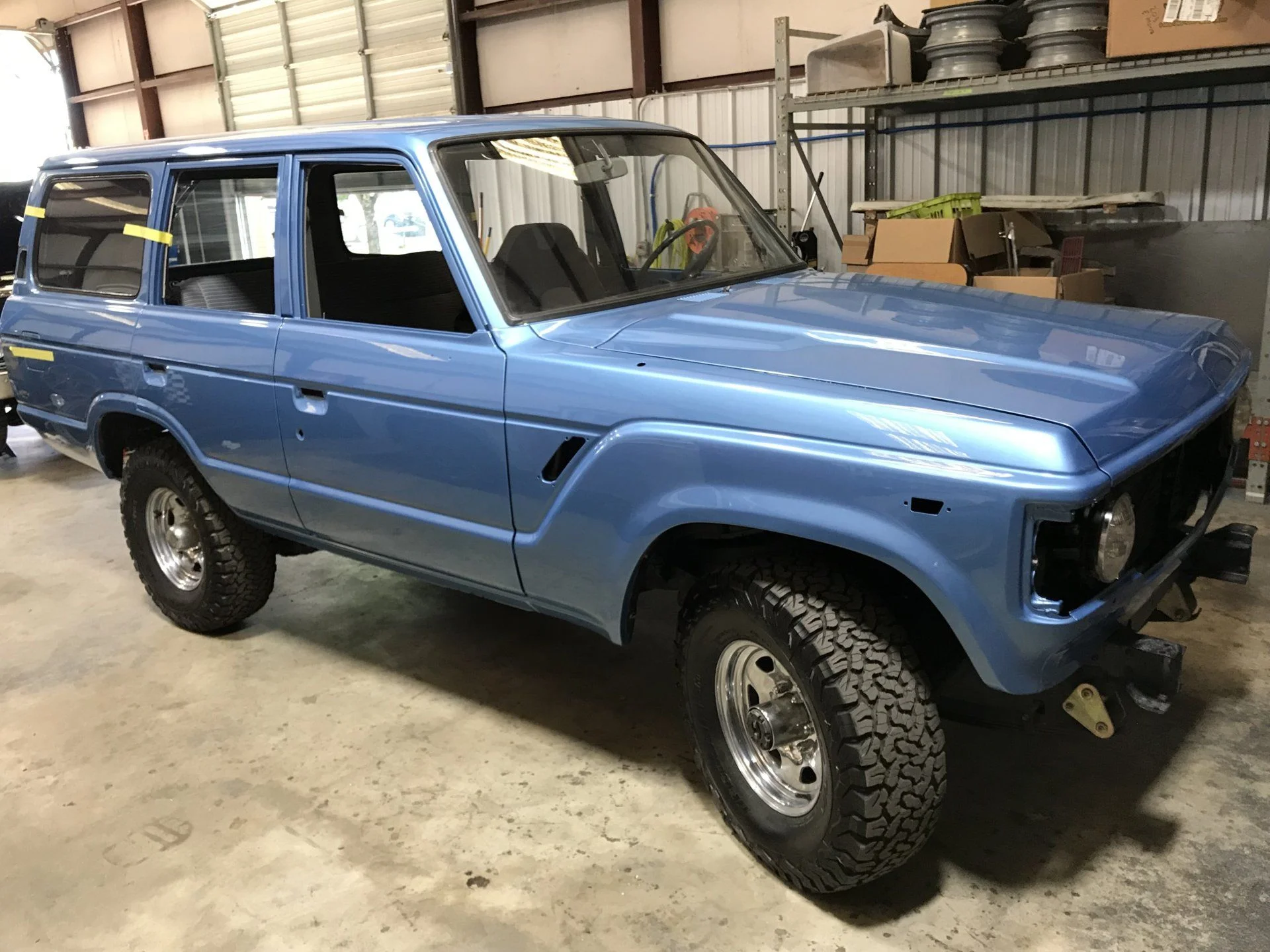

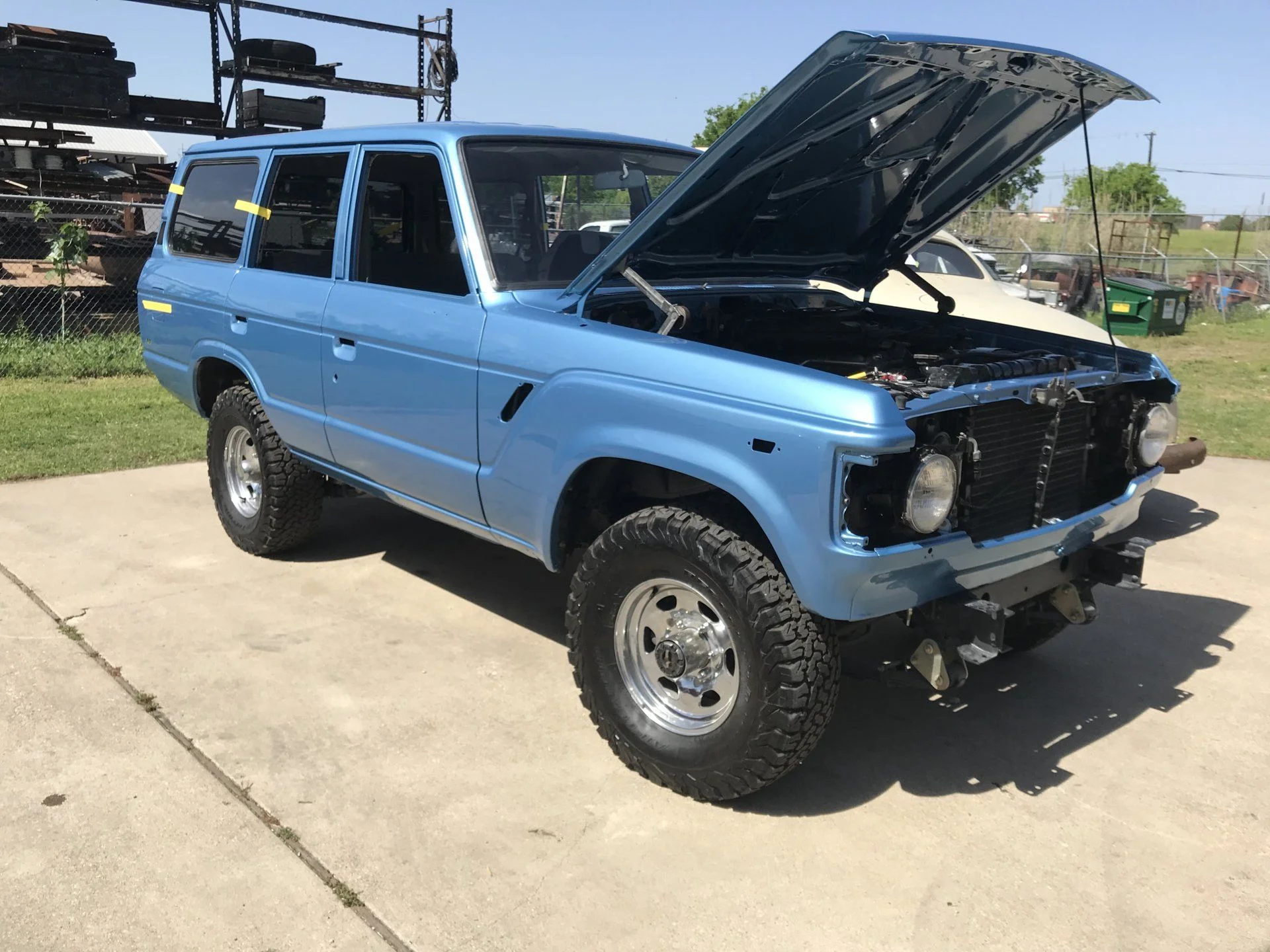

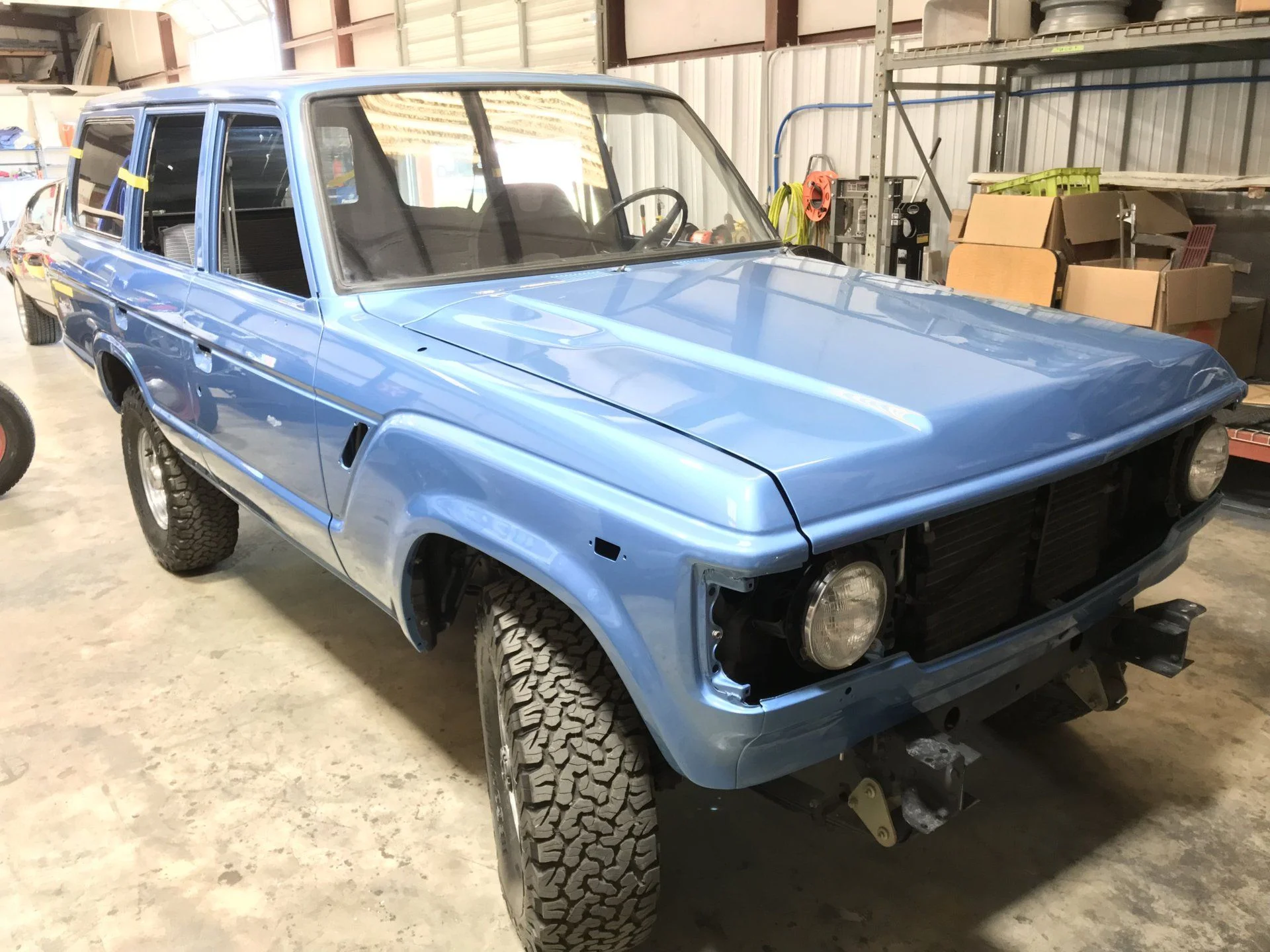

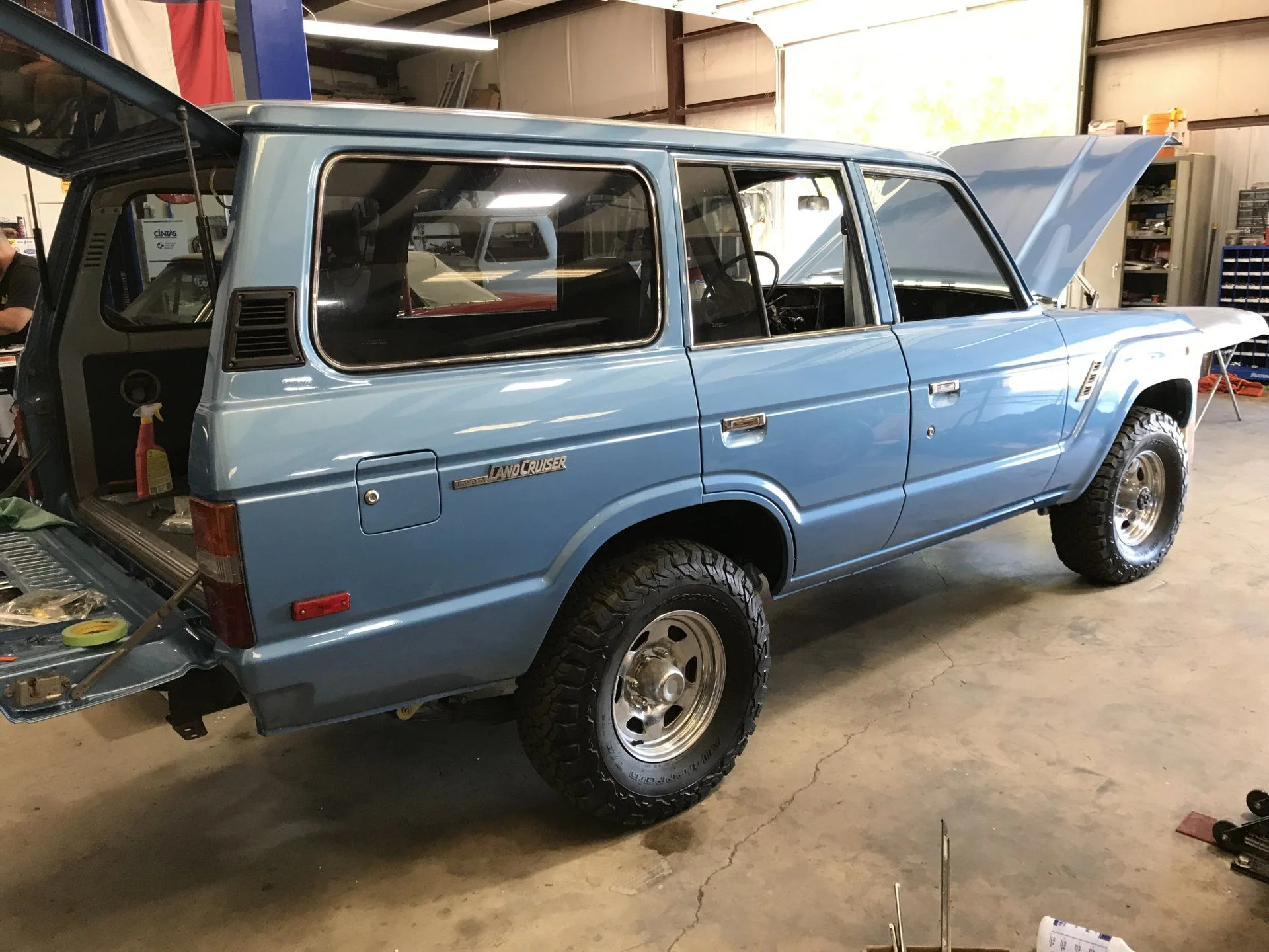

Getting excited because it is coming home from the paint shop this week or next. I opted for Toyota's 861 metallic sky blue. Purists will note that it was discontinued as a Land Cruiser color after 1984, so my '85 technically shouldn't be wearing it. But, it happened to be the color of my first car . . . a 1977 Toyota Corona. So I feel entitled to appropriate it here :)
