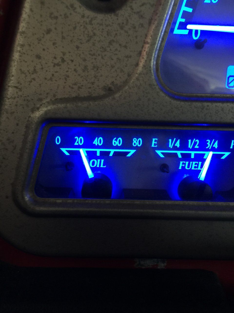

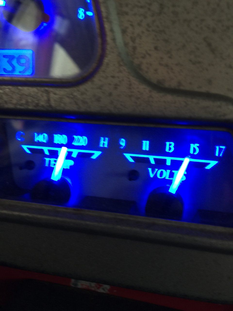

I'm running a 1975 SBC 400. My oil reading is between 18-20 at idle and 195 water temp. Brand new Dakota Digital gauges. Just to give you a comparison. Not sure if there should be differences between your 283 and my 400.
Those Gauges are so pretty...DD really did a good job!

Dd did such a good job on those gauges I just don't wanna fix something not broken. For what it's worth on my 350 oil pressure drops to 12-13 psi when in drive stopped.
