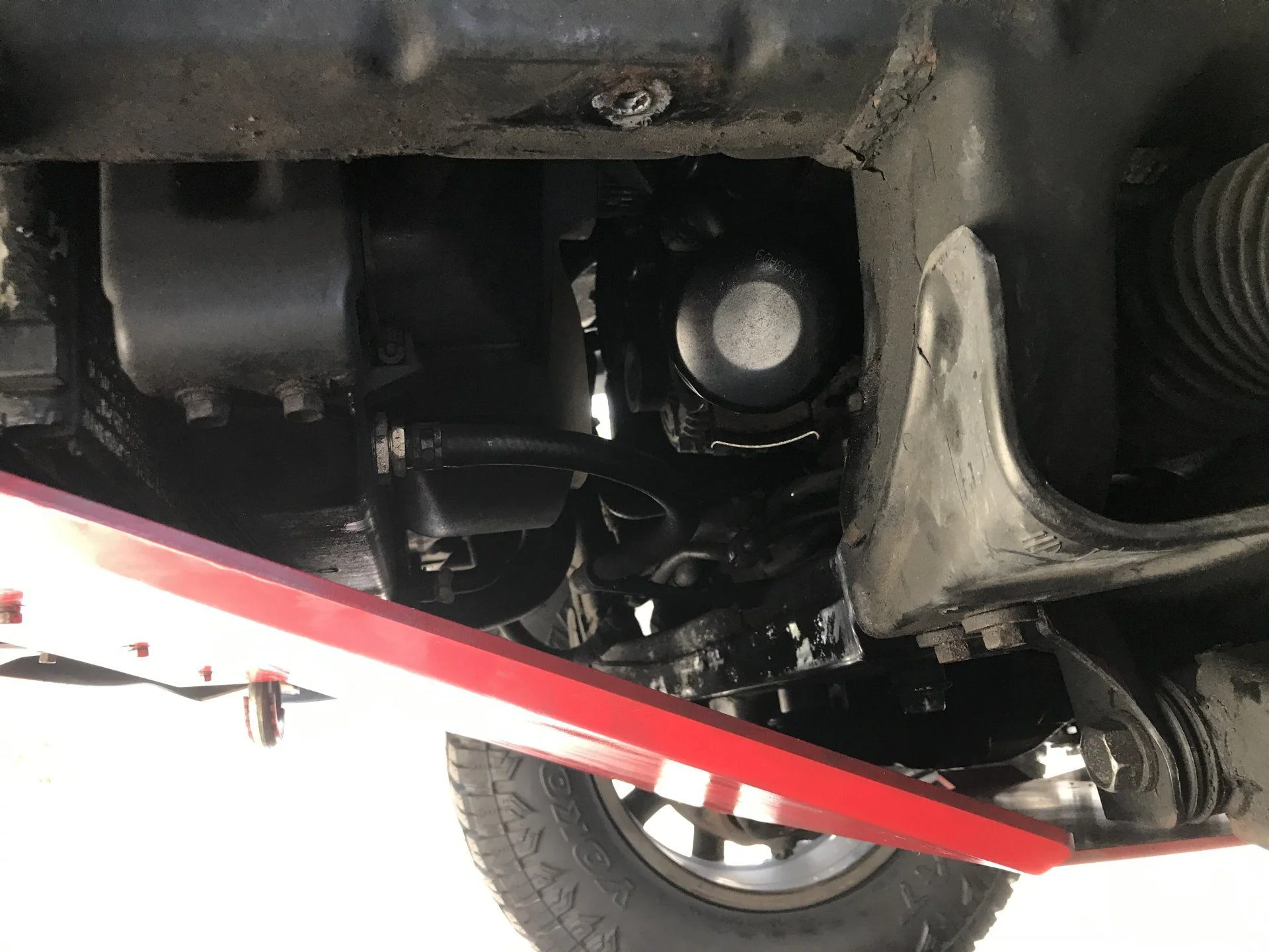

Wanted to share the clearance for the oil filter with the ASFIR front skid, note I do have the diff drop kit from @TRAIL TAILOR and those pucks are 30 mm tall or so. I can reach in with oil filter wrench or pliers. This last oil change I put a piece a bent piece of cardboard and let it run off into the drain pan. Worked decently, maybe will add a hole for drainage.
I do need to source a taller puck as the front skid doesn’t have the hump that the oem skid has. As the pucks I have on hand are too short. I need to measure with calipers, but by eyeball a 90 to 120 mm tall puck would do it. 2 of TT’s spacers weren’t tall enough.
I just installed a fumoto oil drain valve and the ASFIR front skid doesn’t need to be modified. I need to add a hole to my TJM skid. I added a zip tie to the plastic clip to secure it.
Of note I need to drill out the middle hole on the ASFIR so I can place the third puck.
