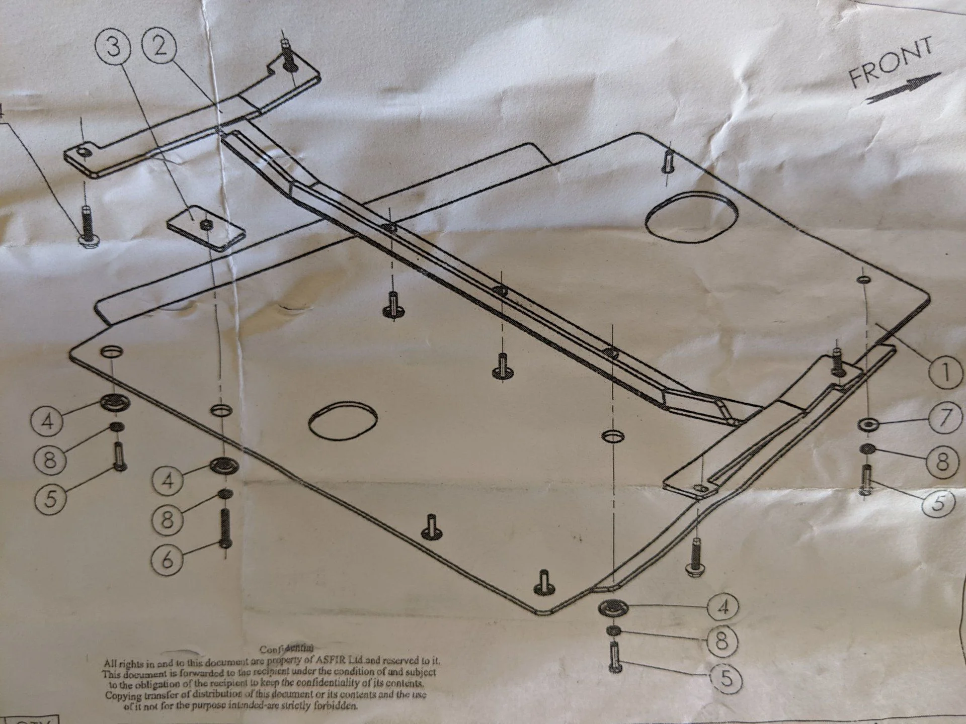

All good, I was just doing that so people didn't have to search through the comments to find the answers. Pictures draw attention, hopefully those will answer some of the common questions for people.

A couple more showing how I fit them around my MetalTech sliders and how I used some of the diff drop spacers for the gear skid between the bracket and the plate.
Just wondering why there is the need to put spacer between the plate and the bracket? If by design there is space in between, what's the purpose of the bracket? I thought the bracket is to support the plate?
I want to get the full skids but have a question about the bolt on sliders. I have a pair of white knuckle on order so do you suppose all the custom fab sliders attach at the same spot? Is this the only spot where the skid mounts to chassis and may interfere with slider u bolt?
You're right, the bracket is to support the plate. On an OEM setup, that would be the case.
The diff drop causes the plate to be mounted further away from the frame, so the spacers are necessary. These spacers came with the diff drop for use with the OEM skid plate.
Thanks for the clarification! 👍
